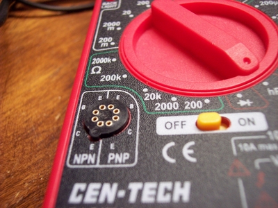

                            Re: Ever used the hFE tester on your multimeter?
                            Originally posted by momaka
                            Yes, those cheap HF meters have completely useless hFE sockets, even if you do take a brand new transistor with long leads and try to stick it in there. The socket is so unreliable and flimsy, that I probably would have better luck measuring the transisotr's hFE with my ass. Seriously!
                            I found that same thing after reading people's comments about using it. I couldn't figure out how they got it to work, as I returned my first one thinking it was broken and had the same results on the replacement. Not having a meter with HFE, I wanted to see it work, so I ordered a machined pin socket where the contact holes sit flush with the surface, but I had to extend all eight legs to get it tall enough.
                            Long story short, I tried a few things on-hand and it surprisingly gave readings almost dead center of the range listed in the corresponding datasheets. I think I also compared against some manual calculations I found using Ohm's law. Not sure how useful it will be, but there was a slight feeling of accomplishment in forcing the feature to work.
                              Nice work!
                              That is actually a great idea there . I do have some SIP machined sockets left over from an electronics class. I'm thinking I could cut a slot on the side of the meter and attach the socket there. It wouldn't look as neat as yours, but it should still work.
                              Not that I use the hFE feature much, but like you, I would feel a sense of accomplishment if I got it working right.
                                If you see a machined pin socket that's tall like the original, I'd be interested, though I'm not sure it's worth modding a second one. The only tall ones I saw look like the stock one, but I couldn't tell if they're any more reliable.
                                I see some non-DT830's with dual row rectangular sockets. I think that or the single like you're doing is what they probably should have used.

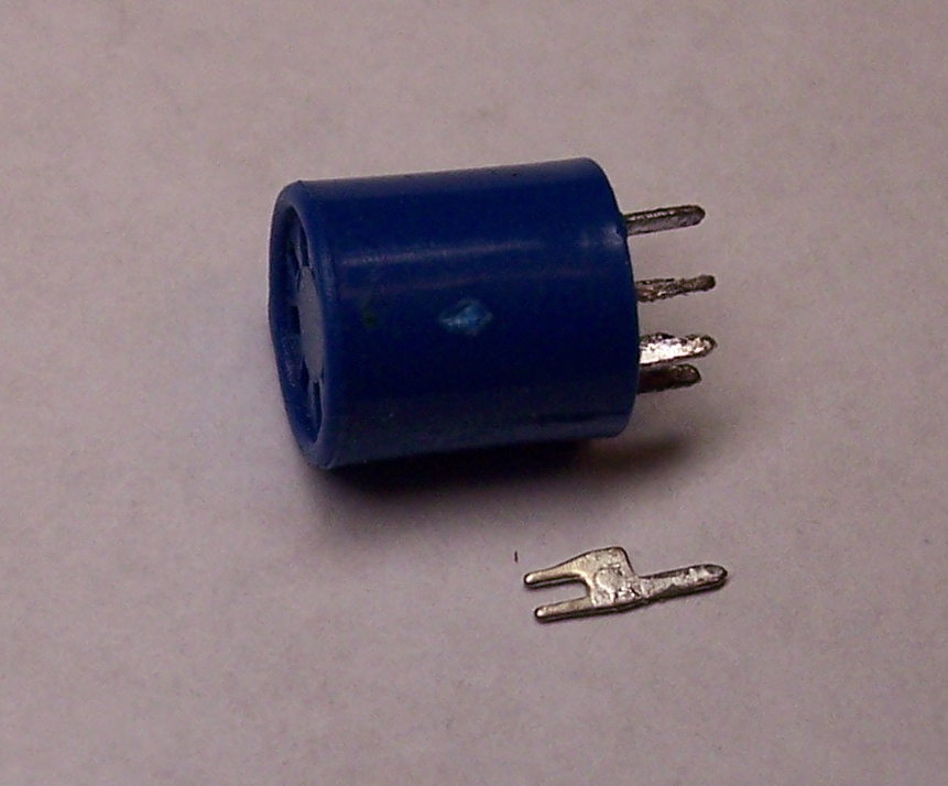

                                  If anybody ever wonders what they're up against with those god forsaken blue sockets, I just realized the old one was sitting in front of me.
                                  rough checks with a caliper:
                                  The blue body is about 10mm deep (diameter is roughly 9), and the pins stick out from the bottom by about 3mm (they're around 6.5 total length). The pins are also pretty "flat". They look to be about 0.3mm thick. So you've got to go about 6+ mm down into the socket before you have any chance of touching that fork thing, and then your leads will need to be thick enough to make contact.
                                    ^ Good info, thanks.
                                    This gave me a new idea - what if you cut the top part of the socket all the way up to where the pins begin to protrude? I think that might be another way to mod these without buying anything. But how well it would work... I don't know. Might try this instead of my previous idea, though.
                                        Yeah, I actually considered that too, but you'd still be dropping the socket way down below the face of the meter. Seems like it would still work, just wouldn't look that good. I was actually thinking of burning that blue one down to size with a belt sander without even removing it. Just make sure you vacuum the holes out or something afterward. I don't think those fork/contact things need any extra help making a flaky connection.
                                        Redwire's link looks like the one I installed. Mine appears to have been this thing by "Mill-Max". Still sits way too low though without extensions.
