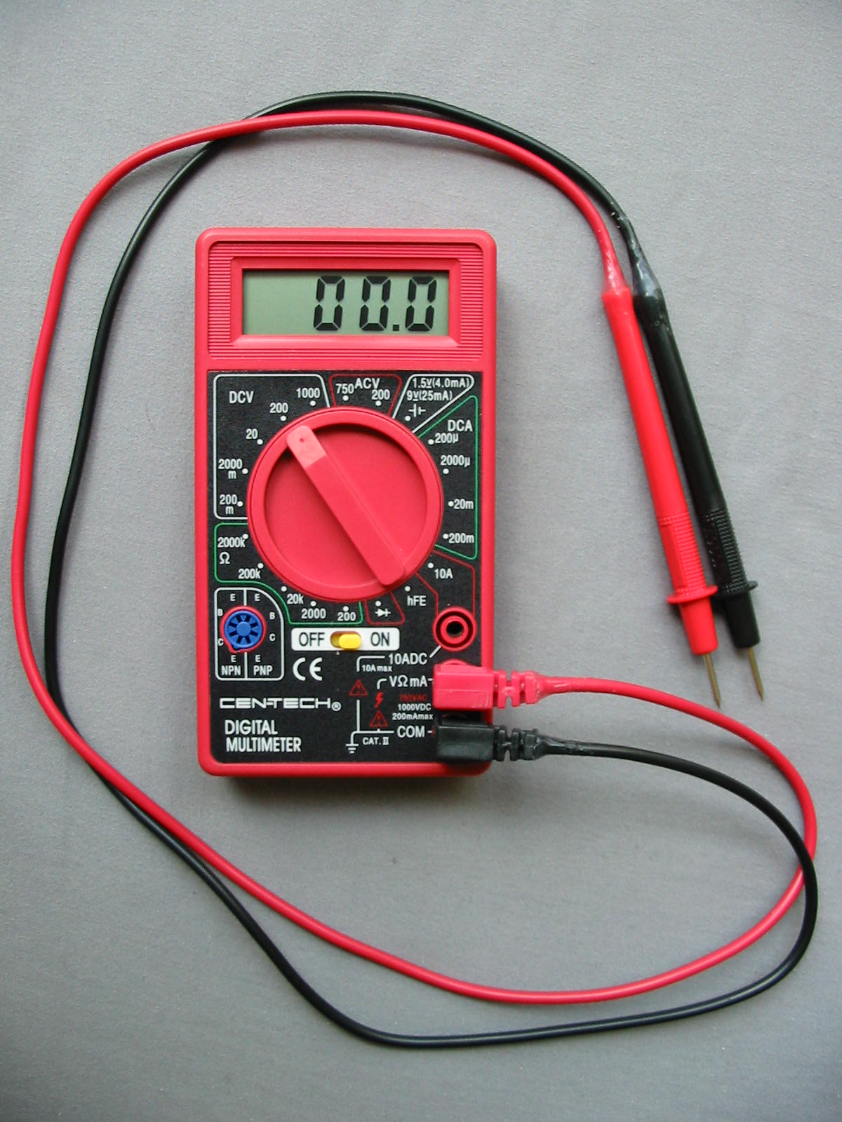

    Two months ago, I received coupons from HF, and one of them included this meter for free (with any purchase). Since I needed some other stuff from there, I went and also grabbed this digital multimeter. The unit I got is item # 69096.
    I didn’t really expect much, since even without the coupons, this multimeter is regularly sold for under $10.
    It’s a very plain 7-function multimeter: standard AC and DC voltage measurements, DC current up to 200 mA or 10A, up to 2 MOhms resistance, diode test, transistor hFE, and 1.5V/9V battery test. Note, however, that there is no continuity function (hence no buzzer either).
    Probably one of its better-thought features is that it has a separate ON-OFF button – or at least I like it better, since I can leave the dial on a setting that’s used the most and not have to turn the dial when I want to turn the multimeter OFF.
    Before tearing the multimeter open, I decided to test some of its capabilities. Upon trying to plug the probes in the multimeter, I noticed that they didn’t go in quite easily. The 10A jack was particularly stubborn – I couldn’t plug in the probe all the way no matter how much pressure I applied (and I didn’t want to apply too much as I didn’t want to break anything after all). I inspected the plugs on the probes, but they appeared fine. So most likely something was obstructing the jacks in the multimeter.

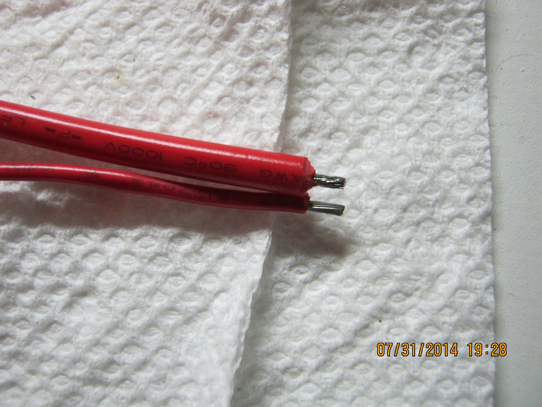

    Speaking of the probes, they appeared quite thin - but no less than the ones on my 13-year-old 830 multimeter. Same length, too. Even the handles were nearly identical, with the wires running through them and not held by anything at the end to prevent them from being twisted in the handle (which, over time will cause the wires to break away from the handles).
    Continuing with my tests, I dialed the 200 Ohm setting and turned on the multimeter. I got a “1” on the left side of the screen – a good sign so far. Next, I shorted the probes together with a 16 AWG jumper lead. The display showed “14”. I though, that’s a bit high, isn’t it? Then I picked up the multimeter and tried to turn its dial. All of a sudden, a dot appeared between the two digits, thus showing “1.4”, then disappeared again. A-ha! So the decimal point isn’t working.
    Next I tested a voltage on a battery and compared it to my other multimeters. It agreed, so I concluded that’s enough testing and tore it up .

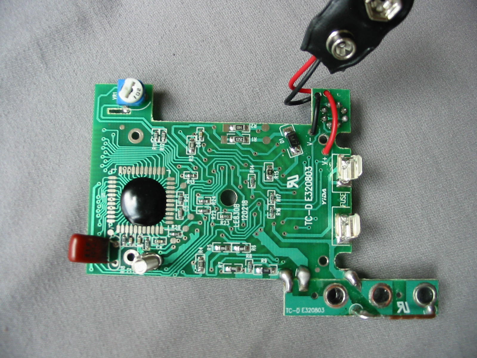

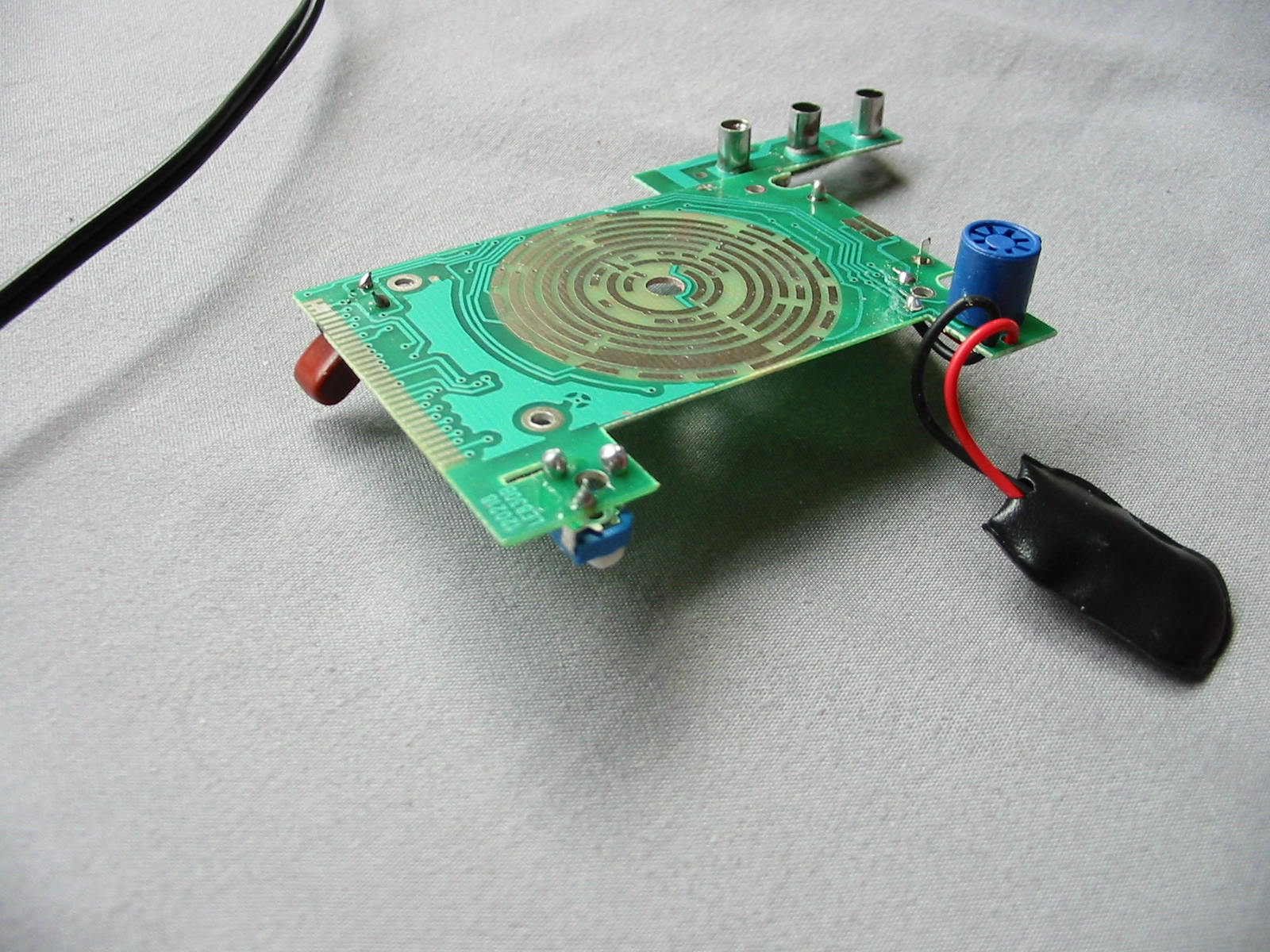

    Not too bad at first sight, it seems – and it really isn’t. However, note the small PCB that holds the jacks for the probes – it is held to the other board only with big, blobby solder joints. I can see a lot of potential (pun intended) for trouble there.
    The solder joints on the rest of the board are pretty blobby too. The fuse (missing in the pictures, because I removed it) is a standard glass fast blow fuse, rated for either 0.2 or 0.5A (I’m going from memory here). At least the battery wires are running through holes on the PCB and soldered properly. I highly dislike wires soldered directly on top of the PCB, so that’s one thing they did okay.

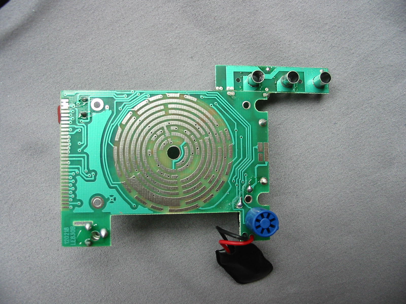

    Here’s another shot of the other side of the board:
    https://www.badcaps.net/forum/attach...1&d=1406841775
    Blobby solder joints aside, the solder mask and PCB looks clean. Not much to complain about here.

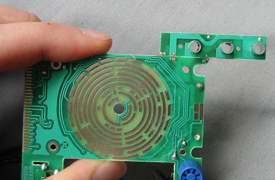

    Another shot – more blobby joints on the trimpot:

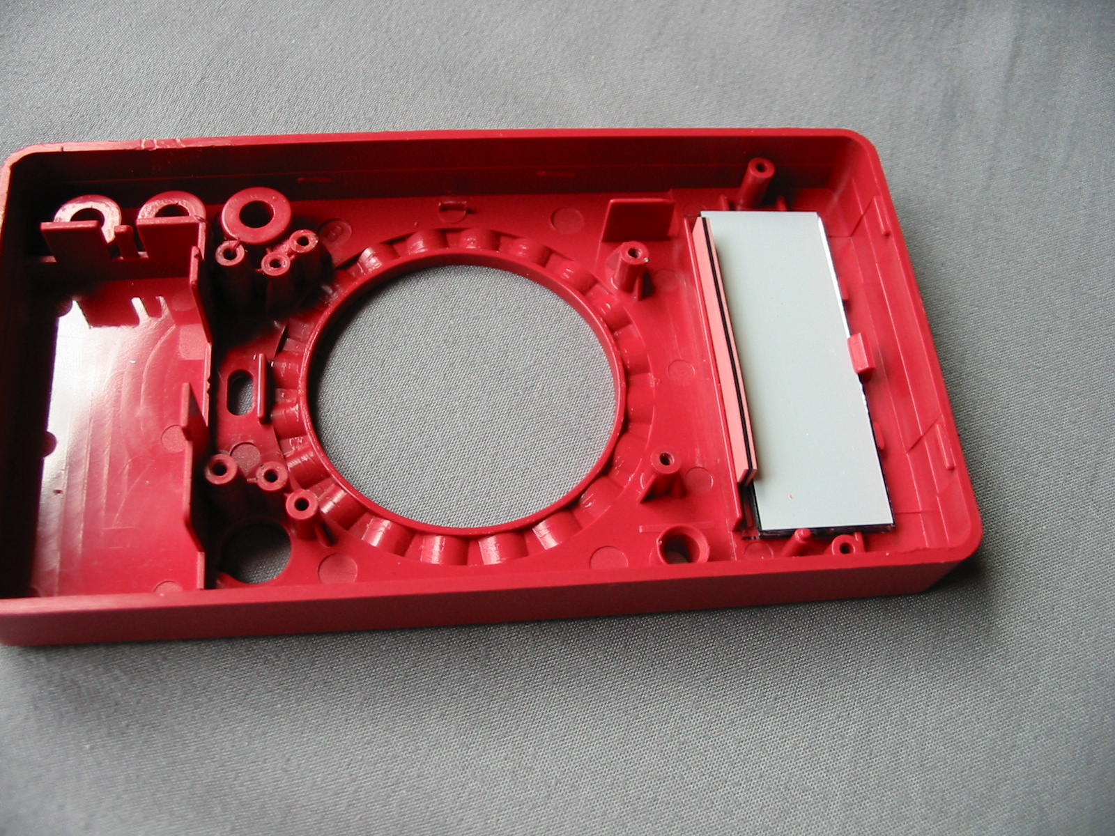

    Plastic top with the LCD inside.
    Although not visible on the picture, two of the screw standoffs that the PCB is mounted on were cracked. The pink tab on the LCD is what touches the contacts on the PCB to make the LCD work. It’s not soldered to the PCB, just held by pure pressure from the PCB. Not a very good design, IMO. I grinded the standoffs only a tiny bit, hoping that this would make the PCB make better contact with the LCD ribbon and thus get that decimal point working. I also put hot glue around the standoffs to prevent from further cracking and/or completely braking off. I’ve seen it before with cheap plastic cases, so I though I would do this as a preventative measure.
    And here is why the probes wouldn’t go all the way in the jacks:
    The soldering of the PCB was so bad that some of it got in the barrel jacks. I grinded it away with a drill bit attached to my dremmel tool.
    Finally, I put some hot glue at the end of each probe handle where the wires enter it. This is to prevent the wire from twisting and pulling out of the plastic handle. I also put hot glue near the banana jacks on the probes. The plastic that they have that is supposed to prevent the wire from breaking doesn’t really do that good of a job. After a years use or so (that is, if the wires on the probes near the handles have not broken yet), this is the second most likely place where the wire will break and cause a loose connection. So adding something supportive and flexible there is a good idea.

    Boy the trace clearances between the input jacks look very small for 750VAC input, it should be at least 6mm.

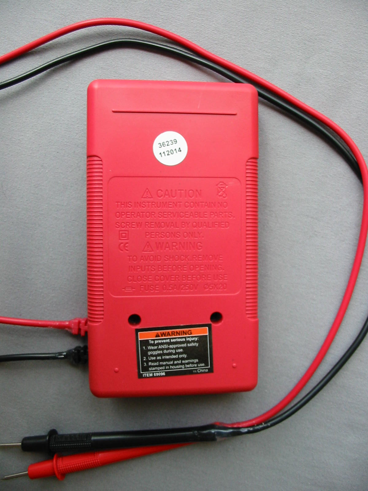

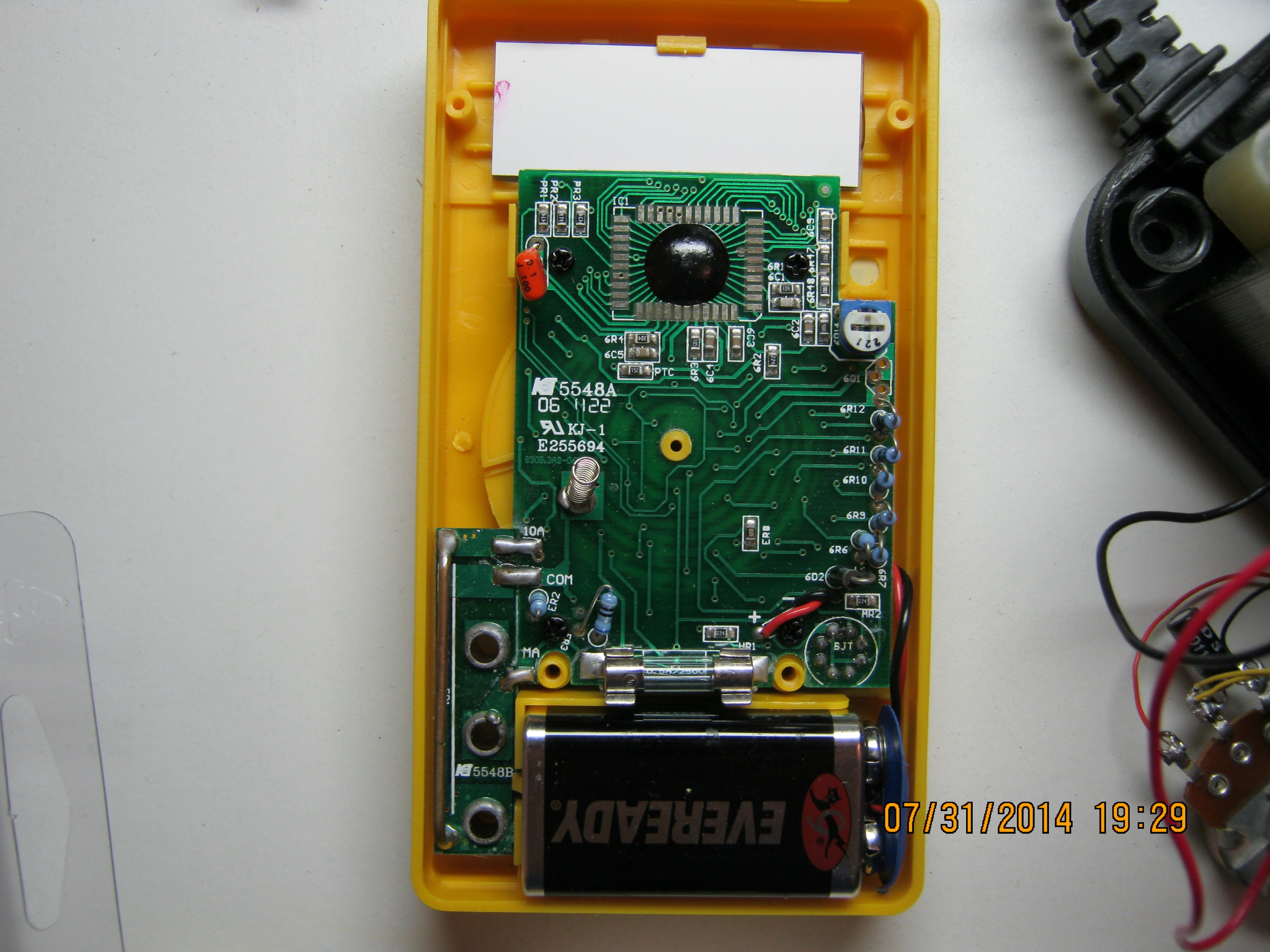

      Here is the old one I've been using. It was made when these meters were $3 without a coupon.
      This one has the same "Screw removal by qualified persons only" warning on the back that yours have. I guess that means you need an electrician or an engineer to remove the screws, but you can do anything you want to it once the screws are out. The front looks the same and has the same ranges (including the battery test).
      I did try removing the circuit board from this one, but the plastic tab holding the jack board in started to break. It's the only support the jacks have.
      The included leads are labeled 18AWG, but I don't know if they really are that large. The wire with thinner insulation in the second picture is 20AWG, and they look about the same. I don't have any way to measure the area, so the included leads might really be 18AWG. Looking at the diameter compared to another stranded wire isn't accurate at all.
      This one always adds 1.1 ohms to any resistance reading. I don't want to start screwing around with it unless I know I can fix that while keeping all the other ranges accurate. Voltage readings are slightly higher than the meter I normally use, but not as high as the measurements from the Fluke 289 I borrowed while repairing my monitor last year.

        It's called built-in spark gap , made to protect the multimeter (but not the user or his/her property) from high voltage .
        I thought about adding hot glue between those traces as well, but I was too lazy to follow the traces on the rest of the board and there may as well be other places with potential (oh, the puns, ha ha ha ) to arc over. So I decided it's not worth the trouble - I'll just use the multimeter for low-voltage measurements and probably mostly resistance and low current.

        Thaat must indeed be an older unit as you have more through-hole components.
        Surpisingly, you wire does seem to be the right size. If it has UL number, it probably is legit. Mine has nothing on it and is way too thin to be 18 AWG and 1000V rated.
        So that means I need a qualified person to change my battery as well .
          I see they cheaped out on the PTC (just below the main IC) with a 152 SMD resistor instead of a real PTC. On some of the cheap 830s that I have, they have an actual PTC.

                That must indeed be an older unit as you have more through-hole components.
                The date code looks like it was made 2006, week 22?
                I have one with through hole components. If I remember correctly, the 100 ohm resistor (R12) was open causing the 830 to display/measure 666V DC for a 9V battery. It took me a while to figure out the problem, but I learned a lot.

                              Originally posted by momaka
                              That's not too bad of a resistance, considering how crappy the wire is with the stock probes. I bet you would get 0.5 to 0.8 with good leads, which isn't stellar but certainly better.
                              I don't think the resistance readings set much lower than that. Even one of those cheap leads gives the same resistance reading. Also, I discovered that the fuse (500mA) has 1 ohm of resistance, but it's only used for the current ranges. The current measurements seem accurate.

                                For anyone interested in these things, I've been sticking some pictures in a thread over at EEVBlog (in addition to the ones already there). If you run into ones which aren't yet on there, it would be interesting to see what's inside. It looks like there's a decent range of board and build quality between them.

                                  ^ Cool thread. I do have another one that I haven't posted yet, but I think it's a version that it has been posted before. When I get to it, though, I will post pictures here on badcaps, regardless.

                                    Hi momaka,
                                    It's starting to look like there might be good ones and bad ones to get, but they use the same model numbers (like DT-830B) for twenty different ones, so it might be hard to figure out. I wish we could get lti's yellow version. I just got a dead DT-830D (I guess that's what the "D" is for). I wanted to see it output a square wave. I may try to track down one of the yellow ones that have it, but who knows what I'll get.
                                    FWIW, the 830D was a black one with a removable battery compartment. Did NOT appear to be very well built and has no labeling on the PCB.
                                    Take Care
                                    George
