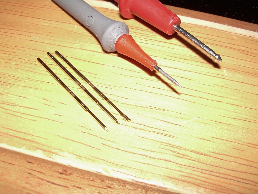

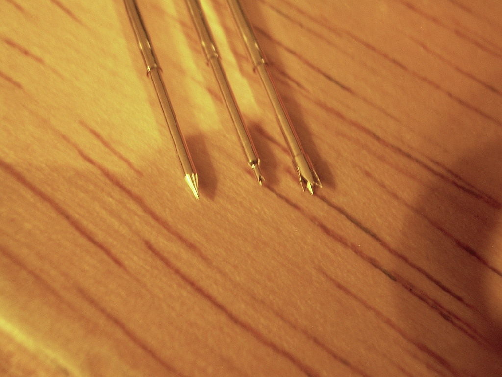

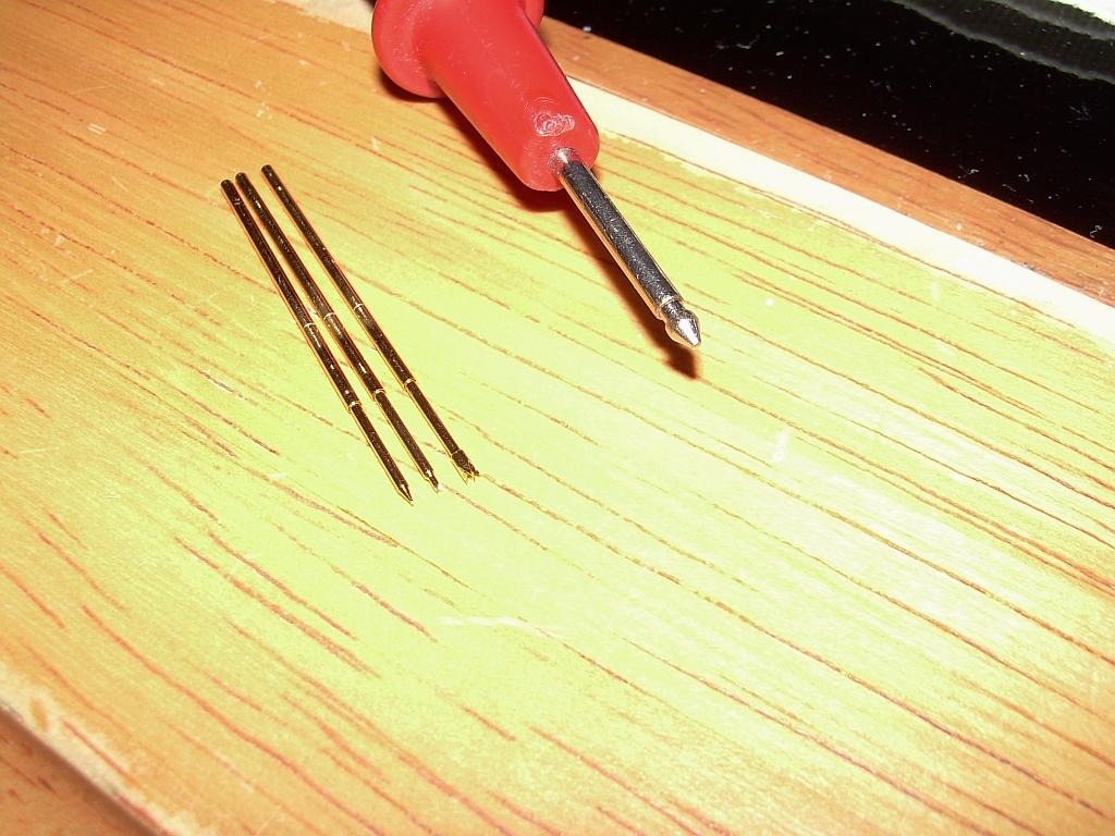

    I use the Fluke Tl190 probes with replacement springloaded tips, took a few pictures for you.
    If i remember correctly Pomona also has these probes.
