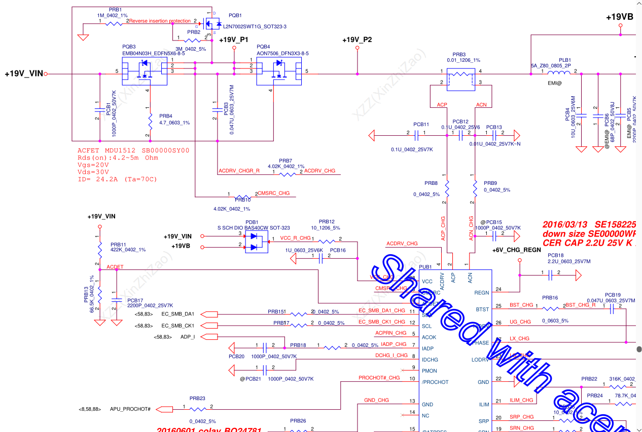

      Welcome. Remove all power. Locate each inductor on the board (usually grey in color and with 2 legs). Meter in resistance mode (ohms). Measure the resistance to ground of each such inductor. Each inductor is linked to a local power supply rail which will accept the 19v adapter voltage and lower it to a safer lower voltage (buck regulator operation). Checking if there are lower than normal resistance on the downstream (consumer) rails. This usually indicates a shorted part which is causing the power adapter to disable.
      Post any suspects.
      PUB1 is the charger IC. With the power adapter connected, with care, measure the voltage to ground of the following pins:
      REGN ; pin 24
      ACDRV ; pin 4
      ACOK ; pin 5
      VCC ; pin 28

          mon2 I've been able to perform part of the measurements you suggested. Here are the results:
          With the power off, I've measured the resistance all 7 inductors present on the main board. Here are the results:
          PL302 0.05 ohms
          PL502 0.05 ohms
          PLZ1 0.05 ohms
          PLZ2 0.05 ohms
          PLA1 0.05 ohms
          PLB2 0.06 ohms
          PLF1 0.05 ohms
          It is worth mentioning that these resistances are outside of the comfort zone of my DMM, as 0.05 ohms is the minimum it can measure (i.e. when I make a direct connection between both probes, I measure 0.05 ohms as well).
          As for the voltage measurements on the pins of PUB1 I wasn't yet succesful, because I was unable to find a way to probe the pins of the QFN package safely (without potentially shorting neighbouring pins). Will try to find a safe way and report back. By the way: can these measurements be done reliable without the (large) battery hooked up?
          Rutger

              I believe that the measurements may have been incorrectly made. Suspecting that the measurements have been made with the meter probes on each side of the inductor? That will make sense for the posted measurements. The inductor is essentially a large length of wire so the resistance should be very close to 0 ohms.
              To confirm, configure the meter into resistance mode, place one meter probe (either color) to the inductor (either side of the part is ok) and other meter probe to ground. Metal shield is ok. Note the measurement in ohms. If the resistance is higher than the selected meter scale (on manual meters) then you may see 'OL' for over limit. Then you must select a higher resistance scale till the meter can measure the resistance to ground of the power rail.
              • mon2
                • Dec 2019
                • 14755
                Ok. We posted at the same time. Makes sense now.
                Review your local Amazon stores. Someone must be selling fine tipped meter probes. That or consider a new low cost meter with fine probes. AliExpress is another option for both.
                Leave all power off. No battery. Measure the resistance to ground of the main power rail that follows the 2 * Dcin mosfets. One probe on the mosfet, other probe to ground.
                measure, pins 1-2-3 (source) to ground.
                measure, pin 4 (gate) to ground.
                measure, pins 5-6-7-7 to ground.
