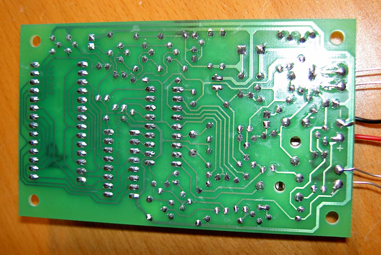

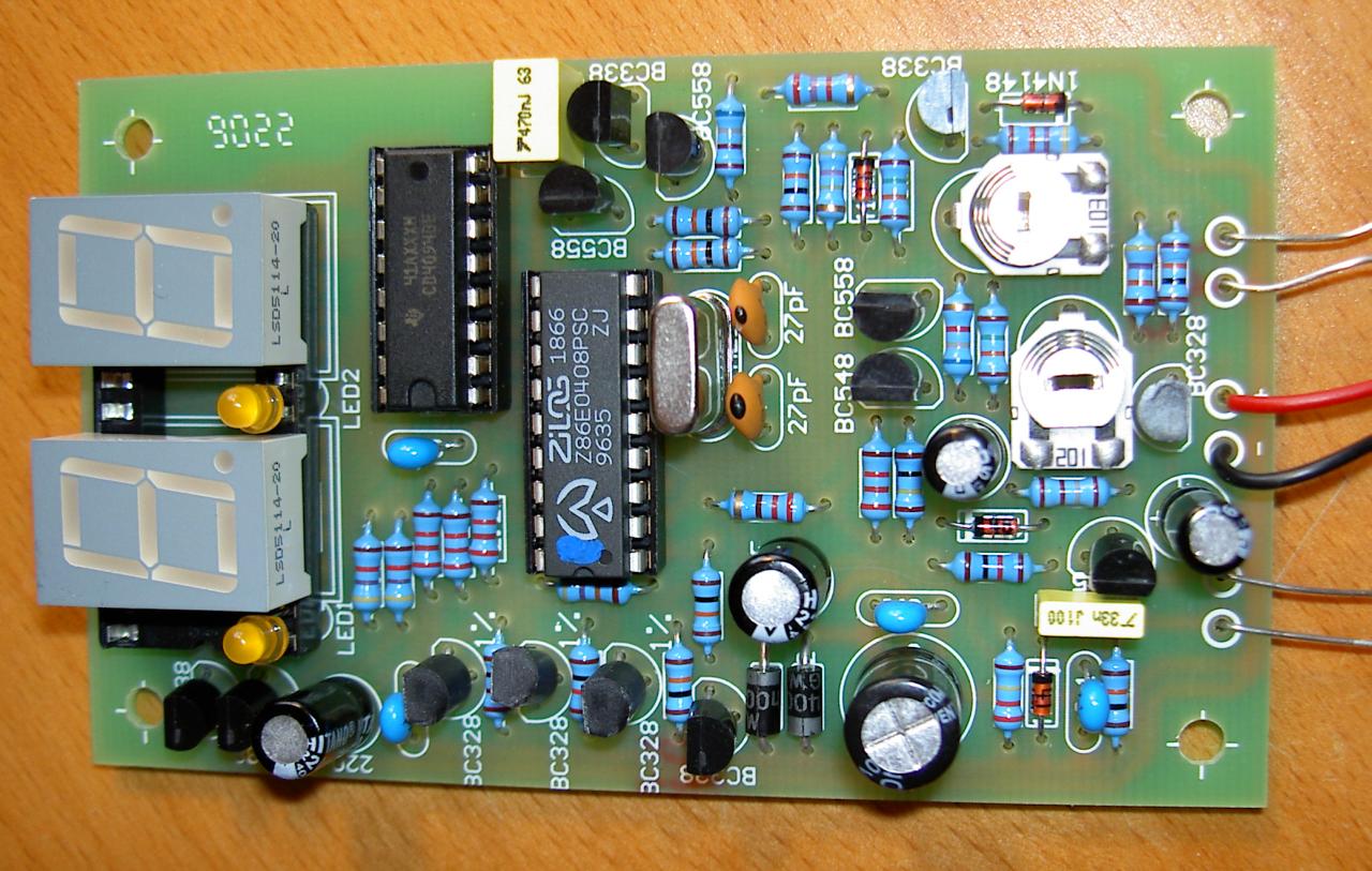

    Assembled my MK2 ESR meter now, it's working fine, right at the first try also
    Included some pics of it almost complete...
    The test probes as was already said above do not work too well though, gonna buy a new pair at Elfa, need a pair for my multimeter anyway because they have also given up :/
    Will also buy 2x 1N5404 diodes to put on the testleads to protect the meter from charged caps... Anything else I could add to make it even more safe?
    And thanks Bob.P for joining the forum and designing the ESR meter for us crazy fools

      Just a thought to my post above, what if I also put 5w resistors after the diodes; should not that make the capacitor dissipate it's charge slowly and nicley while at the same time protecting the ESR meter?
      Because the diode only approach sounds a bit dangerous if I connect it to a really big charged cap, I think bad stuff will happen

        Hi Per,
        You've built it very well. Congratulations that now you've got a Mk2 ESR meter!
        In fact the crazy fool I designed the ESR for was ME. I thought it was so useful that I'd make the design public. Of course I'm very happy that lots of other crazy fools (and some sensible people!) are using it too.
        So far I have not heard of anyone damaging an ESR meter after installing the big protection diodes. But if you connect it to a big charged high voltage capacitor, it will burn the tips off your new probes.

                        There, got cables now too
                        Just to make sure, is this the way the safety diodes are supposed to be installed? (the two vertical things being the wires going to the test lead sockets)

                          Yes, that is correct.
