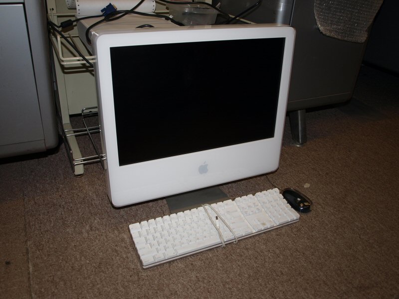

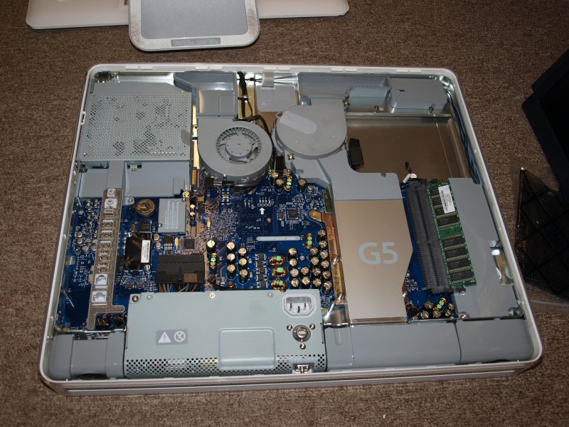

    I was told that the local thrift shop had a bunch of computers for sale really cheap......reluctantly I went and checked it out...... I know now why I was reluctant, there was a pile of beat to shit emachines systems and a few banged up dells, all of which was s370, socket A, and a few 478 systems, nothing too terribly recent....most all beat to hell and overpriced.
    I guess there's a white sheep hiding amongst every herd of black sheep... I walked around the shelf to the other side, low-n-behold, there's a 20" Imac sitting there, KB, mouse, and all. Sticker on it says "runs for 5 minutes then shuts down, $10.00" For 10 bucks, what the hell. I took it up front, paid and left. Sure enough, I get it home, and we all know what was ailing it.
    This one is going to be part of an experiment. Details later.

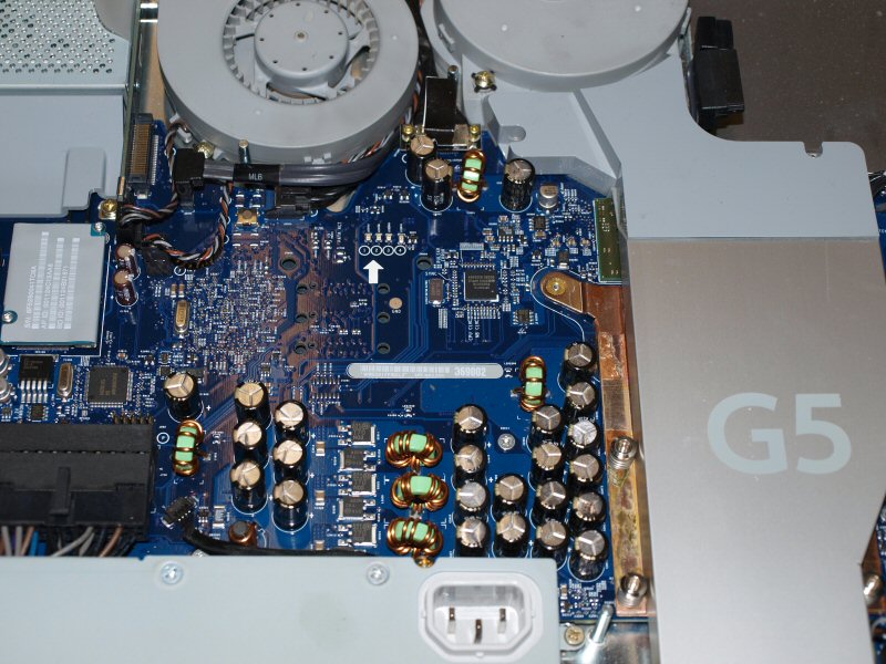

        Bonus points if you explore the PSU.
        I still have a dead PSU I wasn't able to fix, here.
        • Topcat
          The Boss Stooge
          • Oct 2003
          • 16959
          Re: Long live thrift stores....
          Yes, that's standard procedure around here. PSU gets recapped when the logic board does. I have some more G5's on the way for some experiments, which will be released later....this one was just a lucky find.... I havent recapped it yet, I'm waiting for some goodies to arrive.

            • 31260
            i did one of those,
            the mobo is a bitch to desolder from - i have never seen a pcb soak up heat like those!
            • Topcat
              The Boss Stooge
              • Oct 2003
              • 16959
              Originally posted by stj
              i did one of those,
              Try stuffing polymer caps with fatter leads into those tiny holes.... I've found I always have to turn up the heat on the soldering station to easily reflow the solder. It takes longer to get one apart than it does to recap it.
                  Yep. The Hakko 808 is able to take the caps out but is unable to clear many of the holes even with the help of an SMD heater. That's the only board yet I've needed to drill to remove the solder.
                  The new caps were soldered with tin/lead.
