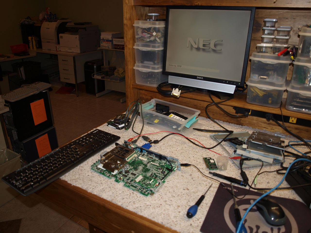

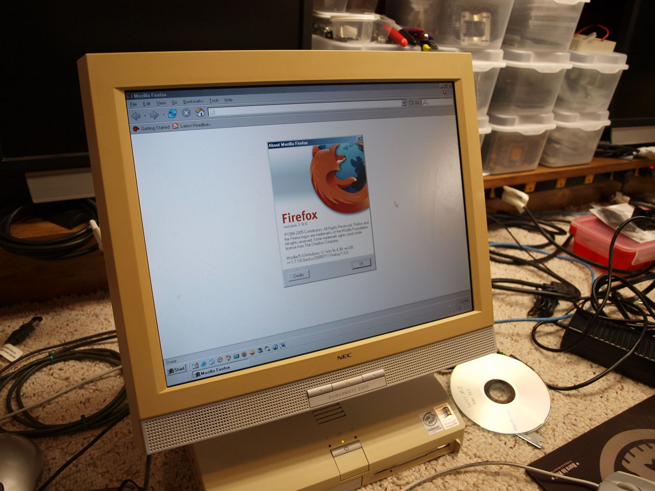

            Had a couple nifty dropoffs..... The pick was a NEC Powermate all-in-one with a LCD, circa 1999; model PM 2000. There was pretty much nill out there on this thing as far as information. It was made in Japan. It had a Celeron 433 & 192mb RAM. I don't have any PC100/133 SODIMM's, so I can't upgrade that.... Originally had Win98 on it, someone up'd it to 'Miserable Edition'. No Uranium, nothing exciting on it.... Has a mega huge 6.4gb notebook HDD in it; as if by some miracle, it's good.
            Firefox 1.0.6....

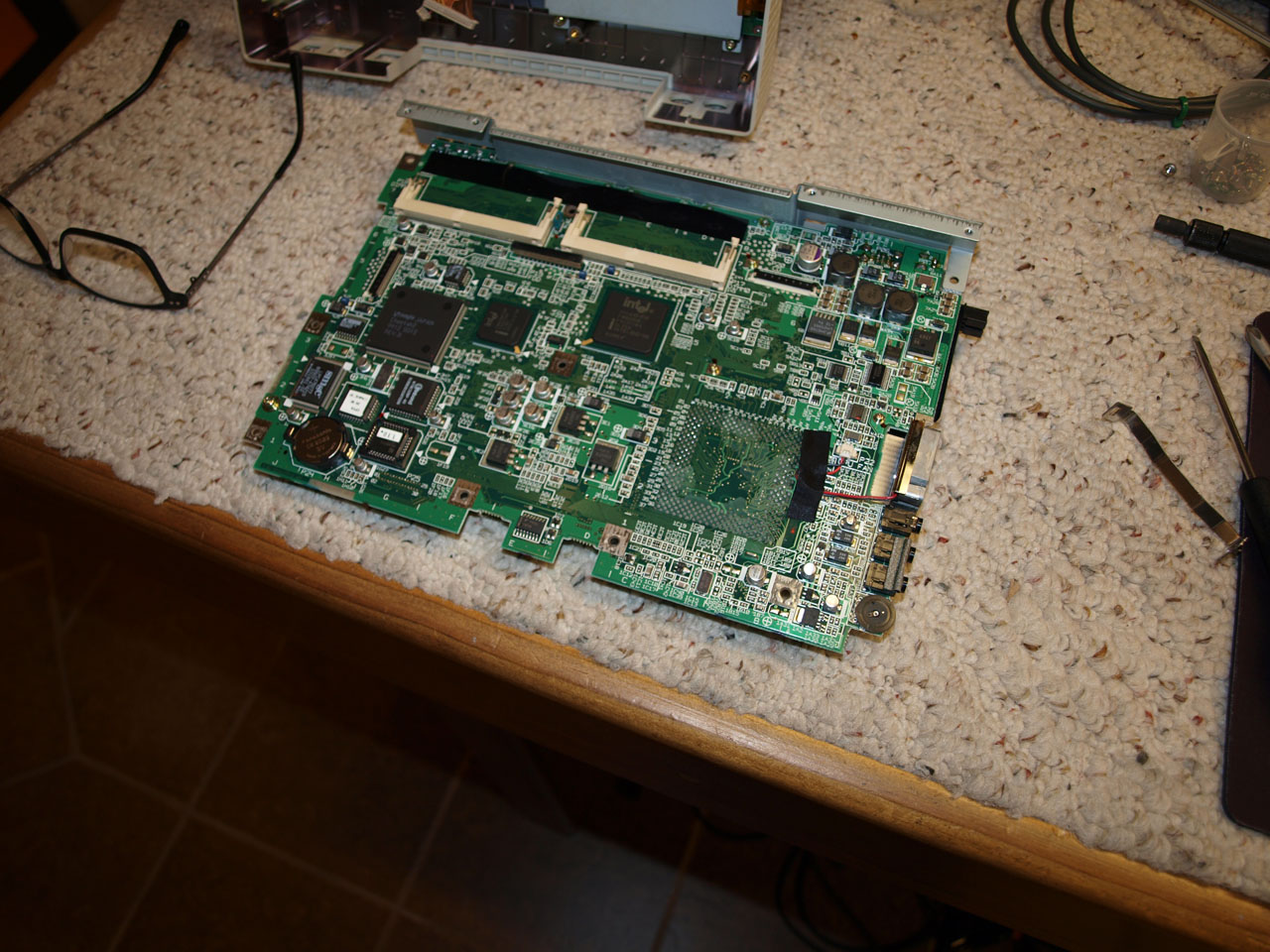

            ...so lets see what else I can do with this....the first task was of course replacing the dead CMOS battery...
            hmmm...now for the CPU... The chipset (Intel i810) *should* support coppermines, but it wouldn't post with one; either 100FSB or 66FSB...so Mendocino is all. It had a 433...

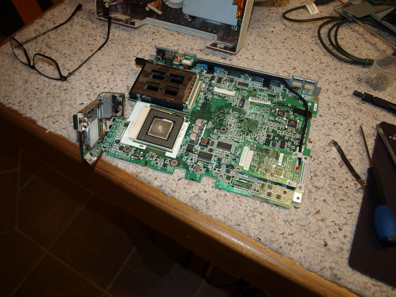

            Always a way fire an AIO out of the case.....well sometimes....but this one was easy.

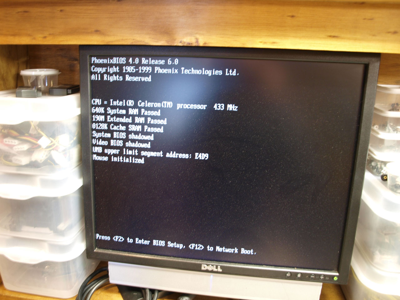

            Meh, slow 433....

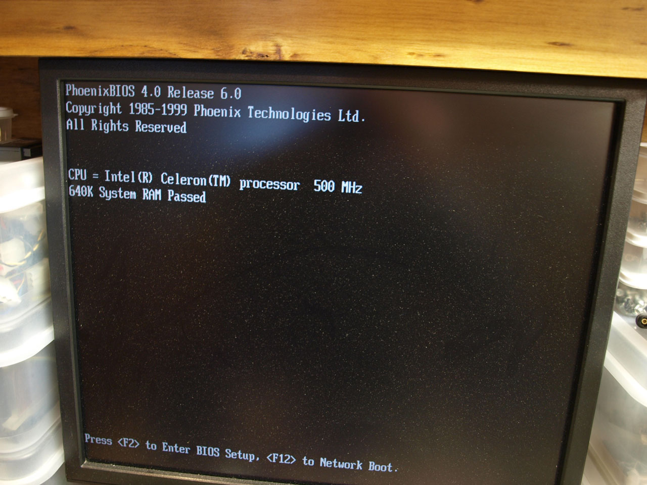

            replaced with the fastest one I had....a blistering fast Celeron 500.... 533 is the fastest it could take, but I don't have one...that's ok though, 500 is a nice round number.

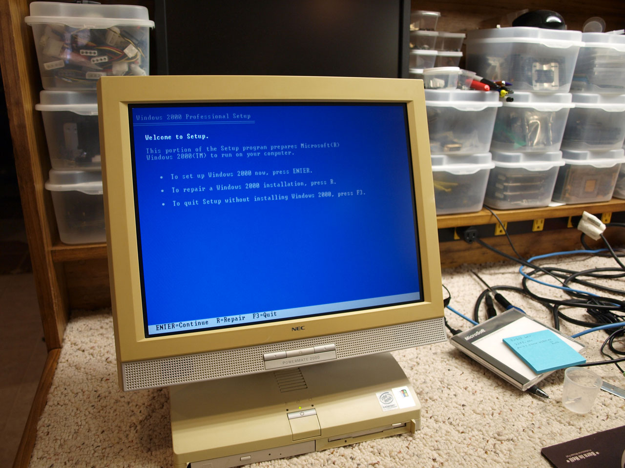

            Now to get rid of the nasty WinME....for Win2k. I thought about NT4, but working USB is nice.... Why not win98? Well that one is pretty self explanatory...
            USP 5 for W2K....

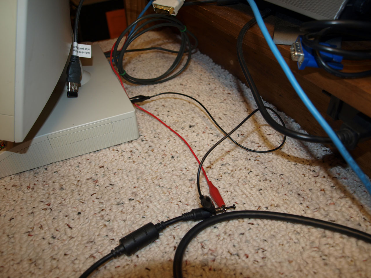

            The power brick wasnt included....but nothing unusual about the power requirements except of course the plug; just 18v @ 4.4a. Nothing a laptop supply and some jumper wires couldn't cure.
            ...and here we are....this post from it.....firefox 12.

                i810 should take "high density" memory, 2x256 HD Sodimms ought to be cheap, as the cool 440BX retro laptop guys can't use them, and the iBook G3 people probably have long upgraded to those rare but existing 512MB modules.
                (yes, I know high density means nothing, and RAM density is measured in megabits per chip, I'm talking about 256MB sticks with 4 chips per side)
                I have a personal theory that i810 and i815 were the only machines they actually tested ME on, and on those it seemed to work as good as a 9x based OS can work.
                After all, if you must run a 9x OS on such a computer, with chipset graphics and AC97 sound that had no DOS drivers to begin with ME is not a bad choice. Yes you lose the ability to boot into DOS, but in exchange you get USB that actually works (maybe not a big deal anymore since NUSB was created) and a better network stack.
                For the HDD, if the mounting position allows, you could try a random SATA laptop drive with one of those chinese JM20330 44pin IDE to SATA adapters. I've used a couple of them (no matter where you buy them from there is only one (I think) PCB design, the only difference is in the connectors, straight or angled) and they work pretty well. Considering how even the slowest SATA laptop drive is fastest than almost all IDE counterparts the speed increase is rather dramatic. At least on the "it feels snappy when using it" side of things, if not raw benchmark numbers.
                Intel pulled an Intel and the PPGA370 socket is subtly different from the FCPGA370, which again is different from FCPGA2370.
                However a PPGA socket can be easily modded to accept a FCPGA CPU.
                I've done it in the past and I can confirm it works.
                Random guide: https://krick.3feetunder.com/370mod/
                (Not my site, just a random google find. Seemed rude to tell "you can do this" without also posting "how")
                Or go mad and put in a Tualeron 1400 with a Lin-Lin adapter
                Would any of this be worth it? Absolutely not. But I think that NEC looks so neat that it might be.
