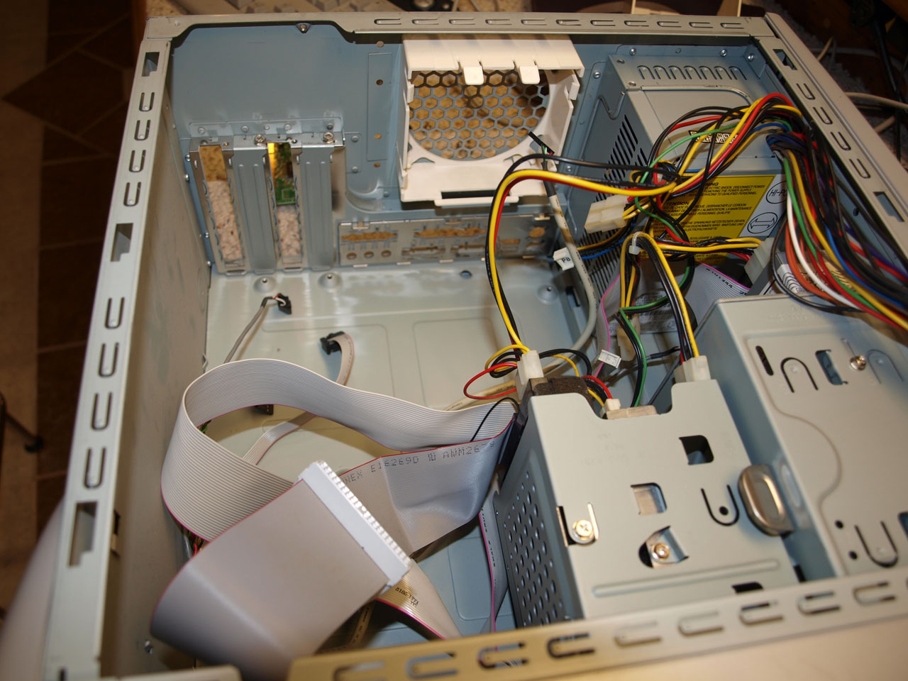

          I wasted a day on this thing.... Someone paid out the wazoo for this, it has the max specs available for it; P3 @ 850/100 (doesn't support 133FSB) and 512mb RAM; Intel i810 chipset.

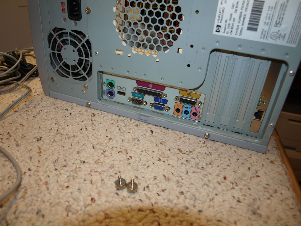

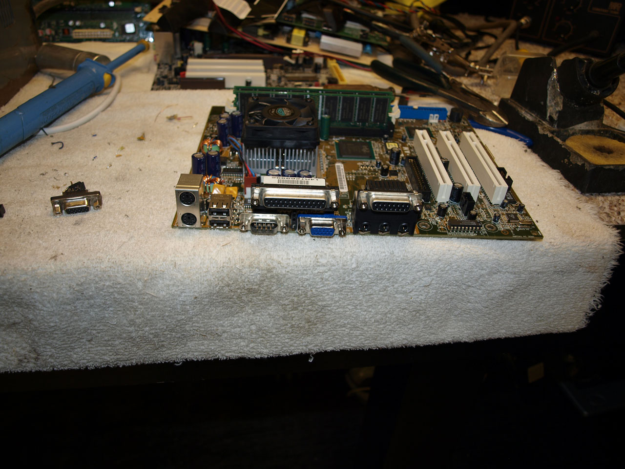

          I did have to make a few repairs.... Someone roughed up the VGA port and ripped it off the board. The PCB was not damaged, but obviously it had no display output. I tested it with a PCI card, it worked, PSU is one of those stubby's; but thankfully not the bestec...it's a Delta, and the secondary caps are all UCC KY and KZH...no need to recap it.
          Thar it be with a 128mb PCI Radeon 9200 in it. Just temporary of course....this thing was made back in the day when you couldn't disable onboard GPU's....so when the drivers load for both (even if disabled in the OS), bad things happen.... I did try....so I had to repair the onboard.
          Board out of case....

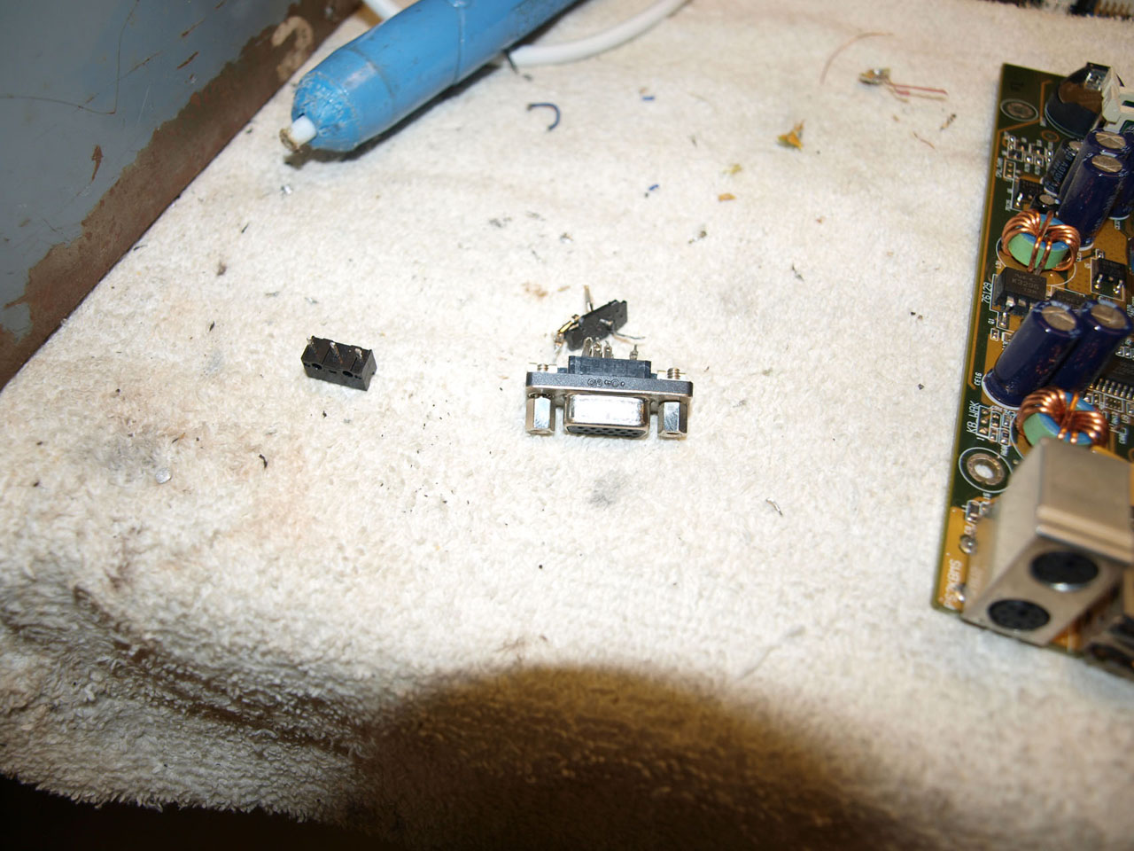

          The culprit....and while I had the iron hot, I replaced an intermittent microswitch in the original mouse (left button)....that's the old microswitch next to the trashed VGA plug.
          I scavenged a replacement from some old junk board... Yea, it was a real treat getting that in there....but I got it.
          Reinstalled.

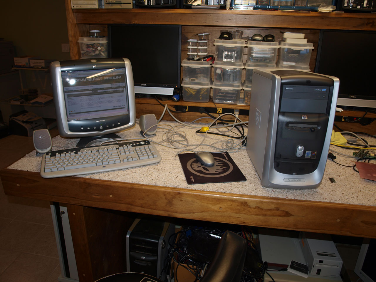

          It originally had WinME on it.....ick. Yes Uranium, I did explore the drive.... Lots of kiddie games on it and no naked ladies. I DBAN'd it and then a clean install of Win2k.
          Firefox 12 and BCN for the win!! A day wasted on this critter, but it is restored in the lowest form.....meaning I just did basic cleaning; air compressor for dust bunnies and gave everything a good wipedown with cleaners....I didn't strip & wash it.... I'll keep it all together, some day it may be some weird classic system....it's already 20yrs old, it was made in 2001.
          This post was created from it. The monitor could use some tuning up. Focus needs adjusting and the red gun is a little hot.......but I may let the next owner do that. Max resolution is 1024x768 @ 70Hz. For what it is, it did fine on BCN's antiquated forum software....I didn't try it anywhere else.
          Specs are:
          HP Pavilion XT923 (motherboard is an Asus CUW-AM)
          Pentium 3 @ 850/100
          512mb RAM
          40gb HDD
          MX50 CRT Display
          All the rest of its original hardware
            LOLz!
            Looks very similar, in terms of specs, to my HP Pavilion 8756c PC that I found many ages ago... except, mine didn't look this good even after a much more thorough cleanup... and it was just the PC box only - no monitor or other hardware with it.
            Mine mis-reports the CPU as 866 MHz @ 133 MHz FSB. But it really is running at 850 MHz and 100 MHz bus. Chipset is i810, not i815 as I reported incorrectly in that post above. Funny thing is, member Penitum4 mentioned the same thing about mine - that someone must have paid a lot for it to get it with that proccy, as he said he had a similar machine, but only with a lowly low Celeron. I found mine with 128 MB of RAM (or was it 256 MB, I can't remember), but I quickly upped that to 384 MB. I wanted to do 512 MB, but BIOS started complaining when I tried it and said something to the extent that I can't have ACPI enabled with that amount of RAM. Indeed when I tried it, XP switched to APM mode automatically and I couldn't force it to do ACPI... which meant I'd have to press the power button every time I shut down the PC, after it displayed "it is now safe to turn off your computer". I mean, who even remembers that message? It's like it turned back time to the old days of AT PSUs. Then again, it's an ASUS motherboard (MEW-AM... which I suppose is a sibling or close cousin of the CUW-AM), and the HP-ASUS partnership has always produced weird, locked-down, and buggy BIOSes. I also could not get the HDD on my system to run at anything higher than UDMA Mode 2 (ATA 33 MB/s), despite the HDD supporting much higher.
            So overall, mine is a HP piece of garbage... though a well-built HP piece of garbage. I used it from ~2009-ish to 2012 or thereabouts as a main PC (of sorts.) Don't even know why I keep it anymore.
            https://www.badcaps.net/forum/attach...1&d=1632260019
            Oh fun! I had to do that on a MSI MS-7184 motherboard:
            https://www.badcaps.net/forum/attach...1&d=1499310663
            ^ Note the VGA port sticking out. I ended up repairing the original one, though, as I didn't have any such spare "compact" VGA port on any junk hardware. Still holds fine, despite using a ton of hot glue and a piece of paper clip soldered to the ground plane behind it to keep it in place. Sounds ghetto (and it is), but it doesn't look like it at all, unless you really take a peek in there.
            Yeah, that's the one nice thing about these older HP and Dell PCs - they regularly came with well-built PSUs and Japanese caps inside. The only thing you have to watch out for is if the 5VSB uses a critical cap, and that critical cap is a non-Japanese brand (the small caps aren't always Japanese on these PSUs... though for the most part, they are.)

            Oh, and regarding that old broken VGA port - I'm sure you save the hex nuts/bolts from it... but if not, it's always handy to have a few of those as spare. Almost half of the used video cards I've bought (be it eBay or Craigslist) always seem to miss one or two (in some cases, the entire bracket! )
            Cool!
            And you even got the original speakers!
            TBH, it's kind of rare to find a complete retro system like that anymore.
            20 years is also nothing for those machines. I reckon they'd do another 10-15 easily. Good save!
                There was no fixing this one, it got tweaked bad. The AFT-most line of pins were torn in half.
                You know better than to ask that!

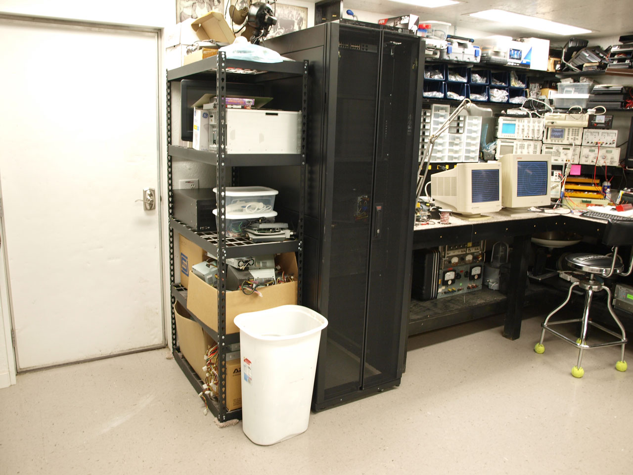

                  Today was CRT monitor testing day.......they all worked, Momaka can breathe a sigh of relief!
                  ....and the big rack and some new toys under the bench to fit in it...

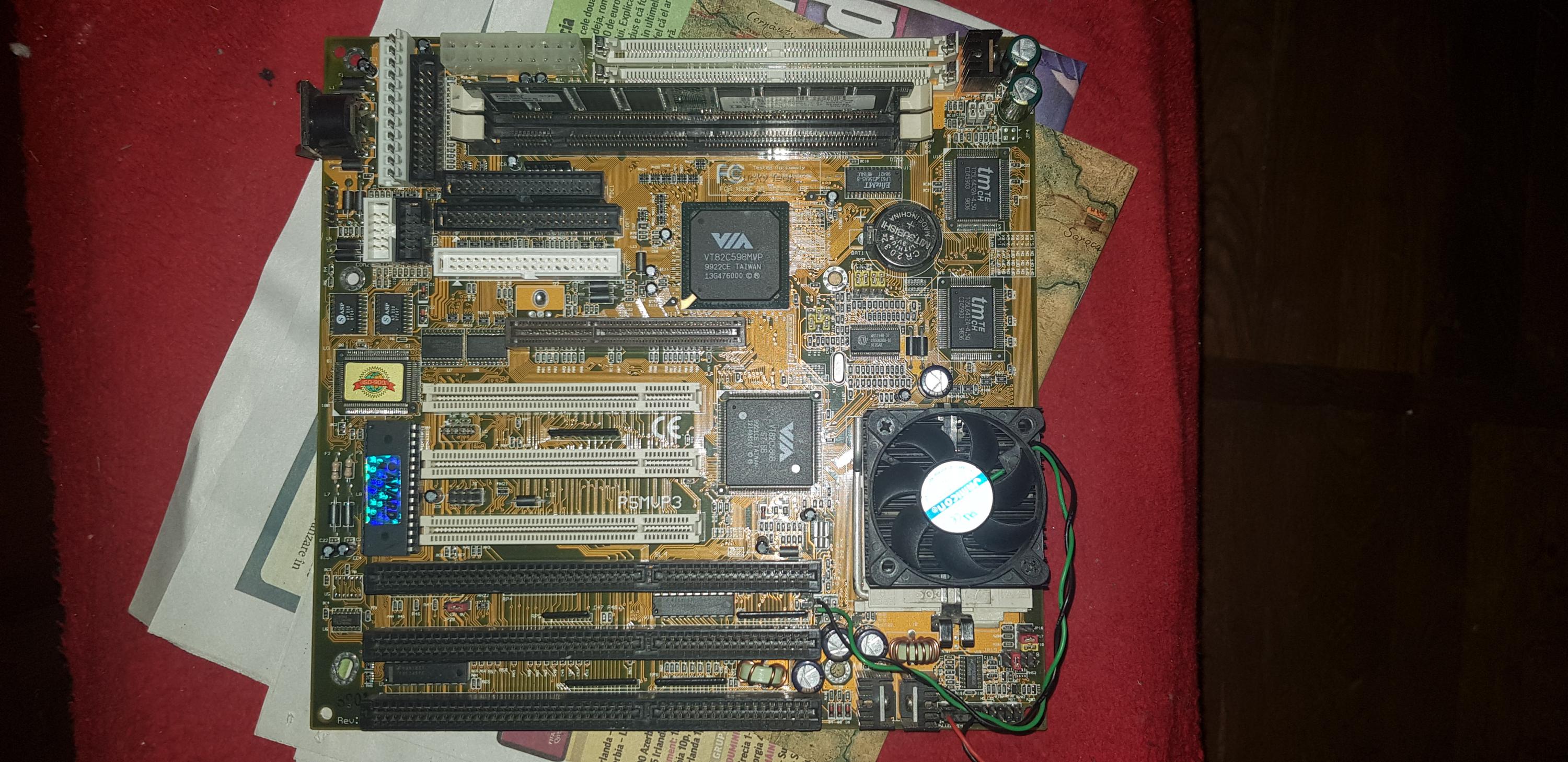

                    Another freebie from a friend.
                    Another LuckyTech P5MVP3 (this time with a working IDE controller) with a K6-2+. Was surprised to find it there, and laughed when I saw that whatever retailer sold the CPU, they sold it as a regular K6-2 500, and not a K6-2+ at the same speed. It's been recapped as soon as I got it. Whatever DIMMs it ran, that KV1083 regulator near the EDO slots got so hot I had to replace it, and also replaced the puny Jackon 1000uF 10v caps with a pair of Sanyo 1800uF 16v just so I don't kill the new regulator. Also replaced the Canicon (no, you can't) 1500uF 6.3v caps that they used on the CPU side with Rubycon MBZ of the same size. POSTs fine over ATX, couldn't run it on AT, at least not with that craptacular L&C LC-200C I have.
