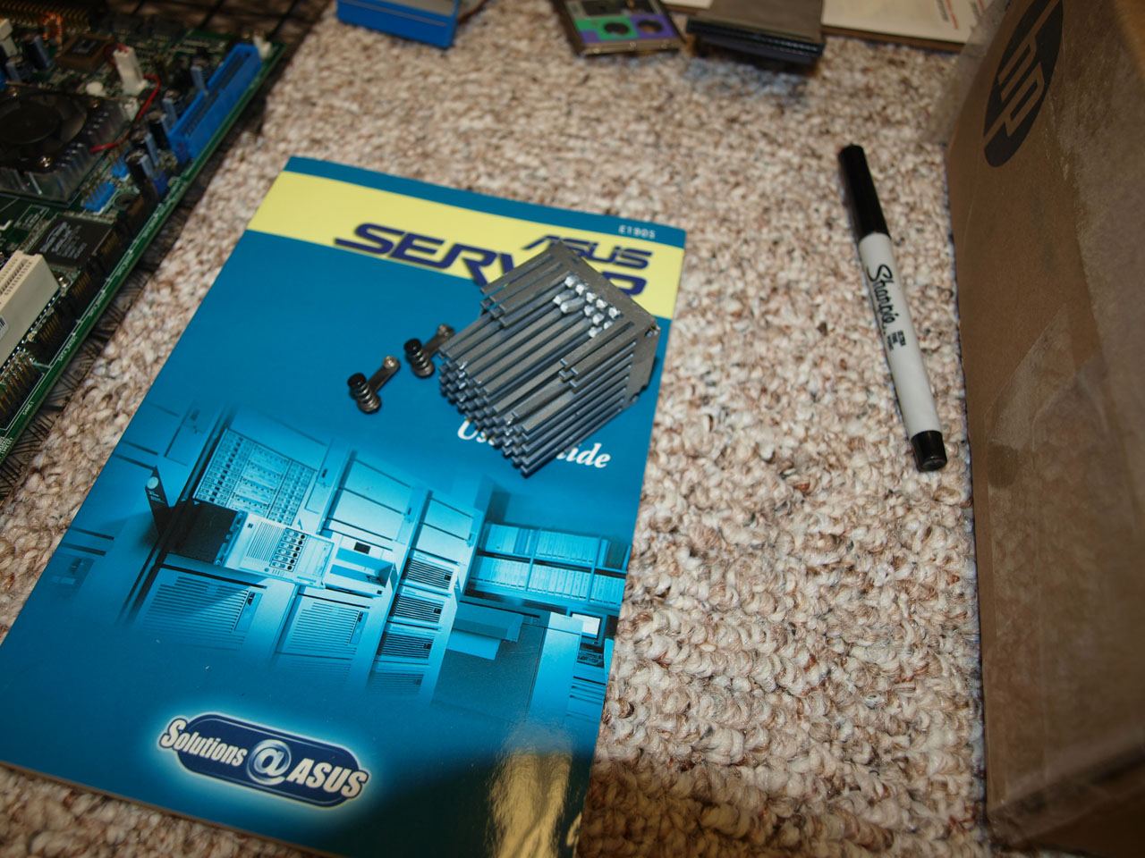

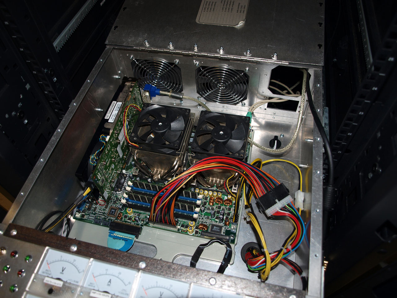

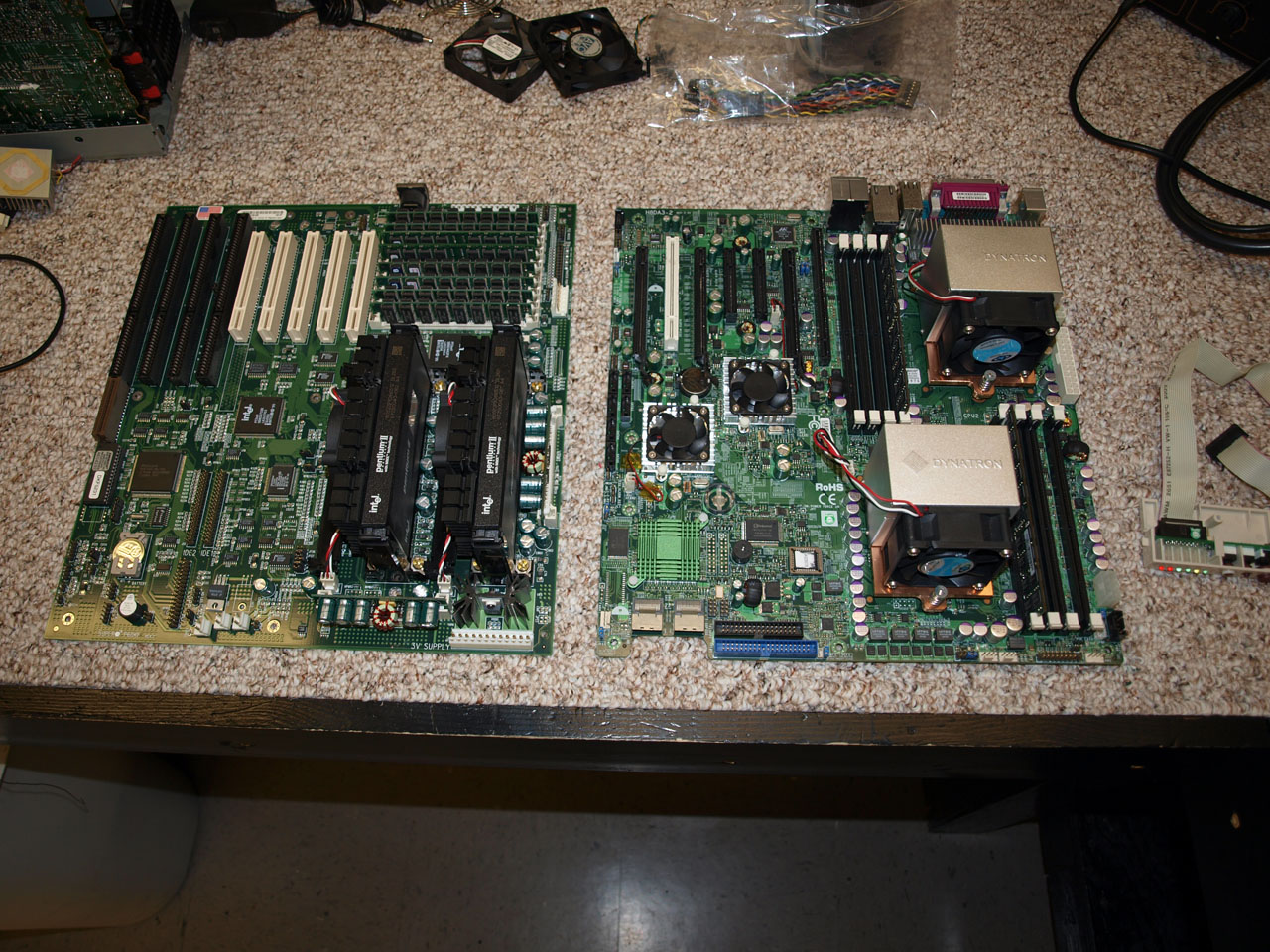

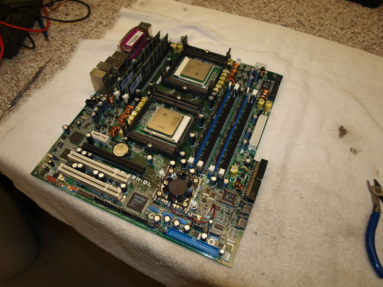

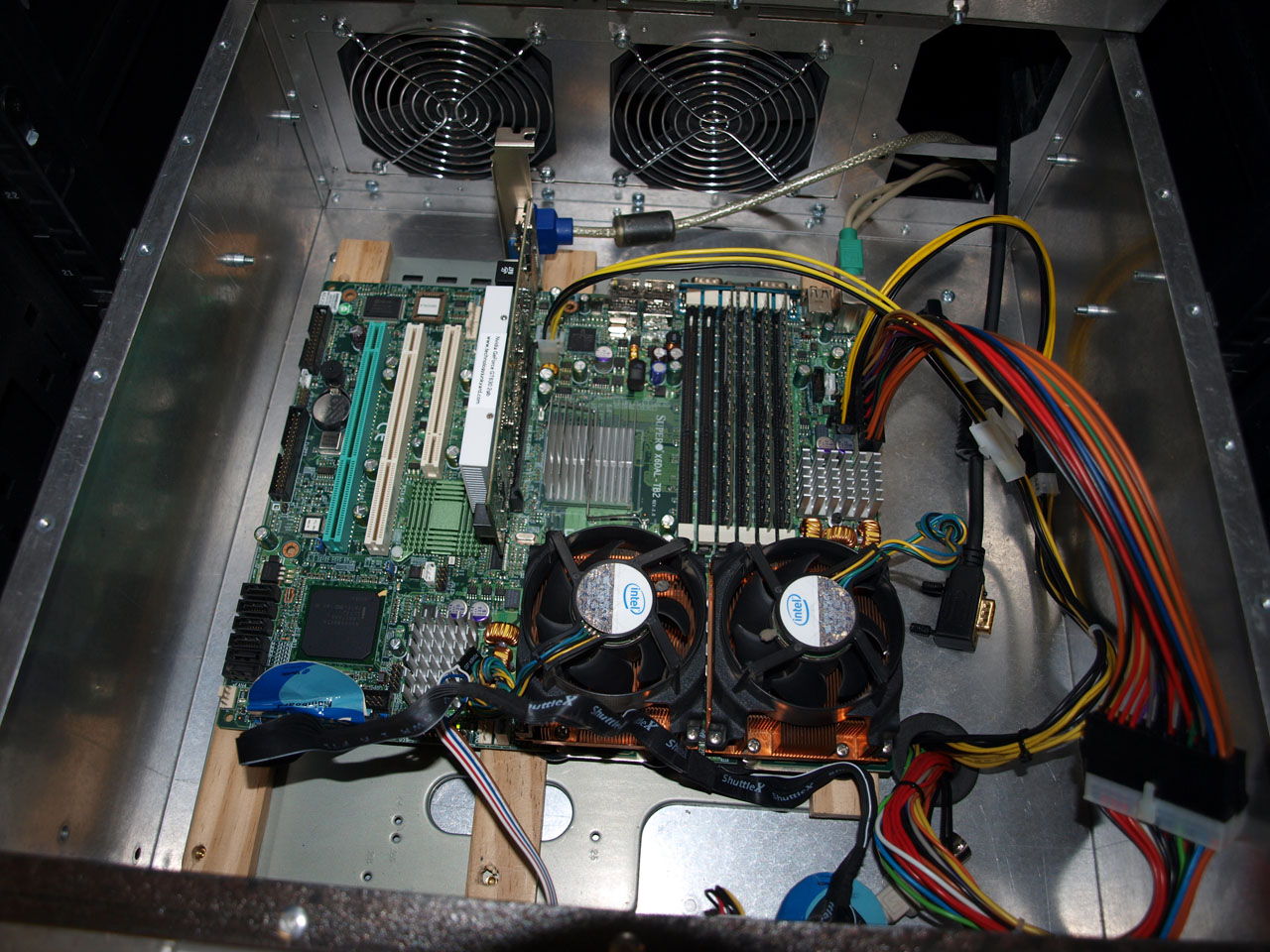

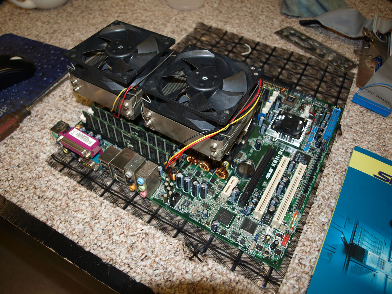

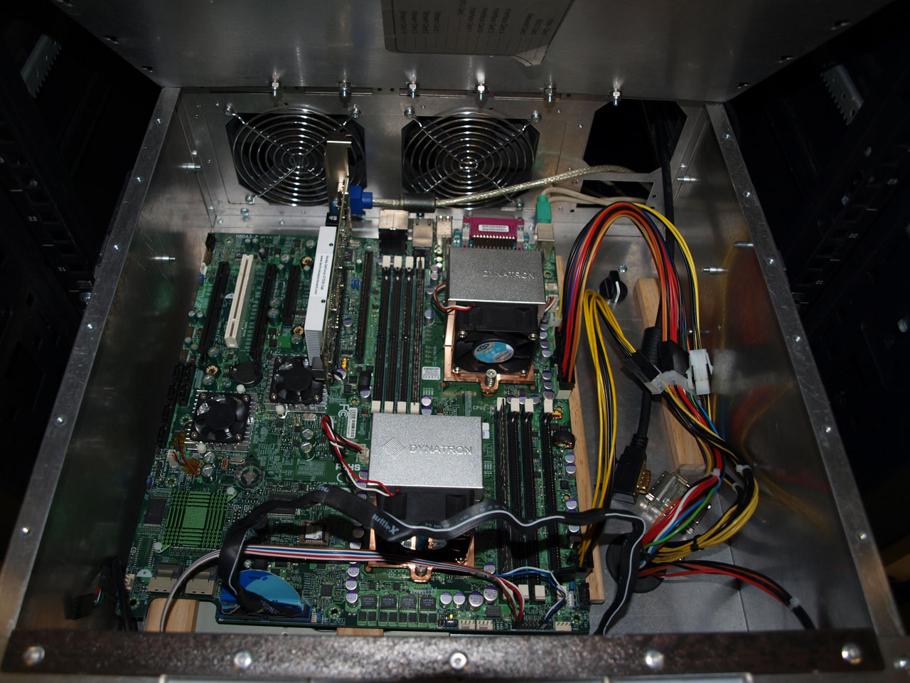

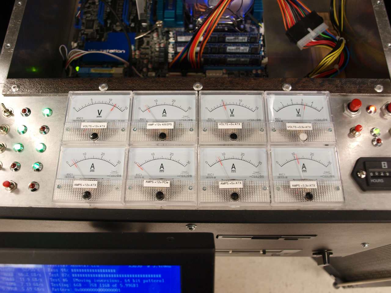

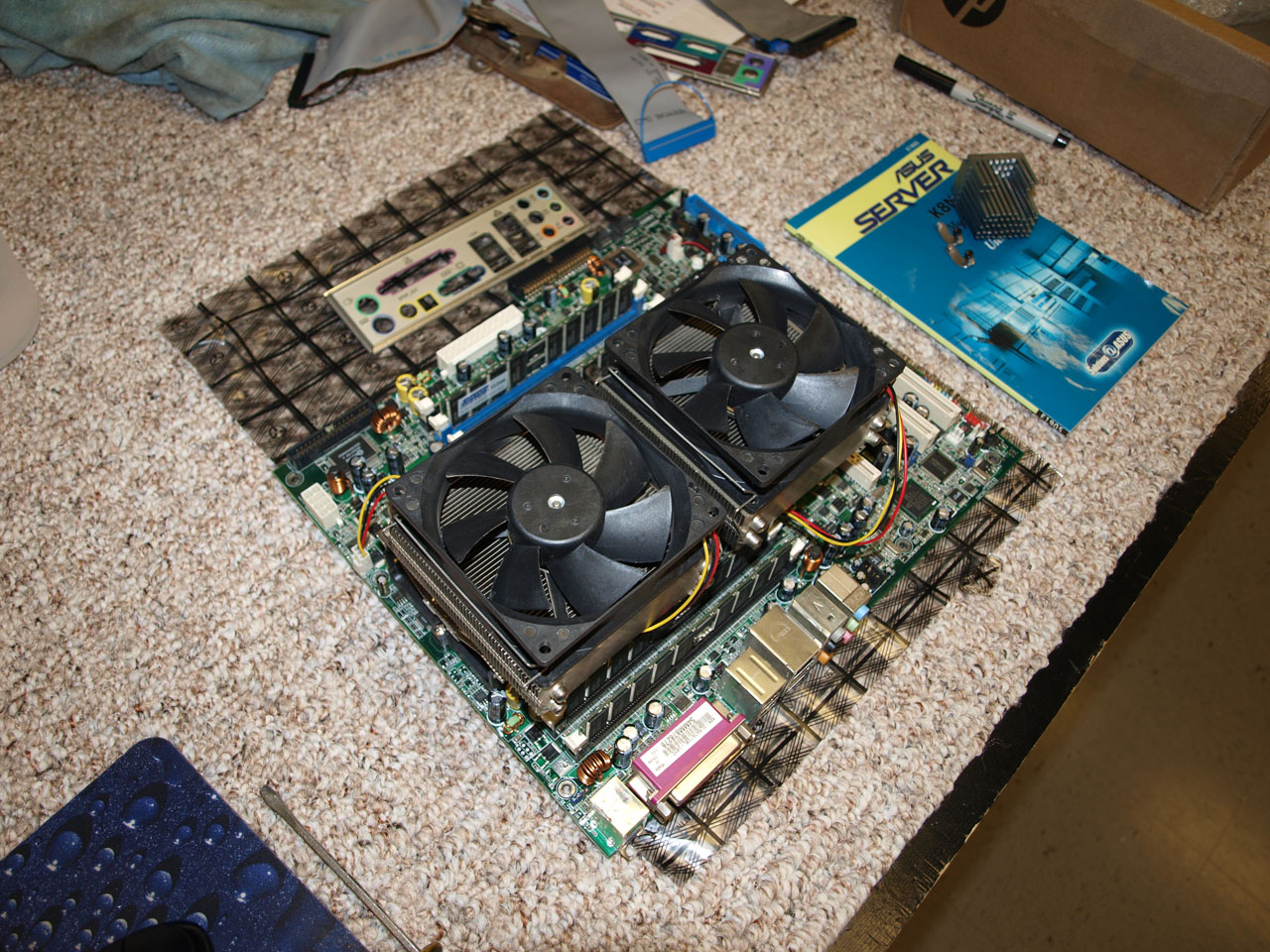

        Ok, now here's where it gets fun (atleast for today) and testing your theory of PSU matching. That was an absolutely brilliant idea....here's a great example of hardware from an era of transitional between 5V heavy and 12V heavy....but having the +12V EPS connector, I'd guess and say 12V heavy. I rescued this on ebay; I didn't buy it with any specific build or plans in mind for it other than maybe some kind of weird retro gamer at some point....it was just cheap, and a bit of a rare / unusual board.... It came with CPU's, RAM, and Heatsinks. Bad caps of course and the chipset heatsink had some oddball cobbled on it....odds are the original fan had failed and the owner rigged it up.....

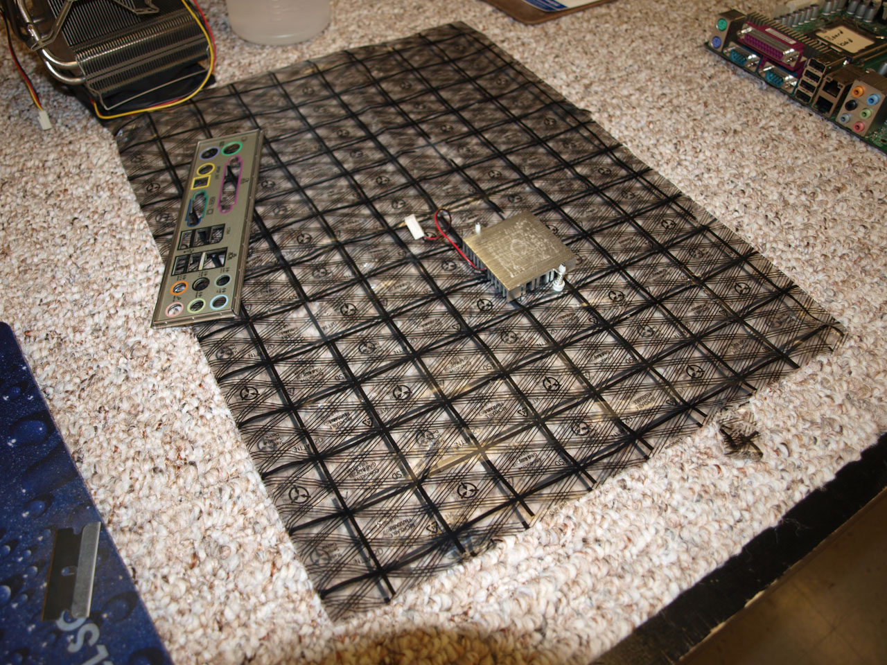

        Asus K8N-DL. I already removed the goofy heatsink from the chipset. Still needed to be recapped.
        The replacement heatsink / fan I robbed off a bad Supermicro SKT-F board I had.
        Recapped and the HSF was a perfect fit!! Low profile, so a GPU won't interfere with it. Nice ball bearing fan.
        The 'rigged' heatsink that was on it when I got it.....
        ...and ready to be tested...
        In 'the oven'....
        So far so good!

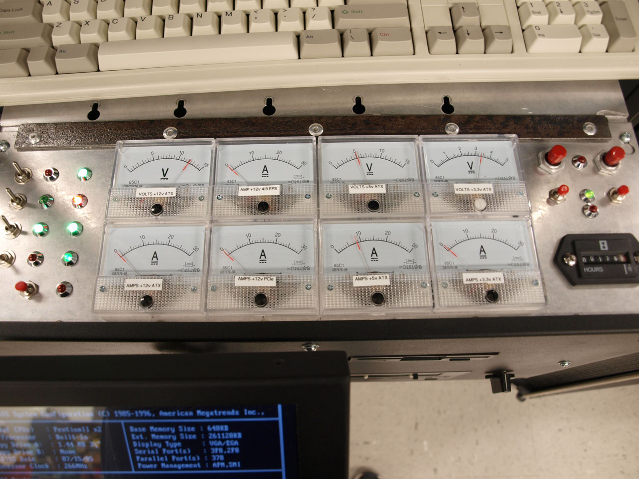

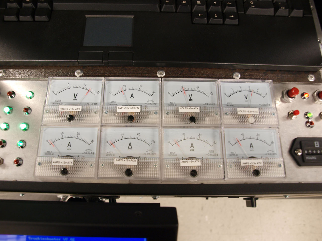

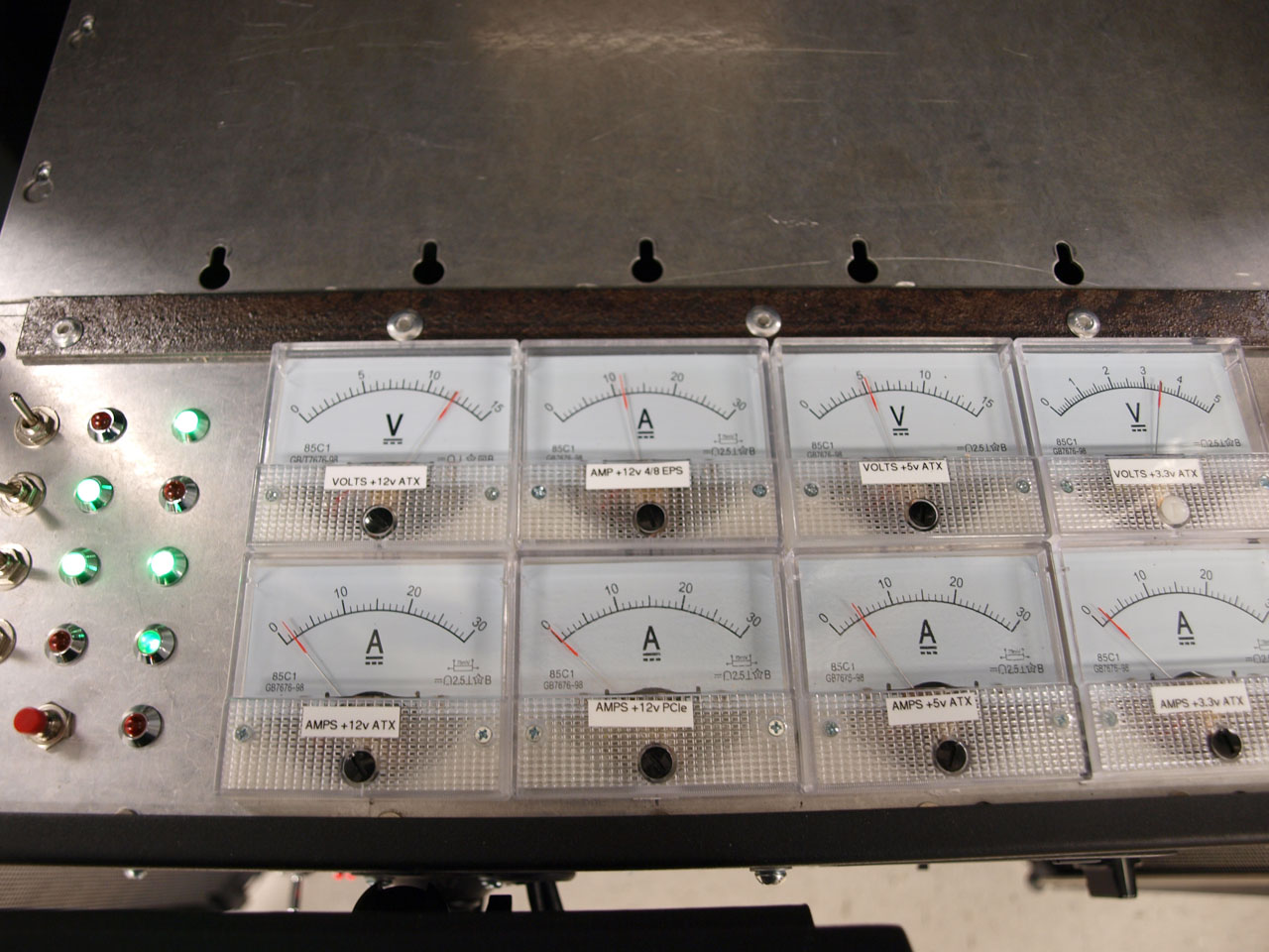

        Sitting idle pulling 8A off the 12 EPS rail and ~4A off the 5V rail and 5A off the 3.3V rail.
        Testing utilities had it yanking 10~12A off the +12V EPS rail, 5~8A off the 5V rail. The 3.3V rail stays steady @ 5A. The 9800GT held steady @ ~3A, as I didn't do anything that taxed it.
        While I'm not done diddling with this one yet, the takeaway is it's a 12V heavy board, but it did tug its share off the 5V rail as well...this board is from 2005....but the point being, watching the loads across various rails is a great way to pair it with a PSU and it's ratings per rail. Some boards it's hard to tell and it's a bit of trial & error. This idea took the guesswork out of it. So put this down as contribution # 2 for this project for you!

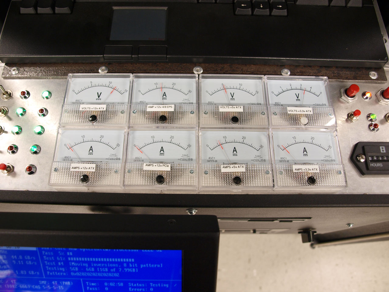

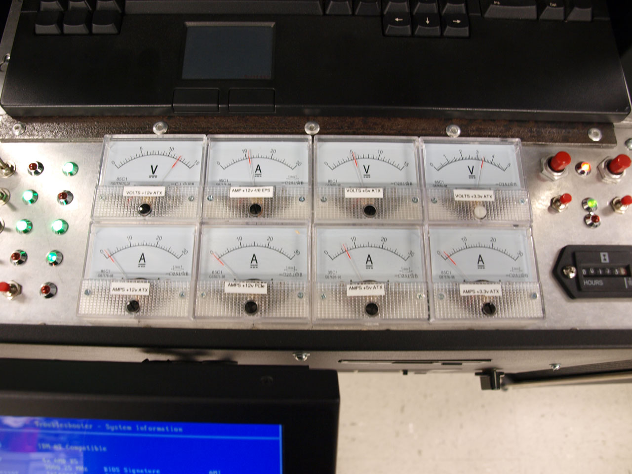

          Originally posted by Topcat
          ………> this board is from 2005....but the point being, watching the loads across various rails is a great way to pair it with a PSU and its ratings per rail. Some boards it's hard to tell and it's a bit of trial & error. This idea took the guesswork out of it. So put this down as contribution # 2 for this project for you!

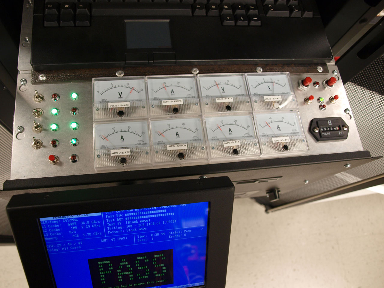

          I like the fact that you see what every power supply rail is doing in real time
          To me this is a real plus for your project or it would be for me
          I have a question for you about what would be a good switching power supply would be good to test the majority of motherboards as a general rule for the sake of argument
            For the TPU, I simply stuck with the PSU that came with the Dolby unit. It's an EMAC's 550W redundant. These units are always under-rated, as they are made to 'sprint' at full load while running on ONE module; load balanced in the backplane...so they're capable of sustaining at least 1.5x their rated load. I stuck with it not only because of it's power ratings, but it fit the case (made one thing about this project easy). To answer your question though, this PSU is heavy on all key test rails (+12V, +5v, and +3.3V); every rail is 30A or greater. ...and these units are very high build quality. Another factor; which plays into the 'it fits the case' category....If a module actually fails, it can be ejected and repaired/replaced from the outside, I don't have to completely disassemble the unit; cutting wires ETC to fix it. If the IPU failed OTOH, that would be a real pain, but nowhere near the disaster it would be to have to replace the TPU; with all the connections to the shunts. I did recap the IPU, and it's not under much load at all....the odds of its failure would/could/should be slim (knock on wood).

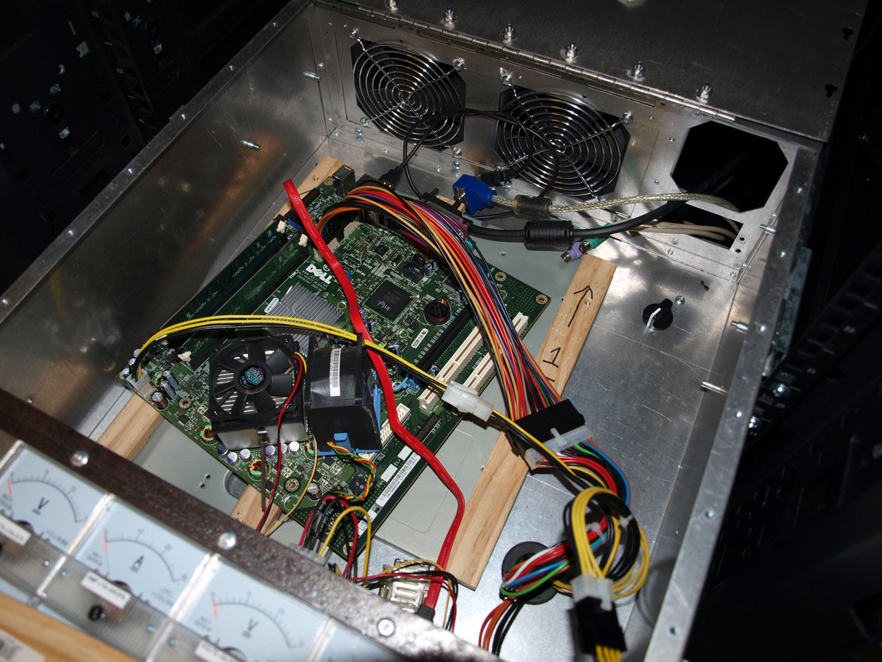

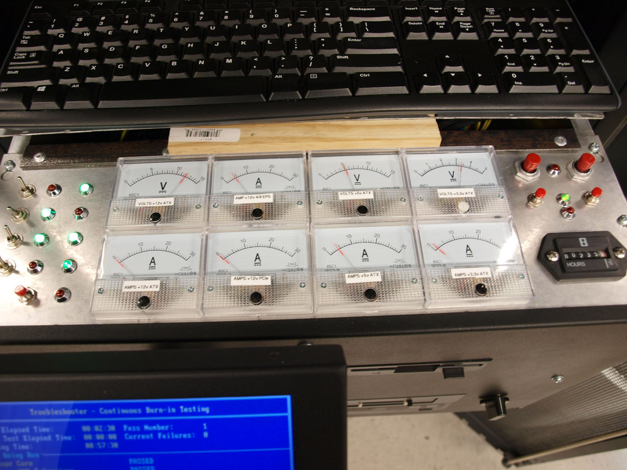

              There is only one function that has not been formally tested yet....and that's the AT motherboard using the override. I'm positive that AT board testing will prove to function just fine, but it does need to be properly tested & verified. The override has been used several times; it is handy for testing an ATX motherboard that will not power up when the PWR soft-on is triggered. When this happens, trip the override switch, which will power up the board. It won't POST, but you can measure things with it running. In testing (the original SKT-A board), tripping the override, it would actually POST & run...
              Anyway, no AT board has been tested in this yet; as I have no AT boards around that aren't in use that I know work. I looked for just the right board...a unique tester and something I can do a retro build with later....and I found one! A Supermicro P6DKF FULL AT dual slot-1. Found it cheap. This is the full AT, not a baby AT. After buying, it dawned on me that it may not even fit in the 'oven'....but I do have a case that can take one of these. This board is circa 1997; FX chipset, supporting only 2.8v P2's (Klamath core). It comes with a pair of 266's, but I happen to have a known good pair of 300's here....that is the fastest this board could take, as the 333 is a Deschutes. This will be the final test for the motherboard tester!
              The 'oven' as this has been so nicknamed has been used pretty much daily since being installed in the rack; for my stuff a little and quite a bit of customer recapped stuff.

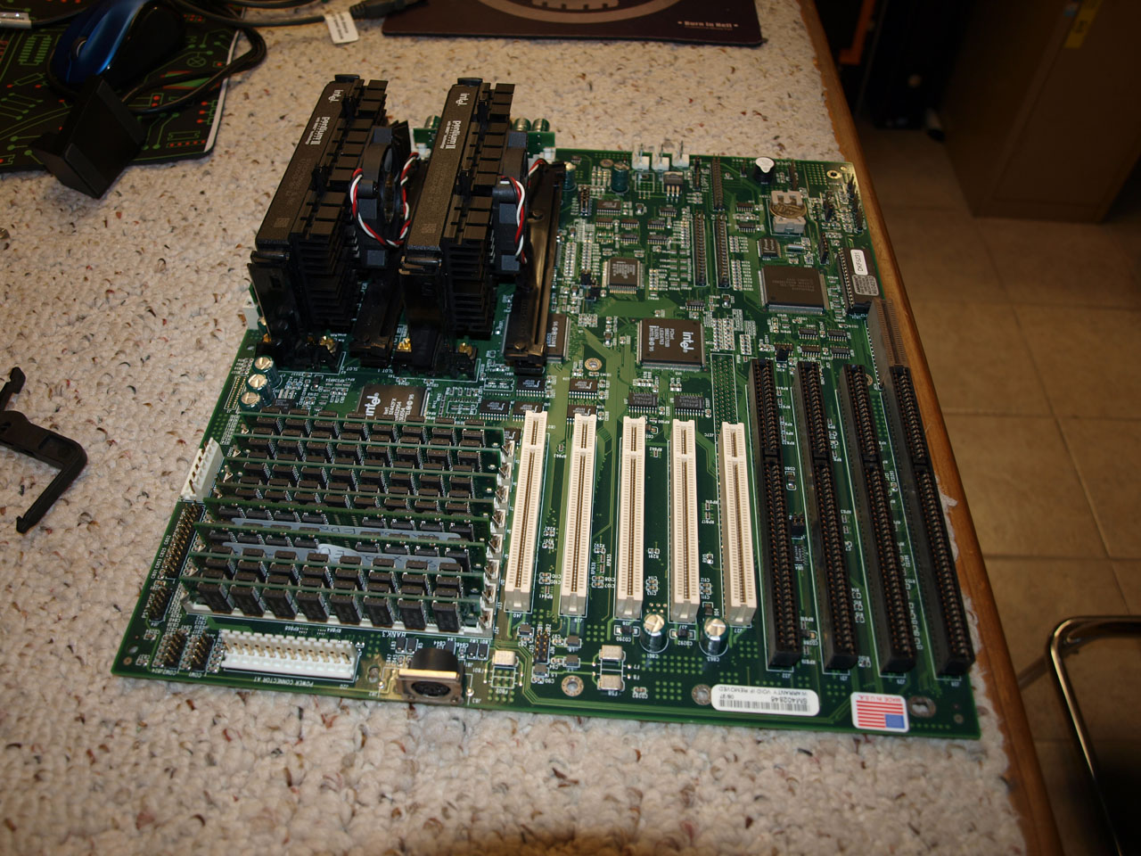

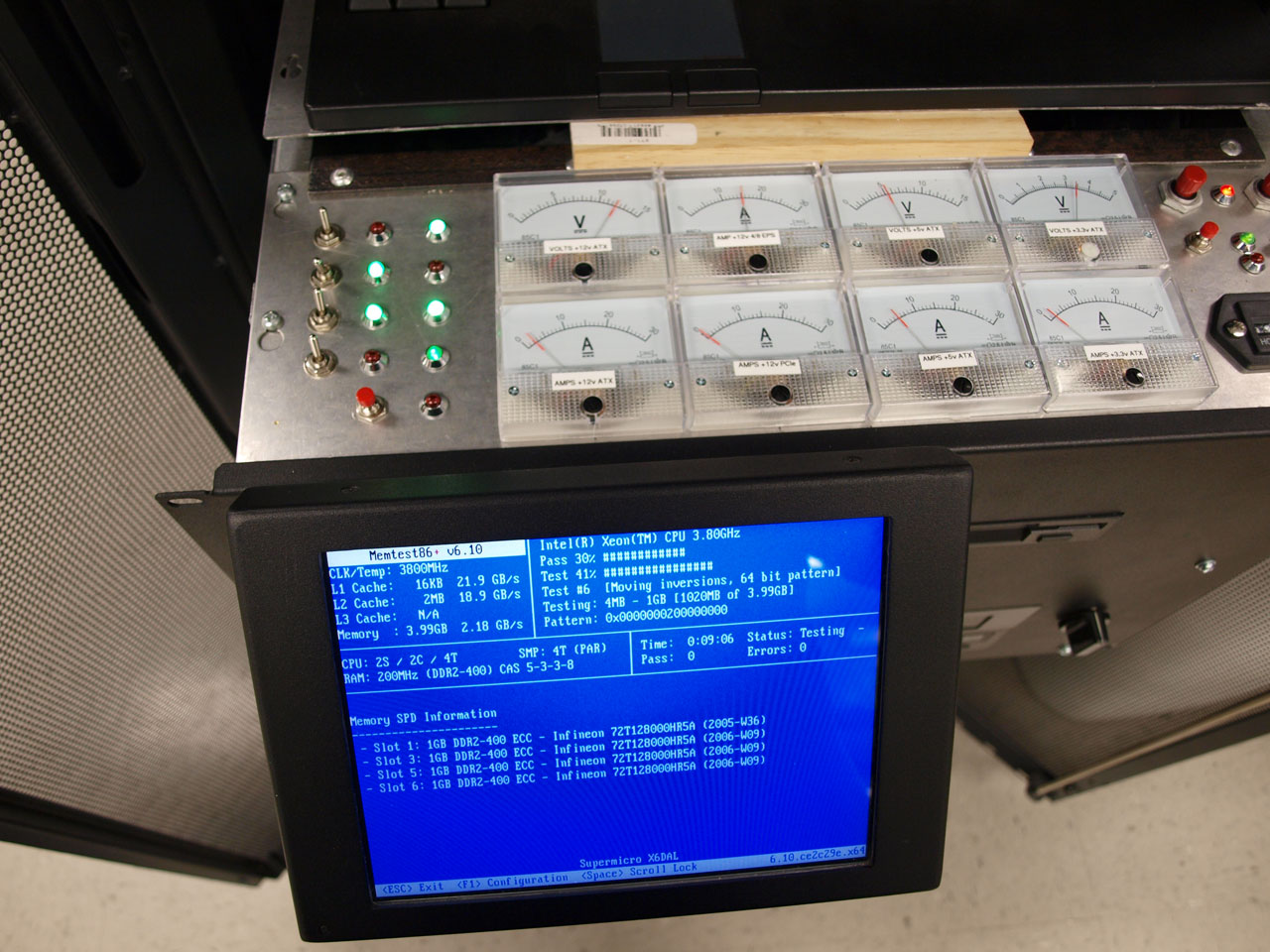

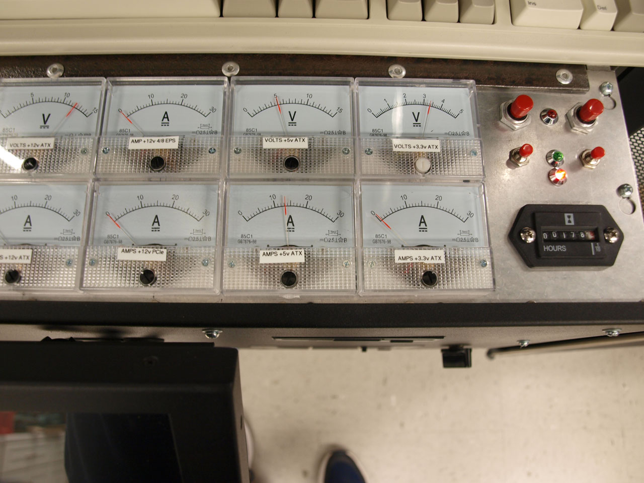

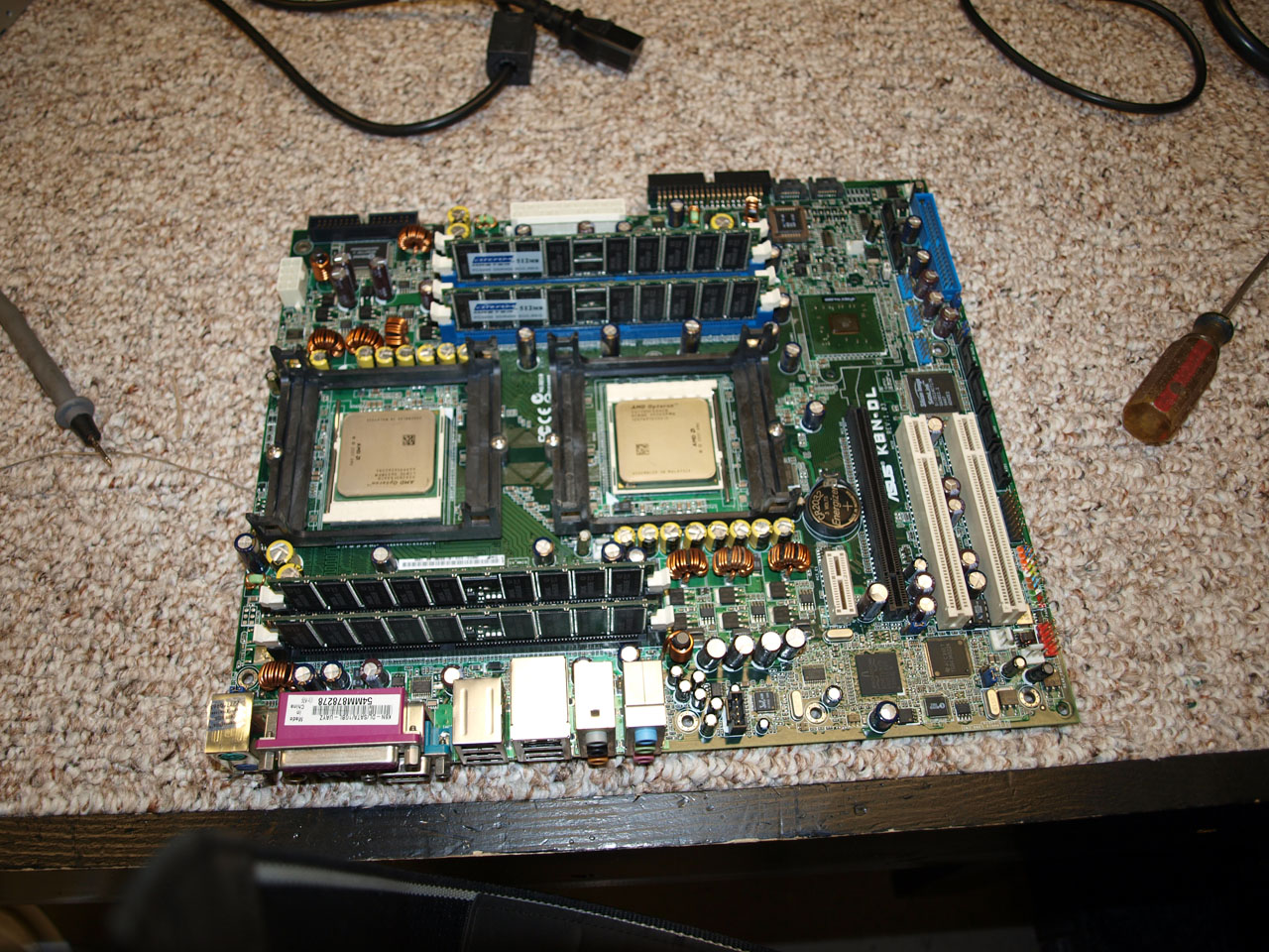

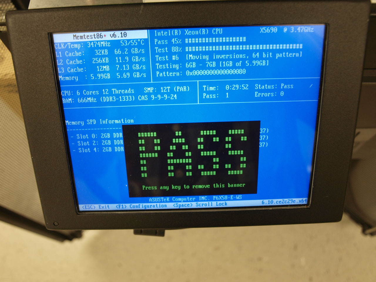

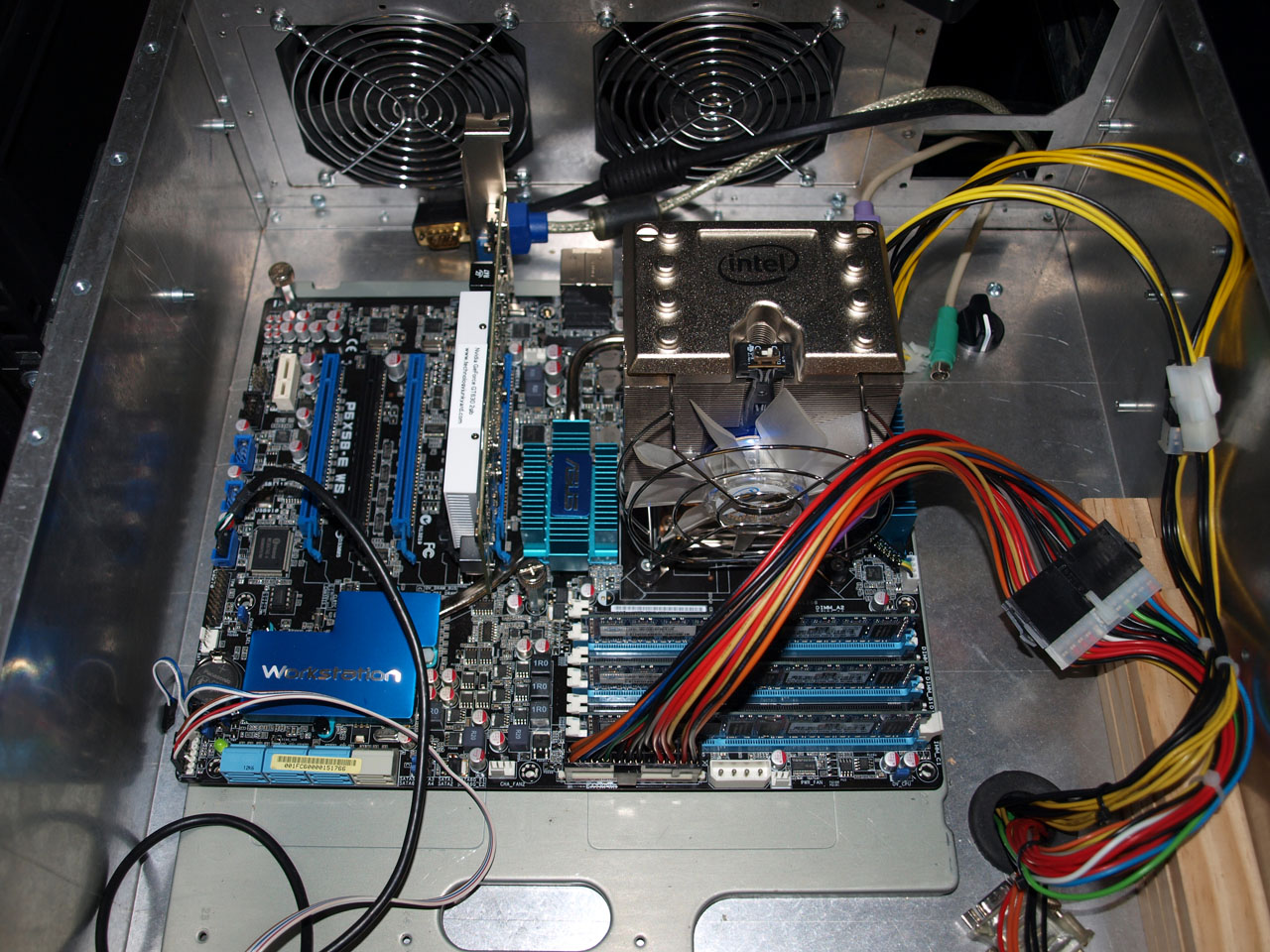

                Here was a real power sucker random test subject; another cheap ebay rescue I bought ages ago, mainly for the Dynatron coolers on the CPU's...I paid less for the entire combo than the normal price of one of those dynatron heatsinks. This is another AMD system; dual skt-f w/ 2x Opteron 2222 SE's @ 3GHz...
                Sitting idle....
                Running memtest...there were a couple tests where the EPS 12V rail broke 15A!
                These CPU's are only the dual core santa rosa's....I envision the quad or hex shanghai's being even greedier. Only 2 memory modules as well. Apparently the 2393/8393's are impossible to find now....I already have 2 pairs of them in other builds....but I'm not taking either of those apart.... I remember buying 4 of the 8393's a few years ago (fastest quadcore shanghai), and they were crazy cheap!! Now, they're nowhere to be found! Weird, didn't think there's really be much demand for them...so I guess this board won't get any 2392's or 8393's.

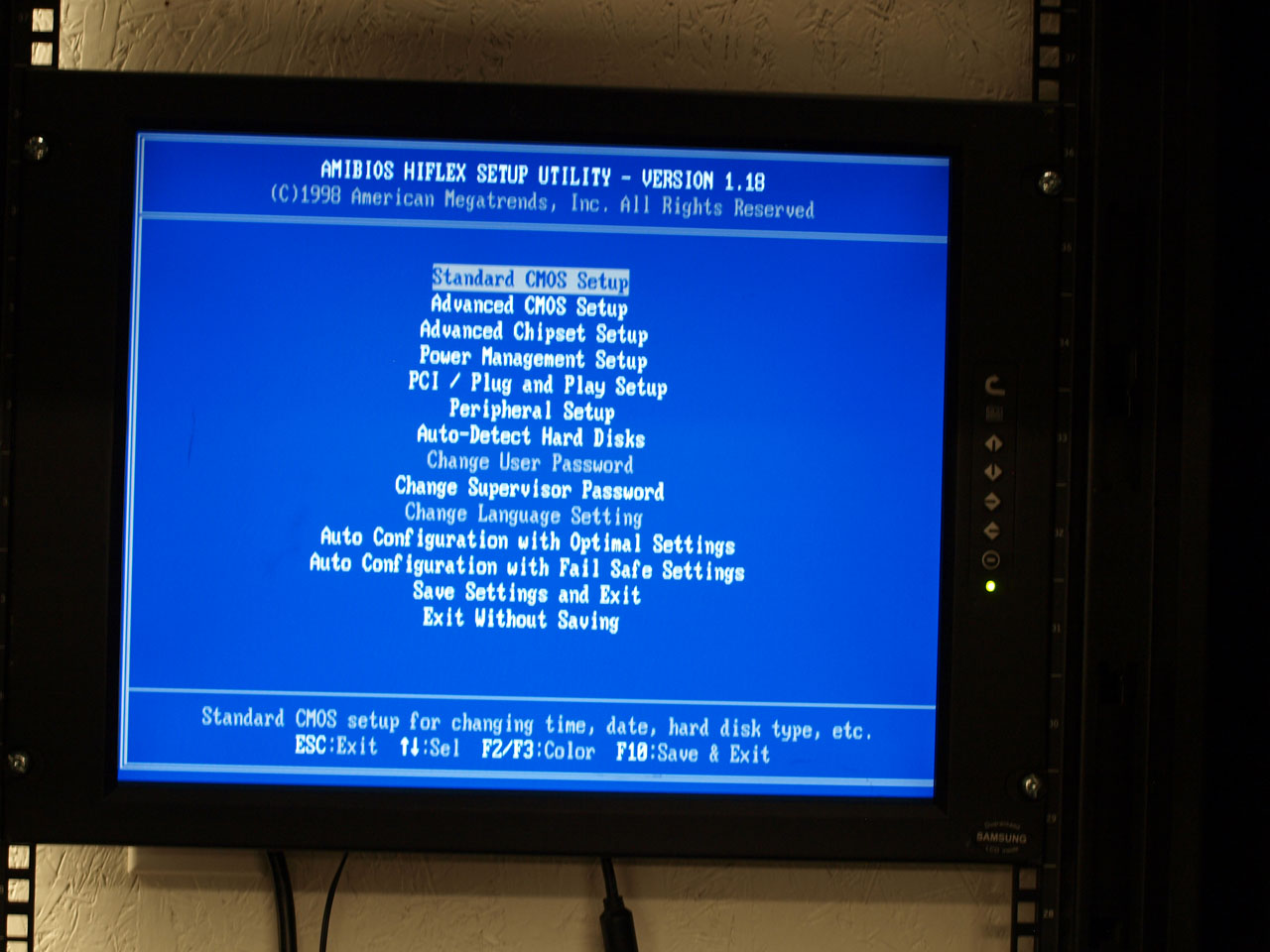

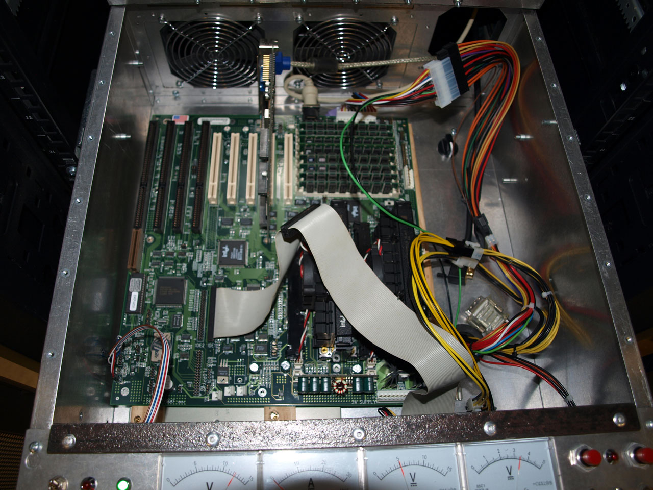

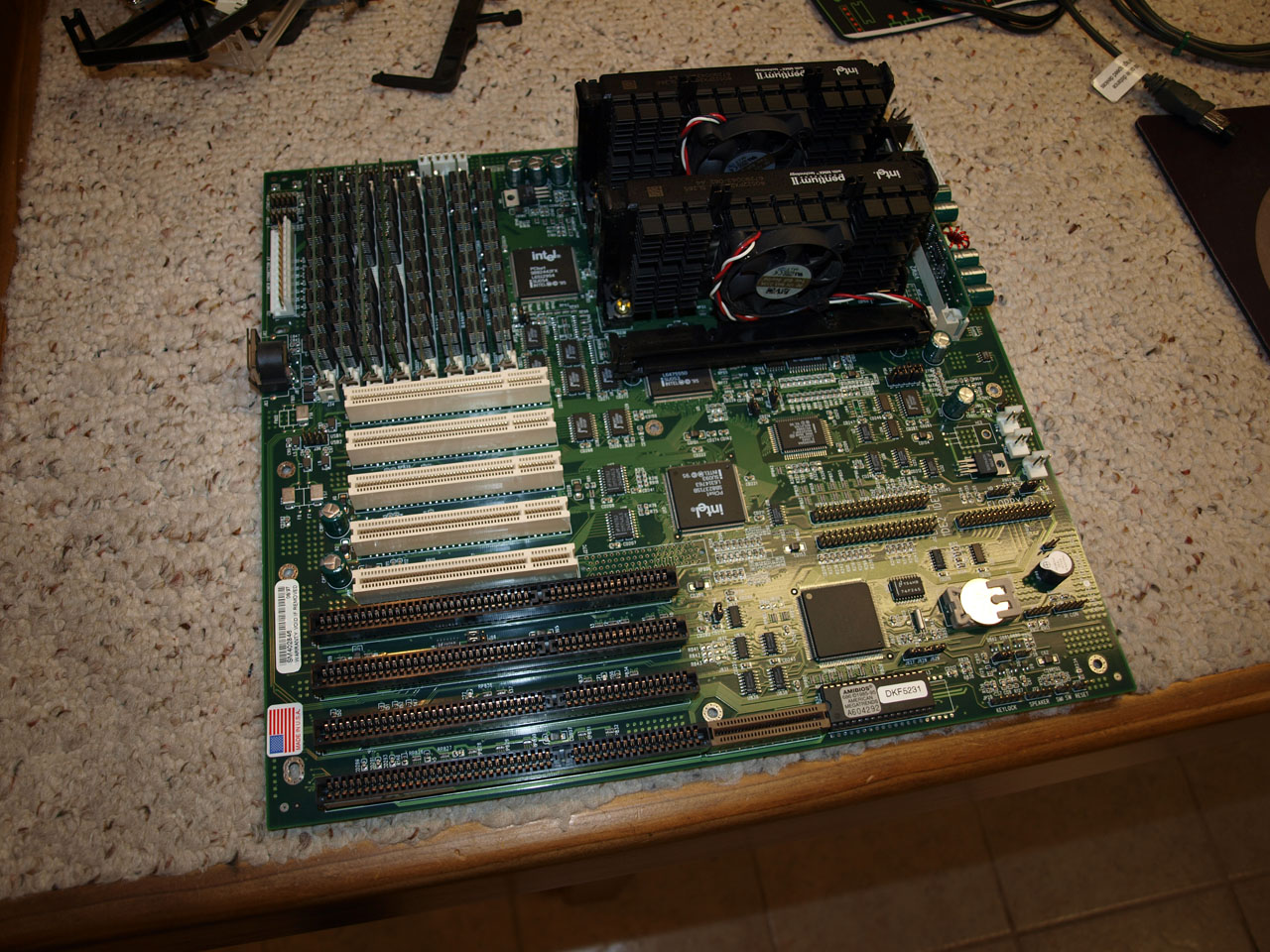

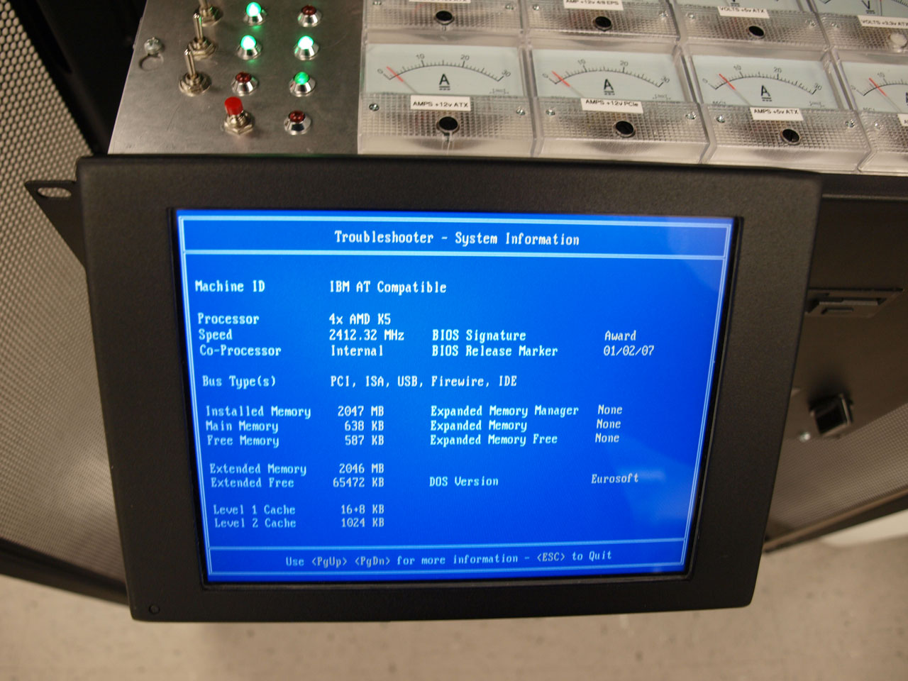

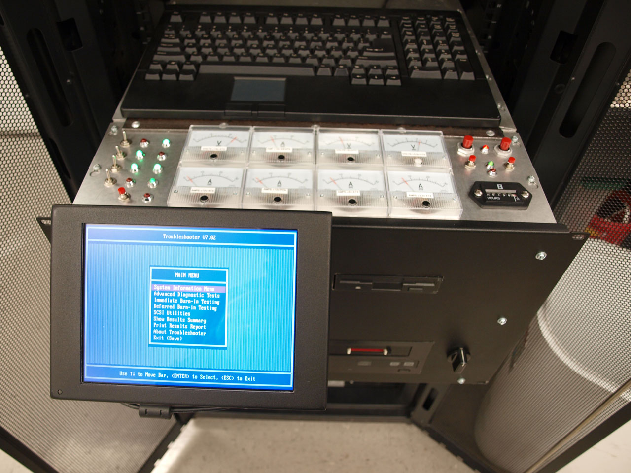

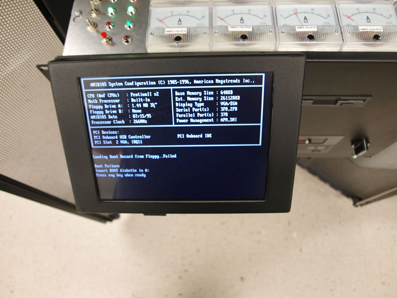

                  ...and the final test for this project... I won't say perfect, as a clearance issue came up with a full AT size board. This would not be an issue with a baby AT (what pretty much all AT boards are).
                  By rule, an 'AT' board is AKA a 'FULL AT'. The more common ones were 'baby at'; but just became known as 'AT', even though that was a bit of a misconception. Anyway, an 'AT' (or full AT if you still prefer) is the physical size of an eATX, but there's no such thing as an eAT or Extended AT....so that'll conclude our lesson of the AT form factor....and onto this big ass board!!
                  Sitting next to an eATX.

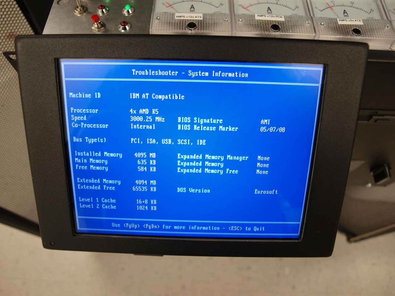

                  It POST's! I had already tested the override...but now it's been officially tested in this format; testing an AT board....which was the original intent of the override.
                  +5v draw at idle. This board draws from the +5V rail only.
                  Now here's where the clearance issue came into play. Being AT, it uses an AT keyboard. I tried to use the PS2 keyboard with an adapter....but that was too long and the board was hitting the front IDE & floppy utility housings and not clearing the fan grilles in the rear, so I simply had to use a real AT keyboard....and even then it was a close shave! This would not be an issue with a baby AT, as it would be shorter and narrower, allowing clearance with the adapter by a couple inches easily.
                  This was also the first time I used the floppy function of the machine, worked without a hitch. I had to update the BIOS; as it was running v1.0.....I'm sure that couldn't be good. Supermicro still had the BIOS for this in their archive; version 1.8d.

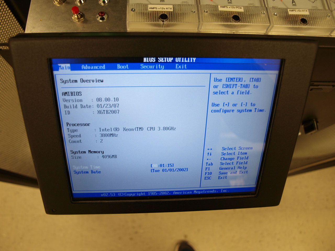

                  Completely changed the BIOS interface from the old AMI with a mouse to this....

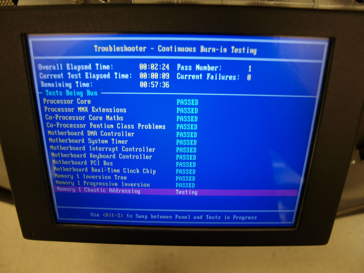

                  Running 'trohbleshooter', it started pulling a bit harder off the 5v rail. It got close to 18a a couple times.
                  I do have a beautiful heavy-iron early 90's AT case that will fit this that currently has a 486 DX4 @ 100MHz in it....I was never a 486 buff, so I'll definitely yank that for this. This is running a pair of P2 266MHz CPU's with 256mb RAM. I have a pair of 300MHz Klamath's for it, the fastest it can take..but that's for a different thread.
                  The testing phase of 'the oven' is now complete!

                    The burning question answered....how big of a power hog is a Netburst-era CPU.....
                    The test subject is a Supermicro X6DAL with 2x Irwindale single cores @ 3.8GHz
                    12A off the EPS (CPU Power) sitting completely idle (BIOS screen).
                    memtest... had it consistently @ 15~16A
                    Prime95 had it as high as 18A.....
                    ...and now you know why these can double as space heaters!!

                      If that's Netburst, I'd love to see how much power an S478 or S775 Prescott would draw.
                        Probably slightly above half that; as Prescott is pretty much the same core as Irwindale....and this test was with a dual board. I don't have a prescott that's not in use to verify that though....but my guestimate would be in the 8~10A at idle.

                            • 16958
                            #193
                            Re: The (now the death of) Dolby DP600 Build (BEYOND COOL BUT PIC HEAVY)
                            Testing a Dell GX745 that had been freshly recapped....I don't see these much anymore....but I got one for repair....and the only form-factor that hasn't been 'officially' tested in the 'oven' (besides outright proprietary); the BTX form-factor.
                            Because it's the weird BTX layout, had to use the standoff slats to test it.
                            Cookin'
                            Draws... The CPU was a single core LGA775 Celeron....don't remember the speed....but it wasn't heavy in the power department.
                            Now I can say that every common form-factor type has been tested in this machine!!
                            <--- Badcaps.net Founder

                              Originally posted by momaka
                              You know what you can use this machine for - matching an old PC motherboard to the "right" PSU for most balanced voltage operation.
                              E.g. socket A boards tend to use the 5V rail... so seeing how much one draws and then matching that with a 12V-heavier GPU, you can use even a crappy PSU with terrible voltage regulation, and still get very nicely balanced voltage out of that.
                              Here was one today that surprised me...and it takes a little doing to accomplish that these days.
                              The board in question is an Asus P6X58-E WS LGA1366 motherboard. I've had it a while....was just not sure what I wanted to make out of it. Something came to mind but I needed to verify functionality; as I need to buy some RAM for it....and didn't want to spend the $25 bucks on the memory if the board didn't work. It only has 6gb in it, I wanted to max it at 24gb; the most the X58 can run.
                              Here's where I was surprised.....get a load of the draw on the 3.3v rail and how much isn't being drawn from all the others. I figured this would be a 12v heavy board, most of this species are......
                              All it was doing was memtesting the existing RAM....
                              So again, that was a fabulous suggestion and something I've paid attention to with builds for motherboard versus power supply specs. A board that's so 3.3v heavy, I will watch the PSU selection closer and make sure it has a hefty 3.3v rail.
                              That's one other weird thing I've found to be helpful when powering up boards with this, various draws on all rails prior to actual POST. If it's a dud board or there's a POST issue, a draw will go to a point (or stay on or close to zero) and just stay there. A board attempting to POST, you can watch fluctuations in draws prior to POST as things are 'turned on', and shazam, it comes on...if it doesn't you do the usual things to eliminate stuff, but with every power cycle, watch for changes in behavior....this has speeded up troubleshooting on more than one occasion of a no-post situation that wasn't the fault of the motherboard.
                              FWIW, 'the oven' has 294 hours on it now. It is used frequently.

                                I can see how and why you like using your creation if you are doing a lot of computer building or troubleshooting I can see how this would be very helpful l pay close attention attention to this post for inspiration on how to use some of what you have here in this post
                                I have one question for you do you think digital meters would do the same exact thing that you are doing here with analog meters that you use are using and if not where did you get those analog meters from and are they still available
                                • Topcat
                                  The Boss Stooge
                                  • Oct 2003
                                  • 16958
                                  #196
                                  That's a good question and something that was taken into consideration during the design stage of this. The reason I went with analog meters is because subtle fluctuations in readings can be missed by digital metering versus analog; IE they won't refresh fast enough....and in the case of this machine, these fluctuations can be critical at times and would be missed if digital meters had been used.

                                    #197
                                    Now where did you get the analog meters where the voltage and current meters are the same physical size and the same dimensions
                                    • Topcat
                                      The Boss Stooge
                                      • Oct 2003
                                      • 16958
                                      #198
                                      They came from ebay. I'll see if I can find the vendor. Their quality is good and they are accurate.

                                        Would these meters be accurate enough for this purpose for a battery charger monitor for 21700 battery cells
                                        https://www.ebay.com/itm/401723265510
                                        https://www.ebay.com/itm/371863979615
                                        https://www.ebay.com/itm/401274655779 —> ( this one is going to be used for charging and discharging and being able to use the same meter )
                                        I would be appreciate if you could find the eBay seller that you got them from thanks
                                        • Topcat
                                          The Boss Stooge
                                          • Oct 2003
                                          • 16958
                                          #200
                                          That is the vendor mine came from. I remembered the name once I saw it. I never had a problem with any of hte meters as far as function & accuracy.
