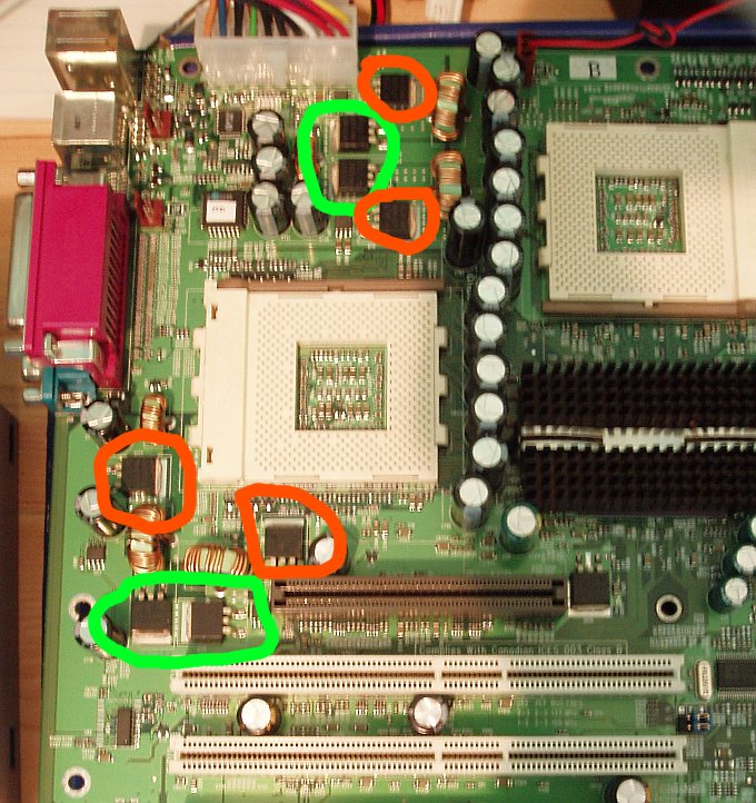

                              Ok, I did just that. Cleaned up and installed a new connector *very* careful of the exposed copper bits. I dont have a heatsink or memory to test with right now, but the fans spin now! I checked over the vregs with a mulitmeter, and I've got a question.. Everything looks normal but 4 vregs (2 per cpu). Here, I'll use a picture to demonstrate. The vregs circled in green measure 5.12v, which is what I would expect. The red circled vregs measure 0.012v.. which is a little odd. Maybe its because I dont have cpus in the board? I'm pretty sure I have a 12v rail working because the fan connectors and a small vreg over by the memory show 11.98v just fine.. If anybody else with a s2460 could check and tell me what these are supposed to be, I would be very grateful.. and here, without further adieu, the picture:
                              • RuKK
                                • Feb 2005
                                • 34
                                Re: Replacing ATX connector - tips tricks experience or help?
                                Nevermind that last post. Got the board to post with defective, unregistered ram and a generic 300w.. wow. Anyway, the vregs which are outlined in red in the previous picture output vcore. So I'll feed the 5v ones some nice clean power direct from the psu
