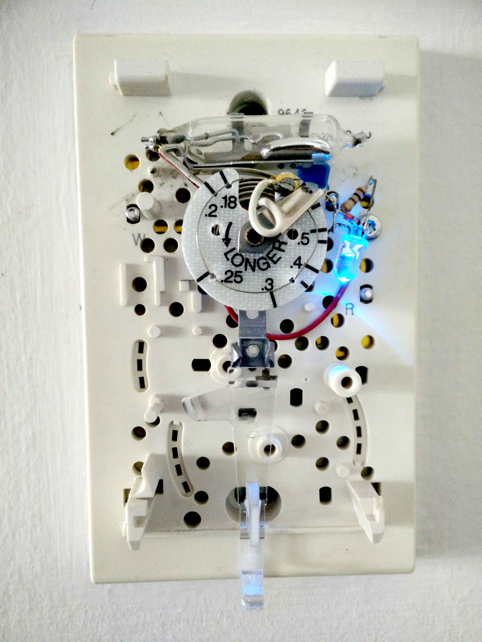

          moding was cheaper and easier, decided to just fix the problem component
          given that slide switch has 4 positions...
          I did use the old tubes as inputs so i can monitor them
          putting a 9th wire in that insulation was not easy for that led that turns on after sunset
          thought it was white turned out to be blue, it was salvaged from one of those silly push button keychain lights you get free here and there
          If something goes very bad i can move the wires to the top jumper and use the original tubes

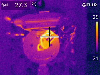

            • redwire
              • Dec 2010
              • 3910
              Re: Looked at new thermostats, nah I'll DIY this

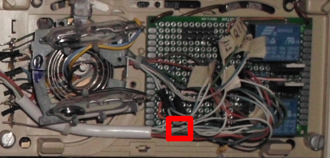

              Where did you put the temperature sensor?
              I found the heat made by a thermostat messes up operation.
              Honeywell mercury-switch tube, the skinny flex wires heat up, up to 10 degrees at 0.2A. Took me long time to figure out why the temperature was never consistent. see pic
              The Pi and relays can make heat too.
              Another house I owned, the wall had drafts and cold air blowing through the junction box. That made the temperature move around too.
              edit: added pic

                inside the red square there is a D18B20 sensor
                I tried to keep it in a low area of the box away from other components cause heat radiates and rises

                  OK, I couldn't see it. As long as it gets air flow, as I found relays/triacs make enough heat to cause the thing to oscillate on/off.

                    that ic is hidden under the 9 wires going to the raspberry pi 0
                    there is no way you could see it from that angle
