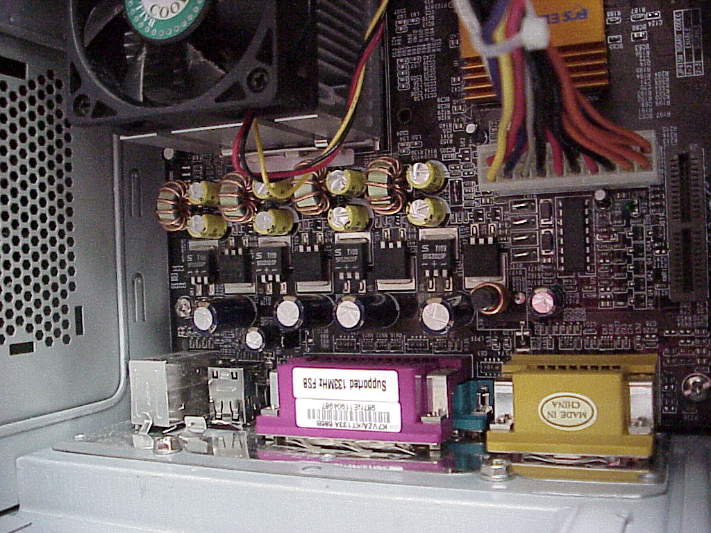

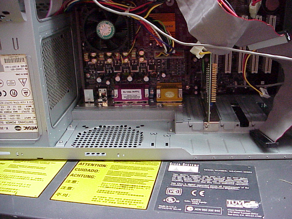

        Re: Poly Mod Success Stories
        ecs k7vza.
        neighbor got tired of bsod.
        i did her p4c 800 with polys a while back.
        just did this one too.
        vcore is dead quiet on the scope.
        these are fujitsu re 820@2.5v
                Originally posted by i4004
                >going to check the old caps after i pull them.
                how were the old caps on that one?
                iirc the ones on the p4c had a 2003 date.
                most were about .25 ohm esr.
                in this app thats as good as open.
                the ones on the ecs had fully hatched.
