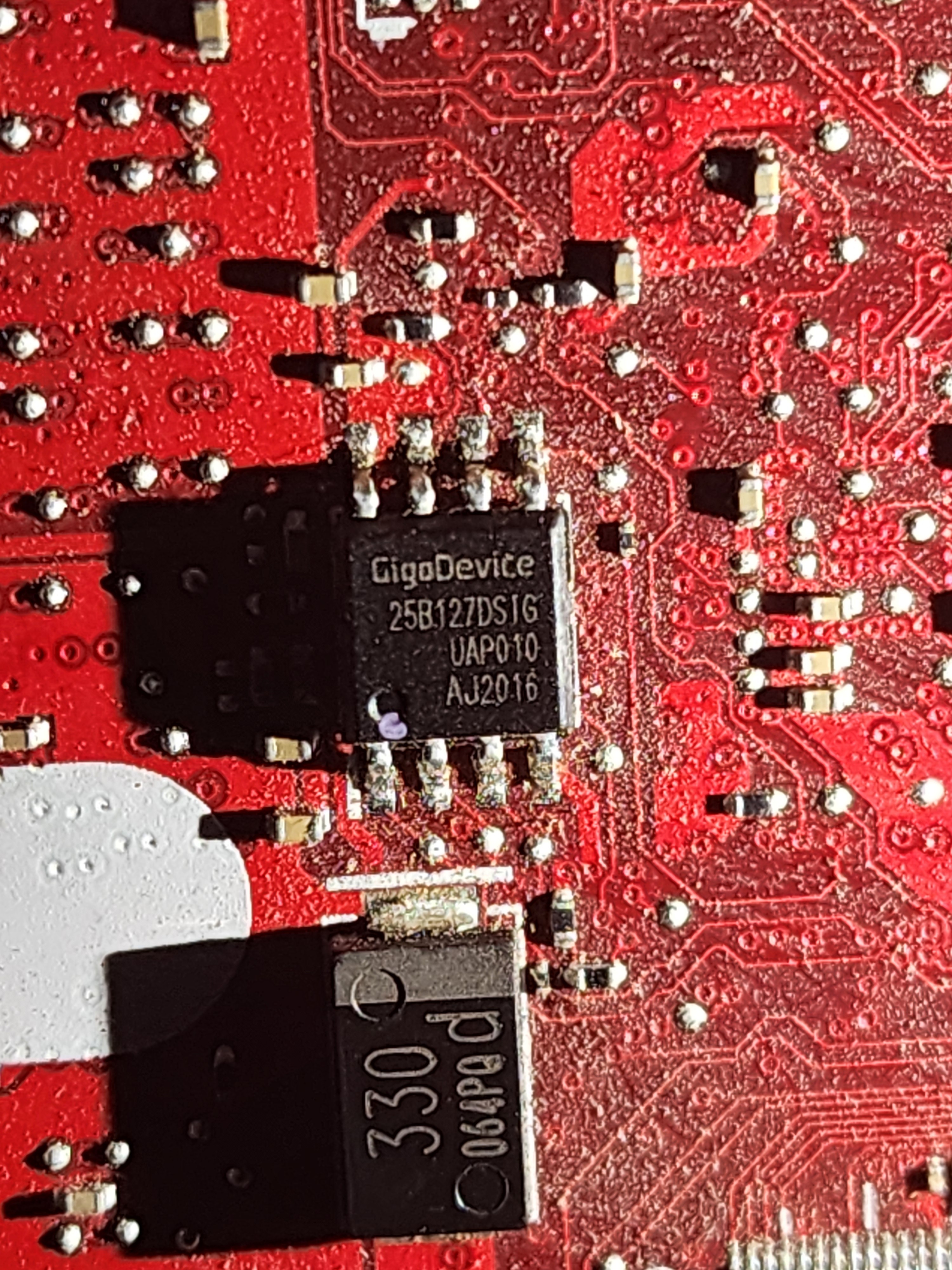

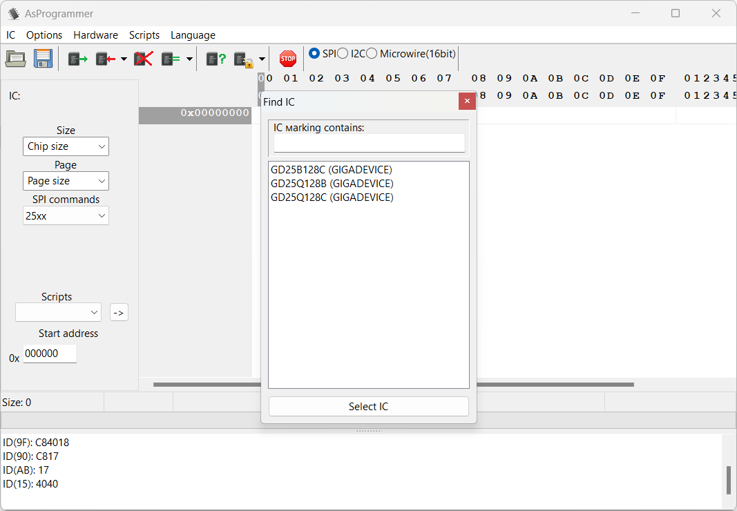

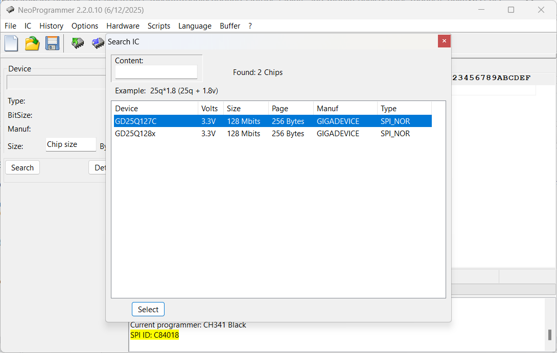

      The name over the BIOS chip is 25B127D, while the NewProgrammer and AsProgrammer detect different bios names, look the images below.​
