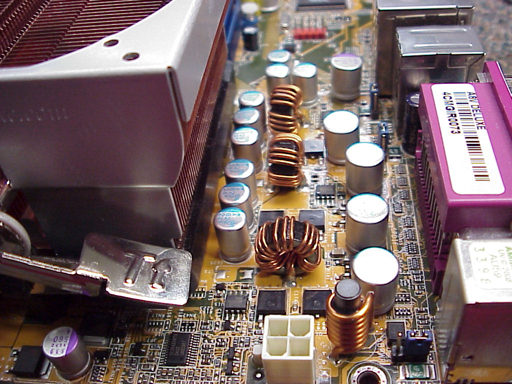

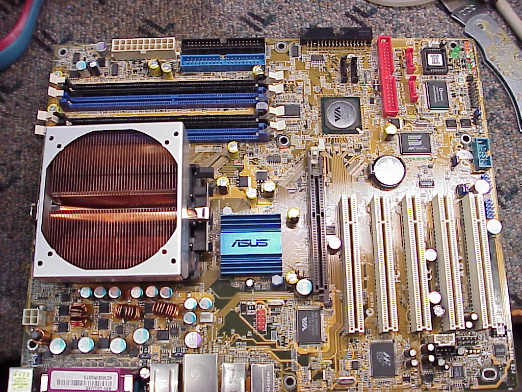

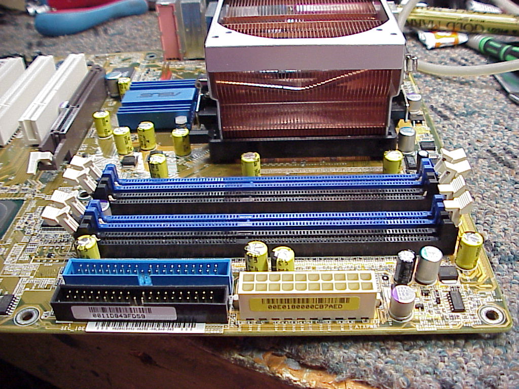

    asus a8v deluxe.
    not only were the caps leaking but the bios was wrong.
    it had ltec in vcore that were 2.5 ohm esr.
    this will soon be home to an fx60.oh the board,4 gb corsair xms,an antec 500w psu,and 2 500gb sata drives were FREE!
    it sure had the deck stacked against it though.
    we all know what was wrong with the antec.
    btw i measured all the cap voltages so you can use this set of pics for your own mod.

                          I can see in photo 1 that you have 820's@ 2.5v installed on the cpu side of the regulators... but other than that... I cannot descern the values of the polymer caps. I have the same A8V deluxe and an A8V E SE that are both more than just ready for recapping...and I'm ready to order the caps and copy your work. Can you supply a board layout of what you replaced with what? Sent you an email regarding the same questions the other day... and again.. thanks for your time.

                              large silver/blue are 330@16 ncc ps.
                              smaller silver/blue are ncc psa 820@2.5.
                              yellow/black are fujitsu 820@2.5.interchangeable with the ncc.
                              and silver/purple are sanyo sepc 560@4.

                                  kc8adu.. again thanks, I've been blowing up these pic's and trying to get a viable count. Very frustrating. Actully can't even make out the colors of a couple by the pci busses And I don't like to ask anybody for anything.. just not the way I've carried myself thru life, which compounds the problem.
                                  This is what I come up with, except the yellow and black electrolytics I'm assuming are 1000uf at 6.3v. ..and can be changed out with the 820uf poly's
                                  large silver/blue are 330uf 16v Nippon Chemi-con ps. 6
                                  smaller silver/blue are Nippon Chemi-con psa 820uf 2.5v 12
                                  yellow/black are fujitsu 820uf 2.5v interchangeable with the Nippon Chemi-con 12
                                  and silver/purple are sanyo sepc 560uf 4.v 3
                                  I don't know man.. maybe a better picture... marked up copy of the componet layout sheet, something. I gave this my best shot. My next move would be to look elsewhere for nfo or fill it full of rubycons.
