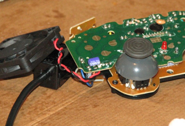

    Sometimes I can hear strange operating noises through sensitive headphones when some USB devices are
    attached. Particularly gamepads. My Nyko fan cooled gamepad would make a lot
    of noise through headphones with it's fan enabled, I followed some past advice
    from badcaps members ( of atleast as I interpreted it - If I've got it wrong pls let
    me know) and parallel a small Oscon to the fan, now the fan seems to spin up and
    down much smoother and the noise appears to be completely gone consequently
    there's no noise now. Perhaps I should parallel all my devices with these
    smoothers?.

                  Anyway heres what I did to stop the fan transmitting noises I could hear through my
                  sensitive headphones with sound levels maxed...
                  Don't worry about the ammount of solder used there. It's a big hill of it, so the top reaches
                  the legs, otherwise the legs would be too close to the wrong pads. I opted for the hill as the safest possible option to my knowledge. Don't worry about the top of the cap either it's just camera playing tricks, it's not going to short circuit and blow up my laptop by touching the solder blobs near it, it's atleast 1mm between them.
                  Also added full range and long length RFI ferrites to either end and twisted the fan power wire.
