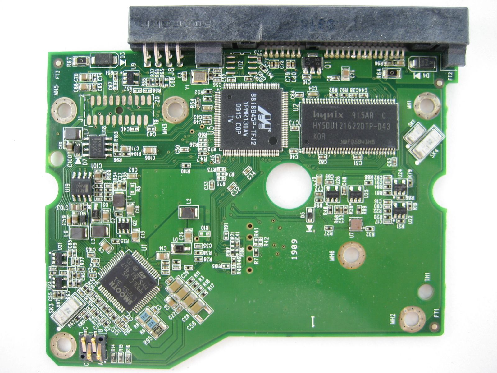

        Update: I took the board off the drive. There are 3 chips on the platter side of the PCB, all SMD. The Samsung chip (rectangular) is the 64K cache, the Marvell chip (square) is the controller, and the "Smooth L7251 version 3.1" has burned. No other burn marks, though parts can fail without showing signs.
        This board (WD part number 2060-771624-003) can be found at hddzone, used, for $36. Special BIOS means the main controller chip AND BIOS must be changed. Information about tracks, etc. is specific to this exact physical drive and it must be preserved.
        I do not have the skills for soldering SMD stuff, especially when my files are at risk. Perhaps I should hire the firm in Indianapolis. Their board repair is a $500. This is a lot of money, but it is cheaper than $1300 for Ontrack, and I know I cannot do this myself.

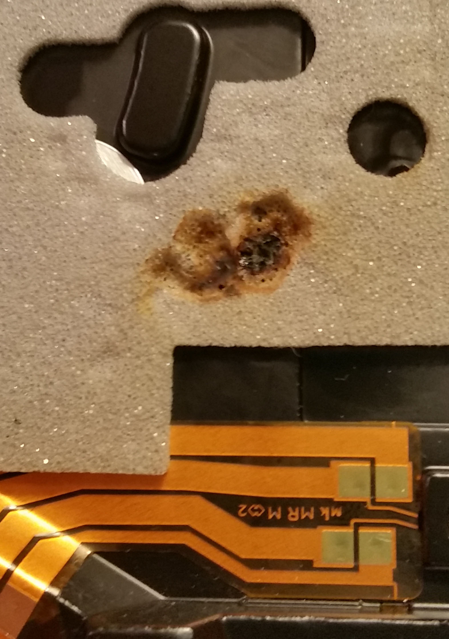

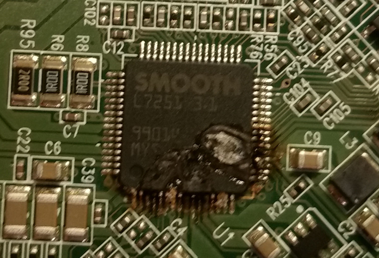

              I thought I smelled something burning when I plugged this drive in. Clearly I did.
              Time for some pictures. Enjoy!

                  If the 5V TVS diode is damaged (check D3 and R67), then there is a high probably that the preamp on the headstack has been damaged.
                  TVS Diode FAQ:
                  http://www.hddoracle.com/viewtopic.php?f=100&t=86
                  Catastrophic failures in Western Digital PCBs:
                  http://www.hddoracle.com/viewtopic.php?f=59&t=1119
                  A straight board swap will most probably not work. That's because the PCB contains unique, drive specific calibration data in flash memory, either in a serial SPI flash IC, or embedded within the MCU. These "adaptive" data need to be transferred to the replacement PCB.
                  If the following is your board, then the ROM location at U12 is unpopulated, which means that your firmware is embedded in the MCU:
                  http://www.dhresource.com/albu_82120...060-771624.jpg
                  Looking at your photo, it appears that the damage to the SMOOTH IC is on the +5V side, in which case the preamp is most likely dead. :-(
                  I would not waste your money on a replacement PCB.

                    These "modular" PSUs have cables with non-standard pinouts. When people switch cables between different PSUs, they will often end up with +12V on the +5V pins. This is what appears to have happened to the OP.

                        Fzabkar is correct. There was an overvoltage; I suspected this also. Most modular PSUs have 6 and 8-pin sockets that deliver 12 volts only, for PCI-E video or for CPU connectors. The 6-pin socket on my OCZ Fata1ity 550W (2010 version not the 2014 model) delivers only 5 volts and 3.3 volts. So the OCZ cable, plugged into a Seasonic PSU, delivered nothing but 12 volts to my hard drive. "Video card voltage" -- it was just as I suspected.
                        I looked for the correct cable before I plugged the hard drive in, I really did. But I am not very organized, and have lots of modular cables.
                        The OCZ power supply (and its cabling) appears to be the only modular PSU I own with this weird arrangement. It will be retired forever by the time you read this posting. I will probably buy the Seasonic SS-460 FL2 platinum fanless modular PSU immediately. It seems to obey a standard pinout.
