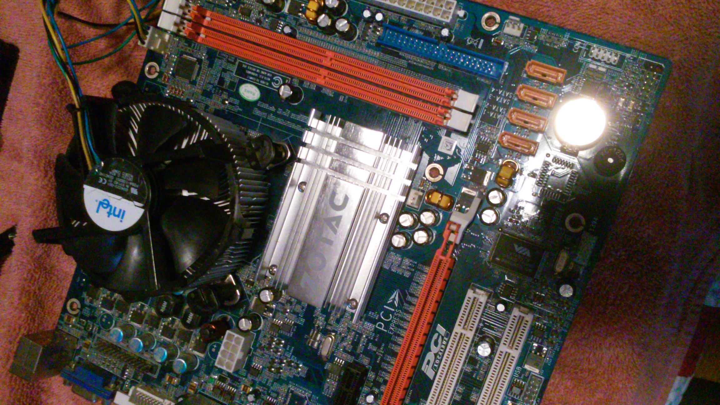

                GPU heatsink with fan, not attached yet, just in position.
                • hikaruichijo
                  • Aug 2015
                  • 123
                  • Spain
                  #48
                  Re: Zotac mainboard needs PSU with 8-pin mobo connector
                  The fan should be blowing the air againts the cooler not extracting. Put it the other way, with the stiker down, it is a comon mistake
                  Maybe with the fan is enought, check the temperatures.

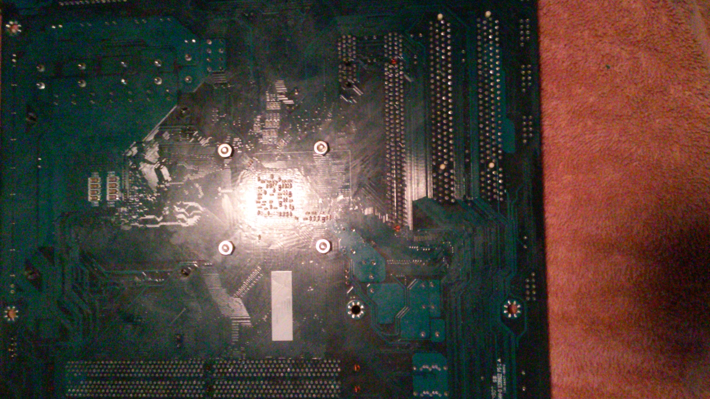

                      I sized some screws exactly today, with nuts for the underside. Problem on the underside is that the nuts will touch motherboard traces. I have a choice of 4 plastic washers or 4 very thin fiber washers used in mobo mounting. Apparently this board is so small, there's another layer of trace circuitry on the underside, or is that normal? I also want to invite ideas for mounting the fan. In the past I have tied it down with copper wire, but maybe there's a better way.
                      When I invited suggestions for a replacement motherboard, I should have mentioned that I want to re-use the Intel Dual Core processor in this unit, assuming it would fail in a short time. I guess that would mean another LGA 775 mainboard.

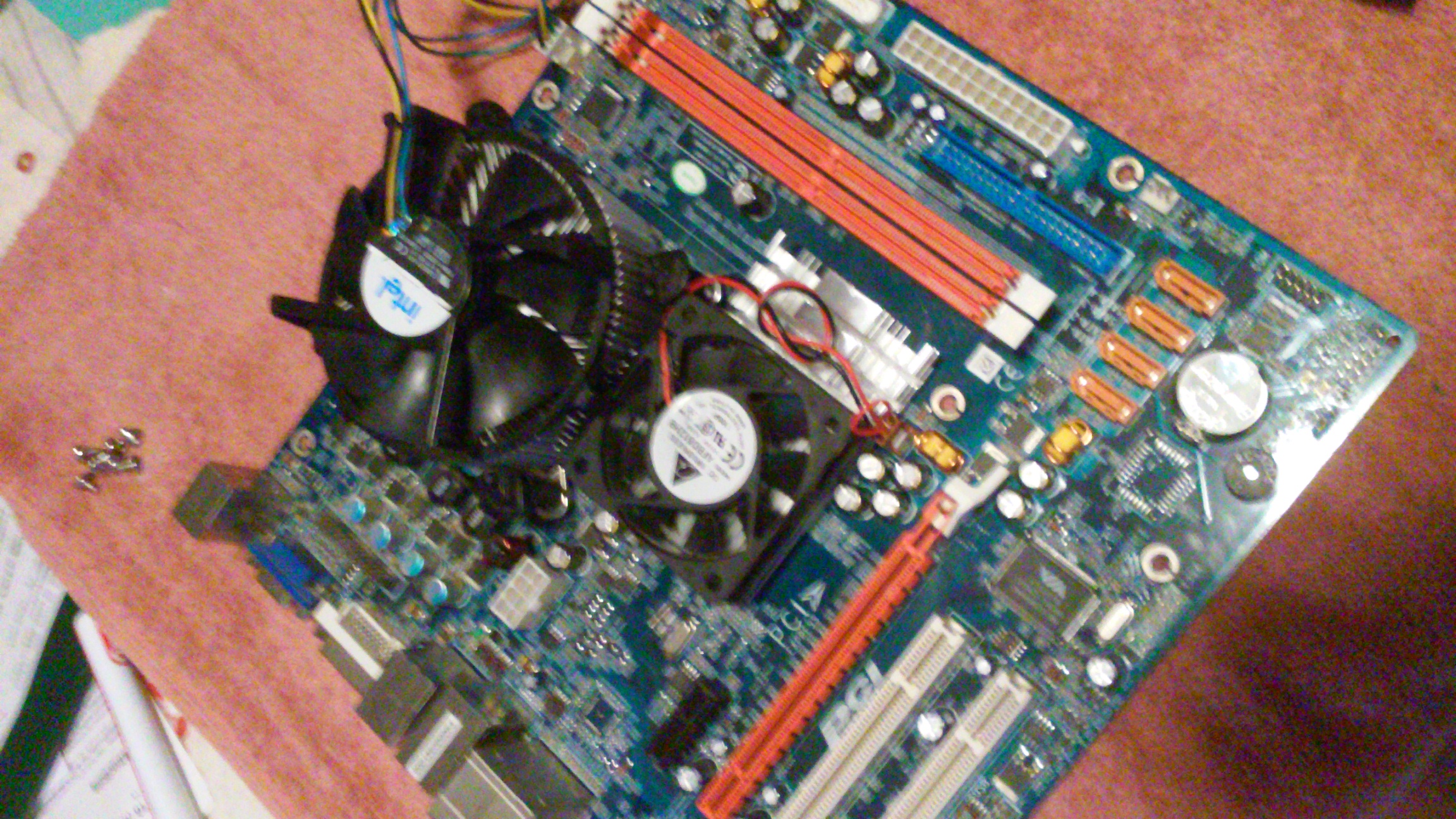

                              I really don't know if this fan works, so before I start drilling holes in the heatsink, I'd better try the board without the fan, connect the fan to test it, and go from there. Still looking for a non-destructive way to attach the fan. Any suggestions?
                              • binsonk
                                • Apr 2014
                                • 182
                                #55
                                After 10 minutes running, BIOS reports CPU Temp as 20*C (68*F), System Temp as 38*C (100*F), holding steady.
                                EDIT: After 20 minutes running, the heatsink is now too hot touch and hold. What temperature is that, around 125*F? BIOS is reporting System Temp as 40*C / 104*F.
                                I restarted the computer and just laid the spinning fan on top of the heatsink to cool it. Gonna check the temp after 30 minutes.
                                With the fan on the heatsink, the metal is warm to the touch, but not hot. What temperature is that, around 105*F? The fan is blowing air away from the heatsink (evacuating). This suits the air flow design than I will eventually implement, ie. installing a case fan on the back, to suck hot air out of the box. I'd install the fan right now, except for the fact that the mobo power source for case fan is all the way to the other side of the board, near front panel connectors.
                                I gather from this little experiment that the heatsink fan is going to make a decisive difference in the life of this motherboard. Any ideas on mounting the fan?
                                  • 31201
                                  #56
                                  rotate the fan 45 degrees like in my drawing and drill 2 holes in the center "T" section.

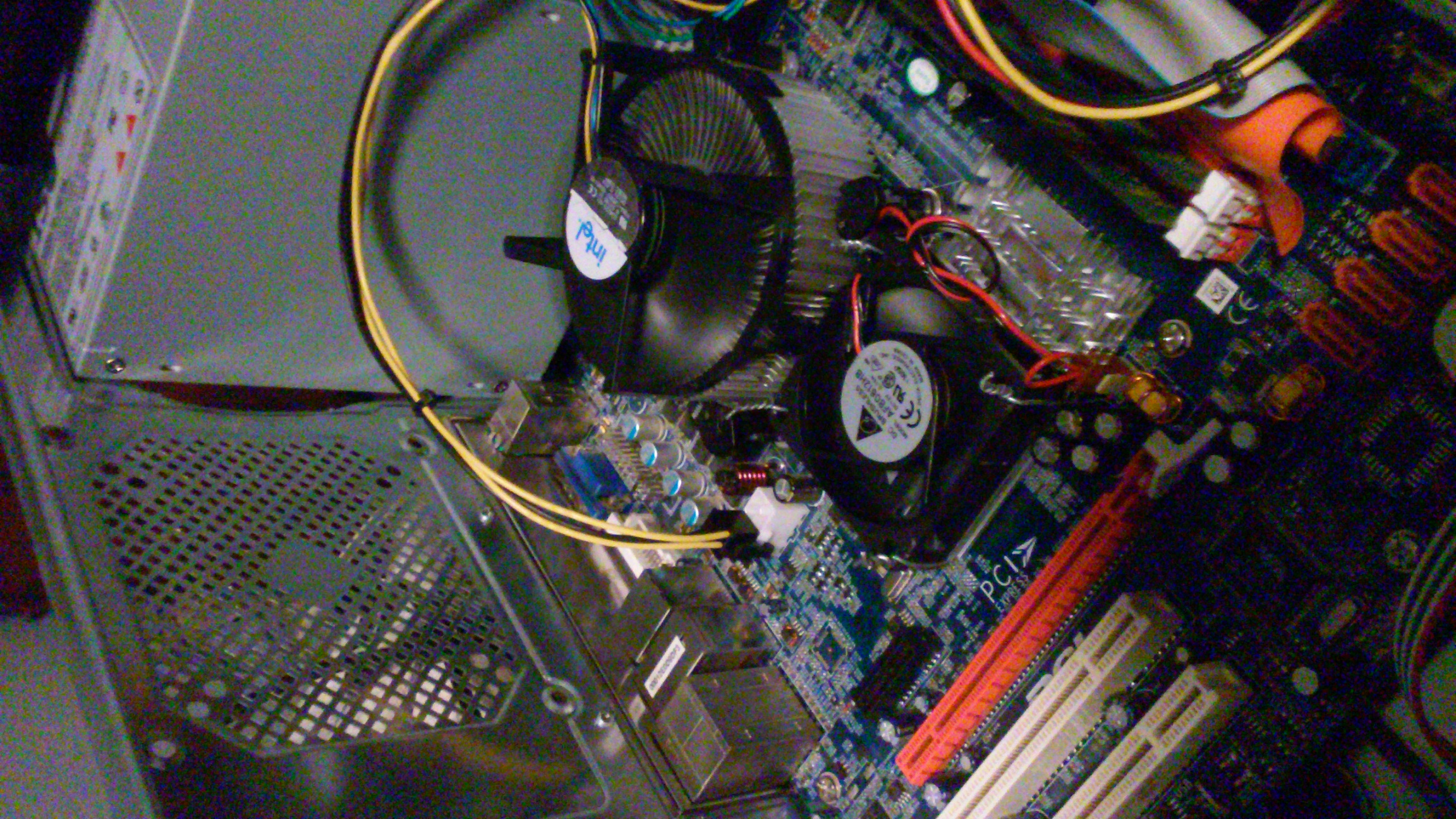

                                    I drilled 4 holes in the sides of heatsink, 2 holes either side, and tied the fan to it with solid wire, positioned as shown in previous pics. I am happy to report the GPU heatsink is just warm (~105*F), and not hot at all. I'm glad I didn't give up on this motherboard. Thanks for your help and encouragement.
                                    • binsonk
                                      • Apr 2014
                                      • 182
                                      #58
                                      cooling fan installed on top of GPU heatsink

                                        After the bios reporting the temperature at 40C, that is perfectly alright
                                        heatsinks are SUPPOSED to be hot to the touch, that is good, it means it's adsorbing the heat and disappointing it in the air. Putting AS5 or another good paste over the previous stuff can cause temps to normalize like that without requiring a fan.
