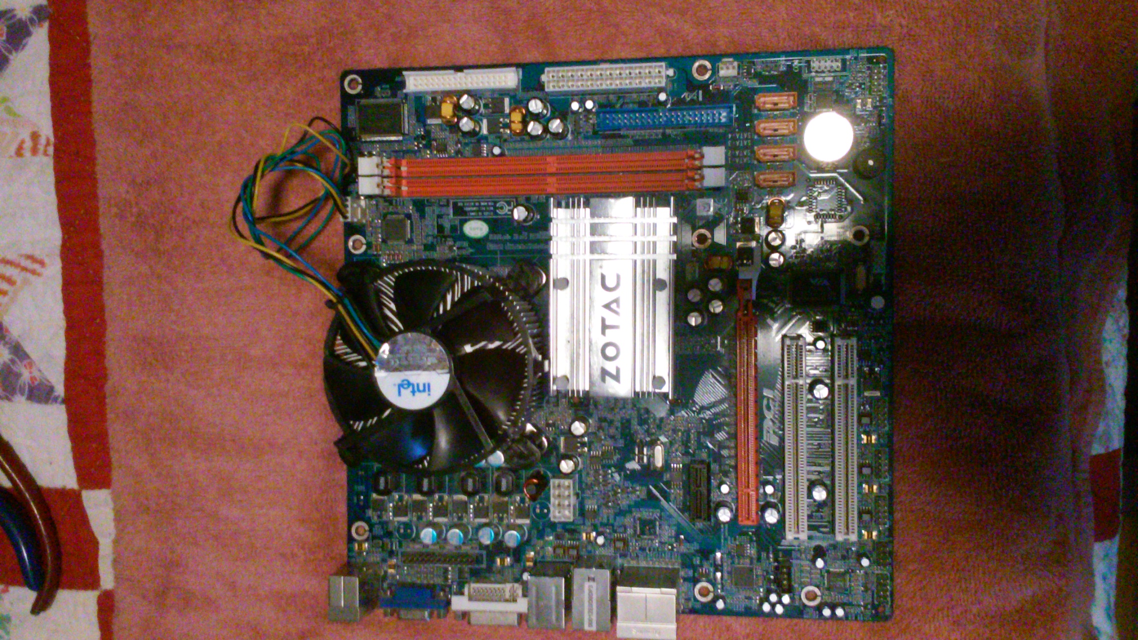

          The motherboard has the words "PCI Express" on it. I finally located a pic and identified the board. Zotac N73PV-Supreme
          http://www.anandtech.com/show/2684/3
          One criticism is that the motherboard lacks dual channel architecture.

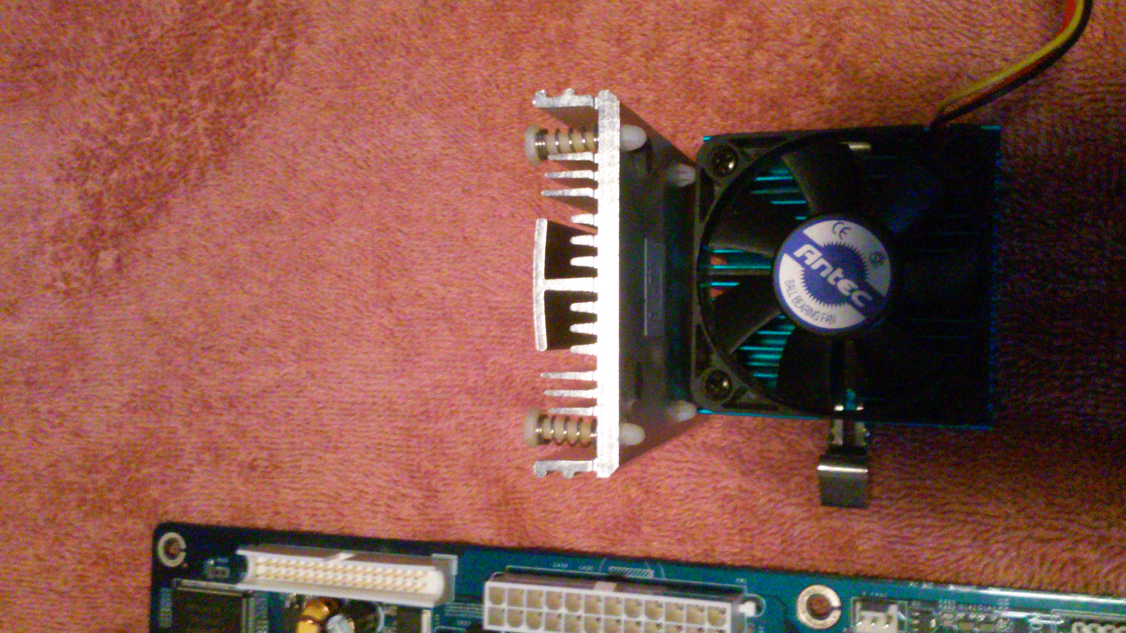

                        What about gluing a P3 cooler (heatsink + fan) to it? I just dredged up a celeron cooler, perfect square with a perfectly flat bottom. I assume this graphics chip is square? The heatsink could probably use a little more metal, but it's lighter than most.

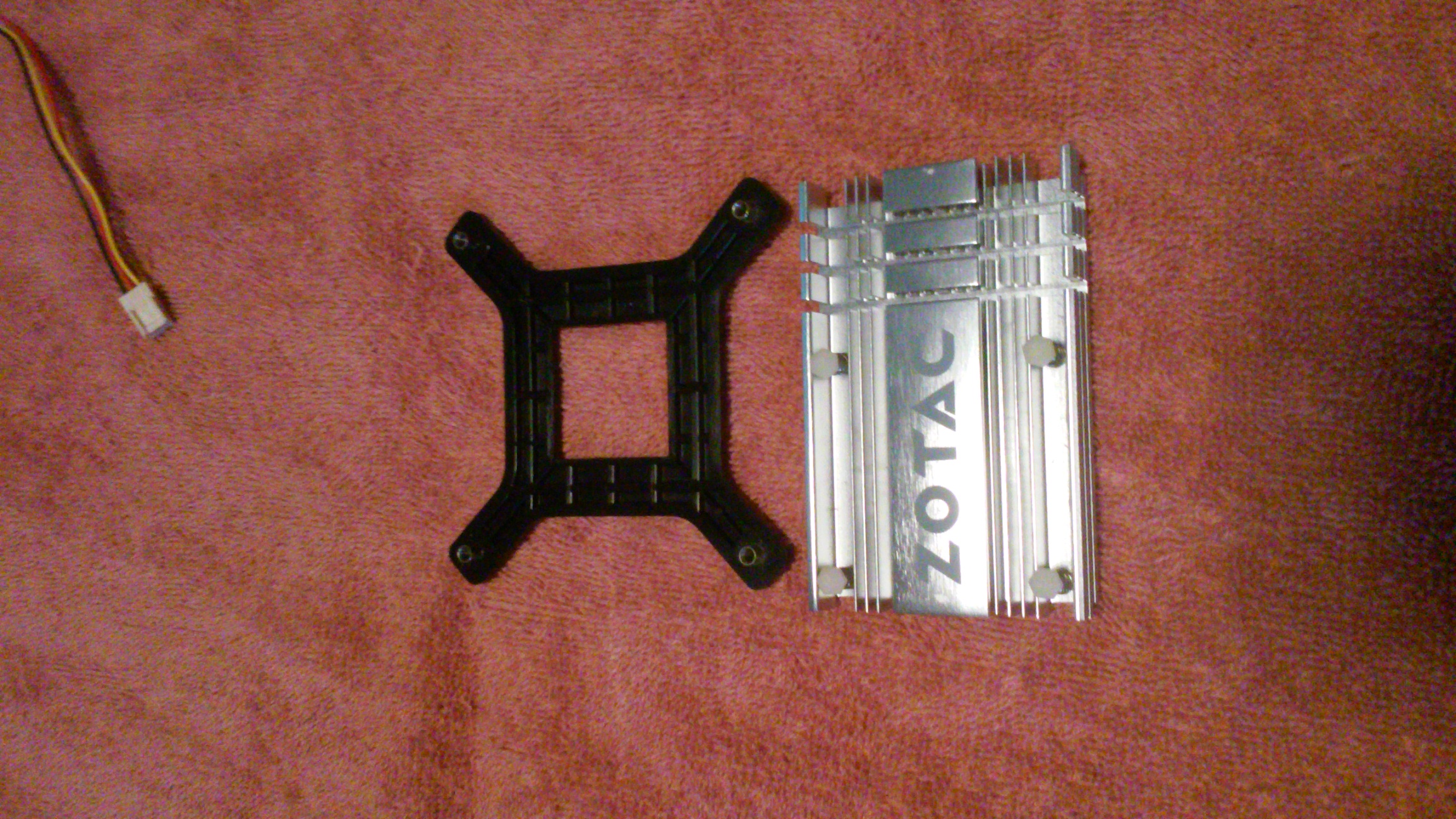

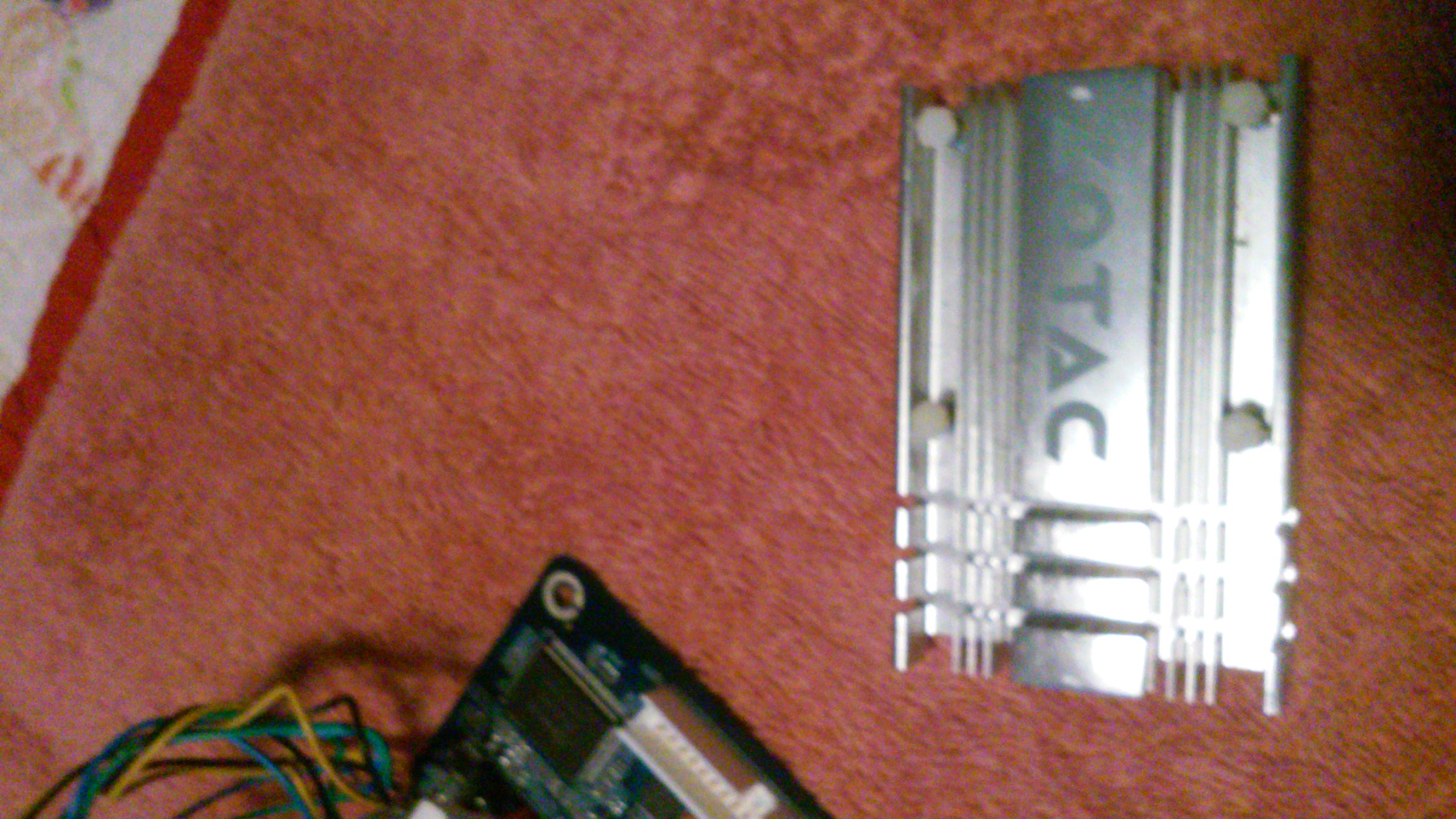

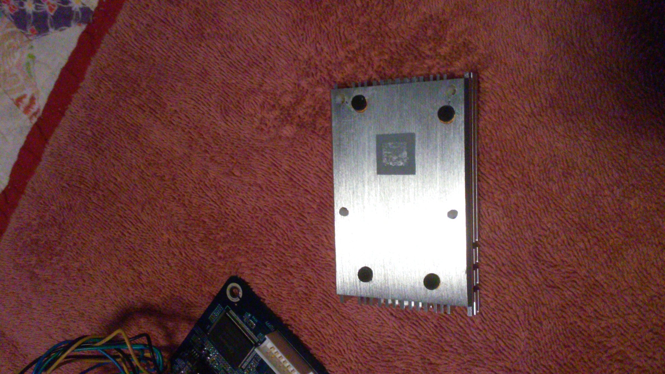

                          The GPU has a strong resemblance to an Athlon XP processor without socket, permanently attached. There are 4 symmetrical holes around the chip. The stock Zotac heatsink has a curvature on top surface, where the letters ZOTAC are seen. This makes it difficult to attach a fan to this heatsink. The proximity of the GPU to the CPU limits the size of the heatsink. The location of a cap has the same effect, as well causing the heatsink to be off-center in one direction (lengthwise). There's more metal on this heatsink than I first thought; it's pretty hefty. The GPU must generate a LOT of heat. I believe I will need a cooler befitting an Athlon processor, a fan being absolutely necessary. With such a small contact surface, gluing seems be out as possibility.
                          As for crud under the heatsink, there isn't much crud because there isn't much contact surface, like the shiny contact surface of Athlon XP/Pentium 3. The thermal paste is a bit dried out, that's all.
                          When you recommend a good thermal paste, I assume you mean Arctic Silver. Please confirm.
                          I have the backup plate for a heatsink mount, that I could modify to back up to those 4 symmetrical holes in the motherboard. It's hard black plastic. The metal screw sockets would have to be cut off, so I'd be working with pure plastic in this backup plate.
                          This ZOTAC heatsink is very specialized, asymmetically affixed to the GPU to occupy available space on the motherboard, with 4 rubber mounts glued to the bottom side to keep it off the motherboard. I'm not sure I could do anything better than the stock heatsink, except to somehow attach a fan to it. I don't see a way to attach a fan to it without affixing some frame on the heatsink to accommodate the fan. Maybe one of those old Celeron fans with a hood that attached to the special heatsink. In my opinion, that hood housing the Celeron fan would be counterproductive. There are 4 plastic spring-loaded nails that attach the heatsink to the motherboard. The heads of these special nails stick out above the metal of the heatsink by about 1/8 inch, so that nothing can ride on top of the heatsink. Maybe the fan will have to blow across it, probably in the lengthwise direction. Nope, not enough space on the ends: that limiting cap on one end, system RAM on the other end.

                              If you trie to glue the heatsink to an exposed die is very likely that you damage it and it will not have good contact neither presure and the glues used for this have bad thermal cunductiviti compared to a good thermal grease.
                              I sugest trie to increase the presure puting a copper pad betwing the heatsink and the die puting a bit of thermal compound on bouth sides of the pad.

                                Here are the photos of the ZOTAC mainboard and GPU heatsink. In the first photo, the heatsink is not exactly in position, it's displaced about 3/8 inch in the direction of the RAM slots.

                                  Maybe I could substitute screws for the plastic nails, using the backup plate to bring more pressure to bear on the contact surfaces. That's not going to reduce the heat to be dissipated by the heatsink. But, with those plastic nails out of the way, maybe I could mount a fan right on top of the heatsink. However, given the amount of heat involved here, a metal backup plate would probably be better than plastic, which might deflect.

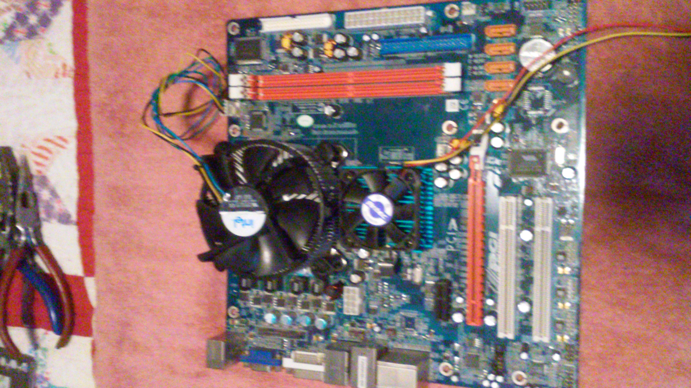

                                    Well this is one idea you could trie. First remove the rubber pads and the push pins from the original heatsink then get four screws, four nuts and four cardboard washers, put the washes on the screws insert then from behind the board so that the washers are in touch with the board and tighten the nuts untill the board starts to bend, always tighten then in cross order, and ofcourse clean that old TIM.
                                    And for the fan, it should not be a problem to mount it on the top of the cooler.

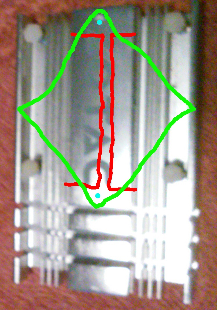

                                      easy - do you own a dremel type cutter?
                                      if yes, i'll post a pic or 2.

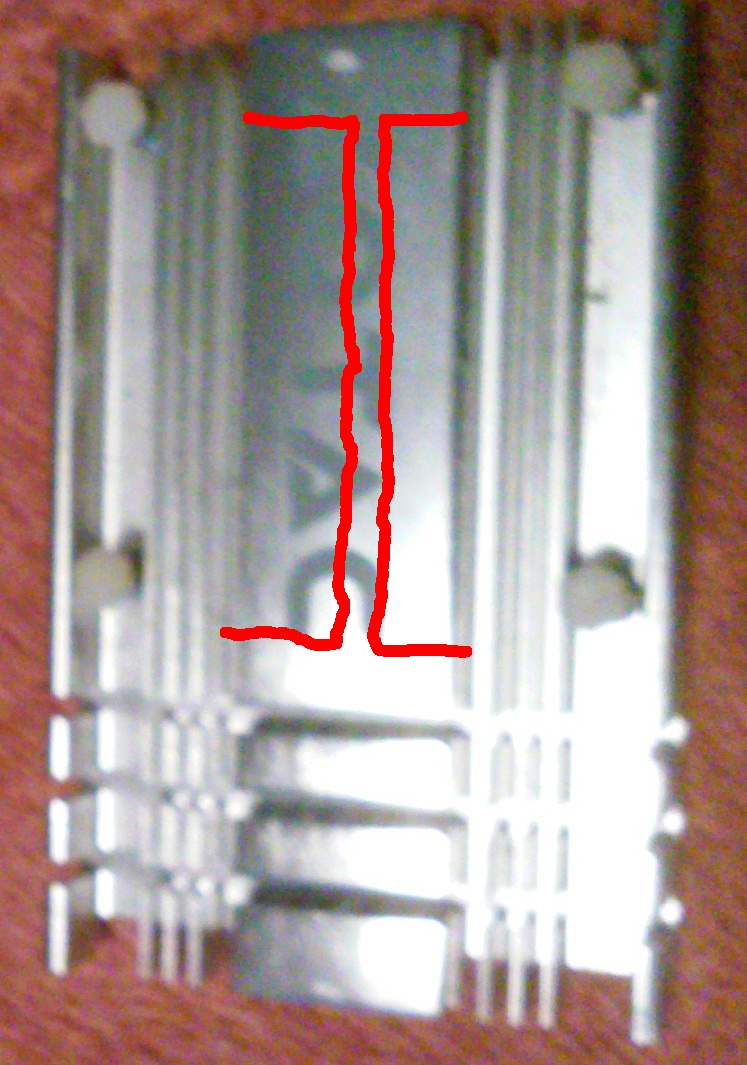

                                          Re: Zotac mainboard needs PSU with 8-pin mobo connector
                                          dont fuck the holes up.
                                          i'm talking about cutting away some of that center fin with the writing on it.
                                          2 foto's
                                          first cut away the red.
                                          then mount a fan like in the green outline wih 2 screws.
