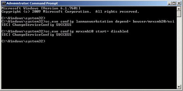

                              Assuming that you and others are running win7 with a limited number of security updates installed (the purpose of this thread), do you intend to install the security rollup put out by microsoft to protect against WannaCry? If not, what is your plan moving forward? Thanks
                              This is what I did to protect my Win7 system from the WannaCry exploit. Please comment on whether you think this is effective.
                              Setup: WannaCry exploits outdated SMBv1 protocols. So, disable SMBv1. Do not disable SMBv2 or SMBv3.
                              I followed the instructions under 'How to enable or disable SMB protocols on the SMB client' (will post the link at the bottom). *My laptop isn't a server, so it must be the client, right?
                              It's a very simple copy/paste of two lines, into an elevated command prompt. To get an elevated command prompt, right-click the command prompt and choose Run as administrator.
                              Paste, or type, the commands one at a time and hit Enter each time. Here they are:
                              To disable SMBv1 on the SMB client, run the following commands:
                              sc.exe config lanmanworkstation depend= bowser/mrxsmb20/nsi
                              sc.exe config mrxsmb10 start= disabled
                              See the attachment for a screenshot showing the command prompt after entering both commands.
                              Here's a link to the instructions per Microsoft.
                              https://support.microsoft.com/en-us/...ws-server-2012
                              Feedback?
                                  <snip>
                                  Feedback?
                                  Actually if you connect from another system, say using WannaCry to your laptop then it is performing the duty of a SMB server.
                                  At least that is how I interpret it...
