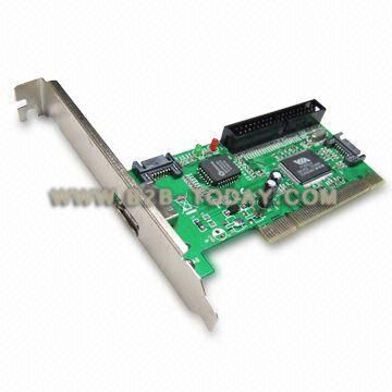

                Re: my raid 1 array has been running with a dead drive for 3 years now!
                oops its not a bad HDD, the SATA power cable burnt up. plugged the bad drive in today and it spun rite up and i could access the data from before it failed! even got some data back that was deleted but wasn't supost to be.
                oh and is this RAID card a P.O.S?
                  general rule, if its under ~$150, its fakeraid
                  that is a via chipset, and I can guarantee you, you're better with software linux raid
                    like MDADM?http://en.wikipedia.org/wiki/Mdadm
                      well mdadm is the monitoring and management for linux software raid partitions, but yes, keep using Software, instead of fake raid
