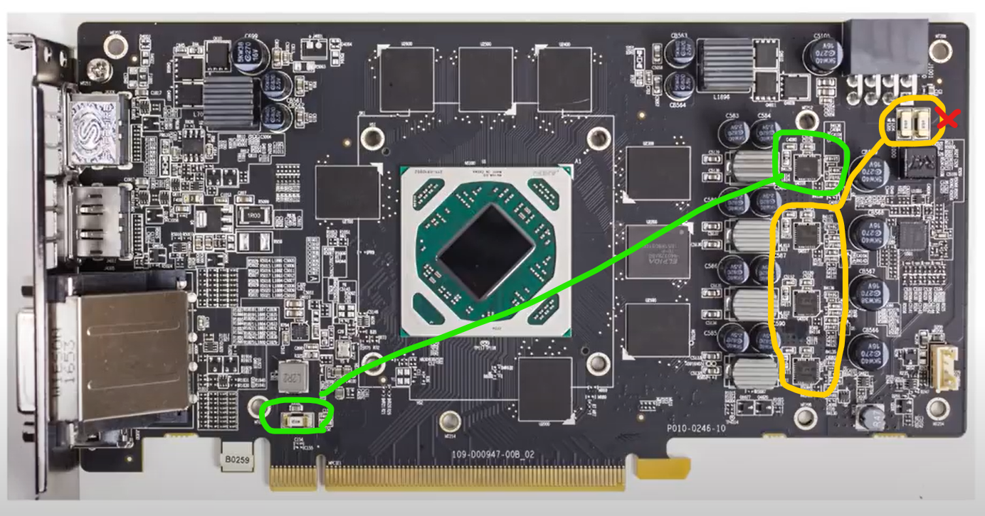

            • Fachrudin_Ahmad
              • May 2024
              • 3
              • Indonesia
              I also have the same issue. I have an RX 570 Sapphire Pulse. I bought the VGA in used condition. I only used it for 2 days without gaming or any editing, but suddenly there was no display, and the fans stopped working.
              Then, I started to investigate the root cause of the problem. Initially, I had no knowledge about repairing GPUs, relying solely on YouTube and this forum.
              Straight to the point.
              First, I checked the condition of the fuses. Fortunately, on the Sapphire Pulse, if there is a short, the fuse will immediately blow, preventing the problem from spreading. The Sapphire Pulse has 3 fuses: one near the PCI and two near the power pins.
              The condition I found was that the two fuses near the power pins were blown. After researching from several references, I found that these two fuses are connected to the 3 vcore. See the attached image.

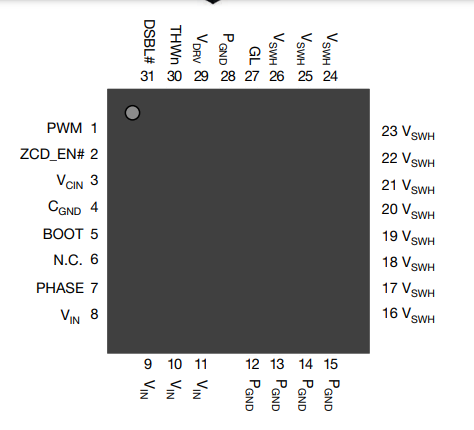

              Then I checked the 3 v-core SIC632 with a multimeter in short/beep mode.
              Specific Short Checks See attachment:
              • Short between V_IN and GND: Check for short between pins 8 to 11, 34 and 12 to 15, 28, 35.
              • Short in Internal Logic Circuitry: Check for shorts between V_CCIN (pin 3) and C_GND (pins 4, 32).
              • Gate Driver Short: Check between V_DRV (pin 29) and C_GND (pins 4, 32).
              I found that the SIC632 was shorted and produced a beep, and the resistance was very low, approaching 0.
              I then compared it with the vcore that had an intact fuse, and the result was high resistance and no beep. So, I concluded that there was a problem or short in the 3 SIC632s connected to the two blown fuses.
              Finally, I replaced the 3 SIC632s and the 2 fuses. My RX 570 came back to life.
              However, I am not sure what exactly caused the vcore to short.
              1. Was it due to overheating?
              2. Was it due to a problematic power supply?
              3. Was there an issue with the VRAM?
              4. Was there a problem with the circuit?
              5. Or other issues?
              ​I hope my diagnosis and repair are correct, because if the VRAM or circuit condition is problematic, the short is likely to happen again.
