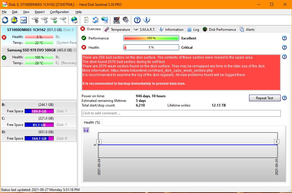

    Hey guys,
    I have an Asus M5A99FX Pro R2.0 motherboard with AMD RAIDXpert. I set up a 1000GB RAID1 array on it. This was about 8 years ago. Every once in a while, a power outage or something would knock one drive offline and degrade the array. After a reboot the drive would be back online and it would rebuild just fine.
    Recently, a drive dropped offline and the array became degraded. I figured it was no big deal and rebooted then set it to rebuild overnight. The next morning I took a look and both drives had dropped offline at 70% rebuild. Uh oh.
    I rebooted and tried rebuilding a few more times but one of the drives kept going offline. Figured it must be bad so I swapped another in and started rebuilding to it. The rebuild was almost complete when the other drive went offline.
    I am currently cloning the last drive to a good drive as it does not seem likely that it will do a successful rebuild. And yes, I know RAID is not a backup. I have several backups of the drive. I am just cloning it to save me the trouble of reinstalling some programs that I didn't have at the time of the last backup.
    I tossed the first failed disk in another PC while the other one was cloning to take a look at the SMART data. 7120 bad sectors. Ouch. No wonder it wouldn't rebuild.
    This leads to my question. Why on earth would the RAID controller never alert me to such an unhealthy disk? This disk has obviously been going out for a long time and it was just after the second disk started going bad that I found the problem. Trying to view the SMART data on the PC when the drive is in RAID just gives "not supported".
    I have another way older PC with a RAID controller that I just use as a server for some video games. I am using a hard drive with bad sectors since I really don't care if it dies abruptly. However, every time I boot that PC, it beeps and complains that one of my RAID disks are failing.
    Is there something that I am doing wrong with the AMD AMD RAIDXpert that I can't see the SMART data from the OS, and that the RAID controller never complains even when there is a disk that has both feet in the grave? It seems to defeat the purpose of the RAID array... Having one disk go bad and then just swapping a new one in isn't an option when the controller waits until both disks are bad to alert me to the problem...
    Let me know your thoughts.

              I took a look through the BIOS and SMART Reporting was enabled. However, the RAID mode was set to "Legacy ROM" and the other option was "UEFI Driver". I figured this had to be the problem. I switched the setting over and then Windows wouldn't boot because my system drive was MBR instead of GPT.
              Should've been an easy fix but somehow my System Reserved boot partition was on the 1000GB RAID array that was failing and my Windows installation was on my SSD. So after days of struggling to get the system reserved partition moved and make the OS bootable again, I finally got my SSD switched over to GPT and the UEFI Driver setting enabled in the BIOS. During this process I found a 3rd bad disk in my 2000GB RAID array. Luckily the other disk in the array did not have any bad sectors yet.
              To my disappointment, this didn't do anything. HDSentinel still just gives ? for the SMART status of the drives connected to the RAID controller. Even for disks that are not a part of the array such as my SSD. CrystalDiskInfo doesn't even detect the disks at all.
              The drives now show a "Healthy" status in the RAIDXpert utility but this obviously means absolutely nothing. I plugged one of the bad drives into another PC to get the SMART status. I have attached a screenshot of the info. 256 bad sectors with 2576 pending bad sectors shows up as "Healthy" on the RAID utility. The other drive in the array had 16 bad sectors and 16 pending bad sectors. Not nearly as bad but it still caused the rebuild to fail at 70%. How the RAID utility considers this disk "Healthy", I have no idea.
              If I boot the computer from a linux USB stick, I can read the SMART data from all the drives, even the ones that are a part of an array. The files in the array are also available in a separate volume. So obviously the RAID controller is allowing the SMART data to be read. However, I have not found any way to do so from Windows. Any ideas?

                  Protip: A drive regularly dropping out of the array is NOT NORMAL UNDER ANY CIRCUMSTANCES. I suggest booting up Linux and checking the SMART stats with:
                  Code:
                  smartctl -d sat -a /dev/sdX
                  where X is the drive letter corresponding to the array member disk.
                  EDIT: Oops, just read that you managed to pull SMART. Junk that Seagate drive ASAP before it takes the array down for good.

                      Never trust these meaningless "health percentage" or whatever. Pending/uncorrectable sectors >= 1 → dead HDD, and you already lost data.

                        Yes, obviously all 3 drives with bad sectors have been removed and replaced with good drives. The spares I had on hand have 40000+ hrs on them but have no bad or pending sectors so they will be fine until I find some replacements.
                        And yes, I was not looking at the silly "Health" value on the HDSentinel tool, but rather the ~2500 pending sectors and 256 bad sectors.
                        One of the RAID arrays did not survive. Since both drives had bad sectors, the array would never rebuild. I cloned the best of the two drives to a good temporary drive, deleted the array, replaced the disks, created a new array, and then cloned the partition from the backup to the new array.
                        I gave HDD scan a try, but it gave the same results. Could not see the SMART data of any drives connected through the RAID SATA ports on the motherboard.
                        I guess I will just have to boot from the linux USB once every couple weeks to check on the SMART status. It sucks a lot, but I guess it is better to go through the inconvenience and find a failing drive while the array still has potential to be rebuilt.
                        Very frustrating that all the SMART data can be read in linux, but nothing I can do will let me access it from Windows. Must be a driver limitation like was mentioned.
