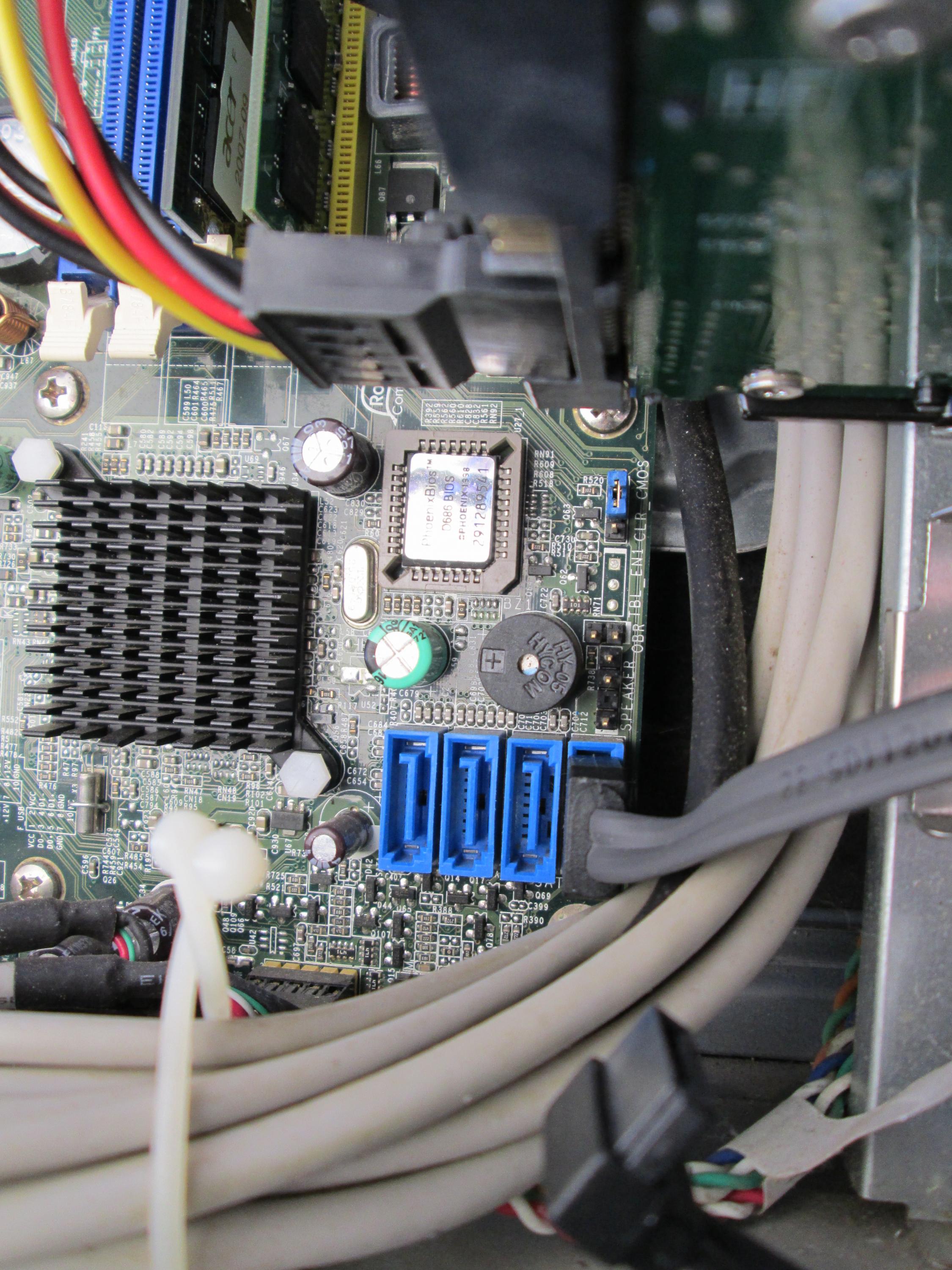

    I wouldn't worry about it. As long as it does run and doesn't overheat. Does the board support temperature controlling?

      It doesn't support anything at the moment,(but I will check to see if it does)I put a brand new 1Tb unformatted HDD in and a few sticks of memory 2Gb to try it out. This is a new boot HDD because the old one failed, probably because of the capacitors failing? Isn't, the bios supposed to come up without the O/S installed? What I'm getting now is nothing on the monitor whilst madly clicking f10, f8, f2,but no bios is happening, I have the recovery disks for it but don't I have to format the hard drive first? Oh I nearly forgot,when I turned the computer off at the front switch it wouldn't turn on again so I swapped the PS out for another PS and it did the same .Then I found if I left it for a while it would start up again?

        I just looked up that model number. It looks like an Acer Aspire motherboard. If so, then it definitely does temperature control the fans, which would explain the delay.
        No. Bad motherboard caps shouldn't kill the HDD
        Yes, it should
        That means that the board isn't POSTing. No key is gonna make it POST if there is a problem.
        No. The recovery will format it
        That motherboard must have another problem. Exactly what, I don't know.

            If the board isn't POSTing (ie, nothing on screen), the recovery disks aren't gonna work.

              Yes I found that out.Looks like some more recapping coming up,any suggestions on were I should start? What I get on screen is a black screen for about half a second and then it has PC letters on the bottom of the screen for another few secs then no signal pops up.

                If mb is too much overclocked or otherwise tampered it might not boot at all. Solution is to clear cmos. Some boards have a jumper for this, others have just two small solder dots, which must be connected for a few seconds using a small screwdriver. Removing battery (usually CR2032) might do the trick too, but needs longer waiting time, about 15-30 minutes?

                  I just tried what you suggested but its still no signal,it was worth a go though. Do you happen to know were I can get a service manual for this motherboard? Ill be able to see whats going on with the schematic and what caps are responsible,if they are? I have installed a new power supply so its not that. Im not getting a beep when I turn it on ,that means hardware problem dosent it?

                    On some boards you press ESC or DELete to enter bios, not an Fkey
                    Does it do any fault beeps

                      No beeps, that points to a hardware problem I think? Ive found that this computer has delete to enter bios.Don't worry I was madly pressing that as well.Ha!

                        Does a shorting pin(the blue things that short two pins together) go on the speaker pins or next to it? I cant remember if there was one there or not,I may have it mixed up with the CMOS shorting pin when I have cleared the CMOS.Just thought Id check seeing as I'm getting no beeps?

                            You probably need to source a schematic/datasheet/ manual for your motherboard. I might have a look later but am going out now. The beeper is the round thing in the pic Hycom HY-05
                            The Pc speaker (if it has one) would go on the speaker pins .
                            OBR not sure
                            The jumper is likely off the Cmos - you move it to the other 2 pins to CLR Clear it.
                            Just a thought - if this is an ACER the silkscreen may show the caps the
                            wrong way round from what you expect - the semicircles for plus and minus
                            black/white are reversed.

                              Ive sorted the CMOS plug it was on the wrong pins apparently,the OBR is system recovery? I put a plug on it but it made no difference.I remeasured the caps again and if I measure down one end of the line of them I get 16.6uf which is perfect,at the other end I get 15uf to 16uf. So it looks like Im going to have to put another 3 caps in. I'm not looking forward to doing that. What do they use for solder on these things,40% cast iron and 60% tungsten?

                                Ok - Did you find a manual have any any more part numbers
                                is it RS690M03-8EKRFS2H
                                Is it an AMD based board
                                What is the Acer or Foxconn pc model number?

                                  No I haven't found a service manual yet,I emailed Acer but I haven't heard back from them? That is the right board number and it is an AMD based board. On the M/B are two stickers one says 04PK73208008 PC RS690M03-8EKRFS2H and the other says MBS 88090017330044AEK00.

                                    Acer model no?
                                    I am looking here but have not enough info
                                    http://www.foxconnsupport.com/downlo...RS690M03&sort=

                                      Acer Aspire M3100

                                        Ive given all the numbers to a foxconn tech at that site, so all I have to do is wait and not hold my breath.Ha!

                                          Is this it?
                                          http://www.manualowl.com/m/Acer%20Co.../Manual/114174
