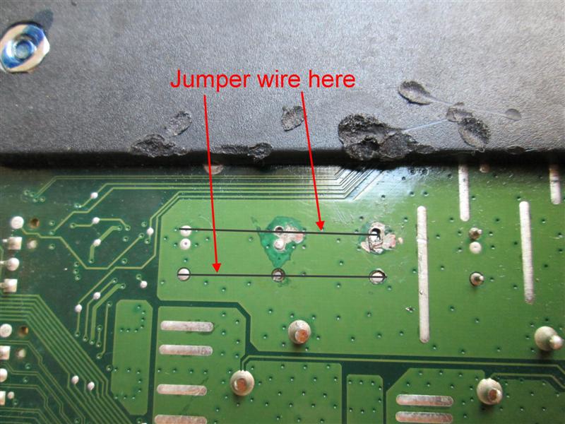

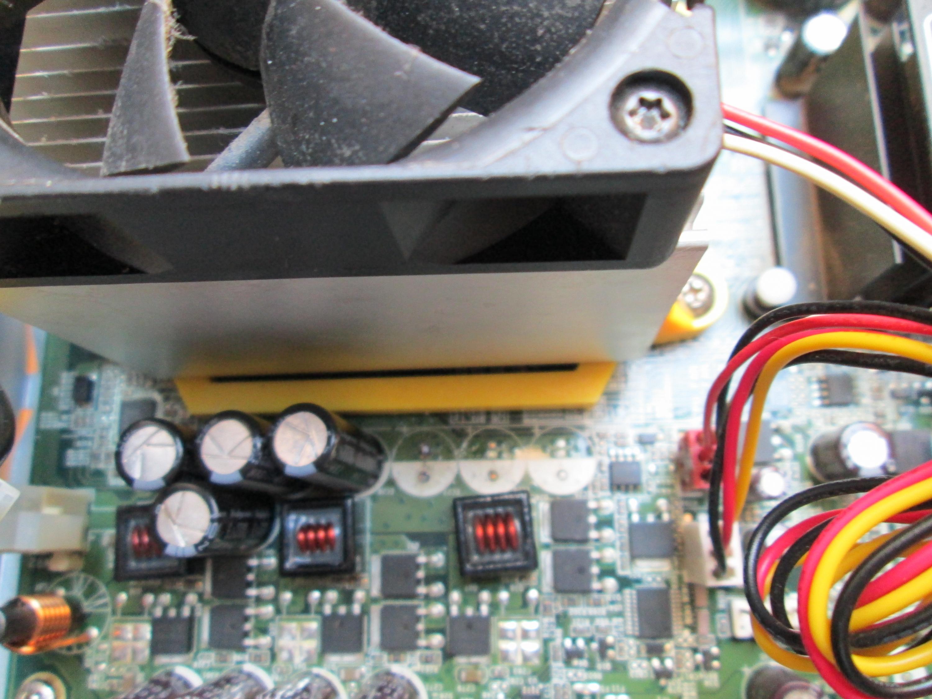

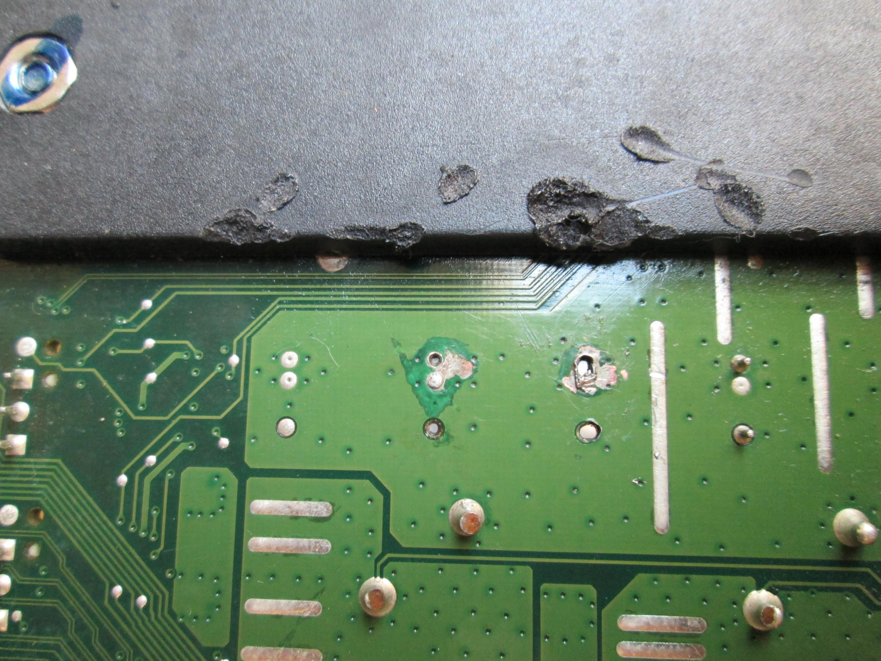

    I tried to replace a couple of caps,3300uf,6.3v next to the CPU on a RS690M03 motherboard and it has been a major hassle,to cut a long story short I drilled out the holes on one of the caps just oversize to what it was originally. Then I thought Oh no! what if it is a multilayer PCB board? Is it multilayer? If it is how can I fix it? What does a cross section of the board look like at that spot so I know what I'm doing? I know that's a lot of questions but I really do need to know if the holes are sleeved with solder and does the solder connect with the copper on one side with the copper on the other?

    It's not recommended to do drilling of bigger holes like that.
    What you can do is to clean (most of) solder around those mistakenly drilled holes. Possibly all 6.3v caps are connected in parallel, like is told here:
    http://www.capacitorlab.com/basic/index.htm
    Then check by measuring (undrilled 6.3v capacitor) holes (+/- holes), that they are not shorted to cause any extra problems. You can do special soldering to add 2 caps into one place..or perhaps use larger capacitors than original ones (so that total capacitance is about the same as 'original').

      I've accidentally destroyed pads too. On the CPU VRM out, the caps are all connected in parallel, so another option is just solder them in as usual and add some wire to the next cap, like so...

                    Am I missing something here the bottom board view suggests that there is one big sheet
                    of copper so if you solder two legs through to that they are bound to be short.
                    We cant really tell but I suspect (Guess) that one leg will solder to that but the other leg would have been insulated from it, and will connect to a trace on the top of the board?

                          BUT if you look to the left in the picture is that an untouched cap? The top leg appears to be soldered to this side of the board but the bottom leg may be just soldered to the "Through" and is insulated from this side - it has a dark ring??. If you could check that.
                          Common sense hahaha we wouldnt be doing this if we had any
                          suggests you shouldnt be soldering both legs to the same trace.

                              is likely to be colder. Anyway on mine I can see one leg is NOT soldered to the bottom of the board plate there is a gap so it is insulated from it. I guess all !!! we need to do now is figure out how to put a cap in so it is isolated . I have an idea but dont know if it would work. Solder in the correct leg but isolate the other but then use a wire as hegge suggested to connect it to the cap that is connected good if it is ok to have them in parallel Tricky but not impossible.
