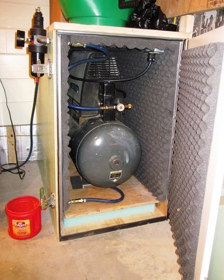

                    • Blargh523
                      • Dec 2012
                      • 46
                      Re: silence an air compressor?
                      Maybe build a cabinet for it?
                      http://www.youtube.com/watch?v=UOpB6oD2lt4
                      Just make sure you have adequate ventilation.
                          Originally posted by Phaihn
                          that might work what kind of materials did you use?
                          Well, it wasn't me, it was random internet finds.
                          The one I attached as an inline pick was made out of 3/4" plywood lined with sheetrock and acoustic foam and the compressor insulated with a few inches of foam underneath it. He removed the petcock and ran it with a hose to a valve the outside of the box for easier purging.
                          IMHO, I'd add ventilation. A couple of carefully placed 120mm fans would do a lot for it.
                          Before going so far as building an entire box, you may first want to just try a muffler for the intake, maybe something like this:
                          http://www.mcmaster.com/#pneumatic-mufflers/=kpo144
                          And for insulating it from the floor, some hardware stores carry rubber blocks or you can do a board-over-foam under it.
