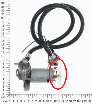

    Also does anyone know what these plastic blades are called/where I can find a replacement? I snapped it by accident and cannot for the life of me figure out where to get another. Pump works fine without so I'm guessing they just serve to cool the motor down? I guess I might need to 3D print one.
    (Edit just 3D printed one)

      Does the motor start no problem as long as everything is warm? As colder it is it harder or even impossible to start? As for the main filter cap, check it for cracks in the solder joint.
      the fan is to cool the motor for cooling. Either fix or replace it.
