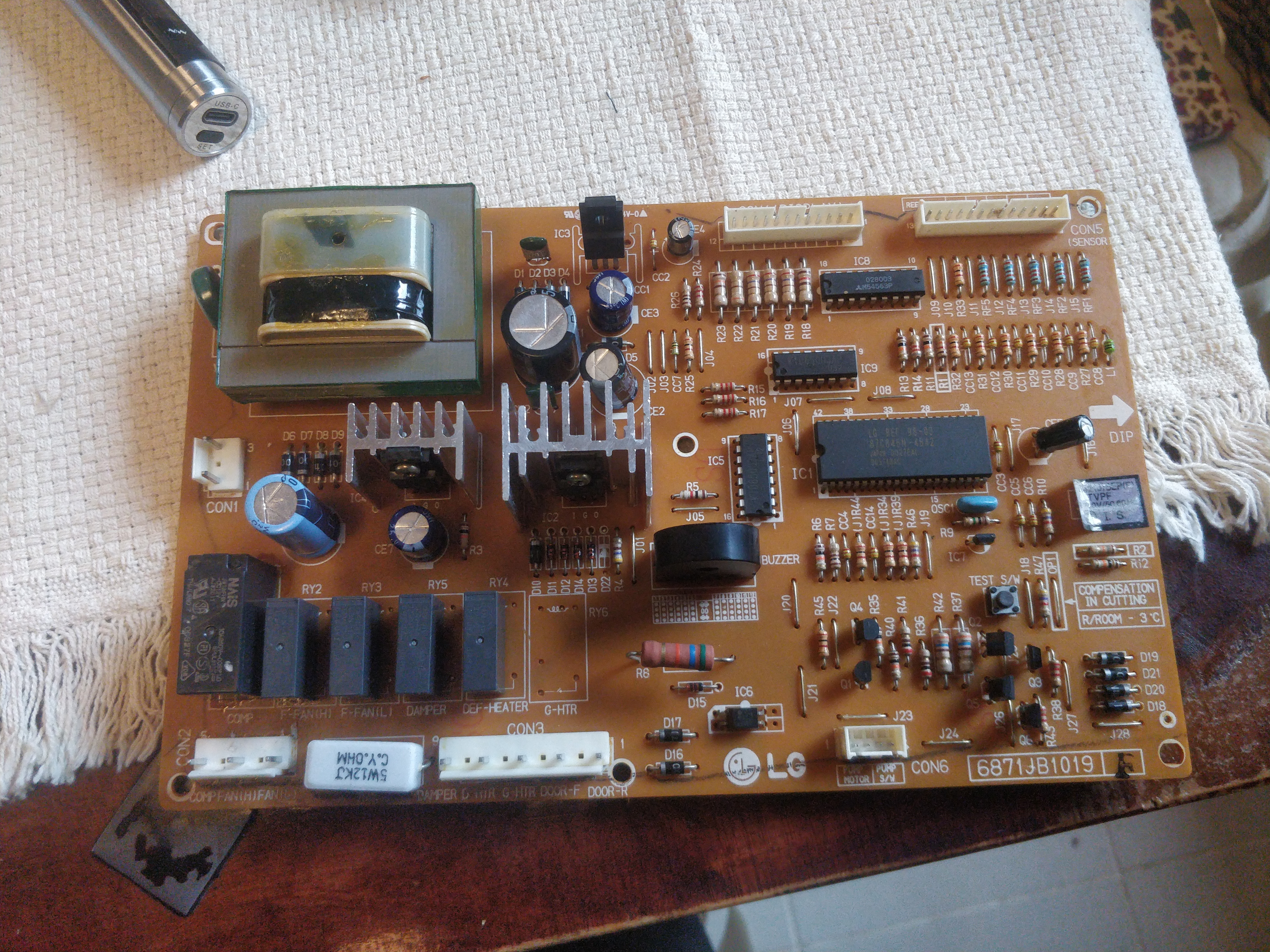

    Hello everyone, my old but loved LG GR-642 stopped cooling and frosting all together.
    The display shows everything as normal, the focused cooling activated when I open the doors but the compressor wont start.
    First I measured the terminals on the compressor at the back of the fridge. 0 volts.
    Now I disconnected the compressor and measured resistance on its leads: around 8 ohms.
    I dissassembled the main powerboard, couldn't find anything suspicious but I noticed that the comps relay wont send voltage to the pin, while Fan H and fan L is indeed at 230V.
    ​​​​​​I removed the relay from the circuit and measured the correct resistance on its coils and I could turn it on with my lab psu.
    What could cause this problem guys?
    Thank you!

    check the protection relay on the motor first.
      • 31015
      looking at con5 i think you need to clean and inspect all the connectors!
      • CapLeaker
        Leaking Member
        • Dec 2014
        • 8146
        What stj said. There should be some sort of a protection device on the compressor. Also check the compressors winding isn’t shorted to the compressor case (isolation test).
        Only because a relay goes click, doesn’t mean it can handle a load.

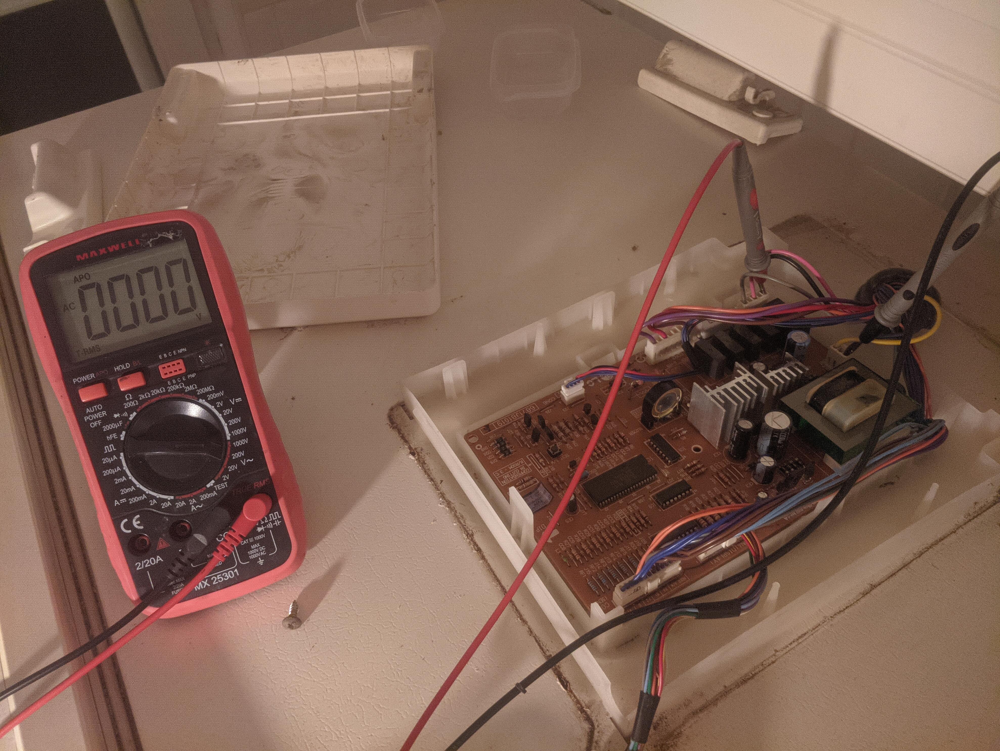

                    Here is some more tests:
                    i connected my DMM to the comp pin.
                    I noticed that as I plug in the fridge, the relay clicks, the voltage goes up then the relay clicks again and the voltage drops off to 0V. It happening in 2 seconds at max.

                        No, the compressor gets power for a second or two, then the relay turns off.
                        The other two pins, FAN H and Fan L getting power. Altough one of them getting 290V while the other 230, don't know if it matters.
                        As I mentioned, the relay does click when I plug in the fridge, delivering power to the compressor but it clicks again as it tursn of moments later.
                        I checked the PTC, the reading were 45ohm on room temperature, it should be okay since it's a 240V system here. Should I check If the resistance increases as I manually heat it?
                        I also checked the OLP next to it, which showed less then 1ohm resistance between the two pins, I guess that also good.
                        I couldn't find any capacitors next to the compressor so I guess it doesn't have any.
                        I also checked the compressor 3 pin, the values does add up correctly so I guess thats also good.
                        Is it possible that the relay on the mainboard is faulty?
                        I mean I removed it from the circuit, applied 12v to it's coils and it does clicks. But maybe it cannot handle the load anymore because of worn out internals?

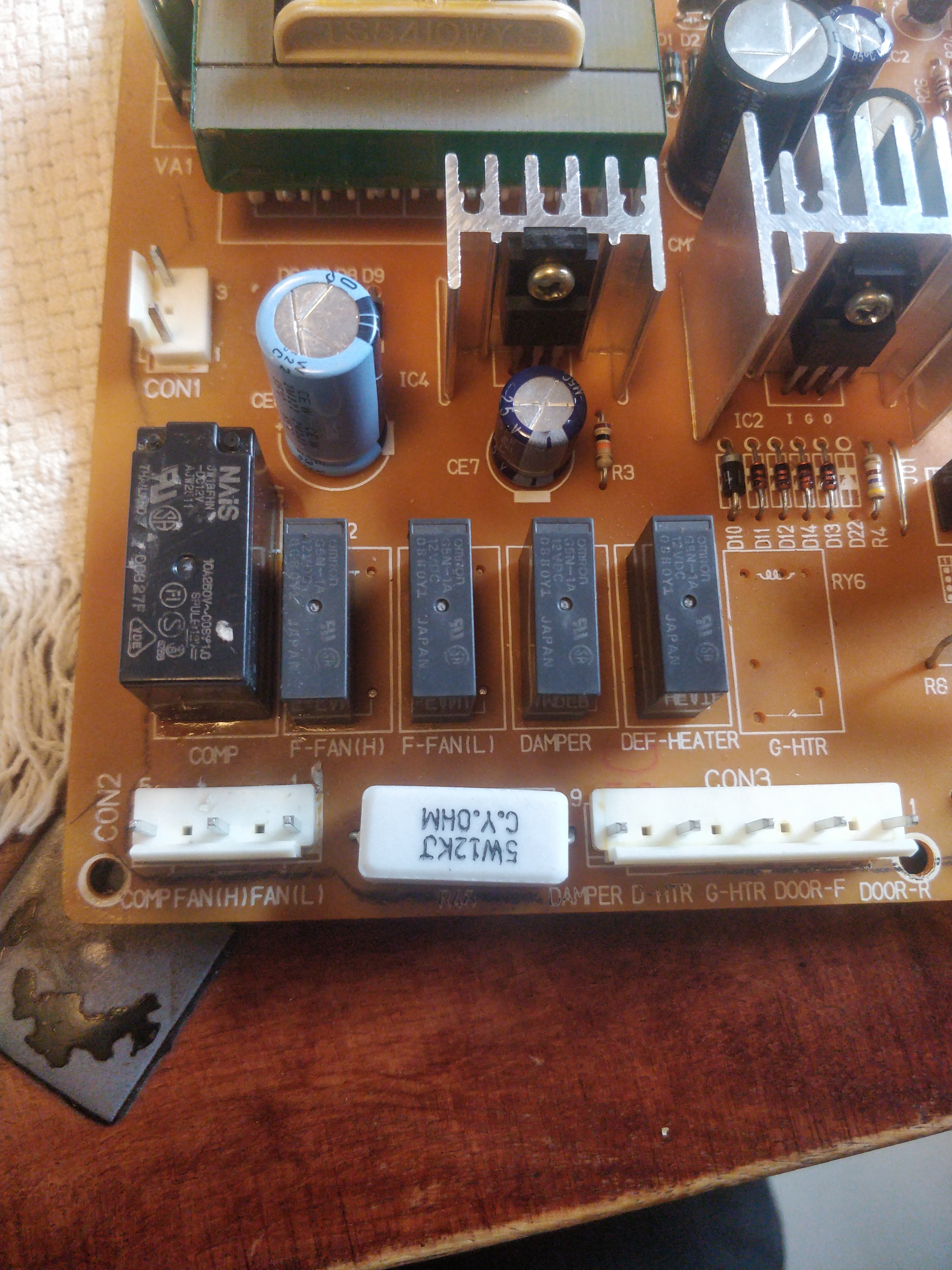

                        • CapLeaker
                          Leaking Member
                          • Dec 2014
                          • 8146
                          Thats what I said before… a clicking relay only means the relay coil is good. Check everything redwire mentioned.

                            Thank you for your help and patience everyone.
                            So I ordered new relays, I tought its better to replace all.
                            After replacing the relays the fridge compresser started right up and started cooling down both the freezer and the refrigator.
                            This happened last night.

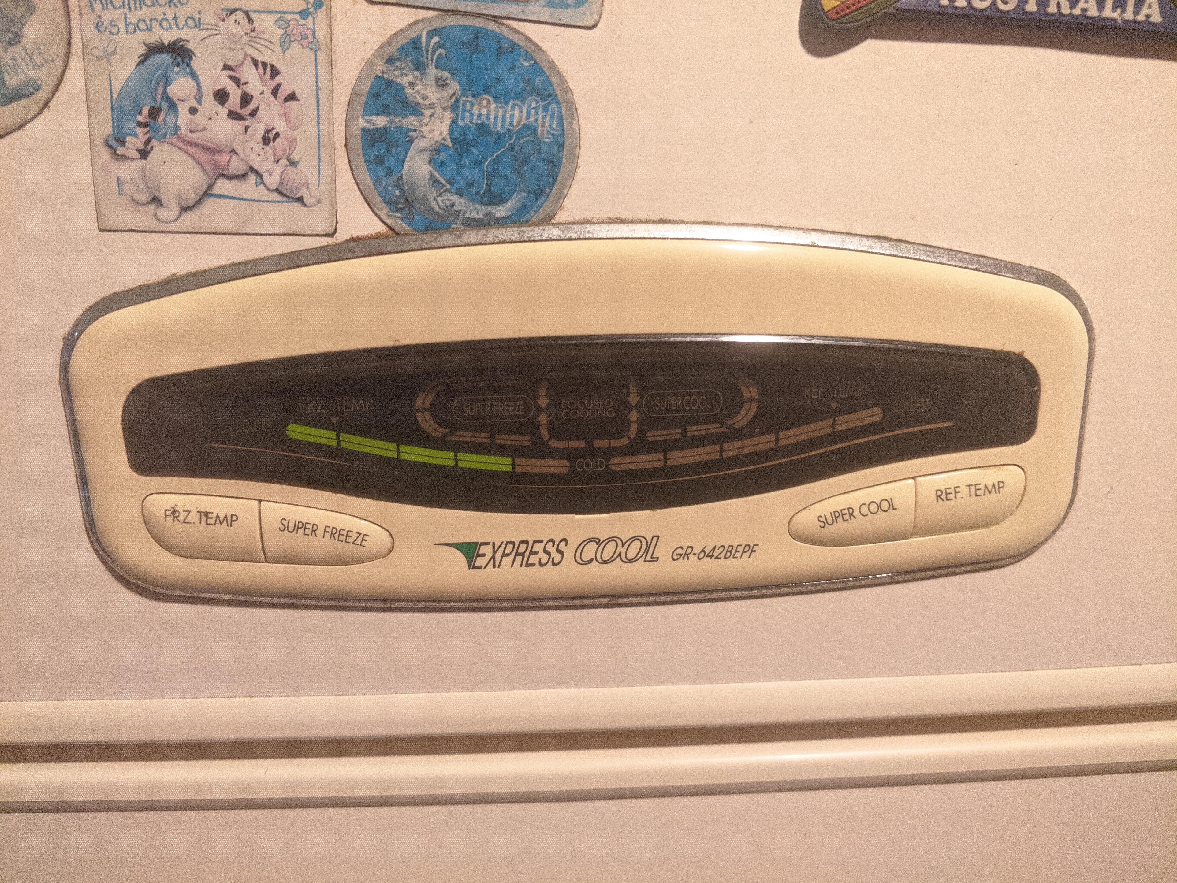

                            Now this morning I noticed that the display showing this error code:
                            The display does not respond to any presses, nor opening the doors.
                            Altough the compressor turns on after opening the doors to cool it down.

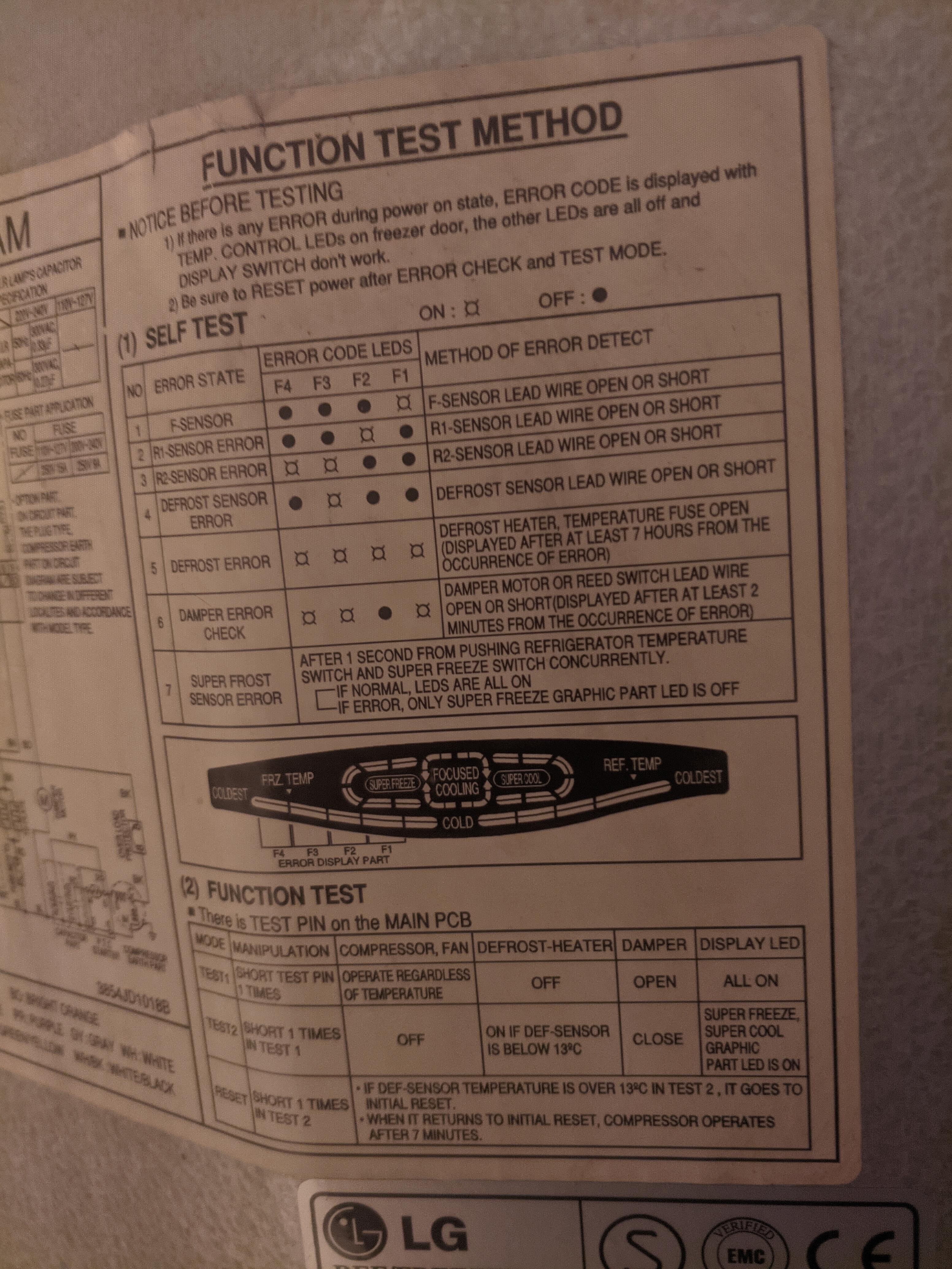

                            I noticed that there is an error code list on the back of the fridge. But the funny thing is that none of the listed codes are like that on the display.
                            What else should I check?

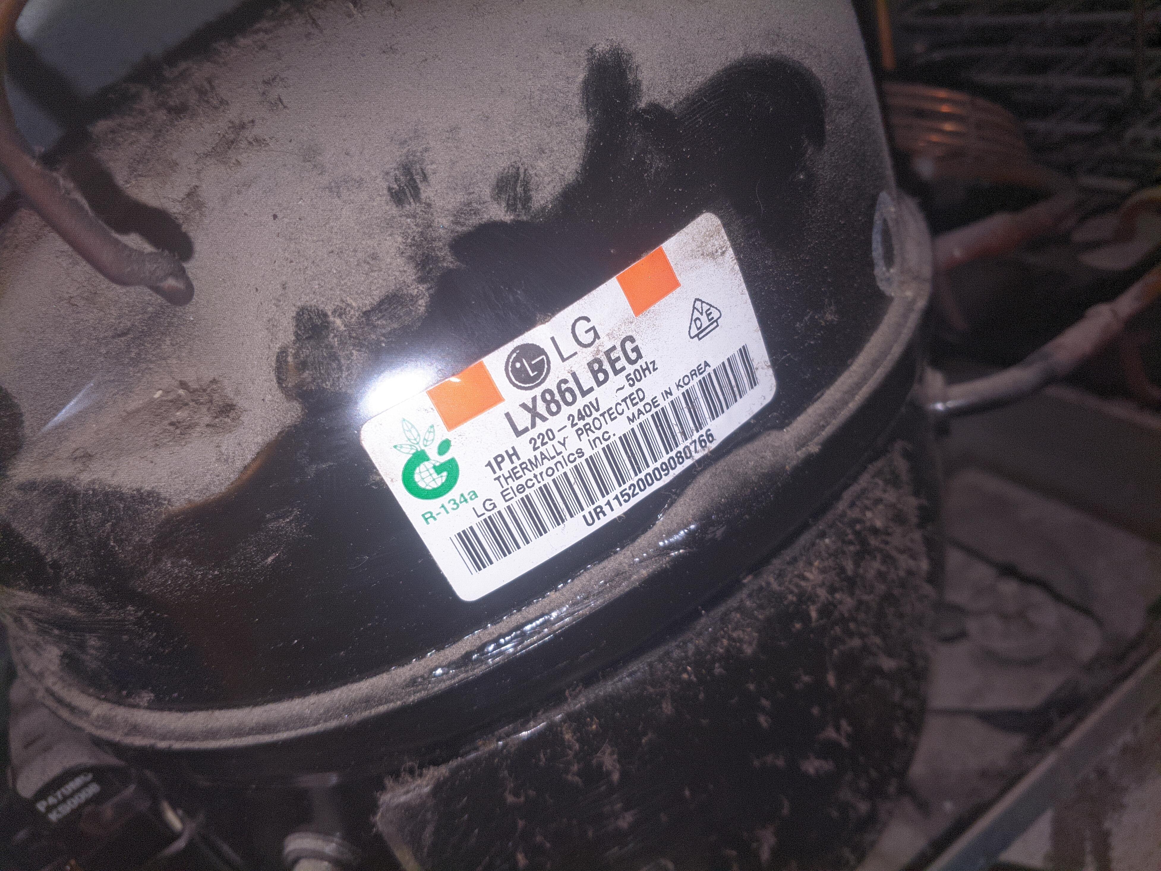

                                Here is a photo of the compressor:

                                  But the funny thing is that none of the listed codes are like that on the display..................... it is self-test no 5, defrost error
                                  • CapLeaker
                                    Leaking Member
                                    • Dec 2014
                                    • 8146
                                    I see 4 leds on. Cording to the chart on the back of the fridge you got a defrost error, the fifth on that list. Check what is sez: Defrost heater temperature fuse open.
                                    • redwire
                                      • Dec 2010
                                      • 3907
                                      Yes a new problem, not related to the original problem? It looks like now if failed doing a defrost cycle.
                                      Check all connectors, and the new relays one might be wrong.
                                        • Jul 2011
                                        • 6039
                                        Check the defrost sensor ohm reading is it correct for the part number if has on I personally seen too many temperature sensors fail in some weird way so please check it
