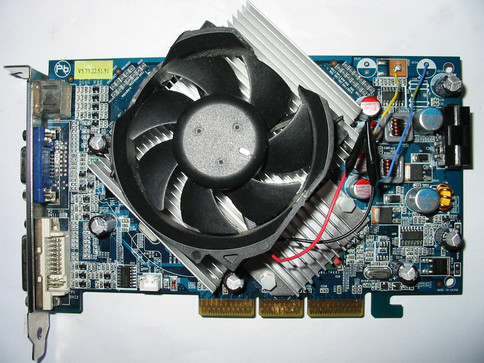

          Here's a GeFoce 7600GS of mine I got for free:
          https://www.badcaps.net/forum/attach...1&d=1353381100
          ^ Custom heat sink is made from an Xbox 360 GPU heat sink. Had to do only minor trimming and cutting to make it fit.

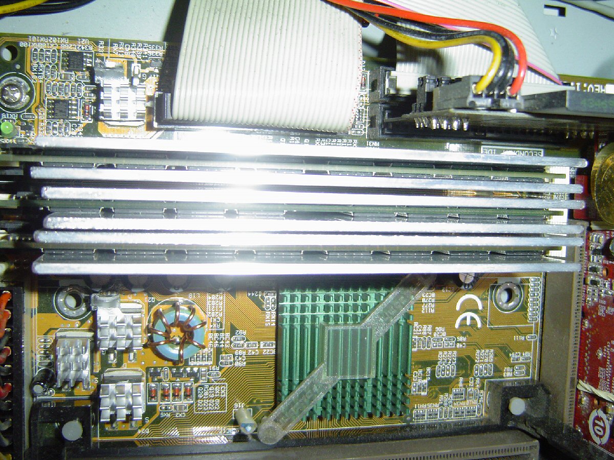

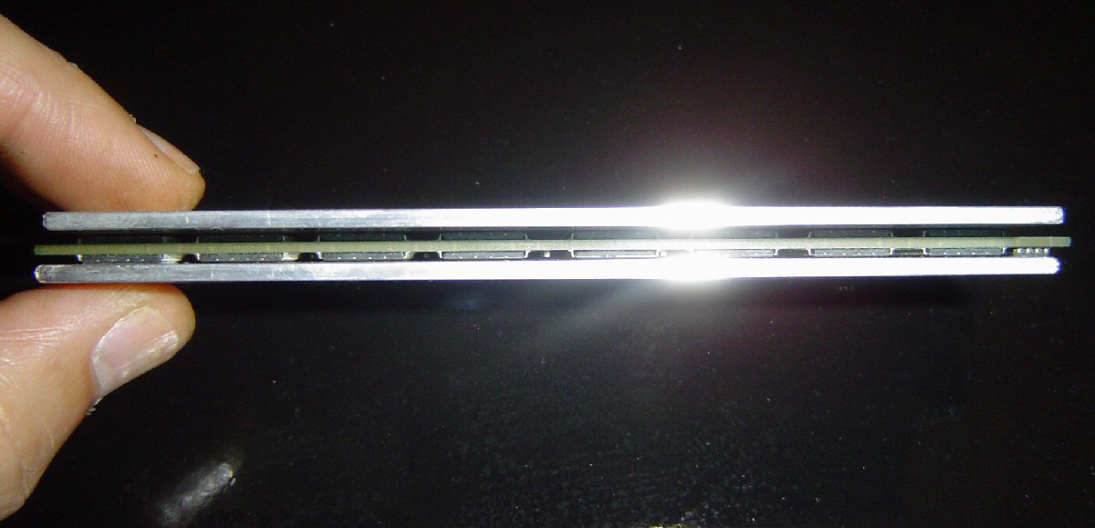

            That half-of-a-fan of yours has raised the bar a lot , but I'll try. Cavemen RAM sinks cut to shape from 60mm wide, 2mm thick aluminium strip.
            Your move .

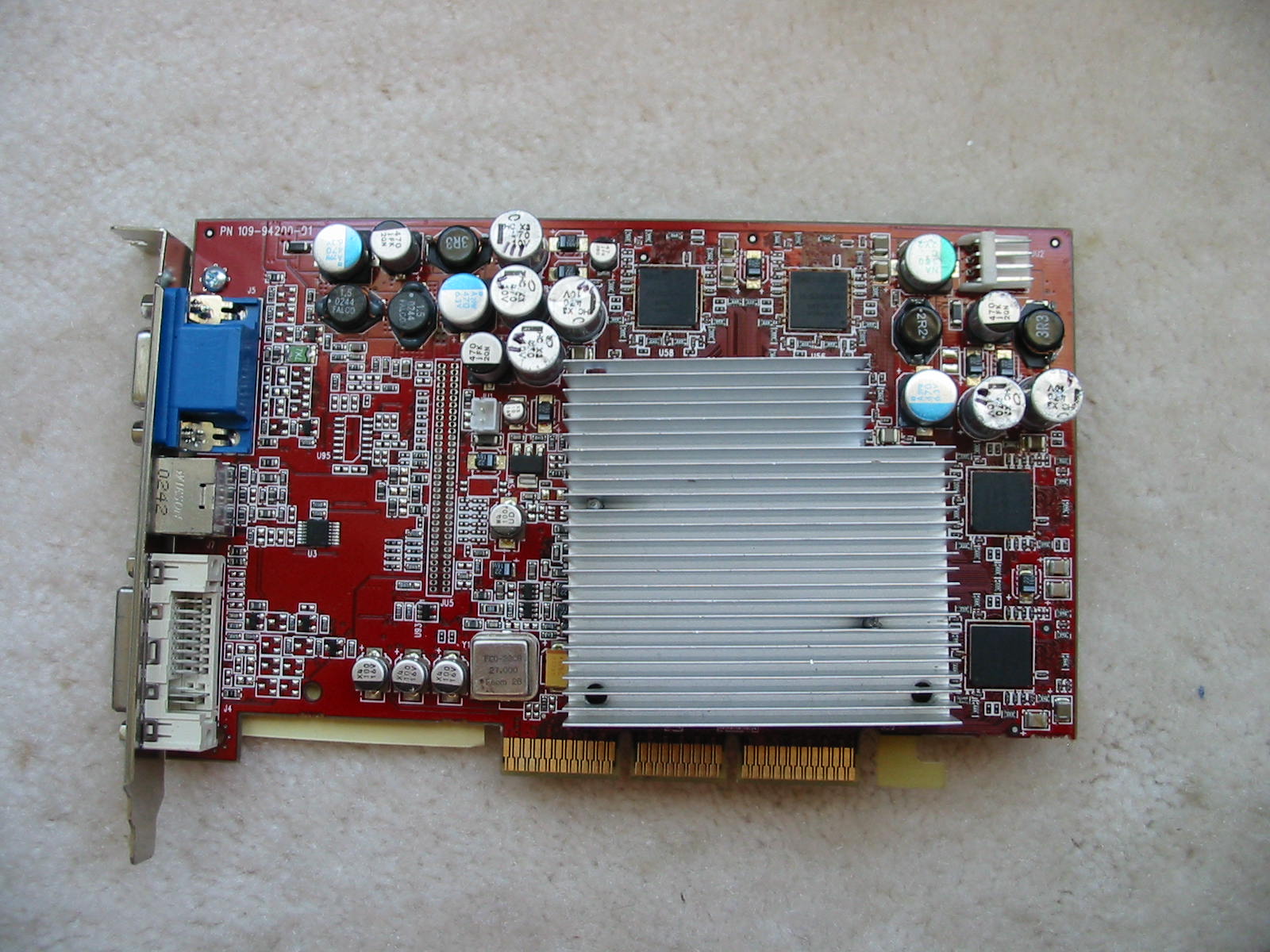

              A Radeon 9500 Pro / 9700.
              https://www.badcaps.net/forum/attach...1&d=1353991011
              ^ the heat sink is again made from an Xbox 360 GPU heat sink, as is the retention bracket, lol:

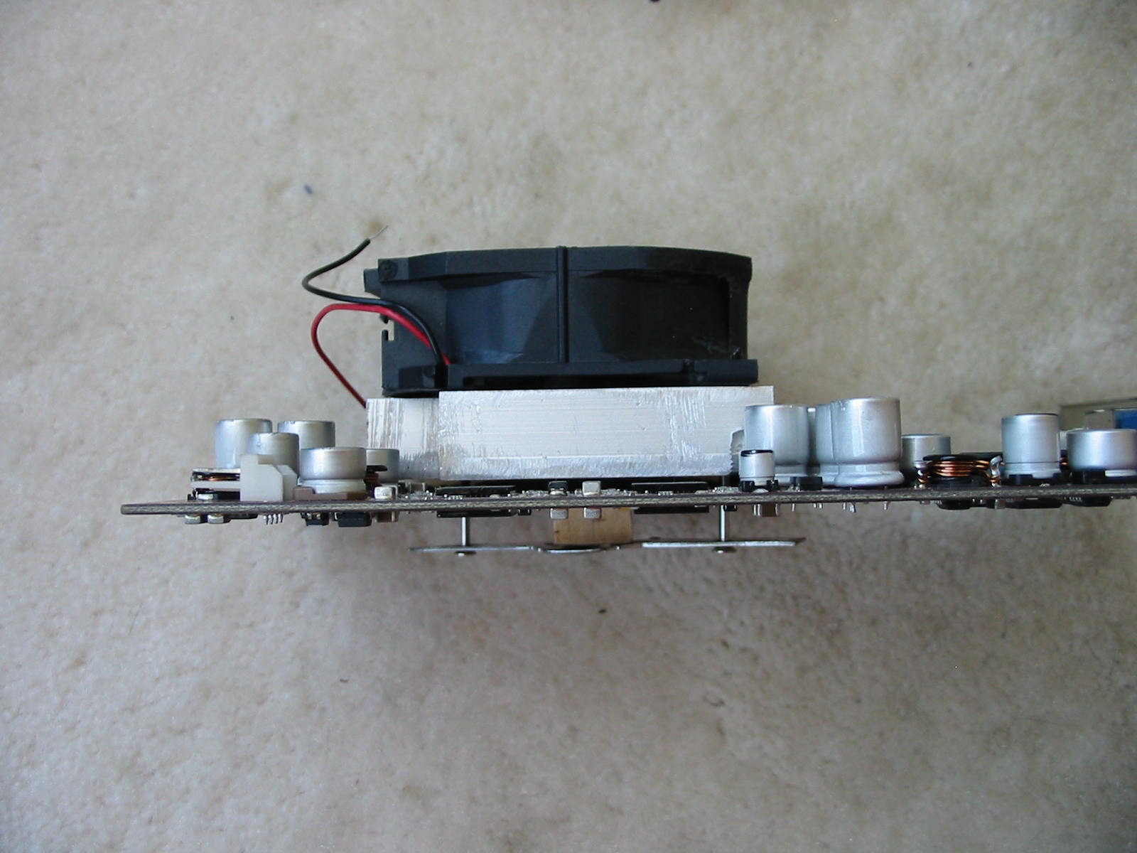

              Another shot of the retention bracket:
              ^ yes, that's a piece of a wooden block. It sits right under the center of the GPU die, so the force from the heat sink won't bend the PCB and crack the BGA joints on it.
              Another shot:
              ^ This one shows the half fan I used in the 7600GS above. Originally, I was going to use it with this Radeon card but decided it was too heavy and bent the PCB too much so I decided to use it in the 7600GS instead. I do have the other half of that fan, though, so I can always put 1 on this card too
              And here's the whole setup:
              And the reason for this mod - I have 3 more of these Radeon 9700 cards that are working and only 1 heat sink that fits them (a Chinese replica of the 9800 Pro heat sink, that is - but it's well made). So that means I need at least 3 more heat sinks. And I say at least because I have 4 more 9700s that still need to be fixed/re-flowed so with some luck I can have up to 7 of these.

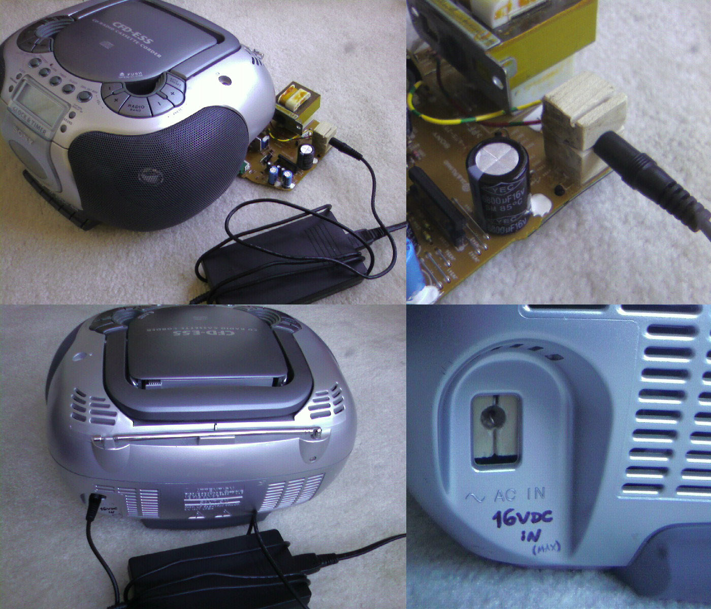

              Another specialty of mine is custom power connectors for power adapters. This is the first one I did:
              I found this boombox in the trash many years ago. It worked fine on batteries but not on AC. The primary on the transformer inside it went open circuit. I can actually probably repair it now since i have a temp. controlled soldering station that can desolder the traffo (back when I did the ghetto connector mod, I didn't have that station, so that wasn't an option)... But I like making those plugs. The power adapter you see in the picture is (IIRC) 15V, 4A from a laptop. The bulk amp cap is rated for 16V (hence the "16VDC in max" note I put).
              Since that mod, I have made quite a few other connectors. Even the camera that took all of these pictures uses one for the power converting cable . The tone controls for my headphone amplifier are another example. Up until last week or so, the tone controls were still on my breadboard and the way my computer connected to them was through some home-brew audio jacks made of wood and staples. I suppose words aren't much good in showing this. I'll try to take a few pictures of these things this week and post them.

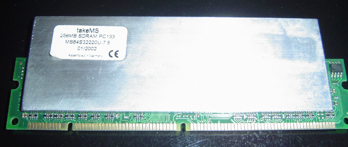

              http://www2.picturepush.com/photo/a/...g/11451510.jpg
              Planning on some crazy overclocking there?
              Looks good, though. I like how you removed the sticker on the RAM and put it on top of the heat sink - that way you don't have to remove the heat sink to see what kind of RAM you had in there (plus, the RAM chips cool better).
                  That transformer doesn't look big enough to power a boombox. Maybe you can ghetto mod a bigger transformer into it. If the transformer has a thermal fuse inside, you could do a ghetto mod to bypass it like I did to a Harbor Freight cordless drill battery charger.
                    Well, it's a small boombox anyways. I don't remember the exact rating of the speakers or the amp IC, but I think both were rated under 10W total. The traffo IMO looks big enough for 0.5A at 12V continuous and maybe 1A peak, so it should be good enough. Or maybe you're right, I don't know. The primary is open, though, so it likely has a blown thermal fuse as you suggested.
