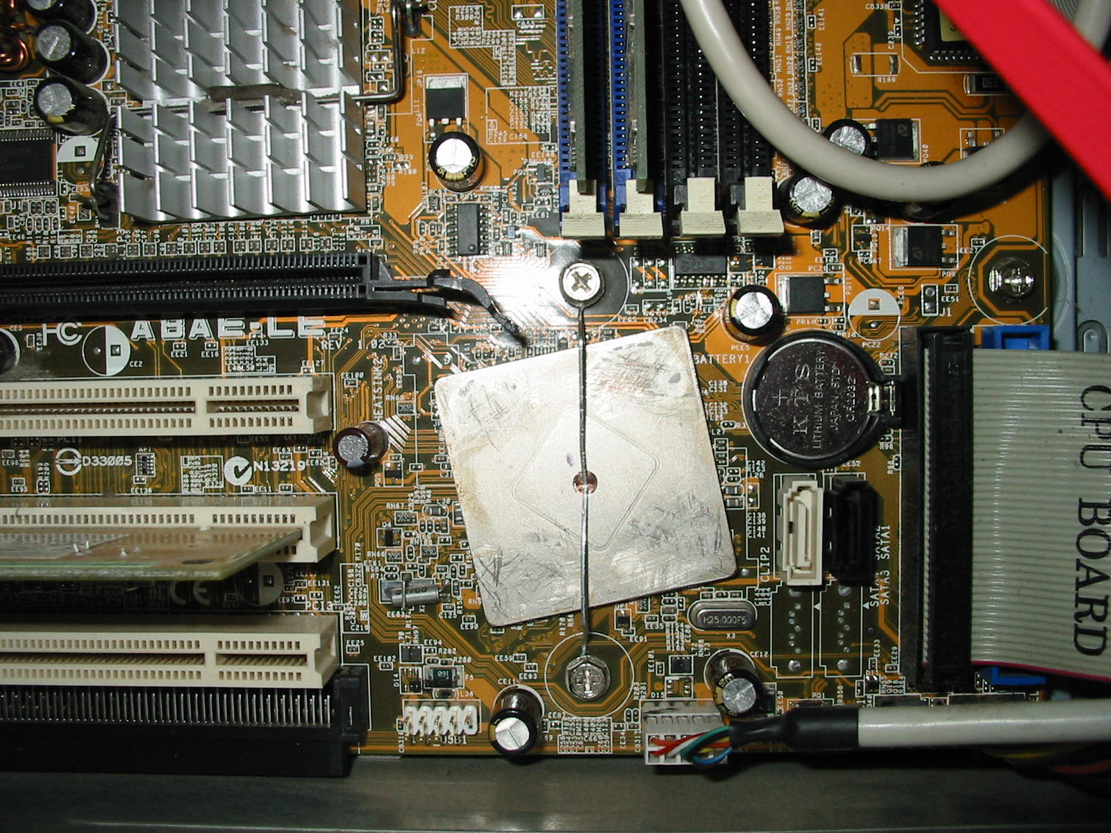

                                I don't think I've posted these...
                                I don't really mind bare chipsets, but when they run so hot that you can't touch them even for a split second, you know a heatsink is needed. These were running about 50 to 55C when the system is idle and PC case opened!
                                (Before) bare Southbridge (SB400) of an ASUS A8AE-LE motherboard:
                                https://www.badcaps.net/forum/attach...1&d=1391897638
                                (After) covered with a simple copper heat spreader from a PS3 GPU chip.
                                Temperatures? About 5C lower at idle. Yes, that's not much of a difference (it would help if I soldered some fins on it). But at least it takes a while to build up to that temperature, so the chipset temperature is a little more constant (always better for the BGA). Now, with a small 60 mm fan blowing just a little bit of air over it, the temperature dropped to about 40C idle and 45C max under full system load.
                                Here is another one I did (this time with a PS3 CPU heat spreader):
                                It's a SB450 Southbridge on a MSI MS-7191 motherboard. The temperatures with and without the mod were similar.
                                The metal "bracket" that holds the heatsink on the ASUS board is just a paperclip bent to shape. The second one is made from those metal handles from Chinese food carry out boxes since they are a bit more springy and thicker than paperclips.
                                Don't worry, though! Those heatsinks are pretty secure . I dropped the PC case on purpose a few times from a small distance (without the CPU heatsink, of course) to see if my ghetto mod would hold. And it did. Good enough for me .
                                • c_hegge
                                  • Sep 2009
                                  • 5219
                                  #156
                                  Re: The ghetto mod thread
                                  I can't believe I've never thought of holding on a chipset heatsink like that before. I always use thermal epoxy and stick in in position (and use a real heatsink with some fins).

                                      Originally posted by momaka
                                      ... (it would help if I soldered some fins on it) ...
                                      Yup, a lot. A flat plate means a thick boundary layer and hence poor heat exchange with the air. Heatsinks need fins, the taller the better.

                                        #159
                                        Originally posted by 3d0
                                        Like c_hegge I stick it in position, never thought to use the holes in the mobo. in such a genius way.
                                        Genius? lol, okay, thank you .
                                        The only reason I did it that way is because I just couldn't think of any other way. I mean, I know about thermal adhesive pads, but I always forget to buy some when I'm shopping online. Plus, they aren't the best for thermal transfer and I wanted to get this done the same day. Also, my local Micro Center carries Arctic Alumina Thermal Adhesive, but that stuff is $10! No way I'd spend that for a ghetto mod! Heck, I got the whole motherboard for like $15.
                                        Speaking of which, what do YOU all use to glue heatsinks to chipsets and MOSFETs? (especially you TELVM - I've always been amazed by your CPU VRM cooling mods).
                                        Wow, you have a thermal camera?!
                                        Well, at least my "heatsink" is spreading the heat evenly on the chipset. Hence why it's called a heatspreader on the PS3 GPU/CPU .
                                        Maybe I can solder some pennies as the fins. That would be funny IMO . (but probably effective, nonetheless).
