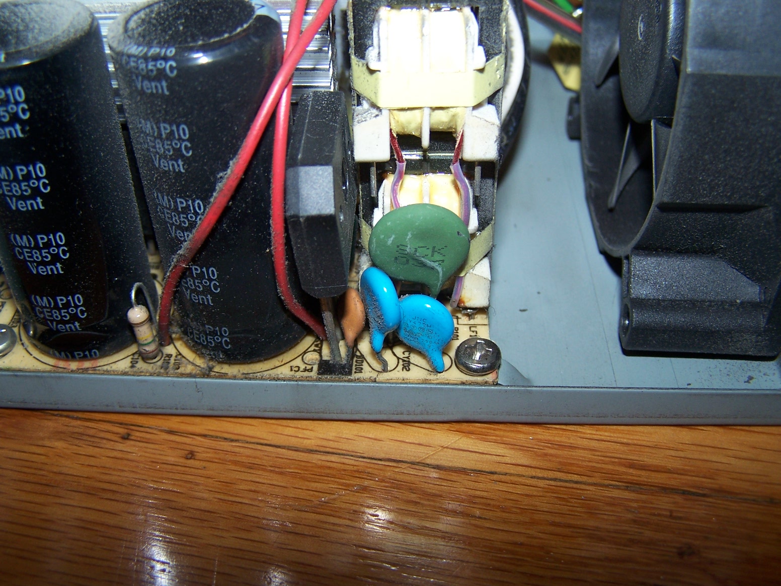

      It uses a weird double choke :
      While I am glad to see imput protection, this isn't how it should be done:

            That's a Young Year PSU. You got a good one with the full input protection circuitry populated. I tried to re-cap one that like that once, thing blew a fuse when I plugged it in. If the speaker outputs on the back panel are horizontal, then it's pre Pentium 4. Not worth even $5. Too fast for a vintage gaming system, too slow for modern use. Also, that VRM looks too puny to put a serious Tualattin chip in there like a PIII-S and the chipset is a VIA.

                  And LOL, is the stacked-choke in the psu a first!?
