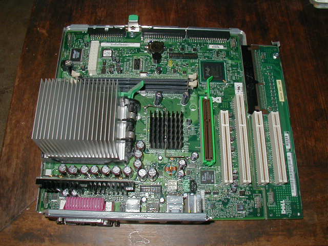

                                Actually, Most OEM things DID use backplates of some form... Even dell, who used threadless backplates with pushpins (opltiplexes)... the other common form was using standoffs that went to the mobo tray and used the tray as a backplate (dell dimension, anything HP/compaq).
                                I also correct both you and I, as there were 604's without backplates... look at the pics in the Supermicro X5DAL manual...
                                BTW, that pic isn't mine... I found it online... I re-homed my Gx260 18 months ago.

                                        RD, the Dell underplates were not for support, they were to align the tray with the case. They offered no support for the underside of teh board. Dell had some plates that screwed to the bracket and were pretty tough (came on some GX270 and GX280 systems)....but as a rule, the standard 478 mechanisms were crap. I cant tell you how many I've seen with broken tabs that made the sink come loose, and cause all kinds of thermal issues and cooking things......
