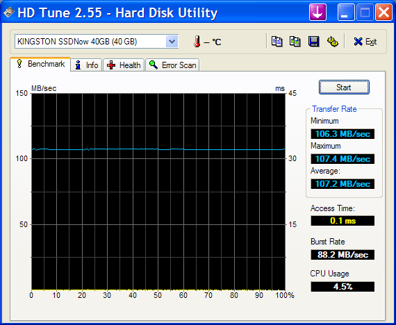

      Here are some numbers from two SSD's
      The first is from my parents HTPC, it uses WinXP and thus does not have TRIM support.
      It is a Kingston SSDNow V Series 40GB SSD that is now 2 years and 2 months old.
      It is connected to a Epox 8RDA3+ mainboard with a Silicon Image 3112 1.5Gbps SATA controller...
      Note the yellow "access time" graph?
      No?
      It's because it's below 0.1ms so it can't be plotted, it's just a flat line!

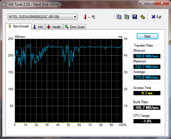

      Next up is my friends Intel X25-M G2 80GB SSD, it sits in his laptop which runs Win7 x64.
      It's nVidia GPU failed so these numbers are with it connected to my own system with a 3.0Gbps ICH9R controller, using Windows AHCI drivers.
      No?

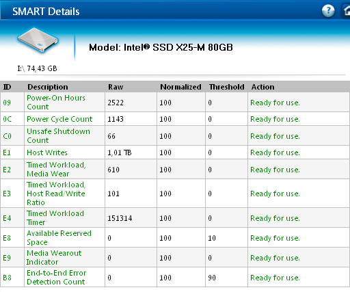

      Here is a Intel Solid State Drive Toolbox picture from it:
      He uses it for everything, including saving x264 movies to it that are 4>8GB in size and watching those on his TV.
      Since the laptop has HDMI (Well he did untill the nVidia GPU failed anyway)
      Yup only 1.01TB host writes (E1). It actually increased to this from 920GB today.
      Because I used "Intel Solid State Drive Toolbox" to run a "full diagnostics scan" to it which writes to all cells, no problems reported...
      Since E4/60=2522 hours (same as "09") the counters have never been reset for the life of this drive.
      Thus for the life of his drive it has been used to E2/1024 = 0.596%

        @ Per Hansson: your screenshots show why I've linked to a newer (allthough already outdated) Pro version of HDTune, which has a seperate access time benchmark just like in this screenshot I posted earlier
        https://www.badcaps.net/forum/attach...1&d=1330196689
        That one only shows the access time and the speed at the given chunk size in a table, rather than having the access time indistinguishable at the bottom of the graph because it's getting dwarfed by the linear read speed graph.

                          This should be able to display the raw SMART values (unlike OSX's own Disk Utility, which is so dumbed down it can basically only say "OK" or "Failed")
                          http://www.volitans-software.com/smart_utility.php
                          Some of the SMART values should reveal interesting details, like total host writes or the like.
                          If you go by the ID's of this screenshot it should give you an idea of what means what (at least roughly)
                          The "raw" values are usually the most useful
