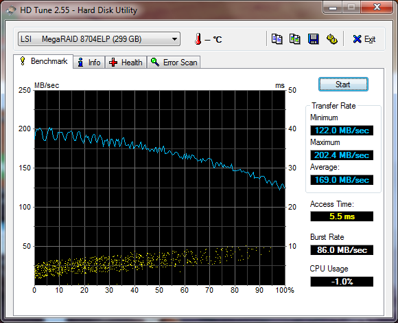

                      If what you are really after is performance for games or photo shop or whatever then you are better off setting up a system with a RAM drive.
                      [Meaning -not- the Flash memory type.]
                      It's not going to start faster but once you are 'working' your transfer rates will be up in the Gb/s range.

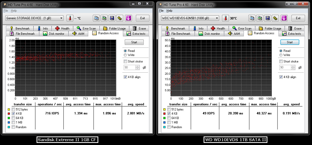

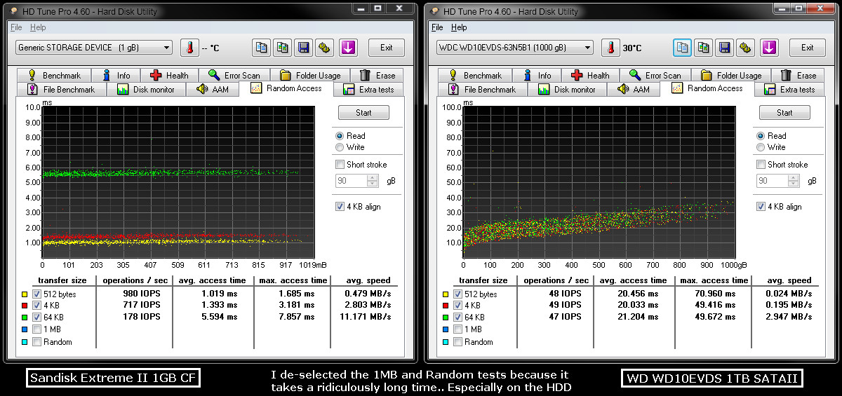

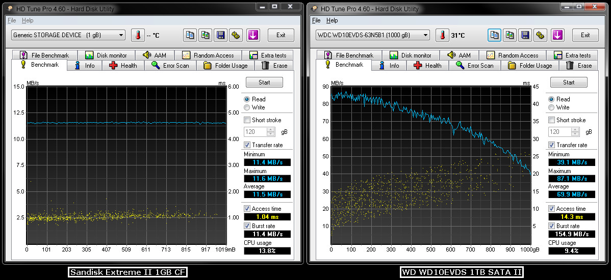

                          ^ that alone shows how little you actually know about SSDs.
                          What they're testing is the endurance. NOT the speed.
                          The constant/linear write speed they're logging ISN'T EVEN WHERE A SSD IS FASTER than a mechanical harddrive.
                          Sure, a modern higher-end SSD manages ridiculously high linear write/read speeds of 200MB/s or more, but that's just an added bonus.
                          Where mechanical harddrives totally suck balls is at small files, i.e. 4k or less.
                          And that's where SSDs generally shine, with read/write speeds of around 15MB/s or more, where a regular HDD manages around 300KB/s at best.
                          That's the main reason why the whole system feels much faster when using a SSD: The shitloads of small files and data queries in just about every system.
                          And that's exactly what ISN'T of value for an endurance test like that, and therefore isn't even logged. They only log the write speed to see at which point (in relation to SMART health values etc.) the constant/linear write speed takes a nosedive, indicating shit hits the fan.
                          All I've addressed with my post is your BS statement that a SSD lasts 2-3 years at best and that you can't recover any data once it's "dead" / "worn out" (not usable anymore -> read only). Your post twists everything in any possible way to fit your opinion, stating pointless comparisons along the way. Great job.
                          As for the 4KB speeds: I currently don't have any "real" SSDs at hand to do a comparison, but even a flash-based CF card (in my case a Sandisk Ultra II 1GB) already shows what I mean (attachments).
                          The last screenshot shows the linear read speeds, just to show these don't have anything to do with the small file access speeds.
                          If anyone who's still reading this (despite the shitstorm happening) has both, a real SSD and a HDD, feel free to grab HDTune and do an access time comparison between the two and post a screenshot.
                          (You can run multiple instances of HDTune for a side-by-side comparison.. just BTW)

                              OMG, My Seagate Cheetah 15K.7 300GB 15K RPM drive connected to a LSI 8704ELP SAS RAID controller with 128MB cache gets slower the more I write too it.
                              Obviously mechanical HDD's sucks!!!
                              PCBONEZ; Incase this is before your morning coffee the above was meant as sarcasm.
