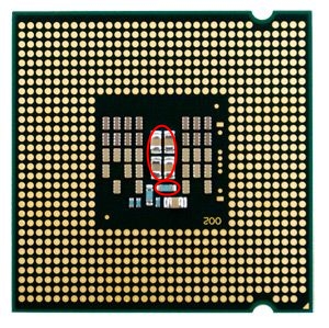

    OK so somebody gave me an Intel Q9300 CPU:
    http://ark.intel.com/products/33922/...333-MHz-FSB%29
    But he claims that it's broken because he was doing some sort of voltage mod and it got shorted.
    He's like "you can have it but don't kill your mobo"
    i found this http://www.hothardware.com/articleim...42/small_3.jpg mine is missing the 4 tan thing in the middle and one of the blue thing... is that bad?
    I've got an ECS/Elitegroup motherboard, that IIRC supports 1333 Quad cores.
    Can I test the CPU without risk of mobo damage? How do I fix the CPU?

                      The "tan things" are ceramic caps. Most of the time, those are there to filter high-frequency ripple going to the CPU so the CPU may actually still work without them (but maybe not very reliably). I'm not really sure what the "blue thing" is - I would guess a resistor most likely... and very likely the CPU won't work right without it (and by that, I mean it probably won't get recognized by the board, assuming that it hasn't been damaged in any other way).
                      As for whether or not this CPU can damage your board - I'm not quite sure.
                      If your board supports quad cores, then I would guess most likely not. Normally the PWM controllers for the VRM MOSFETs have the option to shut down if they are overloaded. But who knows if ECS actually decided to use that option.

                              • shovenose
                                Send Doge Memes
                                • Aug 2010
                                • 6575
                                Re: Test CPU without damaging motherboard?
                                I've circled in red the missing components.

                                  • smason
                                    • 1652
                                    Yup, confimed. Those are "tan things" alright!
                                    Hey, if you can write your own browser, a few "tan things" are hardly a challenge.
                                        Well, I tried it in my other S775 PC (Dell Optiplex 745) that usually Beeps and makes a loud fan noise when you stick a 1333 FSB CPU in (I've tried)...
                                        anyway, it smelled like shit and didn't even beep...
                                        I was afraid I fried my mobo but I put a Pentium Dual Core back in and it's fine... (I didn't want to put the E6600 in again in case it would kill the CPU...
                                        Result: bad CPU, no mobo damage!
