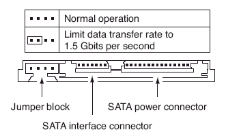

                                      Here is a question that my local shop assistant answered incorrectly. Are SATA2 HDDs backward compatible with SATA1 controllers? The answer is YES. However you can experience issues like system not recognising the new drive or if you connect one SATA1 drive and one SATA2 you can get system lockups. This is because your controller does not support SATA autonegotiation speed.
                                      So you have to add a jumper to force the drive to sata1 1.5 gigabits.
                                      http://www.seagate.com/support/kb/di...sata_lock.html

                                        well the jumper works. i have a 7200.9 sata2 running on a sata1 controller happily at the moment testing. Actually the 7200.9 series are the most available seagate series here currently. I was surprised to get a 120gb pata today and see it was also 7200.9.
