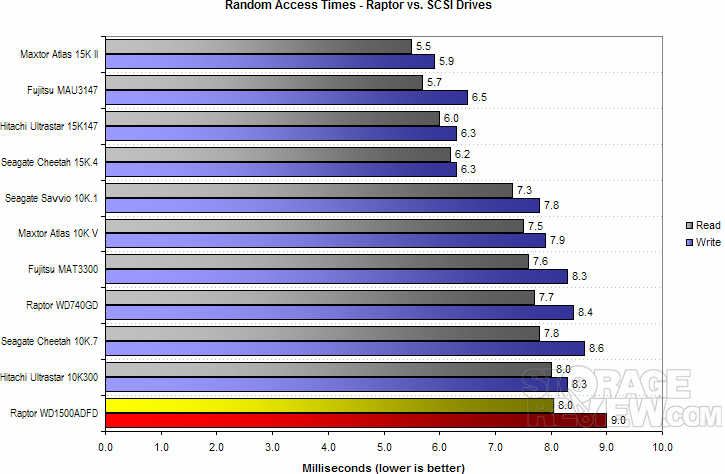

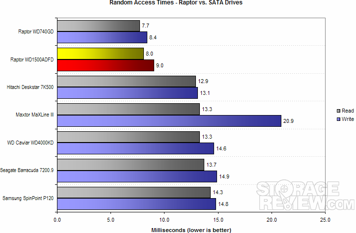

      Not to bash on you Zorry or anything but if you take a looksie over at Storagereview they have a very nice benchmarking rig, so all their current tests (done with it) are comparable
      You will see that the Raptor is way way faster in access time, actually for desktop use it is even faster than almost every single SCSI 15000RPM harddrive; because they are built for fileserver usage, not single user usage cenario
      http://www.storagereview.com/article...500ADFD_1.html

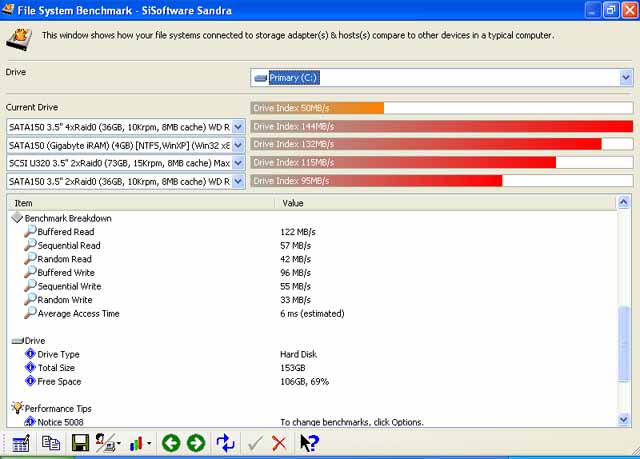

        Did you even look at the benchmarks I posted? I'm scoring 6ms in access time. The access time for the Raptor in that review posted between 7.7 and 9ms. So, it's slower than my system. As far as transfer times are concerned, obviously my Hitachi can't match the Raptor.

            Oh, and no, I do not trust any other site bar storagereview when it comes to harddrive benchmarking, because they know what the actual numbers mean and are able to explain them properly
            Oh, and just to be sure, so your drive scores 6ms... Okay, lets take a looksie at the fastest SCSI 15000RPM drives in the world:
            This would put your 7200RPM desktop drive right up there with the Maxtor Atlas 15k drive and Fujitsu MAU. There this time I did bash you but I can simply not stand to read misinformation like this
            Nuff Said X2

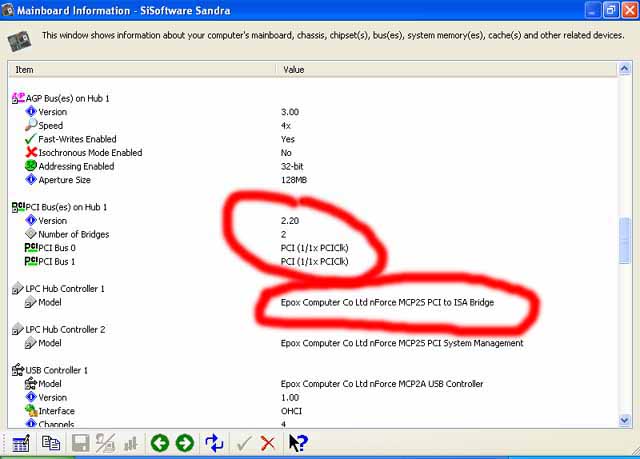

                            Re: HDD Discussion
                            Originally posted by tiresias
                            Q. How can it be, that a Hitachi 7200rpm drive be as fast in terms of access time as a SCSI 15000 rpm Maxtor Atlas on a LSI Megaraid PCIX controller?
                            A. Why 'tis simple. The Hitachi has been OVERCLOCKED.

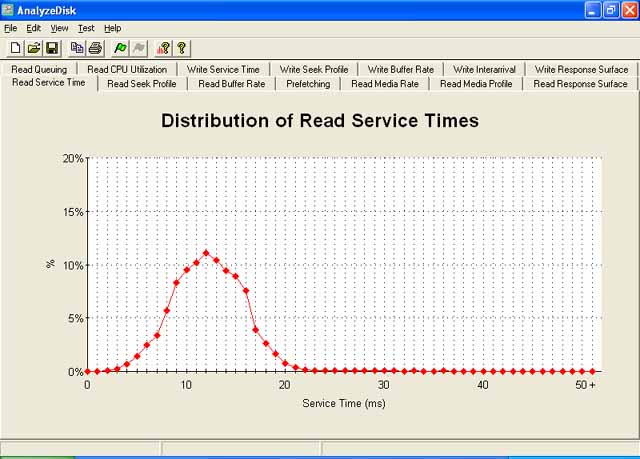

                            1. I'm using an NForce2 based motherboard, the PCI interface is independent of the FSB/DRAM, therefore the hard drive is not overclocked. See attached.
                            2. I did two tests of the hard drive, one with SiSoftSandra, the other with AnalyzeDisk, the same program used by StorageReview and Tweakers. Sandra posts an average access time of 6ms, AnalyzeDisk reports 12ms, see attached. Both scores put my drive in the SCSI/SATA range. That puts my drive in the same range as an IBM Ultrastar 18ES 9GB SCSI according to your venerated websites. So, yes... a PATA can drive can be that fast, even according to the program/website you support. You have no where to go with your arguments now.

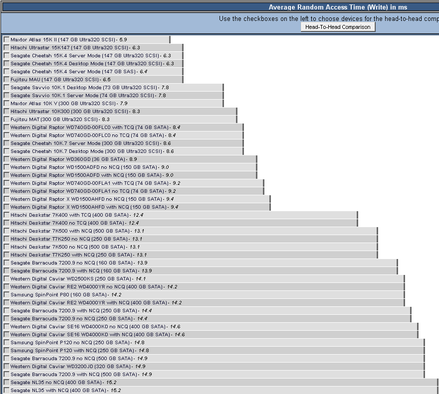

                                  Zorro, you still did not say what harddrive you actually have but I can assure you that the difference between a drive with IDE and SATA is negliable, if you do not trust me you can look up an article at Storagereview where this was tested and see for yourself... (of course the drives themselves must be identical, i.e. for example a Maxtor Diamondmax 11 with either SATA or PATA interface will be within 2% of each other.)
                                  Sisoft sandra is useless as a disk benchmark, it is a highly unreliable estimate and that is it, serious review people never use it for anything bar a one note that okay, it can deliver this theoretical bandwidth or whatever you want to test...
                                  Storagereview uses IPEAK SPT's AnalyzeDisk suite and just as you yourself prooved your drive scores 12ms, just like most other IDE/SATA drives in the same league...
                                  Quote: "Average Write Access Time- An average of 25,000 random write accesses of a single sector each conducted through IPEAK SPT's AnalyzeDisk suite. The high sample size permits a much more accurate reading than most typical benchmarks deliver."
                                  Note: to make this image smaller the slowest drives have been removed, it is from the Storagereview performance database:
                                  http://www.storagereview.com/comparison.html

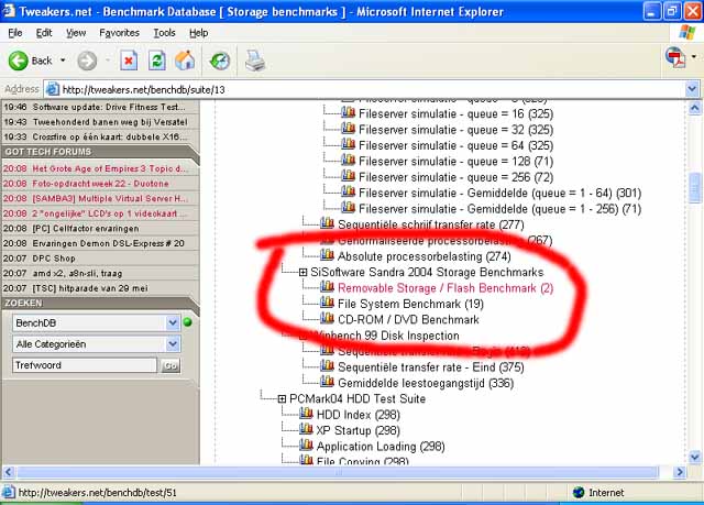

                                    Yeah? Tiresias posts benchmarks from Tweakers, but they use Sandra and you say nothing about it, see attached. Biased much?
                                    You don't need to post large photos, btw. It's easier just to link to the benchmarks, and that particular one you posted has already been linked.

                                      What I am saying is that your Hitachi T7K250 with either SATA or PATA would be 1% difference
                                      And a Raptor with SATA or PATA (if it existed) would also be within 1%
                                      BUT: The difference between these two highly different drives is still a mile, the Hitachi T7K250 would get an avg write access time of 12ms, SATA or PATA.
                                      The Raptor would get a write access time of 8ms SATA or PATA (yes, if it existed)

                                        Well, I'm just special that way. (innocent look)
                                        But hang on, is "Winbench 99 Disk Inspection" the same as Sandra? Winbench99 is what the access time measurements were made with, as it says on the top of the page.
