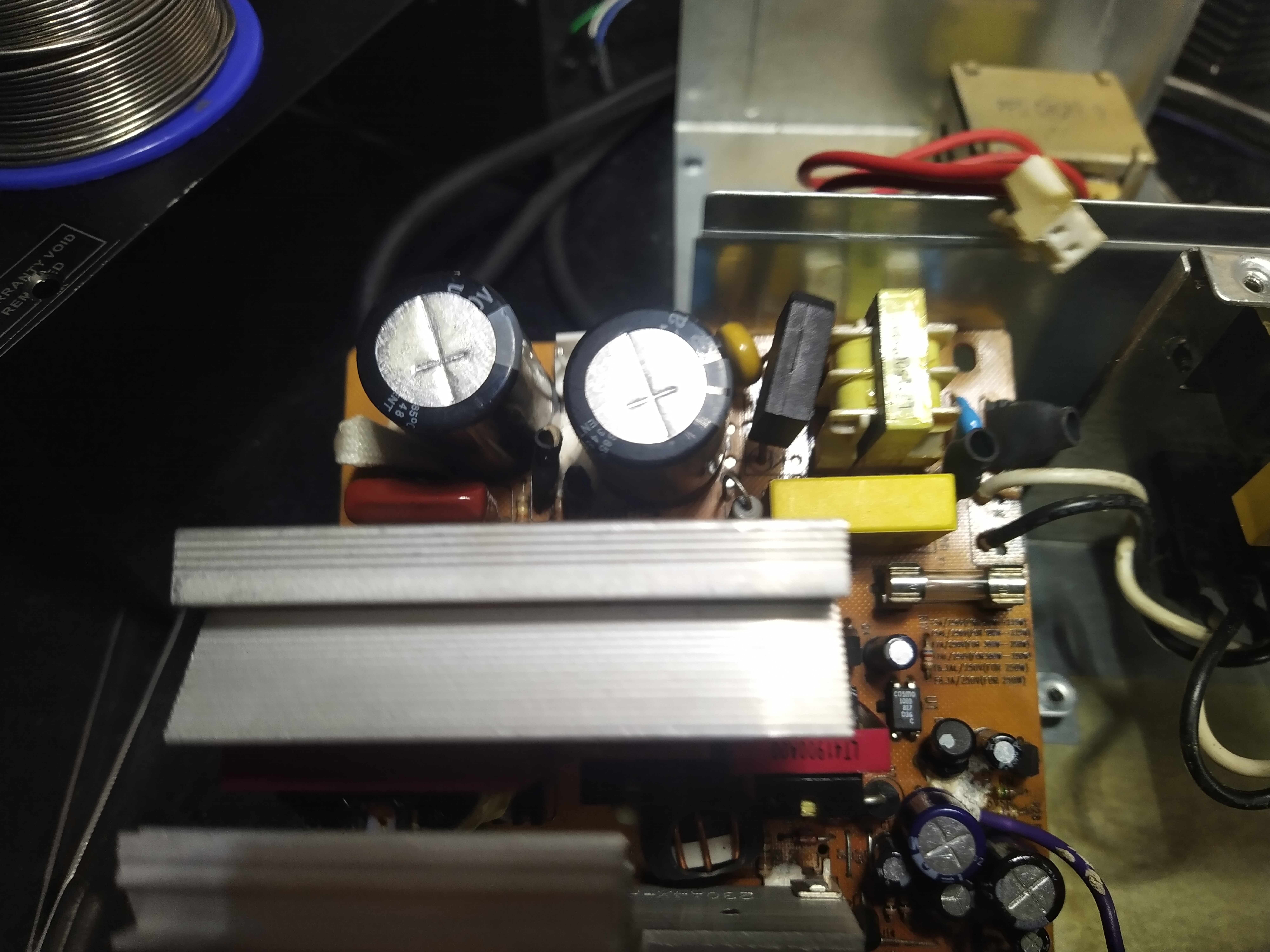

    Recently I gave a shot at recapping this Excellent power IT ATX 300 lc clone doohickey PSU. After I replaced all bulging caps and the 47uF 50v in 5vsb I turned it on. 5vsb and ps_on are spot on. So I shorted the ps_on and it dies after a split second. 5vsb still is generating, all other lines also generate voltage for a while but they all discharge so fast.
    Now I am sure this isn't a problem with the 5vsb damaging the PWM IC or BJT circuit, but I have no idea where to go next. Maybe replacing all the smaller caps?
  • CapLeaker
    Leaking Member
    • Dec 2014
    • 8342
    That sounds to me like the PSU is protecting itself. Post clear, high resolution, straight shot pictures (front and back) of the PSU and post them using the attachment function. Look at the supervisor IC and see what it is.

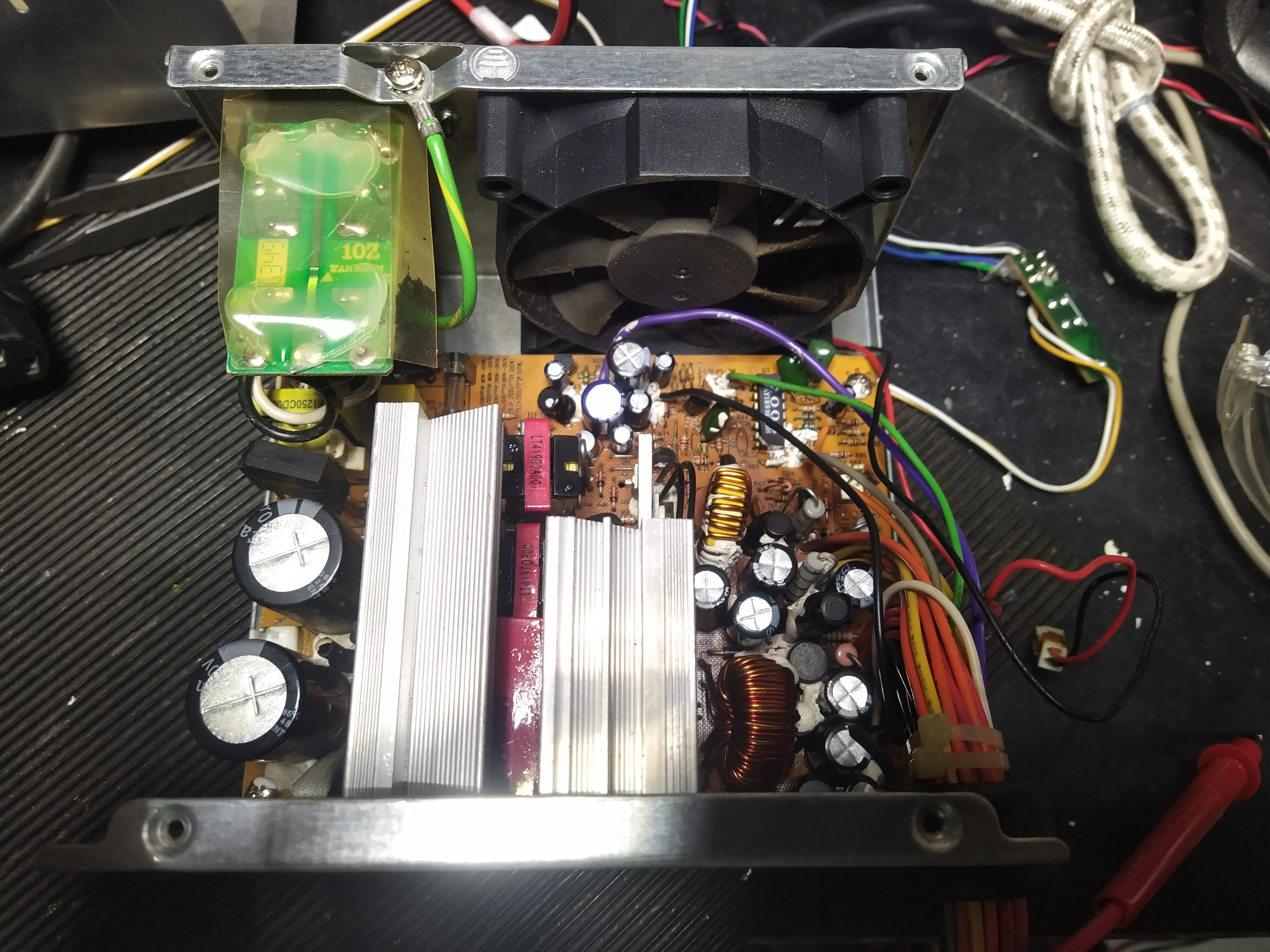

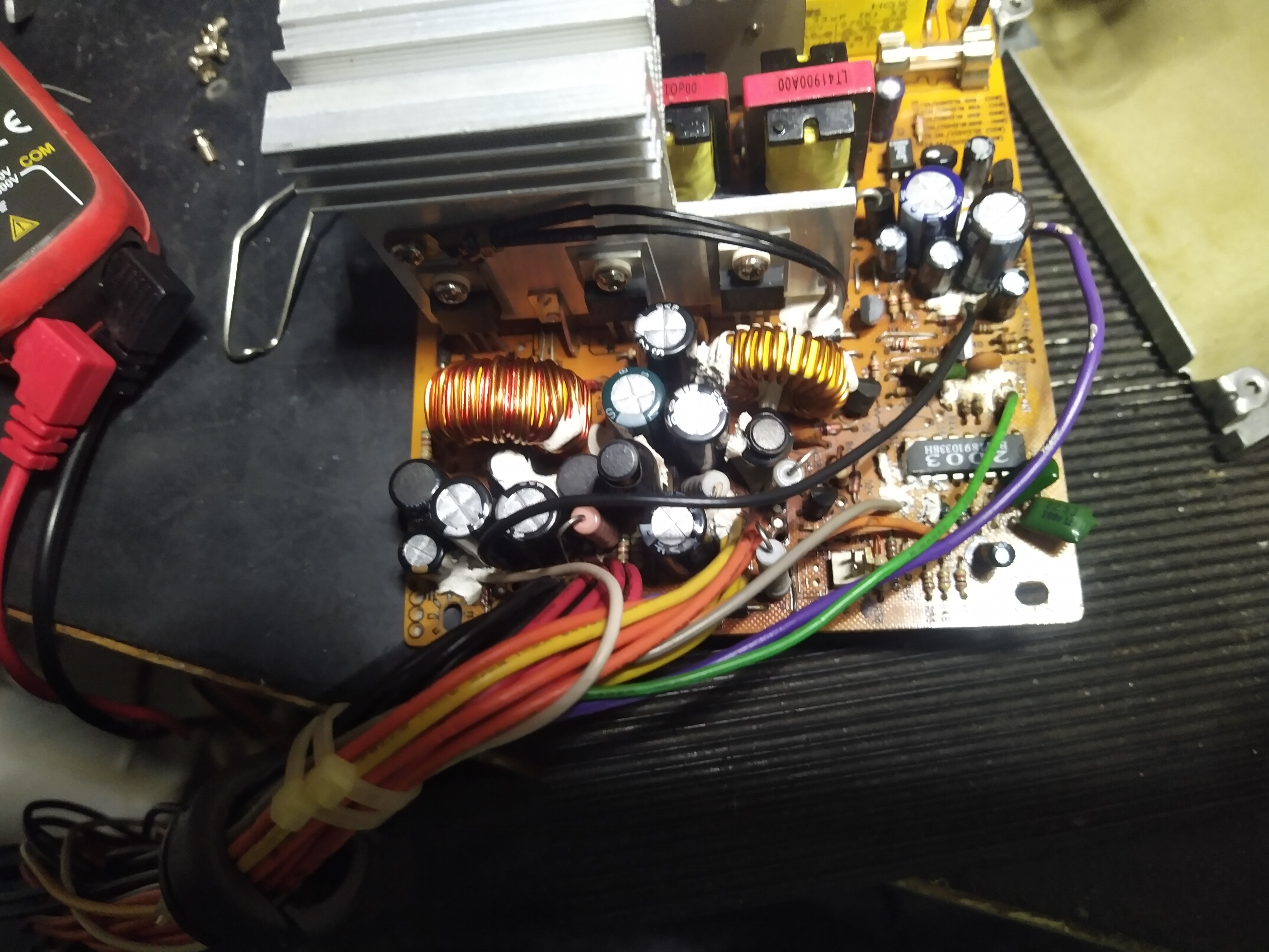

        Here are some pics. I also noticed the PG line is completely missing. Unsure where to go next...
          • 31265
          first check the output diodes for shorts

            Here's an ATX power supply schematic that shows the pinout of the 2003 PWM controller + supervisor combo IC.

              I see a lot of heat was generated on the PCB near the output toroid - probably from when the old caps failed would be my guess. In such cases, it's a good idea to check all of the solder joints on the PCB. I looked at the pictures you provided, and can already see what appears to be at least two bad/cracked solder joints (to the bottom left of the pins of secondary side of the main transformer.)
              Also, as the others stated, check the output rectifiers (TO-220 diodes on the secondary heatsink) to make sure they are not shorted. To do that, you should use your multimeter set on resistance and measure the resistance between each major rail (3.3V, 5V, 12V, -12V) and ground. BEWARE that since this is a Deer/Allied/Solytech power supply, they often used very low resistance "dummy load" resistors on the output rails as a minimum load, which might make you wrongfully conclude that there is a short on one of the output rails when there is none. In most old Deer and L&C units I ran into, it wasn't uncommon at all to see something like 6.2-10 Ohms for the 3.3V rail, 15-47 Ohms for the 5V rail, and 100 Ohms for the 12V rail - all of these being large 2-3 Watt resistors right next to the output caps. I have seen many people who tried to troubleshoot these PSUs by using the "continuity" test on their multimeter on the output rails, and they got confused into thinking that there was a short-circuit / shorted output diode on the output(s). So keep that in mind when you do the resistance testing.
              You say the PSU tries to briefly turn on but then stops. In that case, try measuring the voltage on each rail (3.3V, 5V, 12V, and -12V) to see if the voltage changes at all to some slightly higher value or not (even if it's the mV range.) Maybe even post the values here too. I had one PSU before that didn't want to turn on in the same manner. Long story short, the 3.3V rail output toroid appeared to be soldered normally, but wasn't making a good connection. I was able to double-check myself by running a continuity / low-resistance test from the Cathode of each rail's rectifier to the output wires.
              Lastly, just a question of how you are testing the power supply: do you put any load on the output rails (5V and 12V) when you short the PS_ON signal to ground or are you running the PSU unloaded? In general, Deer/Allied/Solytech PSUs don't need a load to turn On and I never had an issue turning one on without a load. Nonetheless, always consider or try to put some kind of a small load on the 5V and 12V rail. Some people suggest old hard drive or two. I'm personally not a big fan of that method, as the HDD(s) don't put an "instant" load on the 5V and 12V rail. So instead, I prefer to use small 12V incandescent car/auto/home light bulbs (typically 5 to 20 Watt -rated.) This gives the PSU an "instant" load so the output voltages are able to balance better.
              As for PG signal missing - it's missing because likely one of the output rails (3.3V, 5V, 12V, -12V) is either overloaded (under voltage) or showing over-voltage, or is simply not there at all (missing / open-circuit.) The PG signal comes up high only when all of the voltage rails have come up to proper values and are stable.
              And yes, it's normal for the 5VSB to unaffected from failure of the main PS outputs (3.3V, 5V, 12V, -12V), since it's on its own circuit. PS_ON is generated from the 5VSB rail, so that will also be unaffected.

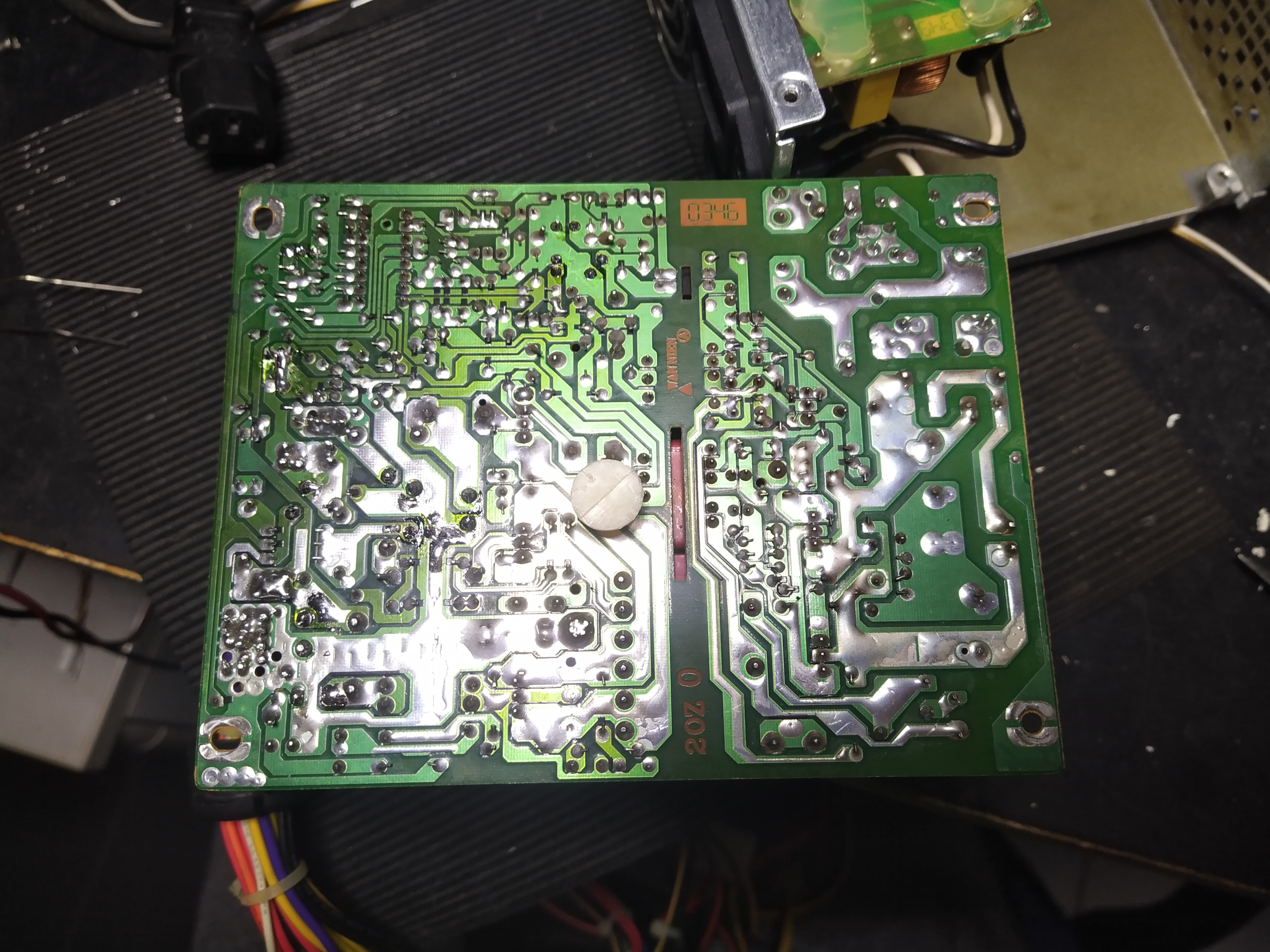

                              P.S. the soldering on the resistors cracked easly so if you can reflow them
                                master hoarder
                                • May 2008
                                • 12175
                                • Bulgaria
                                Originally posted by kotel studios
                                I have redone the measurements and GND on d14 is 0ohm anodes and 100ohms cathode.
                                OK, that sounds a lot more like it.
                                On my L&C, there is also a 100-Ohm load resistor on the 12V rail, so that's what I expected to see on yours too.
                                I also redone the soldering on secondary side and replaced the original -5v filter cap (which turns out to be okay) but to no avail. Still dies after a second.
                                Good. Post a clear picture of the solder side, just so we can double-check it again. I find that no matter how many times I go over something, sometimes it's just better to have another person to check me to see if I missed something.
