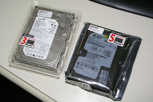

      Re: HDD Discussion
      here is an example of how we get our drives here. the plastic cases i like. seagate were coming like that but the latest drives are back to the antistatic bags only like all other drives.
      considering the amount of drives i receive in bags, it is suprisingly rare that i receive a drive which immediately tests with errors. therefore i wonder whether shock during transit is so much a problem. i am yet to receive a drive with obvious serious mechanical damage though.
      anyway i would prefer to receive drives in the "SeaShell" packaging though because not only is it reassuring but it is useful to reuse.

        Re: HDD Discussion
        Yes, this bags and Boxes ar the sime like here, but probably they are surounded with any kind of foam or plastic chips.
        In any way, i RMA`d some hdd`s direcktly to maxtor and to WD. In both cases, they statet that a HDD which will arive without any foam they will send back witout repair. They even said, that air filled plastic bags are unsave and are voiding waranty repair too. So who is wrong in that business? The HDD manufaturers or those careless seller? with that in mind, i am sure, that many hdd failures will be due to bad handling during transport. The packing, i`ve recived from WD and maxtor are both very very sophisticated. So i think they know, what bad handling will kost them in waranty servicing.

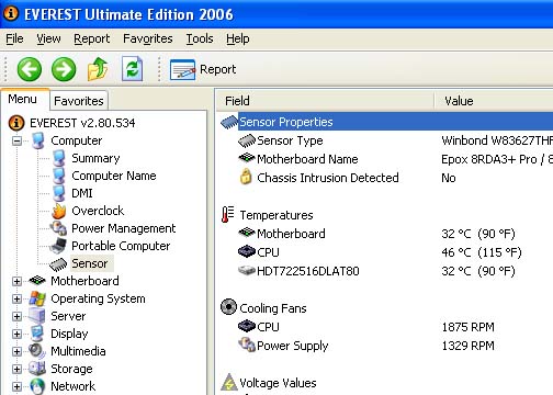

                        Re: HDD Discussion
                        Originally posted by gonzo0815
                        The reason for the wd drive is the amazingly fast data delivery, which will make a differenz in felt performance for a long time, compared with an to expensive GPU or CPu, which will be mainstream after few months.
                        What? A fast hard drive is useless are far as frame rates are concerned. You'll get faster level loads, and that's it. I have a 74GB Raptor, and against my other 7200RPM IDE drives, the extra few seconds it saves when loading games aren't missed when I'm using IDE and a good video card.
                        If you hold your drive below or at 45 to 50ยฐc then i think maxtor an samsung are good hdds.
                        Anything above 38ยฐC is bad. See attached at full load.

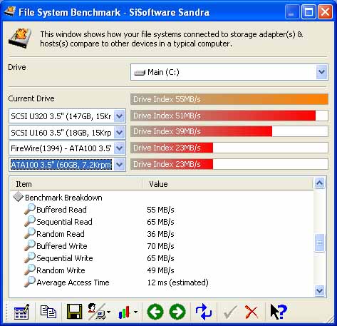

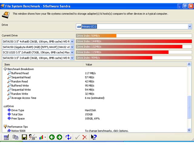

                            Re: HDD Discussion
                            Originally posted by tiresias
                            Still, the WD Raptor drives are indeed very fast when loading many small files (OS, office apps or games), due to their extremely low access time. Certainly if you're dealing with long sequential reads on large files (video encoding or editing, for example), a RAID 0 setup of standard 7200rpm drives will be far faster than a single Raptor.
                            My Hitachi 7200rpm IDE drive comes within 5MB/s of my Raptor. The SATA-1 Raptors are an over-hyped bandwagon. SATA-II on the otherhand, my Hitachi can't hold a candle to it.

                                Re: HDD Discussion
                                I disagree there - sequential read speed (in MB/s) isn't the Raptor's strong point, as I said - it's the access time (usually expressed in milliseconds). Take a look at the specs, you'll see it really is indeed very fast in that respect.
                                I'm not saying the WD Raptor is a good deal in most situations, but it definitely does have its niche in which it performs very well.

                                  Re: HDD Discussion
                                  Actually, it's not that fast. Those specs are marketing hype capitalizing on theoretical maximums. I have actual results, see attached. My Hitachi is running on an Epox 8RDA3+Pro with an 3300+ Sempron. The Raptor is on an Abit AN7 with a 3200+ AthlonXP. And, in this review:
                                  http://techreport.com/reviews/2004q1...d/index.x?pg=3
                                  ...you'll see the Raptor has an access time of 8.1ms, better than the access times on my AN7, but still slower than my Hitachi by 2.1ms.
                                  Also, take note that even though my Hitachi has a much faster access time, the Sequential Read/Write of the Raptor is better, and gives it the extra 5MB/s I'd mentioned earlier... so, your information is backwards from all angles.

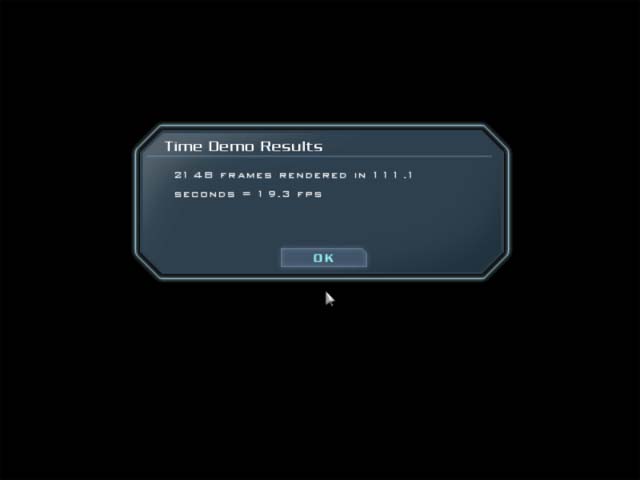

                                      Re: HDD Discussion
                                      But for working like doing some emails, office mp3 usw. and for switching between e.g firebird with 30+ tabs, some pdf and copying 20gigs from hd 1 to hd2 you will feel
                                      You said you were building a "gaming system." What you've just described is a faster than average SOHO system.
                                      Even the loading of levels in games like Doom3, BF etc. will be very very fast; for that nor 4gb of ram nor a high end sli gfx system will do anything for you better than a fast single HDD.
                                      I run Doom3 on my Raptor, and like I said before... it saves all of a few seconds in load up time. You're placing an inordinate amount of importance on 5 second level loads, versus 45 minutes of smooth game play.
                                      In my opinion, this kind of performance will be far more appreciated as some 100+ fps or some FSAA 8+.
                                      Good lord, man... See my above comment. And, see attached. It's my Timedemo Demo1 score in Doom 3 on Radeon 9500 128MB made more than 3 years ago. 19.3fps on high quality. On medium settings I hit 30+. 3 years on the same card that was considered mid-level at the time I bought it... if I'd bought the 9700, $50 more at the time, I'd be upgrading next year, as opposed to next month.
