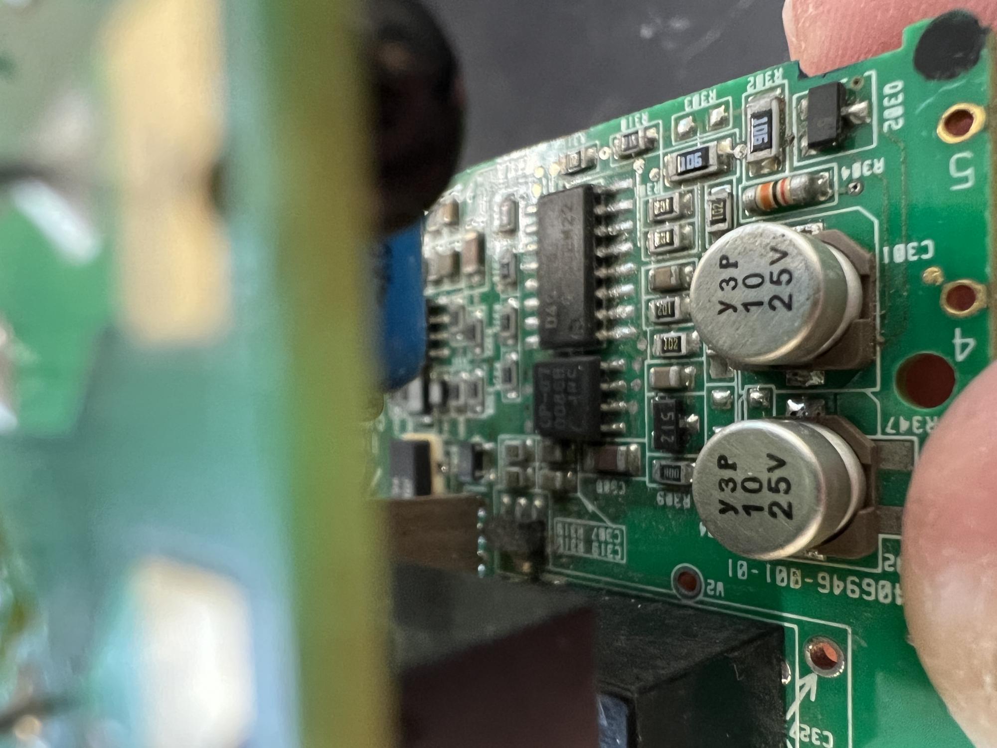

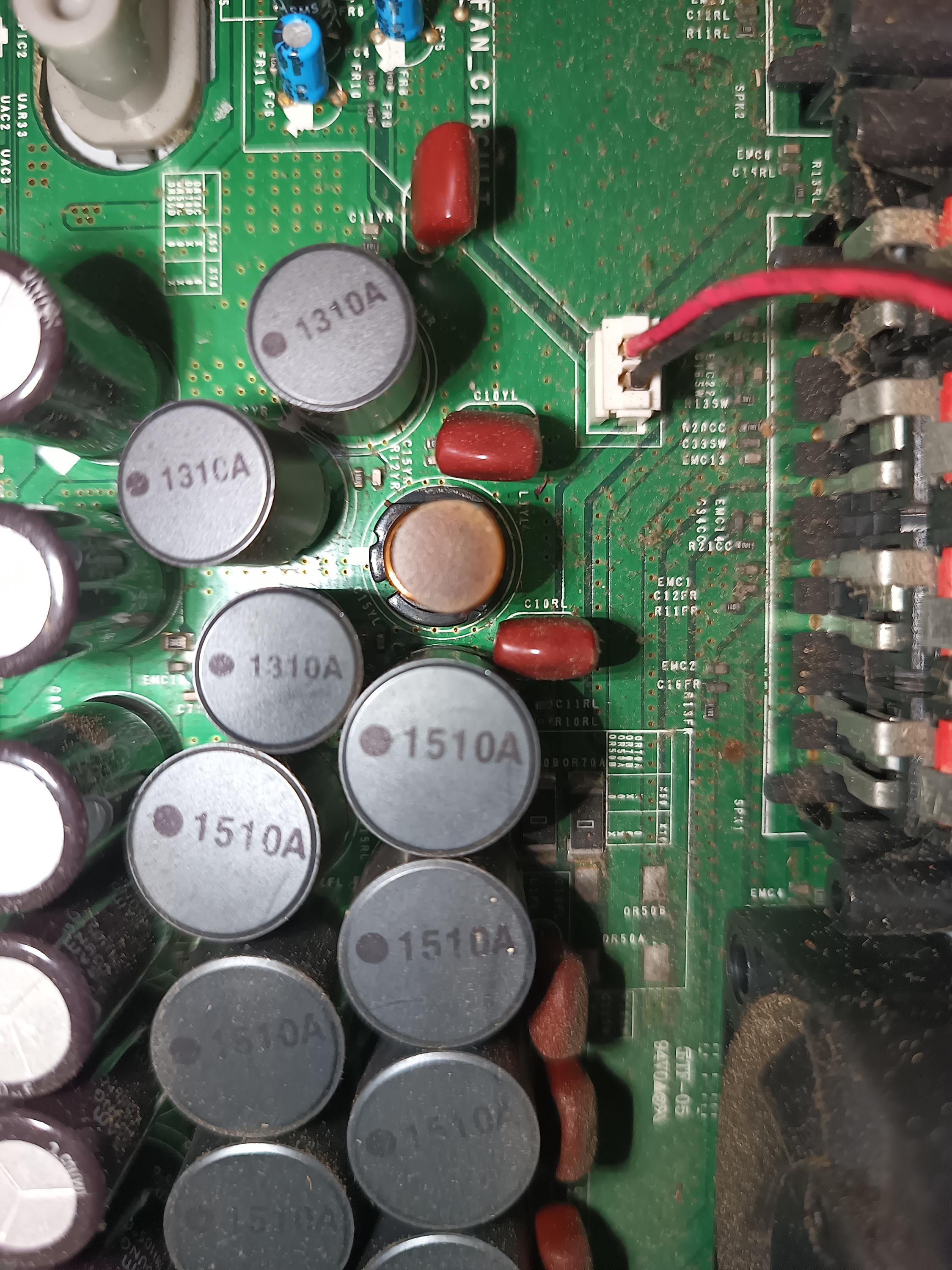

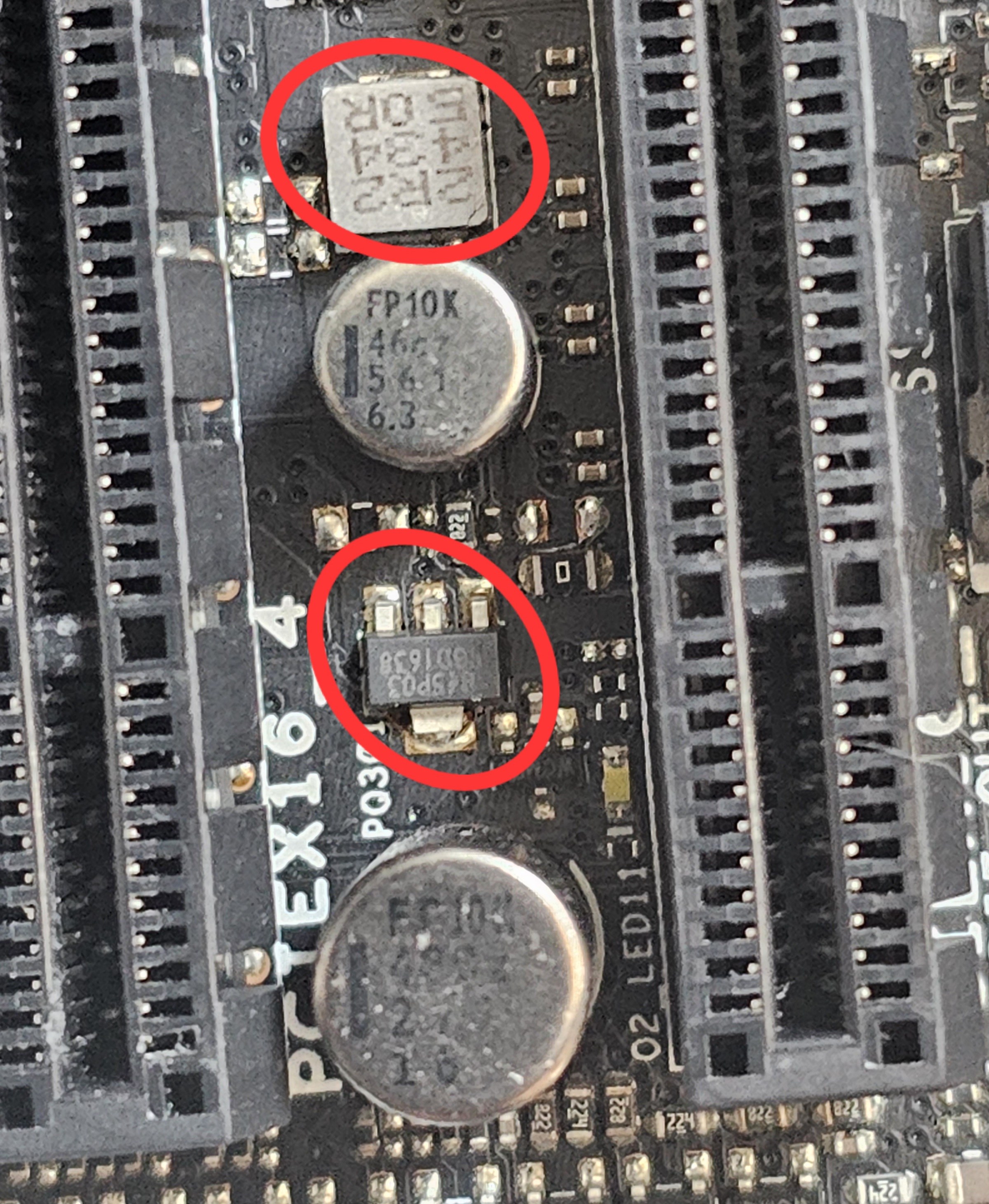

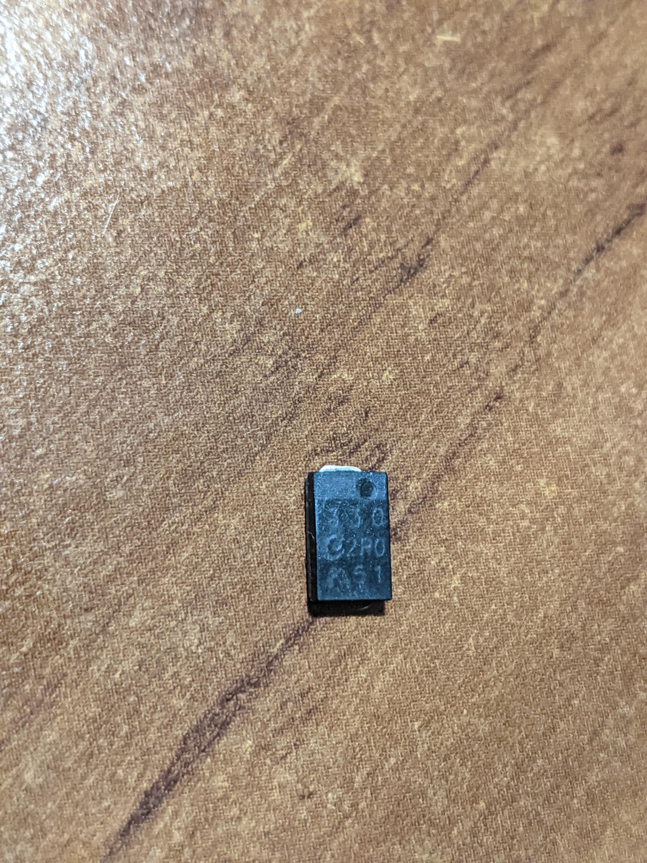

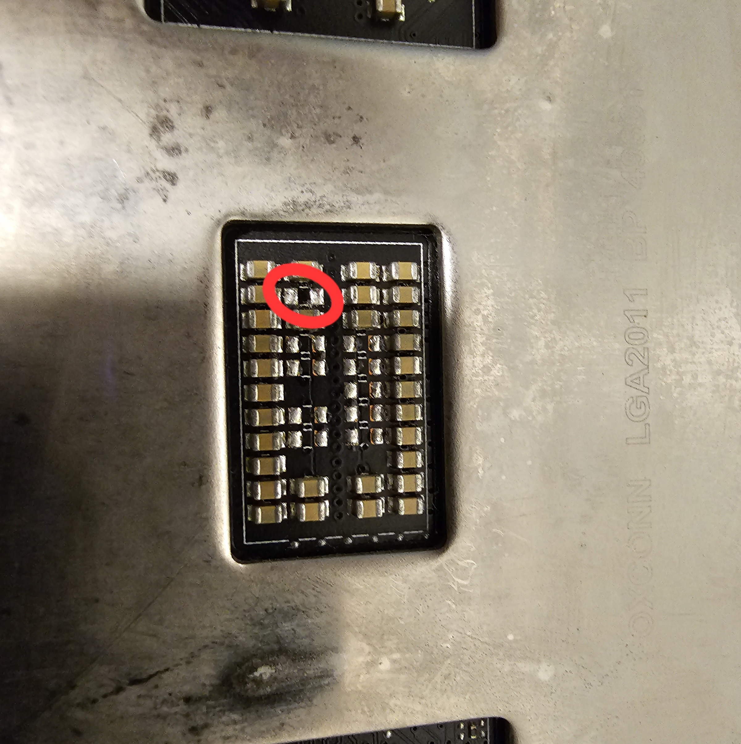

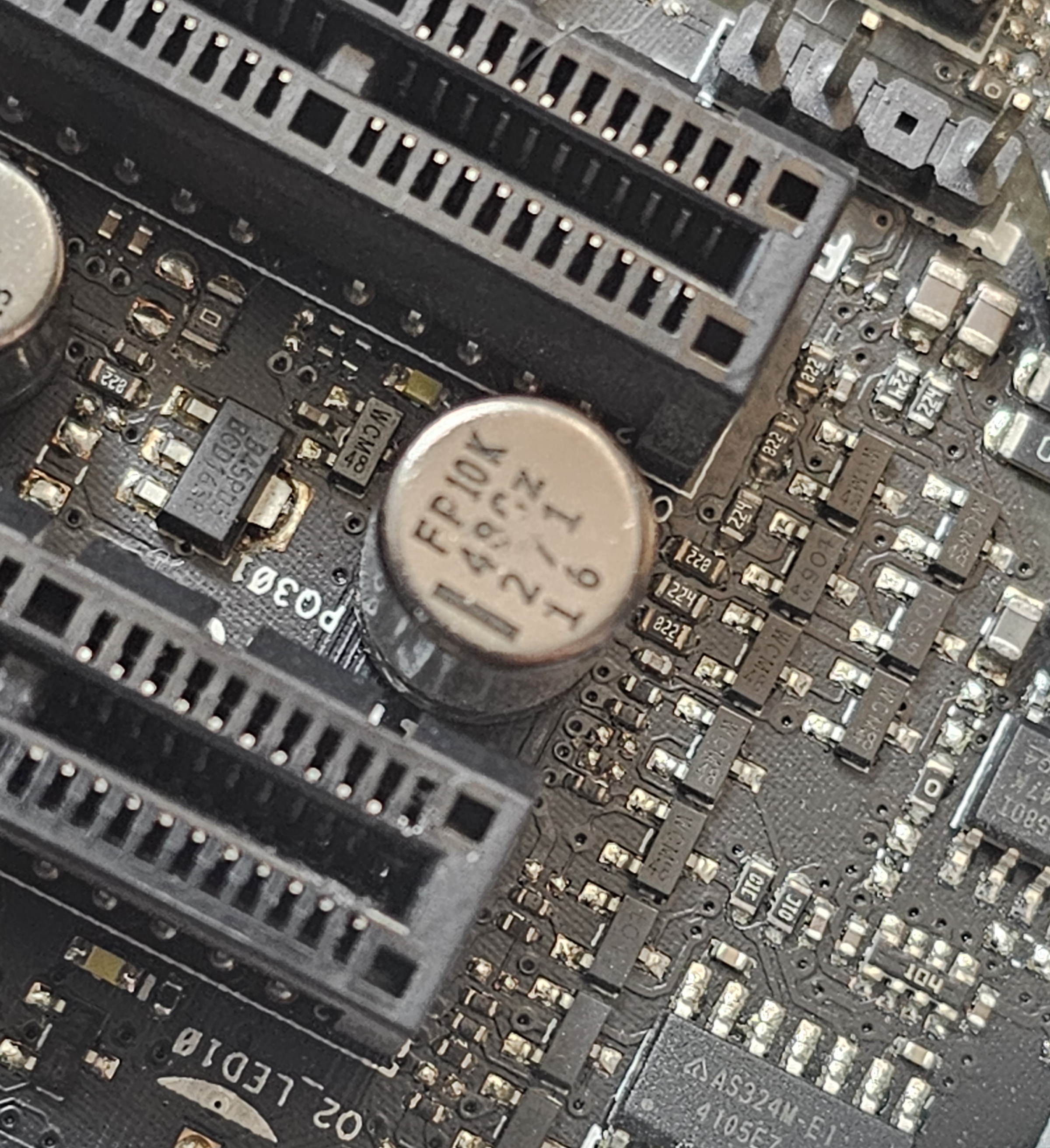

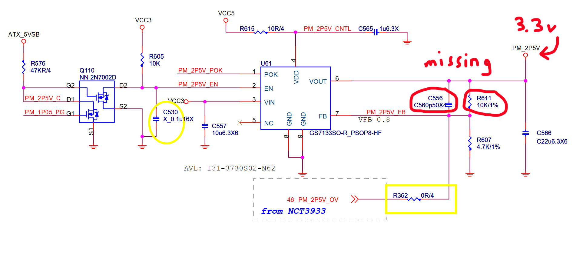

Post help identifying capacitors here
This is a sticky topic.
    master hoarder
    • May 2008
    • 12175
    • Bulgaria
    #101
    Re: Post help identifying capacitors here
    LF = possibly Nichicon LF series, if it has a blue text and mark for the negative stripe, though might be easier to reveal with a picture.
    If I'm not mistaken, C = 16V rating.
    • lethbrp
      • Apr 2023
      • 15
      • United Kingdom
      #102
      Re: Post help identifying capacitors here
      [Like many before me I need some help identifying these SMD capacitors (see attached image). Could someone help me with this. Many thanks
      • jiroy
        • Jun 2016
        • 2416
        • Lebanon
        #103
        Re: Post help identifying capacitors here
        Originally posted by lethbrp
        [Like many before me I need some help identifying these SMD capacitors (see attached image). Could someone help me with this. Many thanks
        10 microfarads , 25 volts .
        • lti
          • May 2011
          • 2558
          #104
          Re: Post help identifying capacitors here
          Those are bipolar, too.
          • lethbrp
            • Apr 2023
            • 15
            • United Kingdom
            #105
            Re: Post help identifying capacitors here
            Originally posted by lti
            Those are bipolar, too.
            Many thanks
            • Dtreb
              • Jun 2023
              • 3
              • France
              #106
              Re: Post help identifying capacitors here
              I've got an Asus X99 Deluxe for years, and few days ago, the PC won't start at all (no BIOS, no fans spinning, ...), only the "Start" and "Reset" buttons on the MB are lit. When I push the "BIOS flashback" green button, the NZXT Kraken, watercooling the CPU is lit while I push the button.
              What I noticed is that the two bottom PCI-e ports, and particularly the capcitor between these two ports is burning hot.
              I want to replace it to try to save the motherboard, with not much hope, but I'll try anyway
              Could you help me identify the 2 capacitors, and, if possible, the two other elements circled in red, please?
              What I can read from the bigger capacitor is:
              FP 10K
              48Cz
              271
              16
              And from the smaller:
              FP10K
              46*z
              561
              6.3
              (* is for character that I cannot read)
              The other two elements, from top to bottom:
              2R2
              434
              5OR
              And
              BA5P03
              BCD1638
              Second photo which is clearer for the bigger capcitor and the component just next to it:
              Would these capacitors be ok to replace the two on my MB?
              Nichicon RHA0J561MCN1GS
              Nichicon PCX1D271MCL1GS
              I'm not sure about the 20% tolerance. Is this acceptable or should I find a reference with a lesser tolerance?
              Also, I noticed that on the back of the MB, a MLCC was not properly soldered (only one side was soldered, the other one was not). Do you know the specs of these MLCC? Nothing is written on it, and apparently, a myriad of MLCC exist, so I'm lost.
              Thank you for your help.
              Last edited by Dtreb; 06-08-2023, 04:02 AM.
              • PeteS in CA
                • Aug 2005
                • 3586
                • USA, Unsure of Planet
                #107
                Re: Post help identifying capacitors here
                2R2
                434
                5OR
                2.2 microhenry inductor
                PeteS in CA
                • jiroy
                  • Jun 2016
                  • 2416
                  • Lebanon
                  #108
                  Re: Post help identifying capacitors here
                  Originally posted by Dtreb
                  I've got an Asus X99 Deluxe for years, and few days ago, the PC won't start at all (no BIOS, no fans spinning, ...), only the "Start" and "Reset" buttons on the MB are lit. When I push the "BIOS flashback" green button, the NZXT Kraken, watercooling the CPU is lit while I push the button.
                  What I noticed is that the two bottom PCI-e ports, and particularly the capcitor between these two ports is burning hot.
                  I want to replace it to try to save the motherboard, with not much hope, but I'll try anyway
                  Could you help me identify the 2 capacitors, and, if possible, the two other elements circled in red, please?
                  What I can read from the bigger capacitor is:
                  FP 10K
                  48Cz
                  271
                  16
                  And from the smaller:
                  FP10K
                  46*z
                  561
                  6.3
                  (* is for character that I cannot read)
                  The other two elements, from top to bottom:
                  2R2
                  434
                  5OR
                  And
                  BA5P03
                  BCD1638
                  Second photo which is clearer for the bigger capcitor and the component just next to it:
                  Would these capacitors be ok to replace the two on my MB?
                  Nichicon RHA0J561MCN1GS
                  Nichicon PCX1D271MCL1GS
                  I'm not sure about the 20% tolerance. Is this acceptable or should I find a reference with a lesser tolerance?
                  Also, I noticed that on the back of the MB, a MLCC was not properly soldered (only one side was soldered, the other one was not). Do you know the specs of these MLCC? Nothing is written on it, and apparently, a myriad of MLCC exist, so I'm lost.
                  Thank you for your help.
                  (FP 10K
                  48Cz
                  271
                  16) : 270 microfarads , 16 volts , the rest is for series and codes , related to manufacturer .
                  (FP10K
                  46*z
                  561
                  6.3) :
                  560 microfarads , 6.3 volts , the rest is for series and codes , related to manufacturer .
                  (2R2
                  434
                  5OR) : Panasonic power inductor choke coil 2.2 microhenrys .
                  (BA5P03
                  BCD1638) : A discrete component , with no available data , probably undocumeted yet , but surely i's a LVR (Low voltage regulator) , Sot223 sc-73 or sc-89 (if you can give its exact dimensional measures , i can affirm more) . From its marking it's a positive regulator anyway (the "P") , and most probably , 5volts for the "5" , And 3volts for the "03" ..
                  I'll keep looking for it more .
                  (MLCC) : Please show its picture , to know if it's ceramic or propylene or else , etc..
                  • Dtreb
                    • Jun 2023
                    • 3
                    • France
                    #109
                    Re: Post help identifying capacitors here
                    Thank you very much to both of you.
                    Here is the component on the back of the socket:
                    I removed it to be sure that it being desoldered would not damage anything else.
                    • Dtreb
                      • Jun 2023
                      • 3
                      • France
                      #110
                      Re: Post help identifying capacitors here
                      Originally posted by jiroy
                      (FP 10K
                      48Cz
                      271
                      16) : 270 microfarads , 16 volts , the rest is for series and codes , related to manufacturer .
                      (FP10K
                      46*z
                      561
                      6.3) :
                      560 microfarads , 6.3 volts , the rest is for series and codes , related to manufacturer .
                      (2R2
                      434
                      5OR) : Panasonic power inductor choke coil 2.2 microhenrys .
                      (BA5P03
                      BCD1638) : A discrete component , with no available data , probably undocumeted yet , but surely i's a LVR (Low voltage regulator) , Sot223 sc-73 or sc-89 (if you can give its exact dimensional measures , i can affirm more) . From its marking it's a positive regulator anyway (the "P") , and most probably , 5volts for the "5" , And 3volts for the "03" ..
                      I'll keep looking for it more .
                      (MLCC) : Please show its picture , to know if it's ceramic or propylene or else , etc..
                      The unidentified component seems to be 3mm * 6mm. It's a bit tricky to measure, because it's between two PCI-e ports and the two capacitors, but I think this is the right measurement.
                      • jiroy
                        • Jun 2016
                        • 2416
                        • Lebanon
                        #111
                        Re: Post help identifying capacitors here
                        Originally posted by Dtreb
                        Thank you very much to both of you.
                        Here is the component on the back of the socket:
                        I removed it to be sure that it being desoldered would not damage anything else.
                        That's a smd ceramic capacitor , basically to provide power and stability to the CPU . Measure any surrounding capacitor , they're basically the same here .
                        For the BA5P03 , I need more , including height and even the pins ..
                        • K46tank
                          • Jun 2023
                          • 3
                          #112
                          Re: Post help identifying capacitors here
                          Hello!
                          Can anyone tell me what these are and where to buy replacements?
                          Marked 1510A and 1310A
                          I have Google searched but haven't had any luck locating any info.
                          Thanks in advance
                          • Per Hansson
                            • Jul 2005
                            • 5895
                            • Sweden
                            #113
                            Re: Post help identifying capacitors here
                            Looks like inductors, no need to replace.
                            • jiroy
                              • Jun 2016
                              • 2416
                              • Lebanon
                              #114
                              Re: Post help identifying capacitors here
                              Those are discrete Through hole ferrite shielded radial choke inductors , and like Per Hansson mentioned , no need to replace , and they look super fine .
                              About the marking , 1310A stand for 13mm x 10mm , A for tolerance 5% , and 1510A stand for 15 mm x 10 mm , A for tolerance 5% .
                              Without labeling them with their inductance values , like mh inductance , makes them standard from any series from some unknown company . So the only way to know their real value , without a schema is to measure one of them . Next , you can have any similar 1310A , meaning 13x10,5% , from any other manufacturer , like this series attached , SRC1013 .
                              • K46tank
                                • Jun 2023
                                • 3
                                #115
                                Re: Post help identifying capacitors here
                                Looks like inductors, no need to replace.
                                Thanks Per Hansson and jiroy!
                                I thought maybe they were inductors but I wasn't positive. I have one that is discolored, so much so that the marking is almost unreadable, and the ferrite "cap" has popped off so I'm pretty sure it needs to be replaced. I attached the above pic because the markings were clear. These are in a Samsung surround sound amp/cd changer. I'll order a few and replace the one that's lost its head and see what happens
                                Thanks again!
                                • udonome
                                  • Jul 2023
                                  • 14
                                  • United Kingdom
                                  #116
                                  Re: Post help identifying capacitors here
                                  I have a motherboard MSI B350M Gaming Pro with missing components. One of it is a capacitor named in the schematic as "C560p50X4".
                                  I need help identifying it as I am trying to find a replacement from an old board Asrock G14C-S.
                                  The pads where it is missing are around 1.5mm apart so it should be really small.
                                  It would be helpful to know how i could use a multi meter to find one from the donor board.
                                  • cobovo
                                    • Jan 2023
                                    • 22
                                    • Ukraine
                                    #117
                                    Re: Post help identifying capacitors here
                                    Hi guys!
                                    Can some one to identify this type of smd capacitors from Gigabyte motherboard?
                                    • cobovo
                                      • Jan 2023
                                      • 22
                                      • Ukraine
                                      #118
                                      Re: Post help identifying capacitors here
                                      Originally posted by cobovo
                                      Hi guys!
                                      Can some one to identify this type of smd capacitors from Gigabyte motherboard?
                                      I found same logo on Asus motherboard at DIP type capacitor and then by boardview found needs to me series and type on website of manufacturer.
                                      This type
                                      https://www.apaq.com.tw/zh-cn/produc...pe/ACAS+Series
                                      • jiroy
                                        • Jun 2016
                                        • 2416
                                        • Lebanon
                                        #119
                                        Re: Post help identifying capacitors here
                                        Originally posted by udonome
                                        I have a motherboard MSI B350M Gami 1Pro with missing components. One of it is a capacitor named in the schematic as "C560p50X4".
                                        I need help identifying it as I am trying to find a replacement from an old board Asrock G14C-S.
                                        The pads where it is missing are around 1.5mm apart so it should be really small.
                                        It would be helpful to know how i could use a multi meter to find one from the donor board.
                                        It's a smd capactor 560 picofarads or 0.56 nanofarads , 50 volts . Better test capacitors outside the donor board . Try find similar size and test it .
                                        • jiroy
                                          • Jun 2016
                                          • 2416
                                          • Lebanon
                                          #120
                                          Re: Post help identifying capacitors here
                                          Originally posted by cobovo
                                          Hi guys!
                                          Can some one to identify this type of smd capacitors from Gigabyte motherboard?
                                          That's a standard and very common capacitor smd 330 microfarads , 50 or 63 volts .. You can find it in any donor board .
                                          • varkatope
                                            Need help identifying capacitors on an MSI MS6163 ver 1. motherboard
                                            by varkatope
                                            Hey there, retro fans.
                                            I have an MS6163 version 1 board I'm trying to repair which was obviously used as a donor because it's missing a few parts, mostly capacitors. There are few high quality images online that would allow me to read the capacitor values (bad angle, blurry photos). I thiiiink I've figured out most of the values for the missing ones except for one in particular, number C210, which is in the bottom-left of the attached photo. Could someone with this board be so kind as to take a look at theirs and tell me the capacitance and voltage values of all the highlighted missing...
                                            12-15-2024, 09:48 AM
                                          • dragon3x
                                            After updating motherboard capacitors, what to do next (Asrock K7VT2, SOLTEK SL-75FRN2L)
                                            by dragon3x
                                            Hi, I have some 32 bits computer motherboards that need repair, as they fail to
                                            power on.
                                            Here are some examples :
                                            (N.B. "capacitors" indicated here are electrolytic capacitors located in the onboard
                                            switching supply area).
                                            (N.B. #2 : I could not find a 3300 microF aluminum-polymer with a higher voltage
                                            than 6.3 V.)
                                            1 - Motherboard #1 : this is an Asrock K7VT2 (socket A) that still works well. To put it on test
                                            I replaced capacitors with aluminum-polymer.
                                            3300 microF/6.3 V. x 4 replaced by 3300 microF/6.3 V. (KYOCERA...
                                            03-21-2025, 02:46 PM
                                          • slybunda
                                            AA and AAA battery charger capacitors?
                                            by slybunda
                                            hey all, iv got my favourite battery charger here which iv had for many years probably 15 years now or maybe even more. it still works good but thought id open it up to clean the dust out of it, lots of dust inside but now its clean and noticed 4 capacitors inside it and wondered if i should replace them.
                                            it has inside:
                                            2 x 47uf 16v caps 105c branded as Su'scon (lol sounds sus to me)
                                            2 x 470uf 16v LZ105c branded as G.Luxon
                                            not heard of these brands are they any good?
                                            iv attached photos of the charger and the board inside for an idea on the type of...
                                            12-24-2023, 04:41 AM
                                            Panasonic switching power supply daughter board has two 27uf @ 50 volt capacitors which I do not keep in stock
                                            by sam_sam_sam
                                            I did not have any 27uf @ 50 volt capacitors but one nice thing is that it has enough room for two capacitors in parallel a 22uf and a 4.7uf @ 50 volts 22 plus 4.7 equals 26.7uf which so very close to 27uf I will show some pictures of it sometime tomorrow
                                            This is one of the shit est boards I seen in a very long time and it was the daughter board the traces just lifting off the board I had to use the capacitor leads to repair the the traces and the main board is not any better because I had to repair several traces for the daughter board to the main board
                                            After all of...
                                            07-13-2024, 08:14 PM
                                          • Cama
                                            Solar Inverter - SMH-II - 2 missing capacitors
                                            by Cama
                                            I need help to find the value of 2 missing capacitors ( C102 and C117) on my Easun SMH-II mainboard (solar hybrid inverter). I circled it in red on the close-up picture. The 2 old capacitors are completely missing, so I have no reference. Does anyone have this board and can tell me the value or make an educated guess based on the location ?
                                            My model is : EASUN SMH-II 7 KW
                                            Mother Board : P/N 18947-002401250250
                                            Maybe the EASUN SMH-II 4.2 KW have the same capacitors
                                            Thank you...
                                            09-12-2025, 02:50 AM
