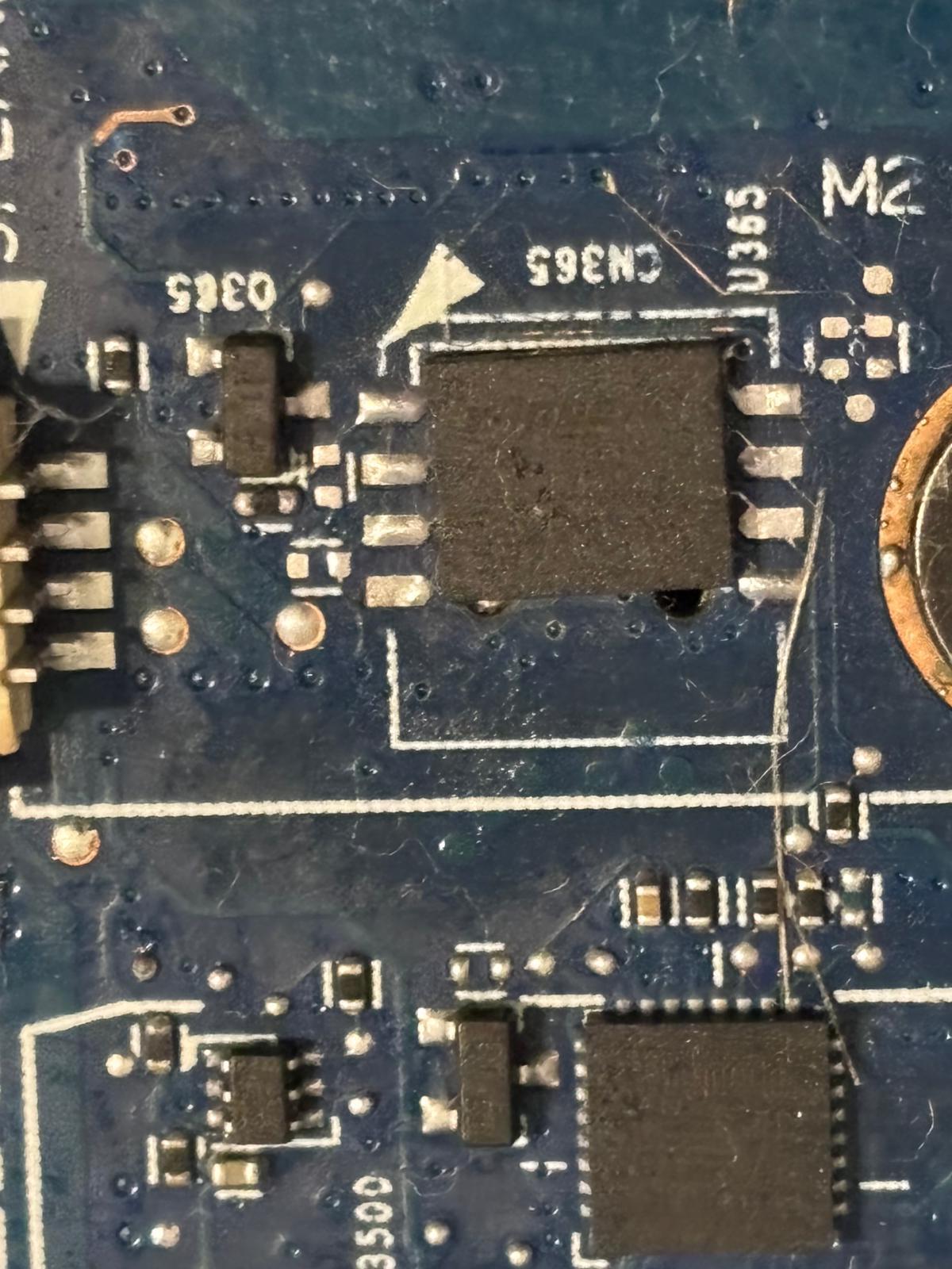

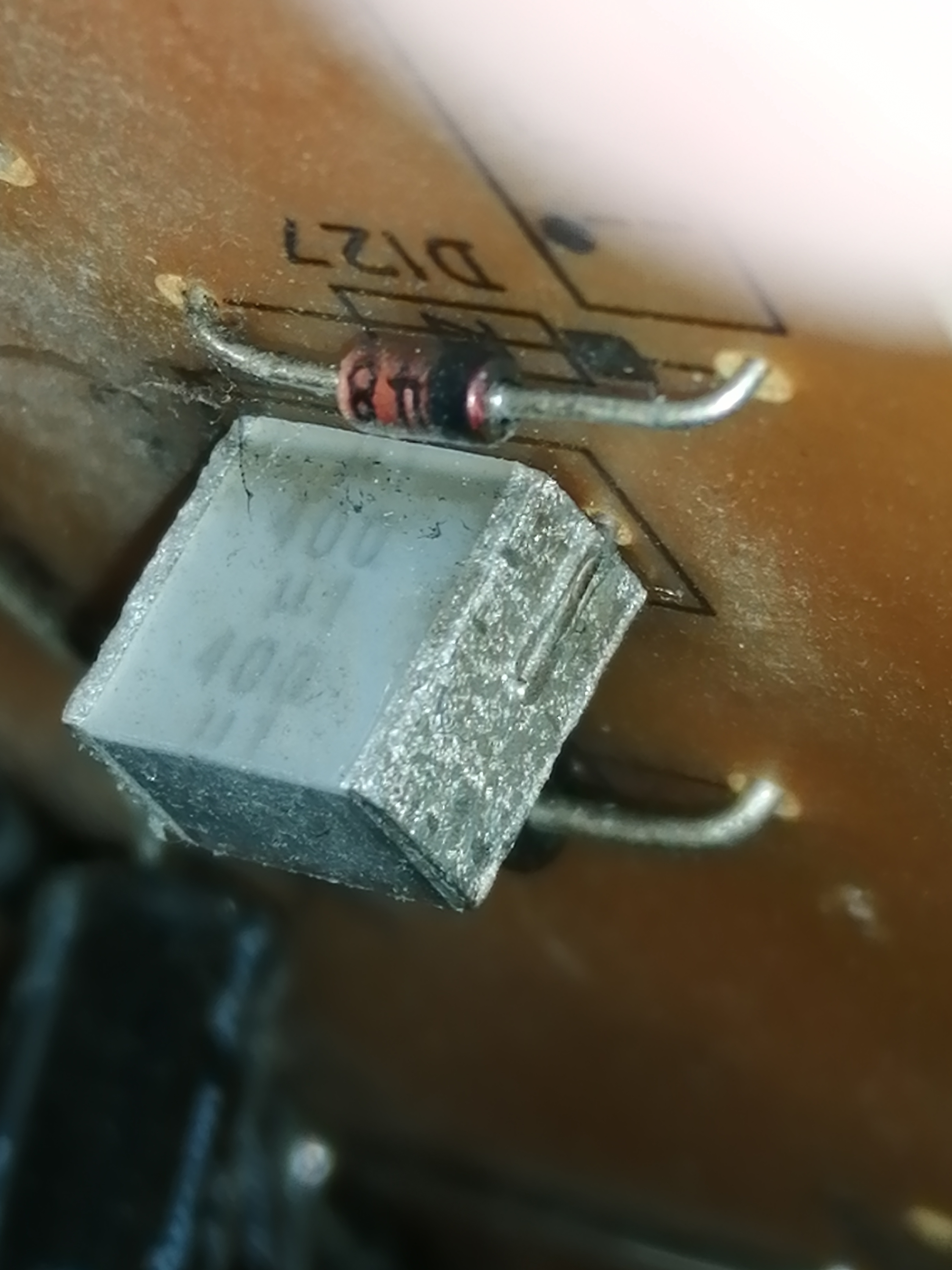

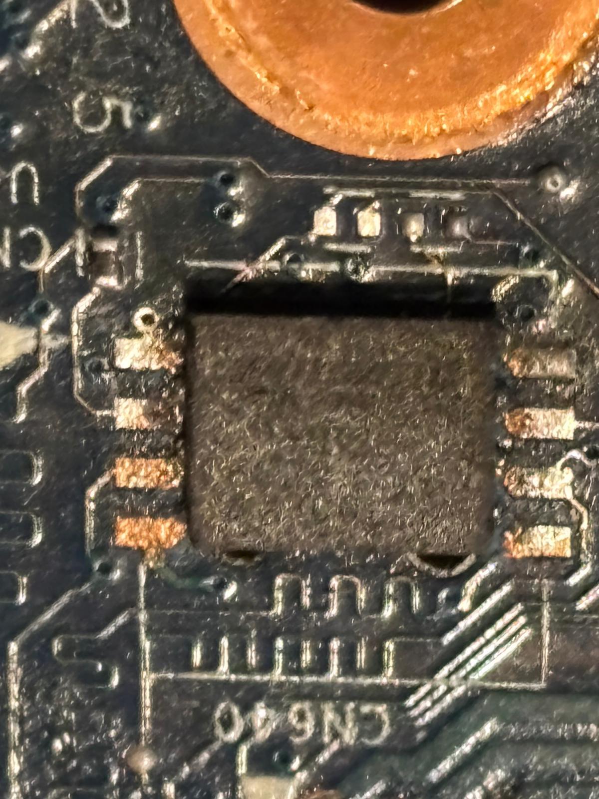

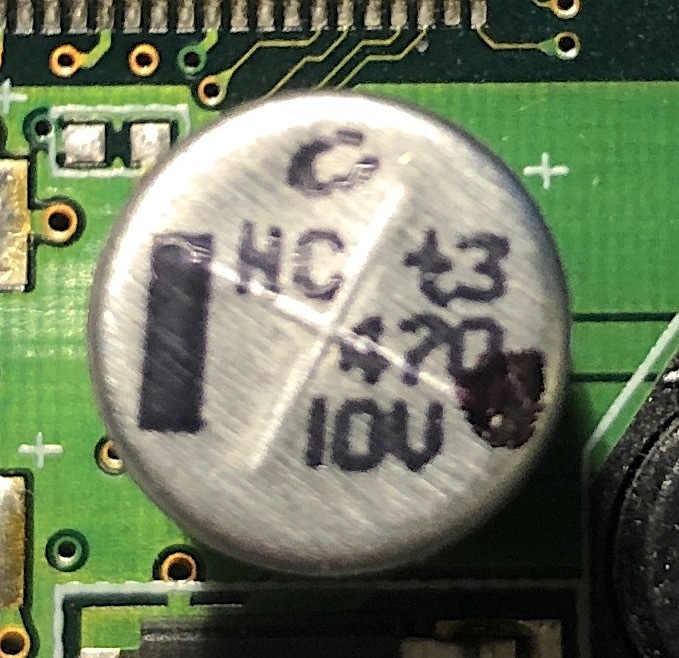

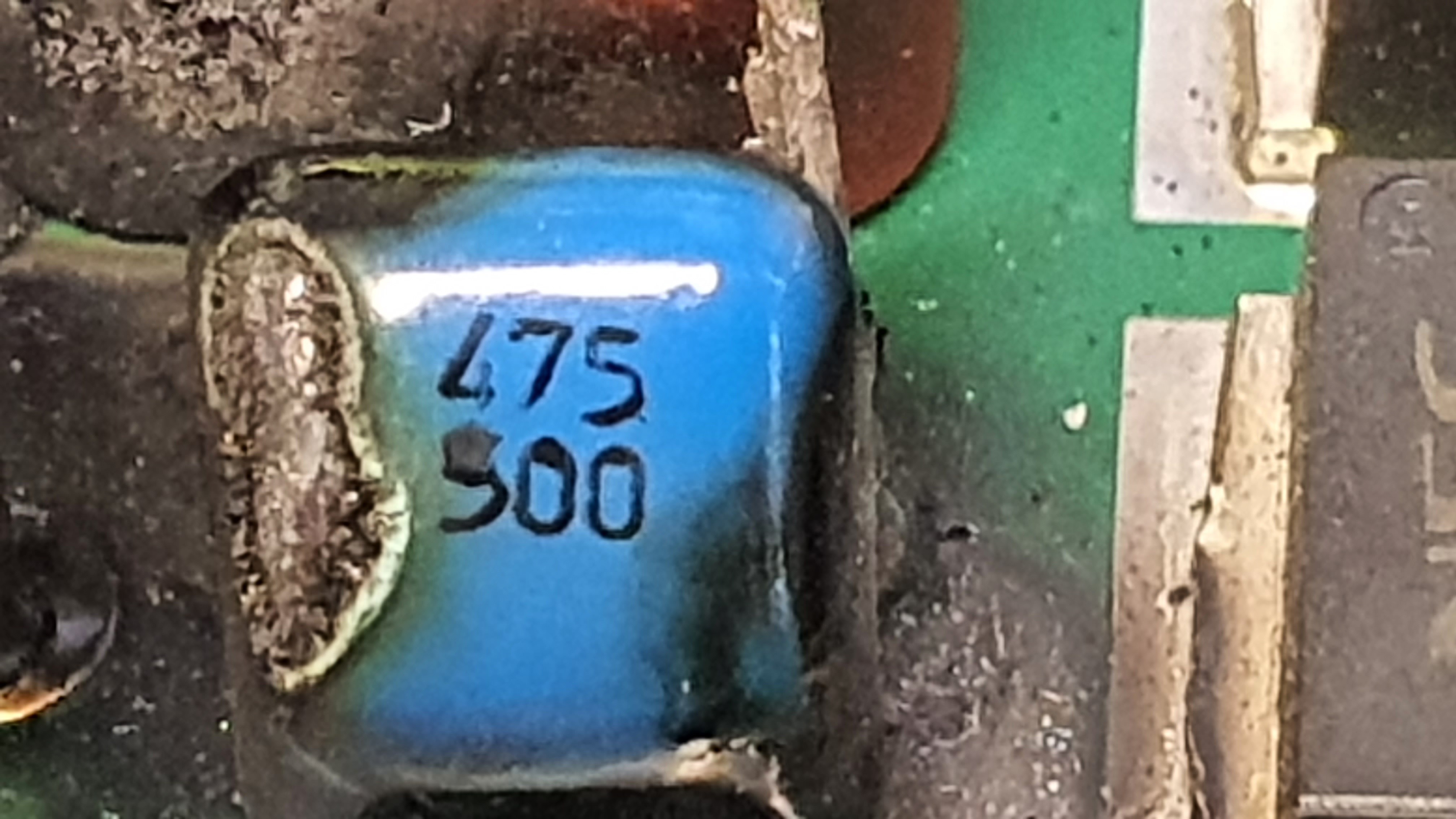

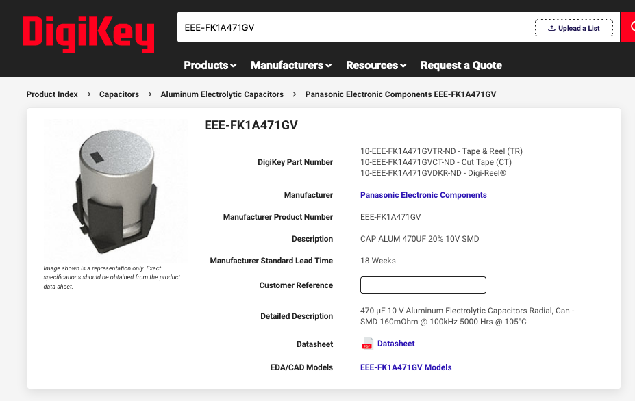

Post help identifying capacitors here
This is a sticky topic.
  • ghost180sx
    • Jun 2021
    • 12
    #161
    Originally posted by Hitto
    Yes, Marcon (''N'') which is a diminutive of Marconi (in honor of Guglielmo Marconi, I suppose) and these are very old capacitors available in stores here in Italy in the era mentioned by PeteS in CA. They are still available as N.O.S. on some shops.
    I also reinforce that, given their era, this is not a polymer. I would replace it with a Panasonic FC but also Nichicon PM would be perfect (E.S.R. not too low and capable of handling high frequencies). I would derate and use a 10V replacement.
    EDIT: I confirm, electrolytic. As per specifictions in the inventory of a shop which sells N.O.S. parts. Picture attached.
    Thanks Hitto & PeteS in CA!
    I'll be ordering some nice electrolytics as replacements.
    • DRKNSIDE
      • Apr 2025
      • 2
      #162
      looking for identity and where i can locate one of these capacitors shows 20K 560J E13 or E73 can really tell, Thanks!
      • m2farid
        • Dec 2021
        • 32
        • France
        #163
        Hi could you please help me identify the capacitors arround bios chips
        • m2farid
          • Dec 2021
          • 32
          • France
          #164
          Those one, please. Thanks
          • scottl31
            • Jun 2025
            • 5
            #165
            Would anyone know where I could purchase a capacitor like this in the picture?
            Thanks,
            Scott Click image for larger version
Name:	Capacitor.jpg
Views:	220
Size:	148.9 KB
ID:	3670400
            • CapLeaker
              Leaking Member
              • Dec 2014
              • 8352
              #166
              Originally posted by scottl31
              Would anyone know where I could purchase a capacitor like this in the picture?
              Thanks,
              Scott Click image for larger version
Name:	Capacitor.jpg
Views:	220
Size:	148.9 KB
ID:	3670400
              Mouser or DigiKey. But you can use just regular through hole capacitors too. You just bend the legs outwards.
              • scottl31
                • Jun 2025
                • 5
                #167
                Mouser or DigiKey. But you can use just regular through hole capacitors too. You just bend the legs outwards.
                I don't know how to read the markings. Are you saying that either of those companies might have pictures on their site I can match this to? Thanks!
                • CapLeaker
                  Leaking Member
                  • Dec 2014
                  • 8352
                  #168
                  Originally posted by scottl31
                  I don't know how to read the markings. Are you saying that either of those companies might have pictures on their site I can match this to? Thanks!
                  470uF, 10V
                  go for something 105c rated 470 uF 10V or 16V, at least 5000hrs rated.. Like
                  EEE-FK1A471GV
                  on Digikey.
                  • lti
                    • May 2011
                    • 2558
                    #169
                    That looks like Nichicon HC series. That's a through-hole series, but I don't see a plastic base or surface mount pads in your picture. For a while, Nichicon marked some of their through-hole series like that.
                    • scottl31
                      • Jun 2025
                      • 5
                      #170
                      470uF, 10V
                      go for something 105c rated 470 uF 10V or 16V, at least 5000hrs rated.. Like
                      EEE-FK1A471GV
                      on Digikey.
                      Mine are through hole with two legs. This one you mention at digikey looks like it's not through hole. Is this right?
Name:	Screen Shot 2025-07-01 at 11.58.00 AM.png
Views:	193
Size:	122.0 KB
ID:	3672594
                      • CapLeaker
                        Leaking Member
                        • Dec 2014
                        • 8352
                        #171
                        Originally posted by scottl31
                        Mine are through hole with two legs. This one you mention at digikey looks like it's not through hole. Is this right?
                        Click image for larger version  Name:	Screen Shot 2025-07-01 at 11.58.00 AM.png Views:	0 Size:	122.0 KB ID:	3672594
                        Then just fit a regular through hole capacitor like
                        EEU-EB1A471
                        just watch the leg spacing, diameter and height.
                          master hoarder
                          • May 2008
                          • 12175
                          • Bulgaria
                          #172
                          The cap that scottl31 posted above is Nichicon HC series, as lti correctly identified.
                          EB series from Panasonic is not quite adequate in that case, if ESR and ripple current capability are to be observed.
                          Relatively close replacements would be United Chemicon KZE and KZH or Rubycon ZLH or ZLQ. All of these are readily available on both Mouser and Dikigey ATM. Just match the capacitance and the voltage (10V, 470 uF), along with the diameter. Height-wise, UCC KZH and Rubycon ZLH and ZLQ will likely both be shorter, since they are newer miniaturized series.
                          *edit*
                          Forgot to add... Nichicon HW and HV series would also be close enough (if not better), along with Panasonic FR and FS. These are also readily available on Digikey and Mouser.
                          Happy hunting!
                          Last edited by momaka; 07-02-2025, 06:37 AM.
                          • semiRocket
                            • Jan 2013
                            • 25
                            • Croatia
                            #173
                            Hi, first time I see I cap like this, I suspect it is anyway as it is marked as C124 on the PCB. The markings means 0.1uF, 400V?
                            Well the in circuit ESR shows around 88ohms, I suspect something is not right...
Name:	IMG_20250704_111209.jpg
Views:	192
Size:	1.48 MB
ID:	3674608
                            • GASPARD
                              • Jun 2025
                              • Argentina
                              #174
                              Tranks!
                              • scottl31
                                • Jun 2025
                                • 5
                                #175
                                Originally posted by momaka
                                The cap that scottl31 posted above is Nichicon HC series, as lti correctly identified.
                                EB series from Panasonic is not quite adequate in that case, if ESR and ripple current capability are to be observed.
                                Relatively close replacements would be United Chemicon KZE and KZH or Rubycon ZLH or ZLQ. All of these are readily available on both Mouser and Dikigey ATM. Just match the capacitance and the voltage (10V, 470 uF), along with the diameter. Height-wise, UCC KZH and Rubycon ZLH and ZLQ will likely both be shorter, since they are newer miniaturized series.
                                *edit*
                                Forgot to add... Nichicon HW and HV series would also be close enough (if not better), along with Panasonic FR and FS. These are also readily available on Digikey and Mouser.
                                Happy hunting!
                                So the markings 10V, 470 uF are all I need to worry about? All the other characters on there don't mean anything?
                                  master hoarder
                                  • May 2008
                                  • 12175
                                  • Bulgaria
                                  #176
                                  Originally posted by scottl31
                                  So the markings 10V, 470 uF are all I need to worry about? All the other characters on there don't mean anything?
                                  The "HC" marks indicate that these are Nichicon HC series - a low impedance type of capacitor. So you need to get the same type - i.e. match the impedance/ESR and ripple current to generally within +/-30%. The brands and series I listed in my previous post should all be close enough. So just look for, for example, Rubycon ZLH or ZLQ on Digikey, and you should be able to find good-matching replacements.
                                  • stevesg
                                    • Sep 2019
                                    • 4
                                    • uk
                                    #177
                                    can anybody identify this 10U_0603_25V6M
                                    10U_0603_25V6M
                                    i need to know what to replace this with i assume it is 10uf and 0603 size, 25volt, but what does the 6m mean, is it 20% 10%
                                    many thanks
                                    • Trond
                                      AtomiC
                                      • Aug 2025
                                      • 2
                                      • Norway
                                      #178
                                      I'm recapping my IBM PS/2 P70 PSU and I've found information about most of the caps. However, there are 3 caps that are not found in any datasheet or in the web archive. They are labeled GM & GX.
                                      Someone told me that these are special purpose caps made for PSUs. I'm looking for Information about the Impetance and Ripple Current on these.
                                      RefDes Capacitance Voltage Mount Diameter/Size Height Lead Spacing Temp Type Brand Series
                                      C009 2.2 µF 400V Through hole (radial) 10mm 15mm 5mm 105C Electrolytic Panasonic GX
                                      C105 33 µF 250V Through hole (radial) 16mm 25mm 7.5mm 105C Electrolytic Panasonic GM
                                      C137 10 µF 250V Through hole (radial) 12mm 20.5mm 5mm 105C Electrolytic Panasonic GM
                                      • Clarify4082
                                        • Oct 2022
                                        • 67
                                        #179
                                        Hi, need help to identify and find replacement for "I9AJN"
Name:	image.png
Views:	64
Size:	1.36 MB
ID:	3718584
                                        • Slydder
                                          • May 2017
                                          • 45
                                          #180
                                          I have a THT MLCC that i am unsure of. could someone help ID this cap please?
                                          thx
                                          • varkatope
                                            Need help identifying capacitors on an MSI MS6163 ver 1. motherboard
                                            by varkatope
                                            Hey there, retro fans.
                                            I have an MS6163 version 1 board I'm trying to repair which was obviously used as a donor because it's missing a few parts, mostly capacitors. There are few high quality images online that would allow me to read the capacitor values (bad angle, blurry photos). I thiiiink I've figured out most of the values for the missing ones except for one in particular, number C210, which is in the bottom-left of the attached photo. Could someone with this board be so kind as to take a look at theirs and tell me the capacitance and voltage values of all the highlighted missing...
                                            12-15-2024, 09:48 AM
                                          • dragon3x
                                            After updating motherboard capacitors, what to do next (Asrock K7VT2, SOLTEK SL-75FRN2L)
                                            by dragon3x
                                            Hi, I have some 32 bits computer motherboards that need repair, as they fail to
                                            power on.
                                            Here are some examples :
                                            (N.B. "capacitors" indicated here are electrolytic capacitors located in the onboard
                                            switching supply area).
                                            (N.B. #2 : I could not find a 3300 microF aluminum-polymer with a higher voltage
                                            than 6.3 V.)
                                            1 - Motherboard #1 : this is an Asrock K7VT2 (socket A) that still works well. To put it on test
                                            I replaced capacitors with aluminum-polymer.
                                            3300 microF/6.3 V. x 4 replaced by 3300 microF/6.3 V. (KYOCERA...
                                            03-21-2025, 02:46 PM
                                          • slybunda
                                            AA and AAA battery charger capacitors?
                                            by slybunda
                                            hey all, iv got my favourite battery charger here which iv had for many years probably 15 years now or maybe even more. it still works good but thought id open it up to clean the dust out of it, lots of dust inside but now its clean and noticed 4 capacitors inside it and wondered if i should replace them.
                                            it has inside:
                                            2 x 47uf 16v caps 105c branded as Su'scon (lol sounds sus to me)
                                            2 x 470uf 16v LZ105c branded as G.Luxon
                                            not heard of these brands are they any good?
                                            iv attached photos of the charger and the board inside for an idea on the type of...
                                            12-24-2023, 04:41 AM
                                            Panasonic switching power supply daughter board has two 27uf @ 50 volt capacitors which I do not keep in stock
                                            by sam_sam_sam
                                            I did not have any 27uf @ 50 volt capacitors but one nice thing is that it has enough room for two capacitors in parallel a 22uf and a 4.7uf @ 50 volts 22 plus 4.7 equals 26.7uf which so very close to 27uf I will show some pictures of it sometime tomorrow
                                            This is one of the shit est boards I seen in a very long time and it was the daughter board the traces just lifting off the board I had to use the capacitor leads to repair the the traces and the main board is not any better because I had to repair several traces for the daughter board to the main board
                                            After all of...
                                            07-13-2024, 08:14 PM
                                          • Cama
                                            Solar Inverter - SMH-II - 2 missing capacitors
                                            by Cama
                                            I need help to find the value of 2 missing capacitors ( C102 and C117) on my Easun SMH-II mainboard (solar hybrid inverter). I circled it in red on the close-up picture. The 2 old capacitors are completely missing, so I have no reference. Does anyone have this board and can tell me the value or make an educated guess based on the location ?
                                            My model is : EASUN SMH-II 7 KW
                                            Mother Board : P/N 18947-002401250250
                                            Maybe the EASUN SMH-II 4.2 KW have the same capacitors
                                            Thank you...
                                            09-12-2025, 02:50 AM
