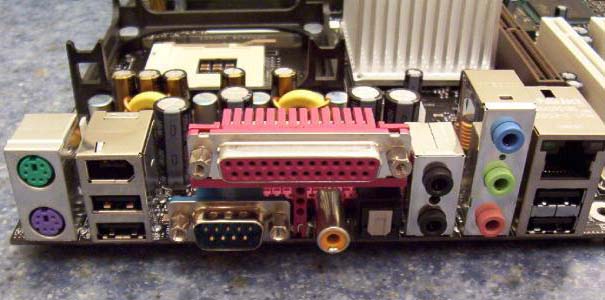

    Anyway, I have an old P4 machine with Intel D865PERL motherboard. I have recently had my local computer shop replaced the capacitors on my motherboard. It couldn't do POST. There were bulging caps on the side of the CPU socket. I don't know how many caps were replaced but the computer does work again.
    After a while, I notice that my Intel active monitoring software is alerting me of spikes outside the threshold. One time, its the CPU temp gone to 100C, then 12V gone to 15V, then Vcore gone to 0V, all these are happened separately and each happens very fast less than a second I think. When I look at the readings everything was normal. Later on, I will get the same alert, but it may not be from the same one.
    Is this a PSU problem or a capcitor problem? So far no freezes or anything like that but I haven't used the computer for long. Another note, I know for a fact the guy from the computer shop had to take caps from other motherboards because he couldn't get a new one.
    Thanks to anyone who can point out something.

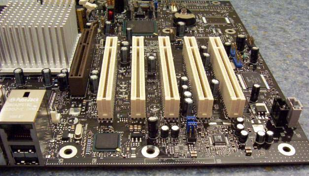

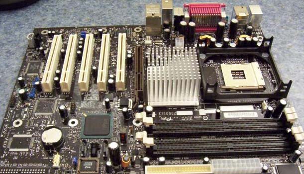

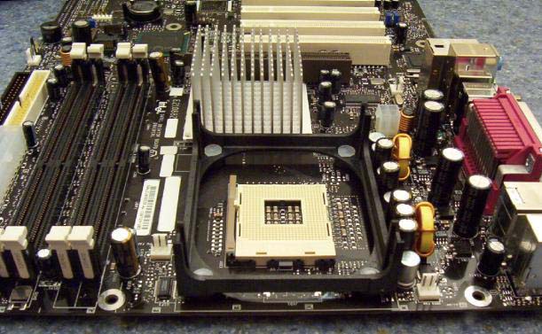

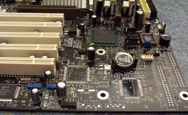

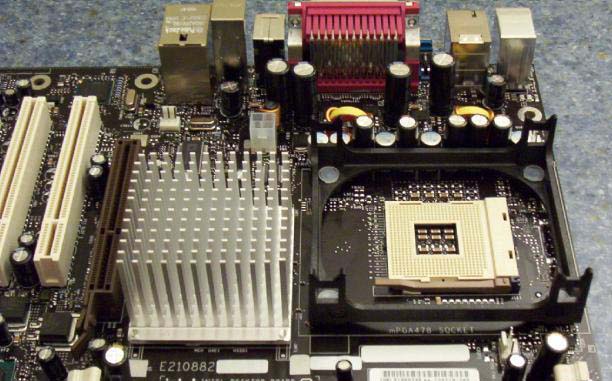

                    first, not every cap needs to be replaced.. at least it is not very likely.. a lot of the smaller caps almost never need replacing on the boards.. It is usually more the standard size ones (with top vents), but can not tell you for sure without seeing or testing the board.
                    as for the caps, i am not sure but a lot of sellers will sell caps to other countries. maybe try badcaps and see. I know he does ship overseas, just not sure about your country..
                    I have attached some pics of your board that i found on the net. At least now we can see what the board caps positions are..

                      I'll repeat it.
                      Intel used 85C caps [usually Nichicon] for the small 4&5 mm caps on some boards at least from socket 370 through socket 478.
                      [Socket 775 if you include Dell-Intel-Foxconn boards.]
                      They dry out and go bad and don't always bloat.
                      They start going bad when the boards are 5 to 7 years old depending on how well it was cooled. [The inadequately cooled Dells can kill them even sooner.]
                      Yeah, that problem isn't typical except to Intel [and Foxconn] made boards, which this is, so I mentioned it.
                      Original caps on a Intel D865PERL sometimes include the defective Nichicon HN and/or HM series caps. [Might also have Chemicon KZG but Intel didn't favor those much.]
                      If the tech only replaced obviously bloated caps you may still have some bad but not bloated yet HN or HM on the board.
                      In Indonesia you can probably order Samxon from Big Pope [a member here] who sells Samxon caps out of Hong Kong.

                        To REALLY know you would need an O'scope.
                        Next best is to remove the caps and check them with an ESR meter and an Ohm meter and a uF meter.
                        Most people just replace the caps 'and see' [retest the board] because the needed test equipment isn't worth the cost for occasional use.
                                Thanks for the pictures, I don't have my camera with me so I can't take picture.

                                Yep as far as I know, the tech only replaced the bloated caps on the side of the CPU socket. There are about 10 caps or so. The row of caps between the CPU and the 2 yellow circular thingy. (this is not my motherboard, picture taken from kaniki's post) So other than these, you're saying the smaller caps could also be bad (without any visible sign) and causing the hardware monitoring to give odd readings? By the way, before recapping I don't think I ever got any alerts from my hardware monitoring software.
                                The Nichicon HN/HM, what color do they have or look like?
                                I have to ask, 85c means the temperature and 4 or 5 mm means diameter?
                                When I have my camera back I'll try to post my motherboard picture here, hopefully the picture is good.

                                  HN are black with gold lettering and are marked HN(M)
                                  HM are black with white lettering and are marked HM(M)
                                  The (M) is not part of the part number.
                                  It's the industry standard tolerance mark meaning +/-20% for the uF.
                                  - Most caps you run across will have it somewhere.
                                  Note: If you see a [M] with squarish side brackets and no other logo or brand name it's probably Matsushita - aka Panasonic.
                                  Date codes on Nichicons are like: H0344
                                  .. which would be year 2003 [the 03] and week 44.
                                  Year marks 01 through 04 are bad.
                                  [Some people say 05 too but the problem was ID'ed in mid 2004 and fixed so that isn't correct. Late 2004 is probably okay but as no one has an actual date it's safer to call all 2004 bad.]
                                  Chemicon KZG [another good brand with a bad series] have a shield for a logo and are brown with white letters. The "KZG" will be evident.
                                  [KZJ has the same problem but I'm pretty sure they are too new a series to be on that board.]

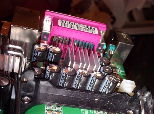

                                  Nichicon HN
                                  Nichicon HM

                                      Re: odd motherboard voltage reading
                                      More Pics from other threads.
                                      Chemicon KZG
                                      Note shield logo. All Chemicons have it.
                                      Bloated KZJ
                                      KZG and KZJ don't always bloat.
                                      Panasonic FM
                                      Note M logo for Matsushita [the parent company]
                                      Panasonic FM
                                      Note shape of Panasonic Trademark vent stamp. All Panasonic have it.
