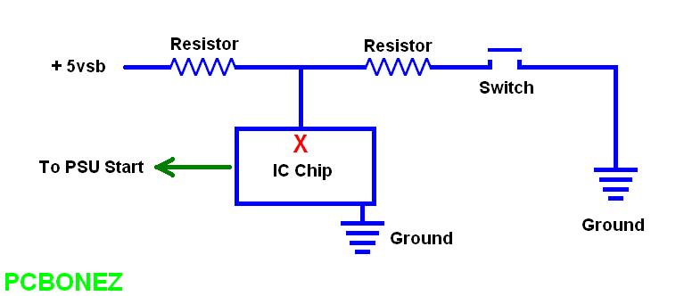

        Another thing what can cause a motherboard to power on by itself, when the switch at the back of the PSU is turned on? The front panel connector is not even connected to the motherboard.
        Two things:
        - A BIOS setting that tells it to either start or return to previous condition after a power loss.
        - A short in the circuit the switch goes to.
        Look at the drawing. Note the IC pin marked with an X. When the switch is open the voltage on X is high, near +5vsb voltage. When the switch is shut the voltage on X goes low, probably less than 1v. [This is called to 'pull down' the pin.] When pin X is pulled down the IC sends a signal to the PSU for it to start. [The IC is usually integrated into the chipset.] The PSU then has roughly 50 milliseconds to get voltages within 80% or it will initiate a protective shutdown. [Turn itself back off because 'something' is wrong if the volts don't come up.] - - - Anyway, if pin X or the resistor between it and the switch has a ground it will 'think' it is pulled down... You see?

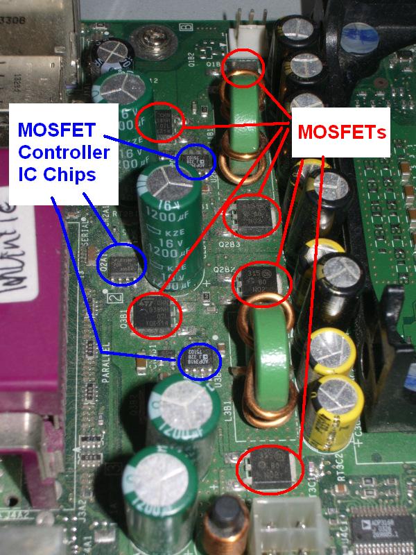

          VRM MOSFETS? It sounds like something I read before, can't remember now. Where is it located?
          Suppose it has traits you mentioned, is it replaceable?
          They are replaceable but they can be a bugger to get off when they are soldered on flat like they do these days. The metal chunk at one end is the heat-sink. The whole back side of that is soldered down so it takes a lot of heat.

            I had to read few times but I think I sort of get it. The drawing does help though, thanks.
            The bios setting is set to off after power failure. What are the likely suspects for this ground?

                There is an unseen resistor [or resistance] inside the IC chip between X and ground. Compared to the internal resistance the two resistors outside the IC chip are small and the one on the +5vsb side is the larger of the two.
                - With the switch open the current path is through the 'X -to- +5vsb resistor' and the unseen resistance. The unseen resistance is higher so most of the voltage drops arcoss it and the voltage on X goes high.
                - With the switch shut the primary current path is through the 'X -to- +5vsb resistor' and the 'X to ground resistor' because the 'X to ground resistor' is a very small ohm resistor. The 'X to ground resistor' doesn't drop much voltage and that pulls X nearly down to ground potential.
                All the other things that will start the PC [wake-on-lan, wake-on-ring, wake-on-mouse, etc] do the same thing as the switch in that they put a ground on X through a small resistance.
                - As the board has been worked on I would first look for solder splats or solder hairs shorting PCB traces. That would be the most likely suspect. [And about the only easy one to find.]
                - Next look for SMD parts that shifted when caps were replaced.
                - It's possible a bad small cap has failed in such a way it is effectively replacing the switch. [Short on ground side of X making X low.]
                - It's possible a bad small cap has failed in such a way that it is pulling a whole segment of the +5vsb distribution down to near ground. [Short on power side of X making X low.]
                - It's possible a bad cap in the power to the IC chip [or that section of the chipset] is affecting it's power and so affecting it's operation.
                - It's possible a bad cap in the Reference Voltage for the IC chip [or that section of the chipset] is making the Reference Voltage wrong. The IC compares the voltage at X to some other voltage to know if it's high or low. That other voltage is the Reference Voltage.
                - A bad small cap can also hose Vtt. Vtt is kind'a sort'a the power voltage IC chips use to make siganls to other chips. [Flashlight Anaolgy: Vtt is the battery, the IC chip the signal comes from is the switch, the IC chip the signal goes to is the bulb.]
                Most of those are a real pain to circuit trace and track down. At some points you may find you are looking up IC schematics to figure out what to check next.

                  Someone just showed up with a blown MOSFET like I mentioned earlier.
                  Happens but not too common.
                  https://www.badcaps.net/forum/showthread.php?t=10400
