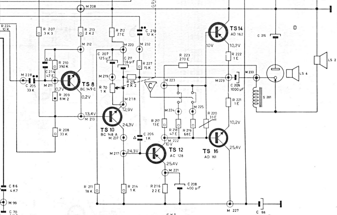

                        This 'thing' is an old (1960's) Philips receiver/amplifier which is all solid state, so this won't apply right here.
                        Managed to get both channels working however the one that had failed is distorting.
                        Amongst other things, the channel had a failed germanium AC128 32v 1A PNP which I've replaced with a couple of different PNP's (to test) but that makes no difference.
                        Considering that all the electrolytics and a few ceramics have been replaced, then what else in a circuit might distort the signal?
                        Enclosing the section in question...
                        Any pointers are appreciated.

                          if you have a stereo device you can find the fault by swapping parts between the 2 channels

                            I would make sure the transistor you replace for the germanium transistor is another germanium transistor. The characteristics of a silicon transistor is different and could very well cause distortion. Here is a link to explain that.

                              Very good point. I fact, it had dawned on me that I could compare the two channels' voltages, and had just finished drawing up a complete list of all the voltages from the schematic, which I can compare to the actual readings.
                              Seeing as it is highly possible that the silicon replacement for the germanium isn't helping, then that can easily be switched over to confirm, one way or the other.

                                  So...
                                  Using the same AC128 germanium on the bad channel resolved the problem...!
                                  It is not 'quite' as clear as the other channel, but I think once connected up, that only an audiophile would clock the difference.

                                    It is important to keep those germanium transistors cool. Make sure the components around the transistor are with-in specifications. You do not want to overdrive those transistors any anyway. You also might check to see if you can locate a used one that maybe has no damage.

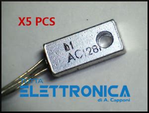

                                      Astonishingly, I found an AC128 in my components vault, down in the dungeon.
                                      Btw, these are the square ones with a hole through (photo), which enables them to fix to the large heatsink.
                                      All the nearby components are original, to spec, or as near as possible (i.e. the 1.6uF is now a 2.2uF and the 125uF is now 150uF). All the transistors are as specified in the schematic.
                                      The only components which I went 'off-piste' with were the 2 x 2200uF in place of the 1000uF main output caps, and a 100uF instead of a 64uF on the balance.
