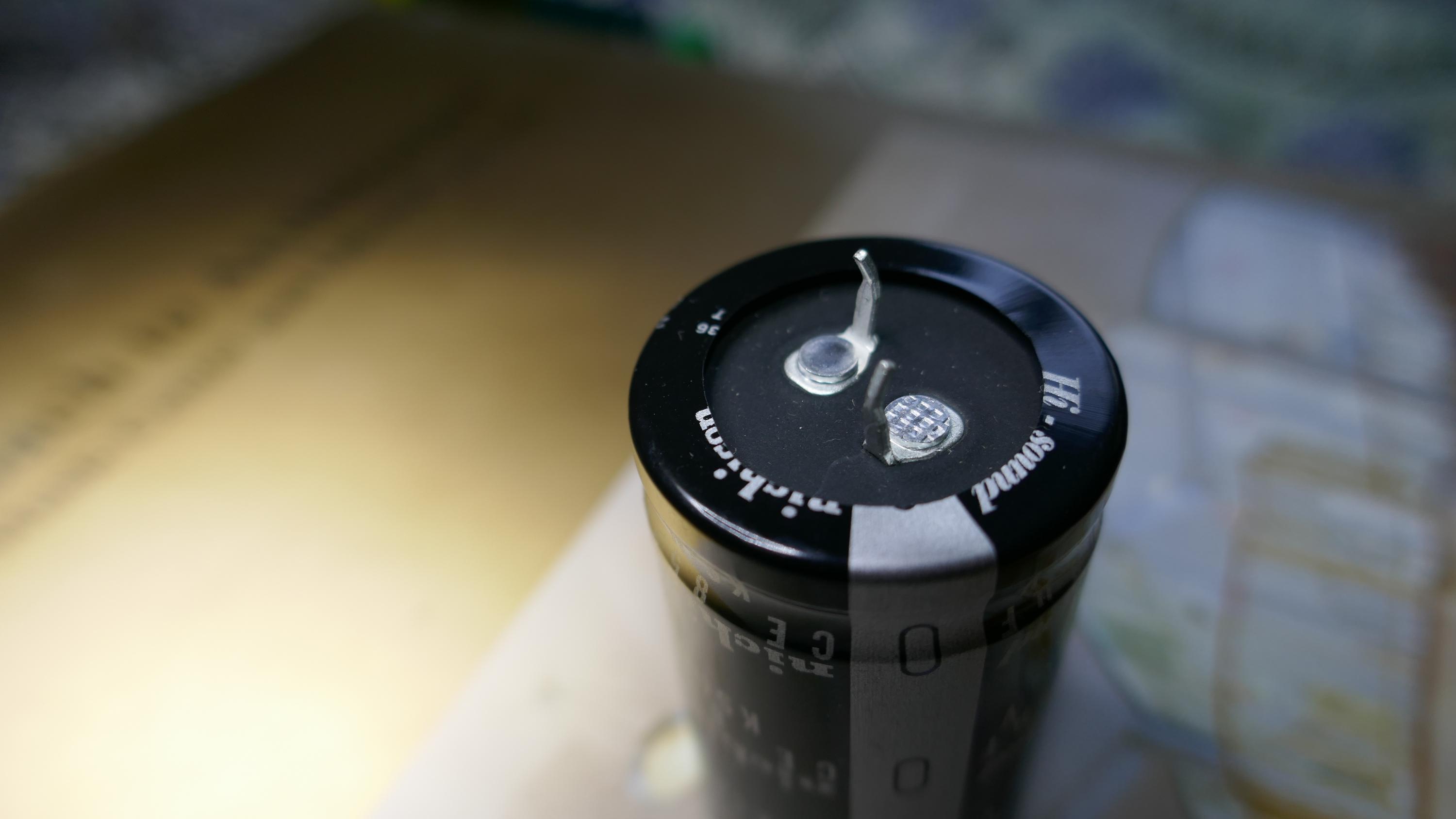

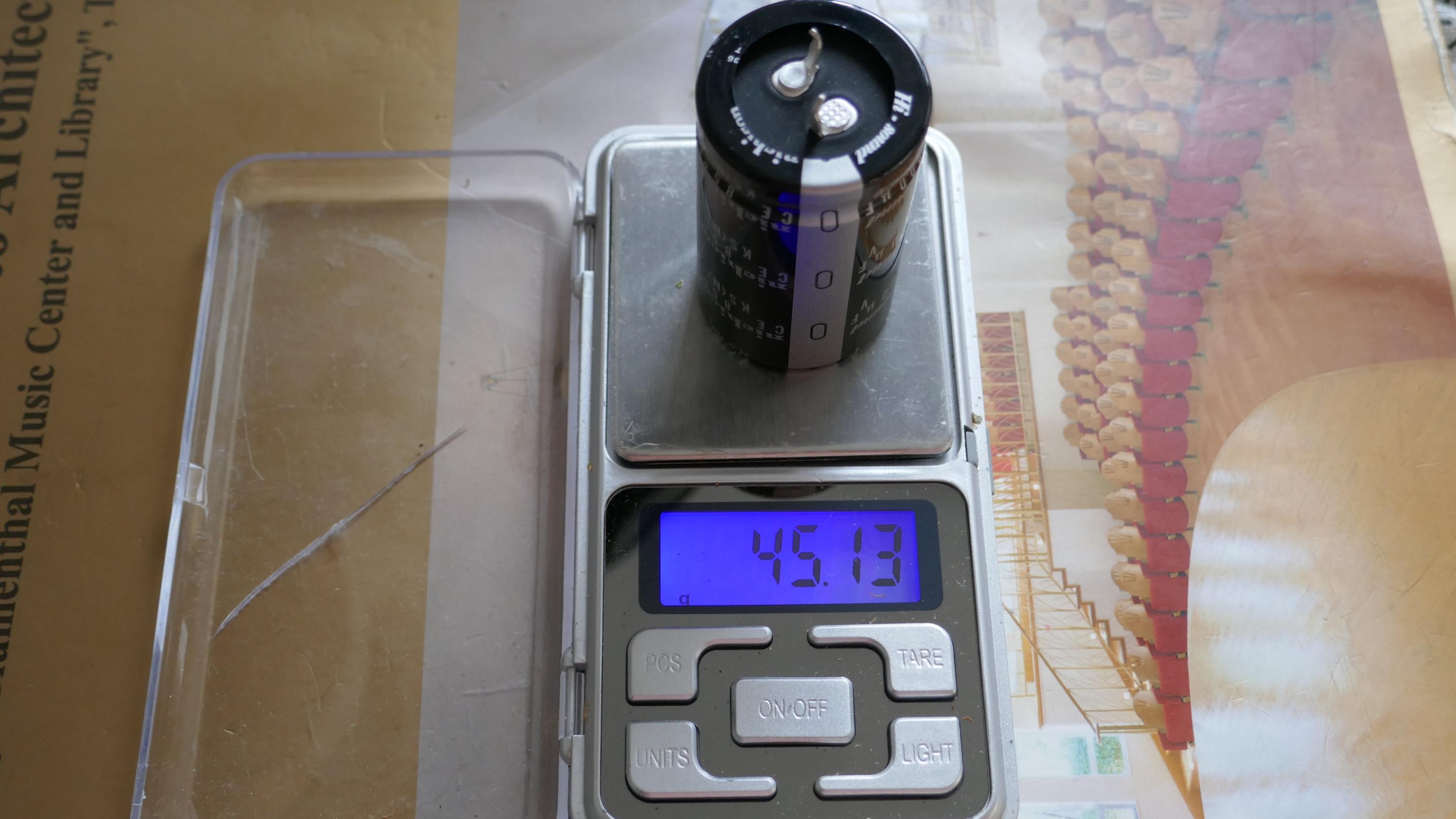

    I have recently received some Nichicon LKS1J103MESB 10,000uf 63v capacitors. They felt very light when I picked the up so I decided to weigh them. On my admittedly cheap scales they weigh 46grams the spec sheet says they should be 59grams. I tried them on 3 sets of scales and the readings are the same. The seller says that he only buys from mouser and digikey.
    Is it possible for them to be real Nichicons? I really want them to be genuine it would save much time and effort. I am recapping an old Audio Dynamics ca2000e amplifier (I know it is an obscure make but I love this old thing from th 80's) and don't want to put bad caps in it.
    Any insight would be appreciated. I have no experience with identifying genuine capacitors.

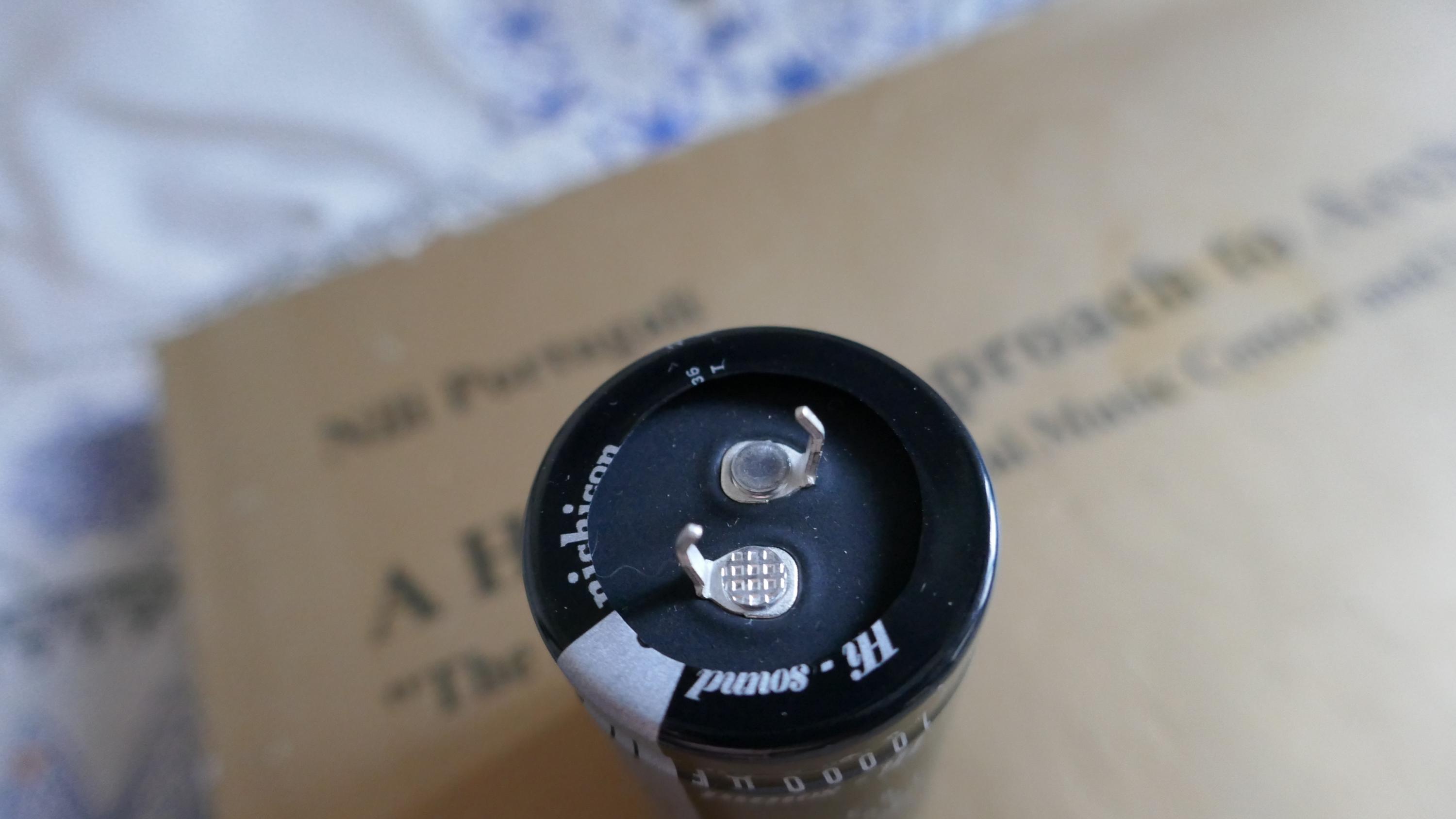

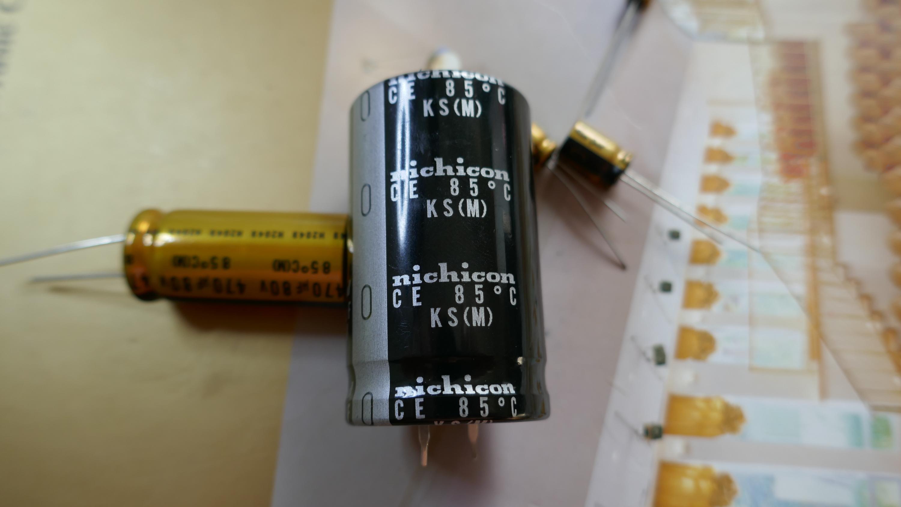

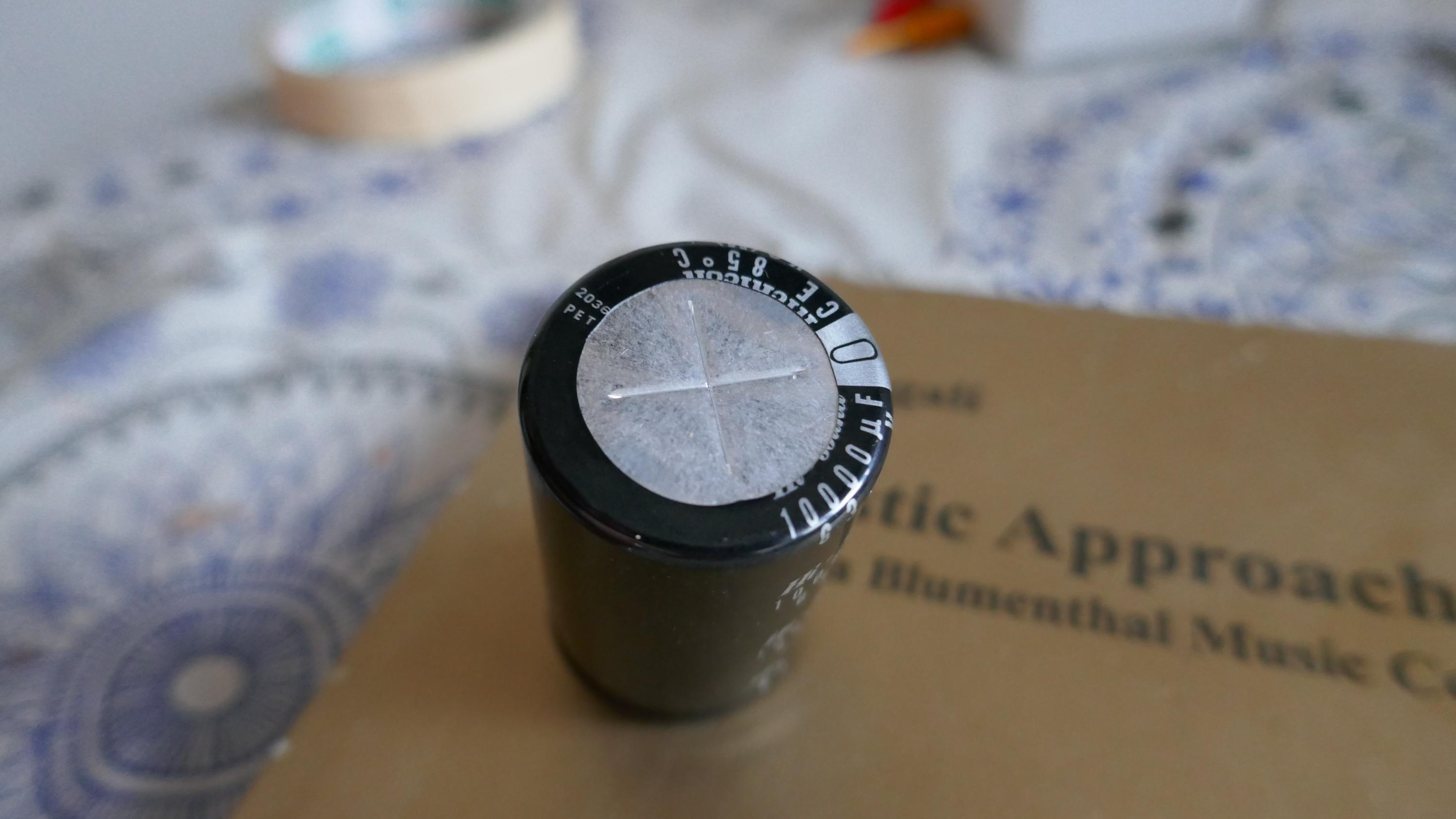

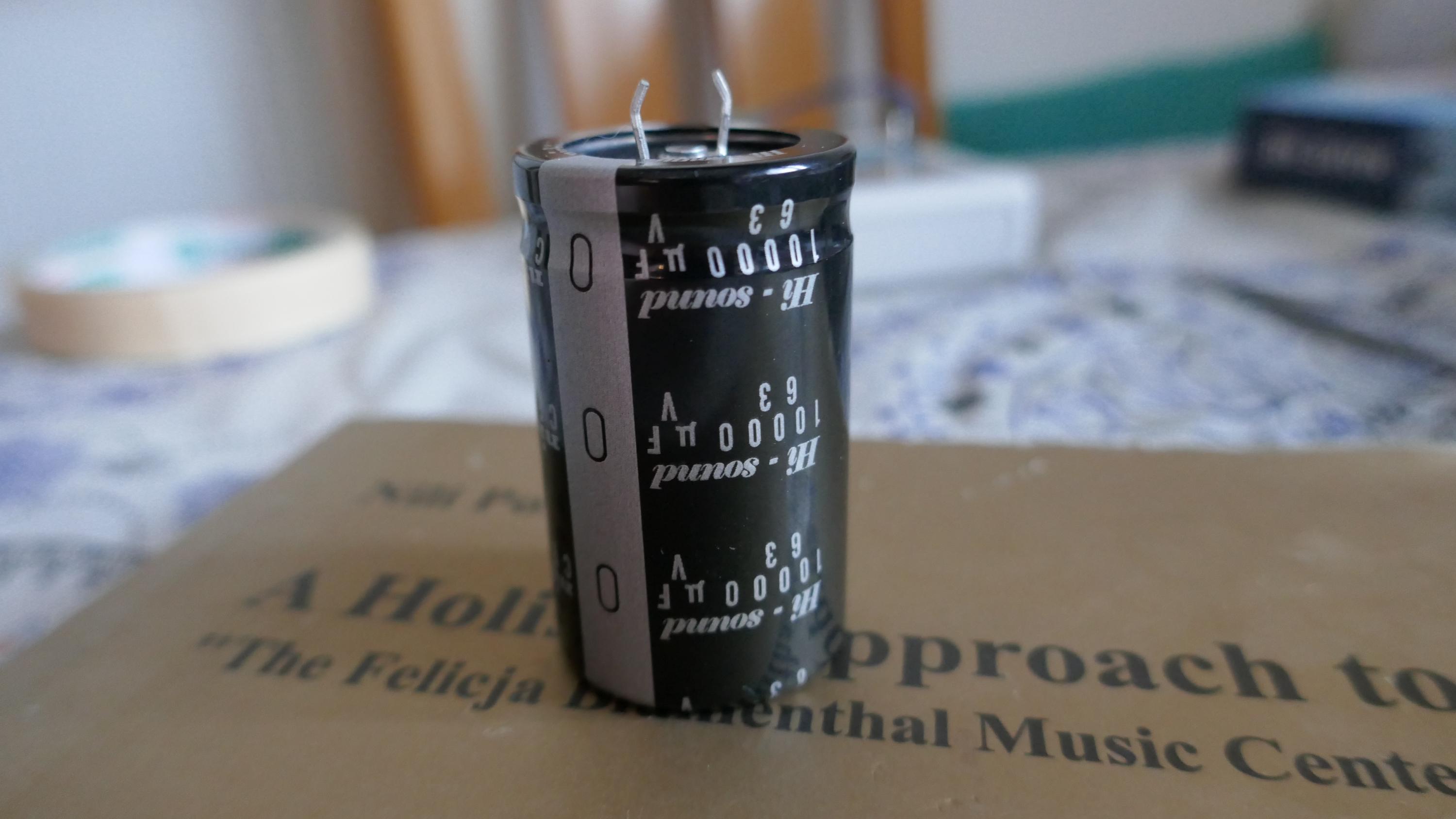

          While I wait I have taken another couple of photos, just in case someone sees something obvious in them.

              Thanks for your reply, I will take measurements and check them out. The weight difference worries me, but the weight came from a mouser page not an actual data sheet (couldn't find weights on the data sheets).
              I'm inclined to believe the seller that he only buys from trusted sources. Just the weight bothers me ( I'm used to checking 18650 batteries for weight as it is a good indicator of authenticity).
              Ok I checked the sizes for 4 different caps that he supplied me and the sizes are all spot on.

                Well for what it's worth it looks really good so if they faked it they sure did a good job at it!

                    Looking real to me, since the quoted weight is not from an official data sheet, it may be wrong.

                      I've never seen any datasheet listing capacitor weight. So lot of fuzz about nothing IMO.

                        Eventually I got to look at another definitely genuine Nichicon and the weight is 45 grams and looks identical. So the weights listed on sites like mouser are not accurate. At least I can confirm that the cap is original and the other caps from this seller are also original, which is a relief as I had already replaced about 50 smaller caps.

                          As for the Nichicon caps show in this thread - I'd say they look very genuine as well. It's actually fairly easy to spot fake Nichicons by their vent stamps. Sure they use the conventional "X" vent, which may seem easy enough to copy. However, Nichicon's "X" isn't just a simple "X". Note how thin the indents are and that they are rounded near the edges. They also don't go all the way across from side to side on the larger cans. On fake Nichicon caps, they always seem to make the stamp indents too deep and go all the way across the top of the cap... and that's if they even got the correct stamp on there (some fakes are so bad, they miss even that and use something completely wrong, like a "Y"-shaped vent. )
                          So I think you should be pretty safe with using these capacitors and that they are more than likely genuine.
