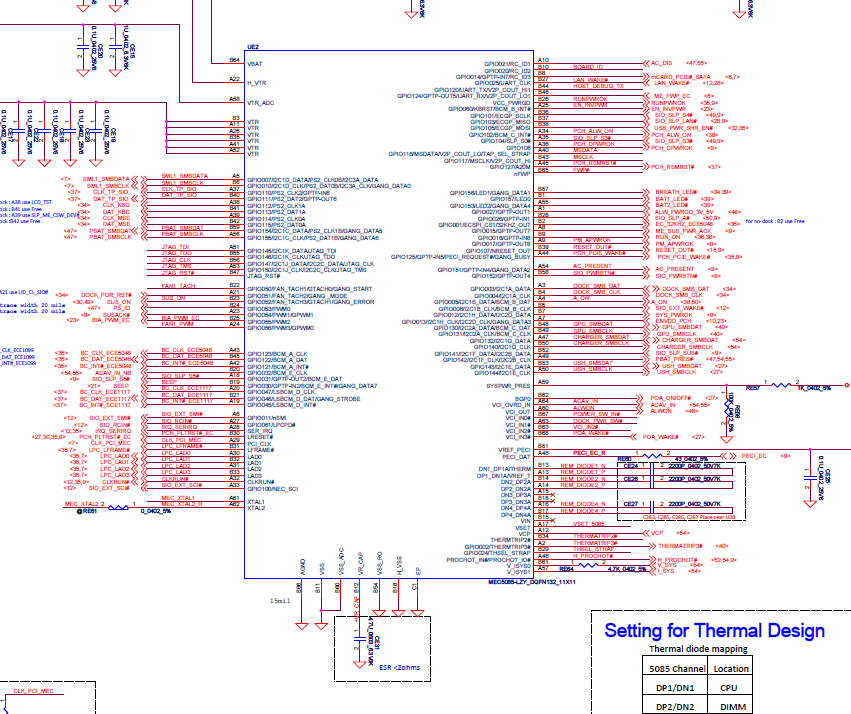

    -latitude e5550 all batteries sense as non genuine(ive tried two working genuine and two new non genuine).
    -battery led flashing white and amber which indicated non genuine AC adapter. tried multiple bios.
    -ive tried multiple genuine chargers
    -the circuitry seems to be working fine and battery and charging seems to be controlled by EU2 which is ECE5048-LZY
    https://datasheet.octopart.com/ECE50...-147335658.pdf
    does this chip have to be programmed? or is it replaceable? do you all think this could be the reason?

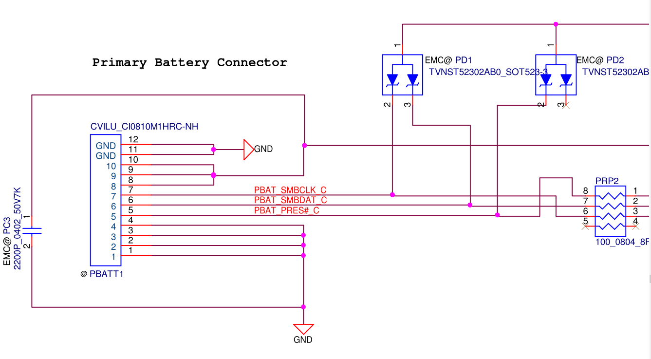

    2) measure the voltages on pins 5, 6 and 7 of the battery connector. These are used to extract the data from the battery. if the local ESD diodes are zapped, they could hinder the communication channel to the logic board. As a test, you could simply remove these ESD TVS diodes and see if the results improve.
    • sdinelli
      Sdinelli
      • Aug 2014
      • 152
      Re: latitude e5550 - no charge- all battery not recognized as genuine
      Yes all genuine dell chargers.
      dat and clk pins both fluctuate from 3.27V - 3.235V
      pres read -30mV w/o charger and flat 0 with charger
      W/O battery
      dat and clk read steady 3.305V
      pres steady 3.277V
      i assumed when battery was plugged in it pulled down pres to let it know it was there..
      PD1 and PD2 dont seem to be an issue. although im not sure what the function of them are.
      PD1 had voltage drop of .800V and 1.48V reversed
      PD2 has VD of .600mV on OL reversed
      is PD1 an issue?
      • mon2
        • Dec 2019
        • 14619

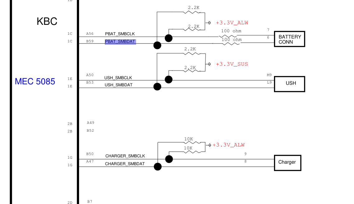

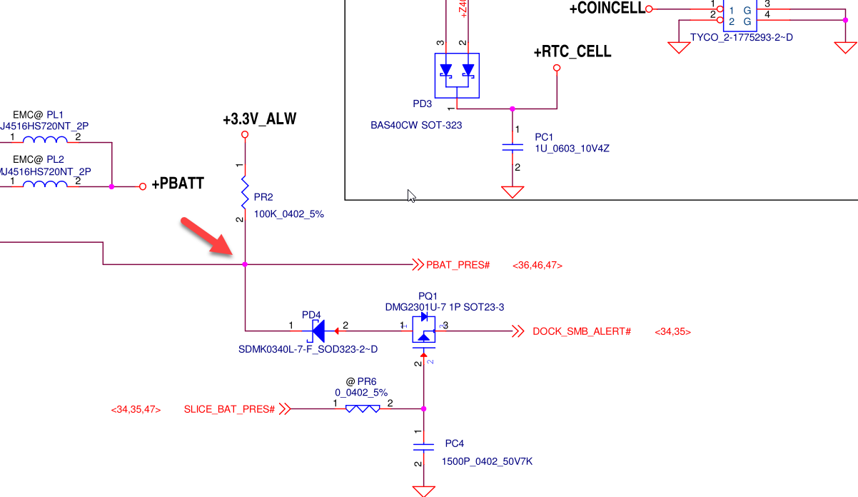

        3v2 on the SMBUS (I2C) lines is ok. These 2 lines will be used to extract ID info by the KBC controller. You may have to reflash the KBC but personally do not have experience with this area.
        The PBAT_PRES#_C line is active LOW so 0V is ok. To confirm, you can remove the battery and check the PBAT_PRES#_C line again.
        See attached. Monitor the voltage at the junction with and without the battery.
        Do you see a difference ?
          Yes i can confirm PBAT_PRES#_C is 3V2 w/o battery
            At this time, believe the decision of whether it is a Dell battery or not is made by the KBC. The KBC has an internal 8051 microcontroller (if I recall correctly) that uses firmware for the assorted function. Wait for feedback from others like @SMDFlea who is very knowledgeable on the KBC. Issue may be just the incorrect bios which also holds the KBC firmware.
            • sdinelli
              Sdinelli
              • Aug 2014
              • 152
              Is that the chip i posted in first post?

                yes - same. Any chance the KBC has solder ball issues or is defective?
                Does the keyboard work ok ?
                That is, perhaps the I2C (SMBUS) lines are not reaching the KBC balls ?
                The external pull-ups are working since you have +3v3 (approx) for these open-drain lines. However, in the end, the KBC is the bus master and must communicate with the battery logic.
                I think you also noted that the AC adapter is not detected properly? That too is a function of the KBC.

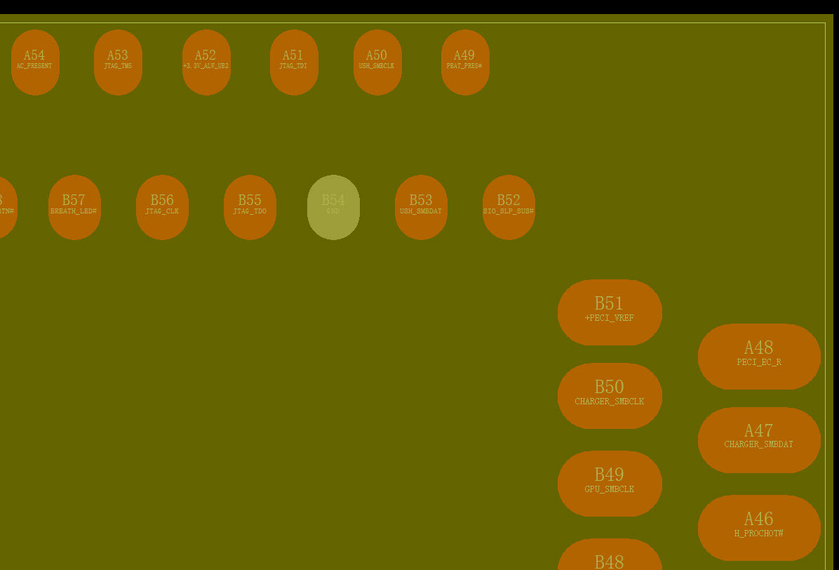

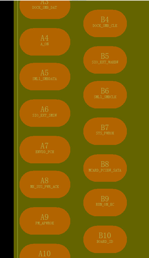

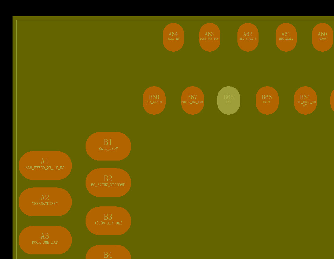

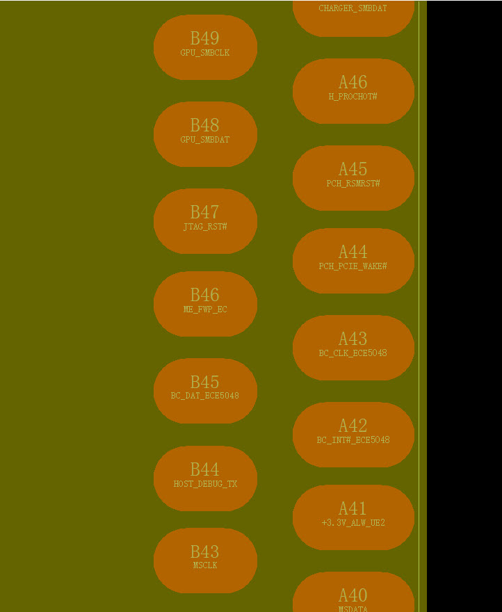

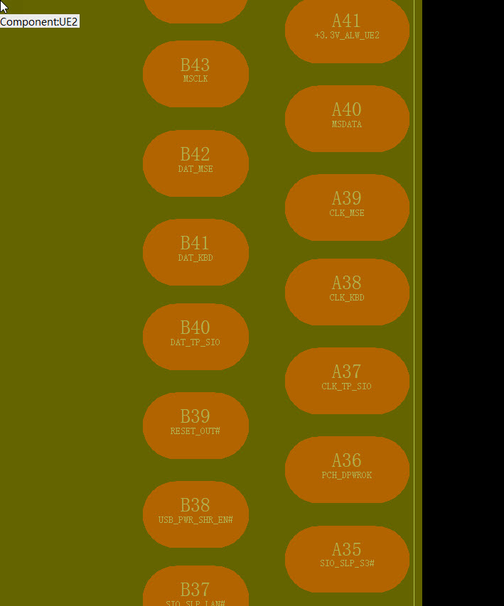

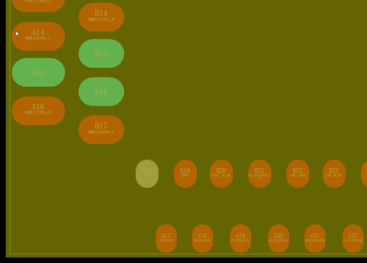

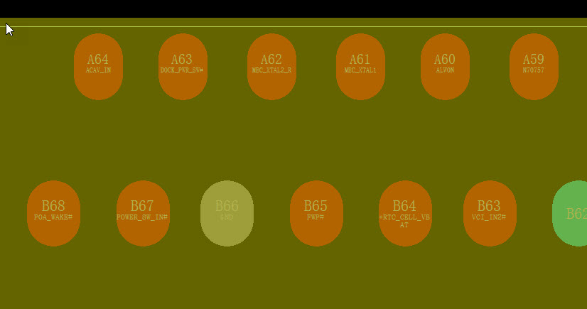

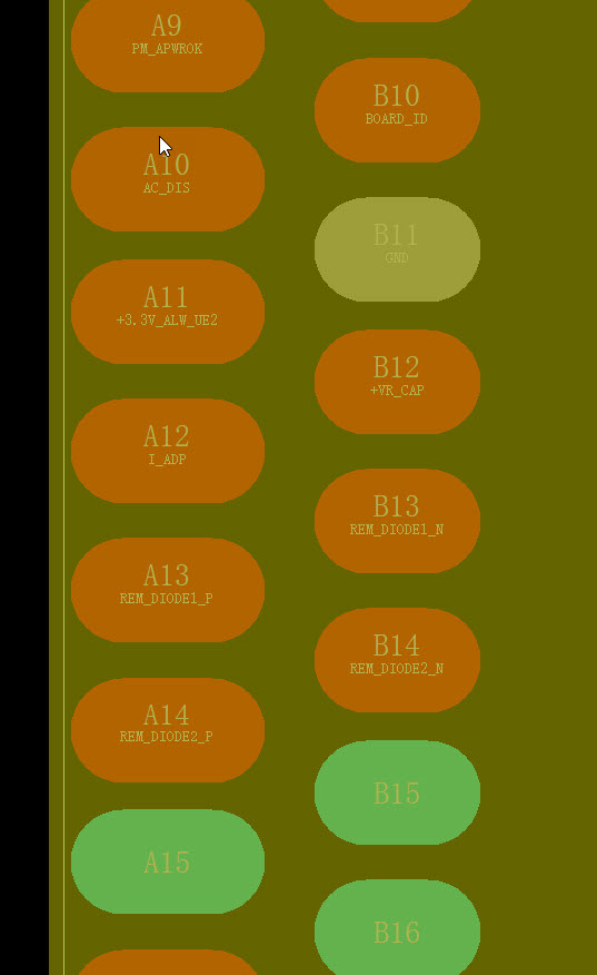

                      a boardview file would be nice. dells schematics suck i feel like.
                      whats up with the weird pin alpha numeric crap
                      • mon2
                        • Dec 2019
                        • 14619

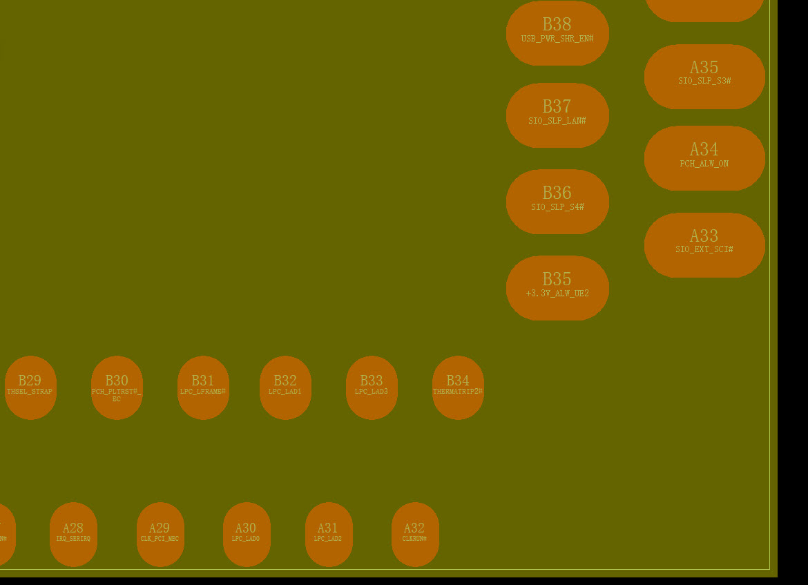

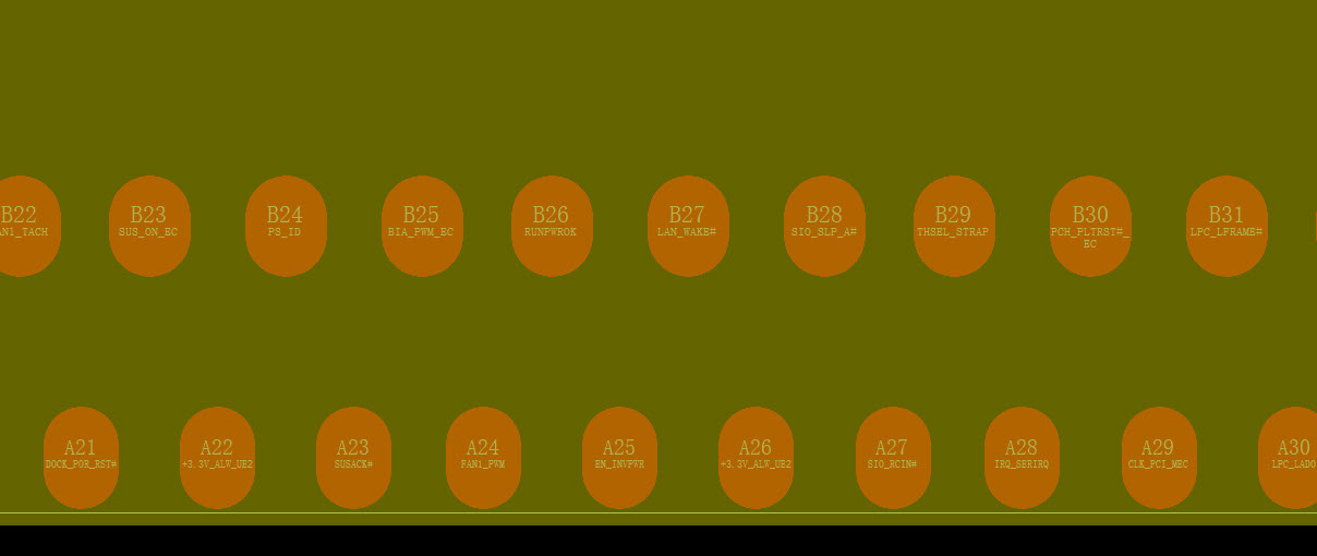

                        Alphanumeric usually means the package is a BGA or QFN
                        Update:
                        Found it in the schematic and the symbol is marked as:
                        MEC5085-LZY_DQFN132_11X11
                        So it is a 11x11mm QFN (Quad Flat Pack package)
