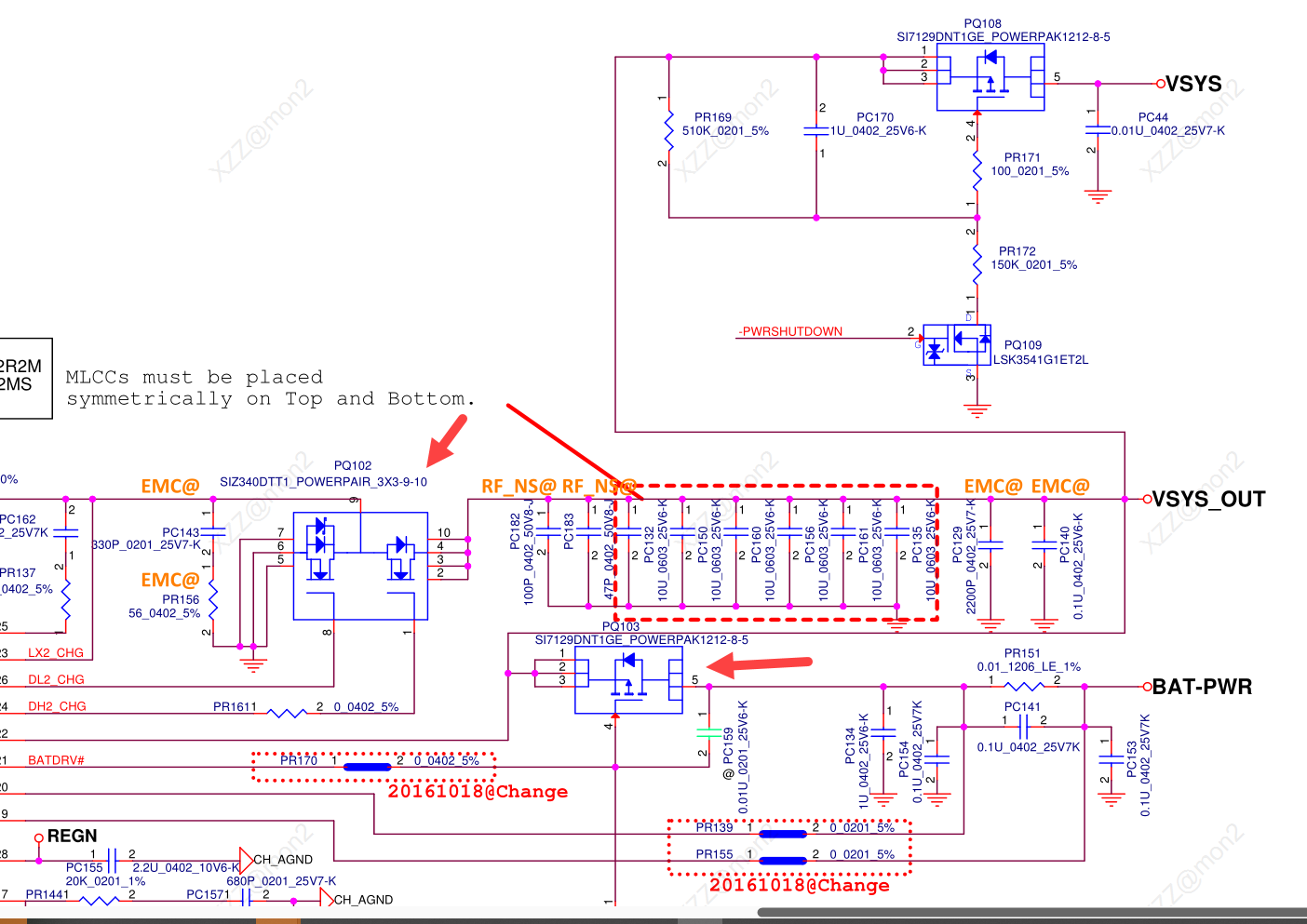

t470 have fake charging
  • eliemgh
    • May 2024
    • 13
    • lebanon
    i have t470 have fake charging
  • mon2
    • Dec 2019
    • 14742
    Can you test with another battery if available? Does Windows report the battery gauge and the battery gauge climbs over time?
    • eliemgh
      • May 2024
      • 13
      • lebanon
      I have replaced the battery, but the same problem persists. When I remove the charger, Windows still shows that it is connected ot the charge, and the charger light remains on. We have to disconnect and reconnect the battery; only then will the charging symbol disappear
      • mon2
        • Dec 2019
        • 14742
        Remove all power. Remove the battery. Meter in resistance mode.
        Measure the resistance across the mosfet pins to check if they are leaking.
        source (1-2-3) & drain (5-6-7-8)
        source (1-2-3) & gate (4)
        gate (4) & drain (5-6-7-8)
        Post each measurement. Start with checking the battery mosfet @ PQ103. If the resistance is low, then the mosfet may be defective.

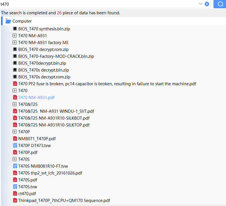

          this schematic for t470 ? because can't find it on motherboard

            My database shows that T470 = NM-A931 logic board. Can you confirm?

            • eliemgh
              • May 2024
              • 13
              • lebanon
              ct470 nm-a931
              rev 2.0
              2016-10-28
