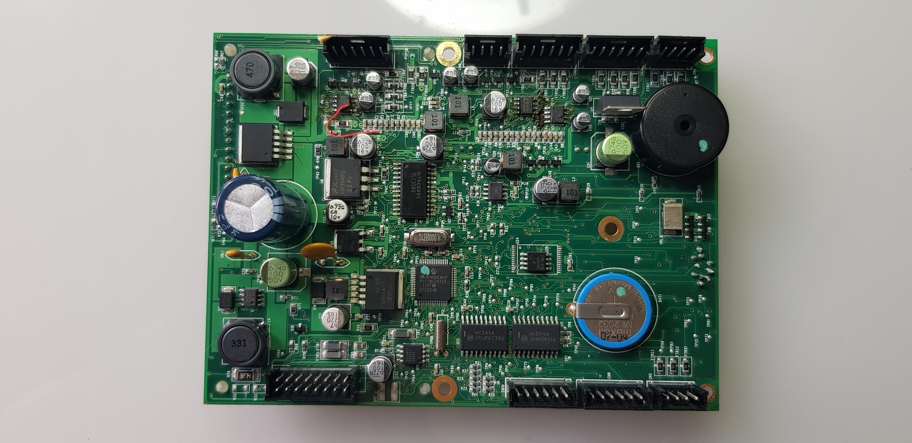

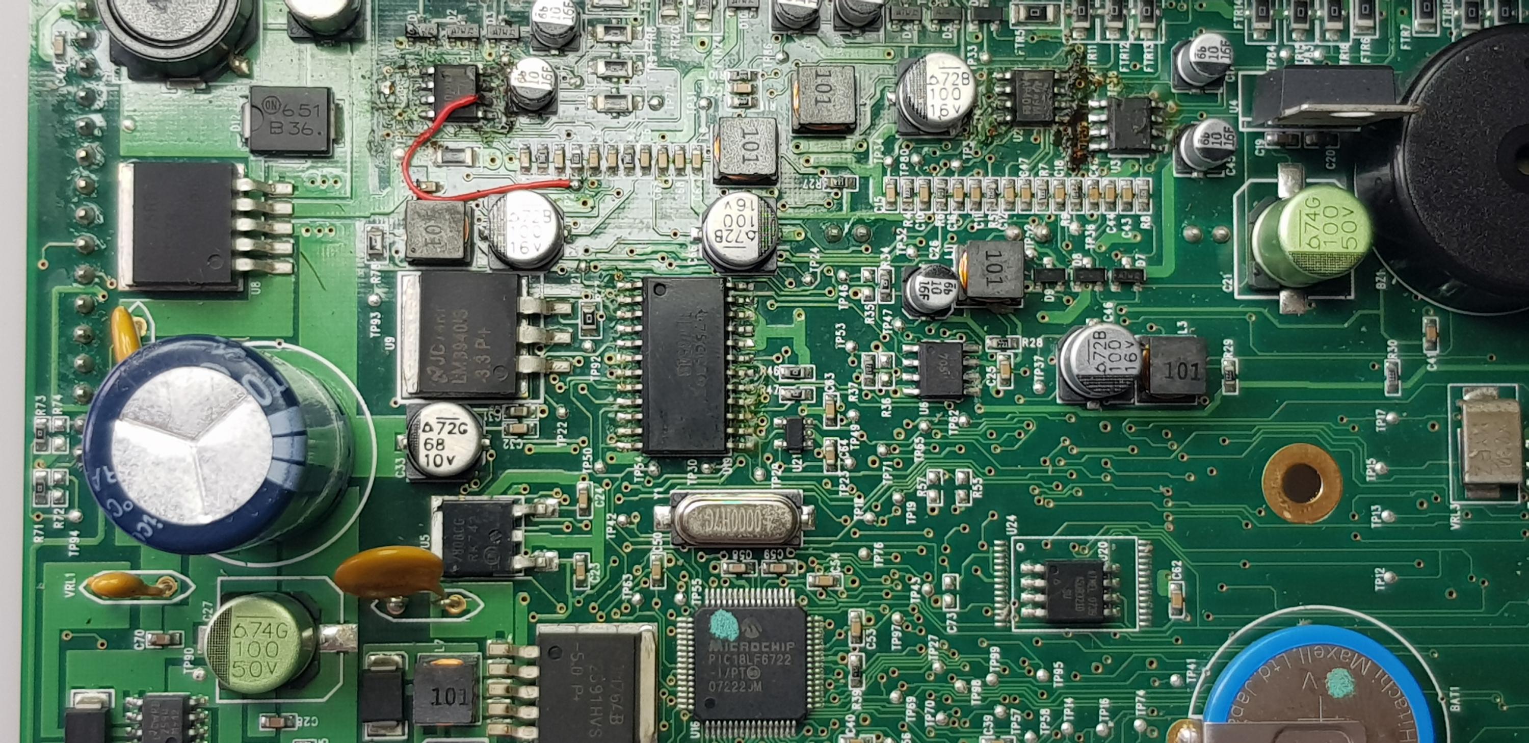

          Thanks redwire, it might be as you say.
          Here are some pictures of the board.
          it looks messy around the op-amps as I desoldered them multiple times. One of the traces come up. I had to use micro wire to re-do the connection.
            Re: Valeo AC650/690 PRO scales, opamp, PIC controller fault
            Ah.. you said that you measured before the op amps, then after them, and then at the input pins of the PIC?
            Have you checked for shorts at all between where the ground enters the chip and the input pin that is having the problems? I would expect each of these i/o pins for each of the scales to have the same sort of voltage potential differences. If you measured from something like what seems to be a common ground you might actually be getting some false readings..
            If all of the inputs have the same sorts of voltage, there doesn't seem to be any low ohms shorts between the faulty pin, and the op amps behave the same all the way up to the chip I would think that there was something physically wrong with the chip or that there is some calibration in the software that has gotten badly jacked. For instance, maybe there was a calibration where you were suppose to have the scale empty but they had it full at the time and the software doesn't handle negative numbers.
