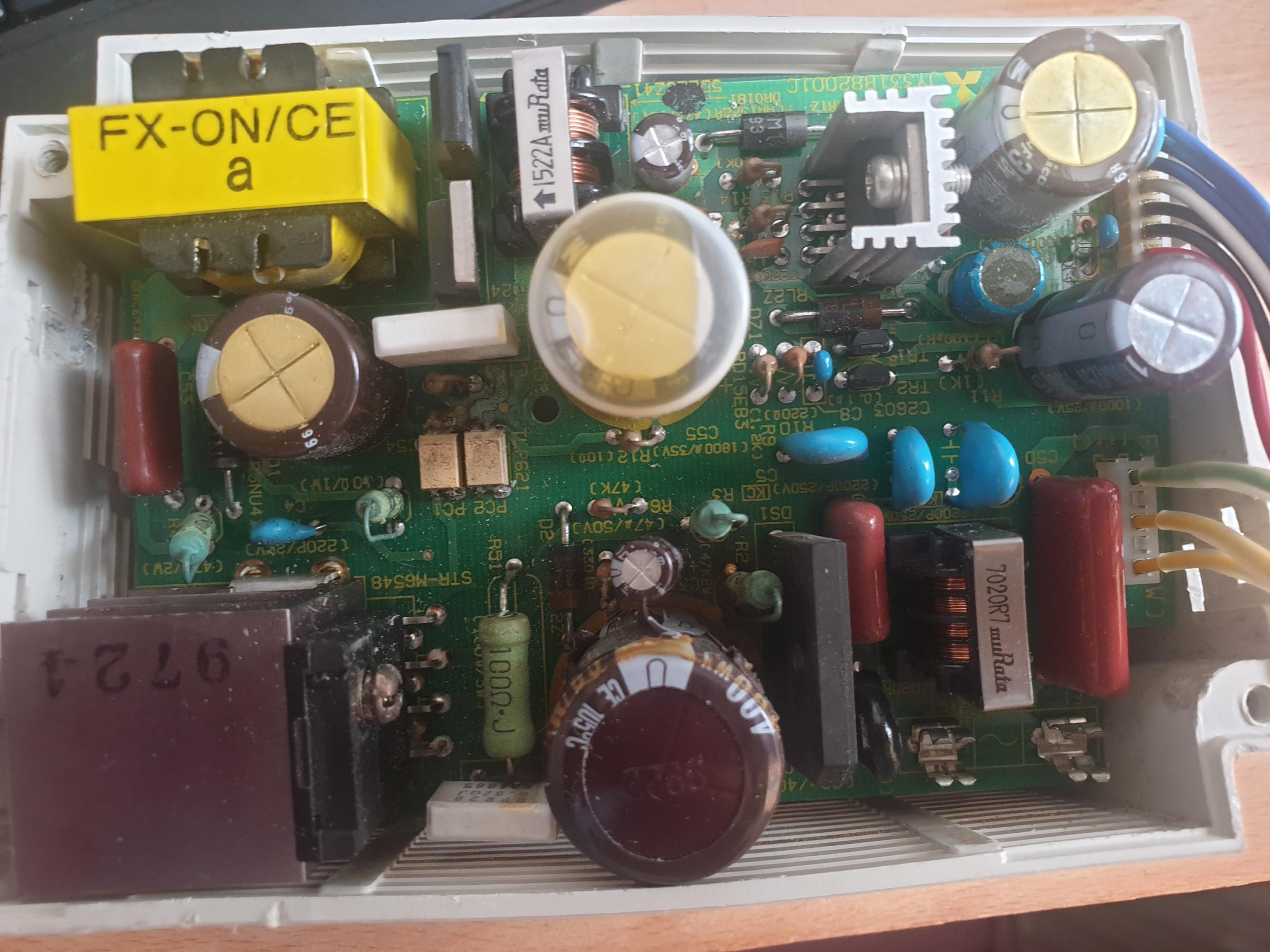

I need help identifying this thermistor
  • Assurance
    • Jun 2020
    • 16
    • u.lk
    sorry if this has been posted in the wrong group

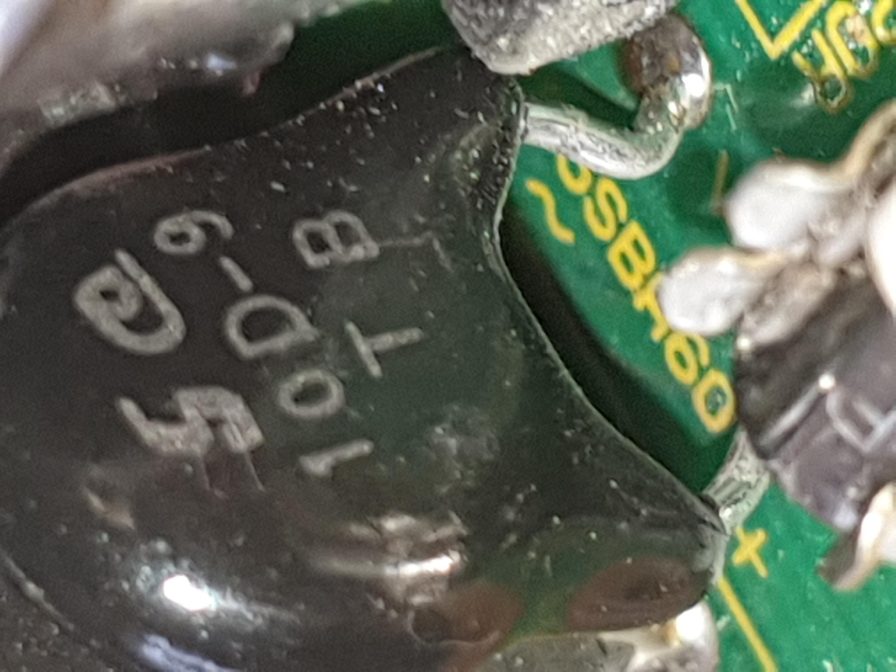

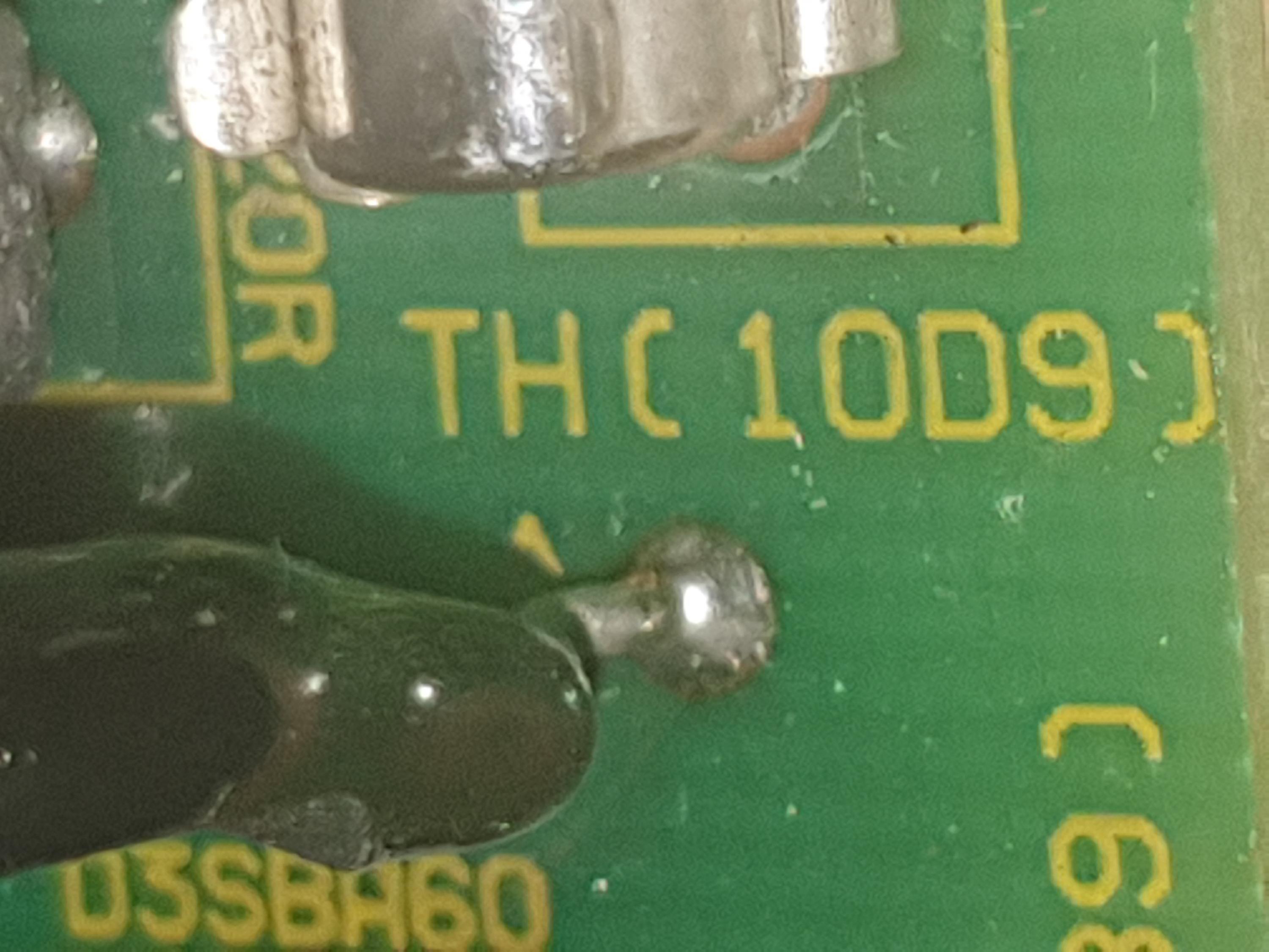

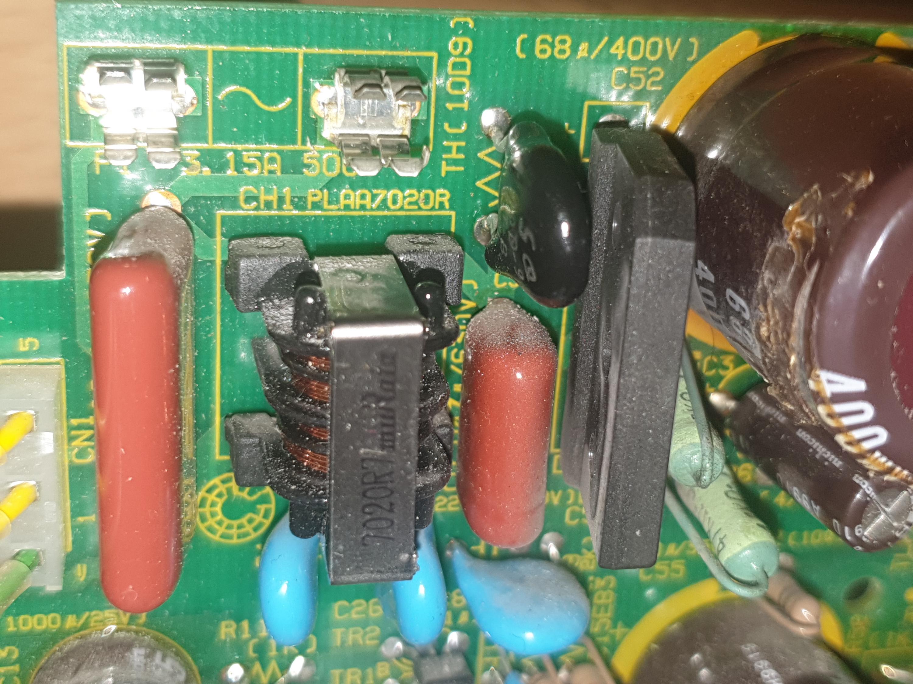

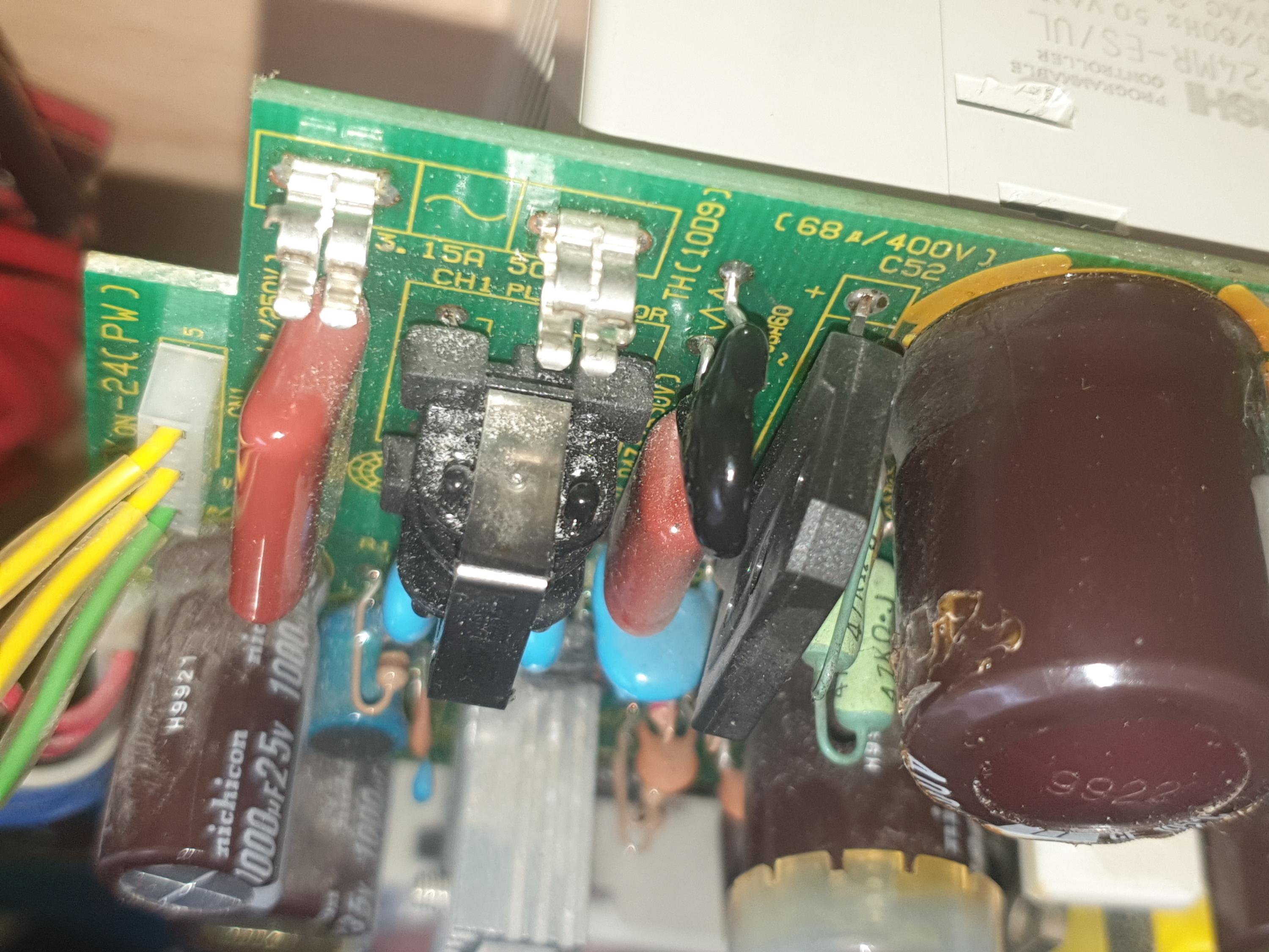

    Im trying to replace this thermistor<<<10D-9 >>>> implies 10ohms, 9mm
    im not sure if this NTC or PTC ?
    I need help identifying this thermistor from
    rs online website and
    https://uk.farnell.com/w/c/circuit-p...ost=thermistor
    what will this be an ideal replacement fro RS ?
    Ive been chatting with RS online but theyve been very unhelpful

    Almost all search result returns as NTC for 10D-9. What is the device used for? I assume its on the mains input side of a power supply; in this case it would be NTC and used to limit inrush current.
    This should be a good replacement: https://uk.farnell.com/ametherm/sl10...r9Wjd6oxzMXZLs

      is it open circuit ?

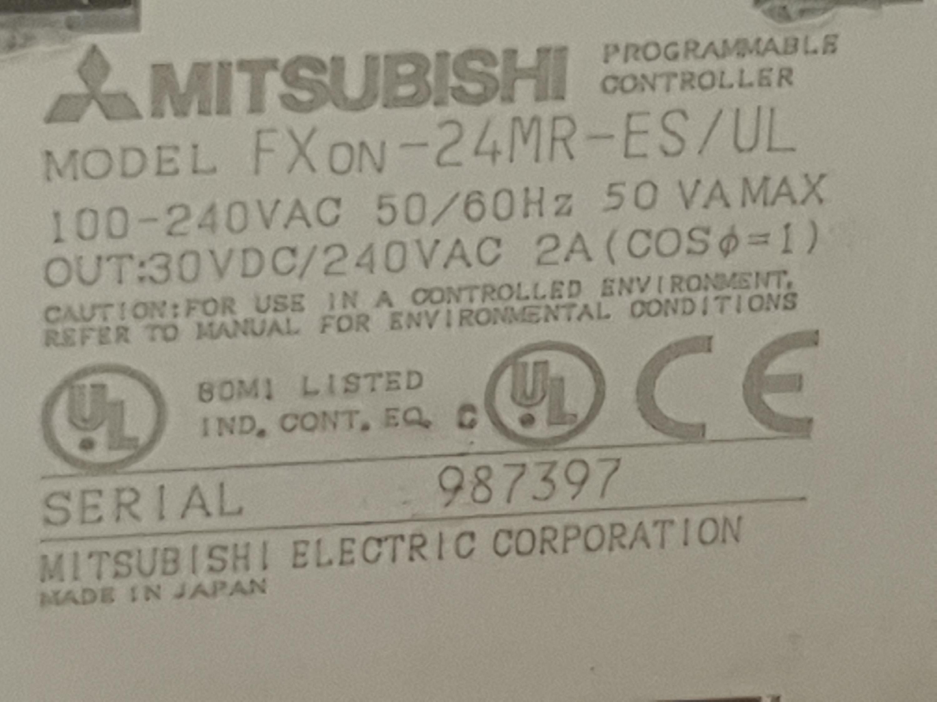

        its part of a controller circuit

          1) Why do you think it is bad?
          2) 10D-9 is the NTC for inrush current protection. It is 10 Ohms 9mm Dia. https://www.ebay.com/itm/10pcs-NTC-1.../221405367958?
          3) What is board not doing?
