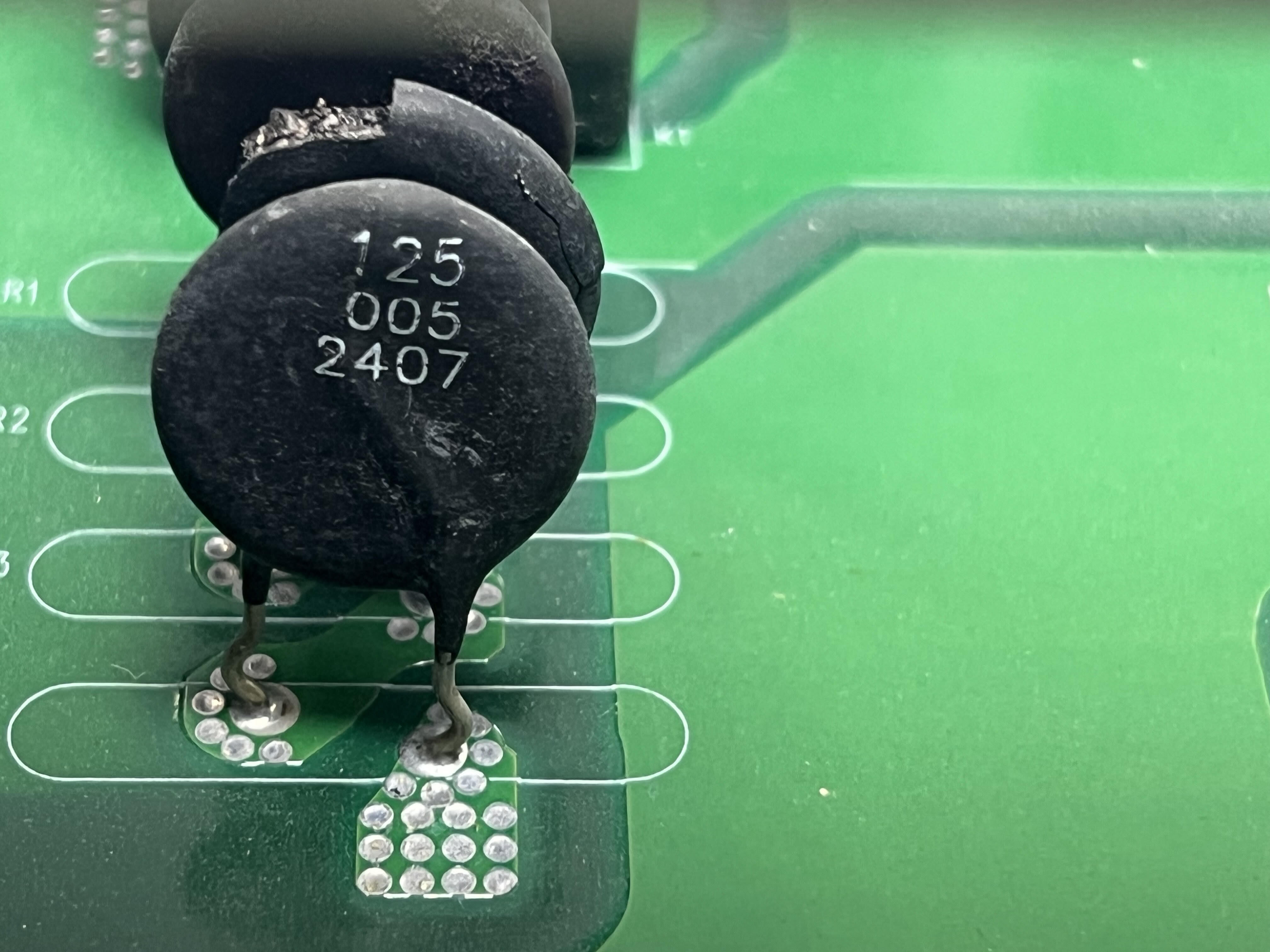

Looking for help identifying the rating on this thermistor
  • skinner
    • Jun 2013
    • 58
    I believe it's a 2.2OHM based on reading the other ones with the same markings. Just wondering if anyone knew for sure what it was. Thanks.
  • truclacicr
    • Apr 2019
    • 346
    • australia
    Does the resistance increase or decrease as you warm it up?
    "2407" is probably a YYWW date code.
    I would have thought that "005" would be the resistance in ohms at 25C.

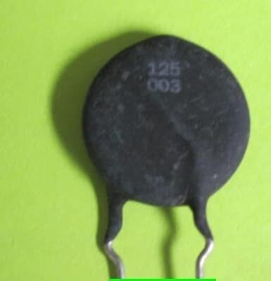

      The closest image I can find is this with the similar numbers 125 003, it is listed as Ametherm Thermistor SL22-2R510, (STI: 125 003) Inrush Current Limiting
      Measure the diameter of yours or provide a make and model of what it is used in
        https://www.ametherm.com/datasheetspdf/SL222R510.pdf
        The part marking is obscure. I can't understand how anyone could make the connection, especially since the datasheet is devoid of this information.
        Nice find, by the way.
          It's a machine used for concrete - model # m12300d and it's roughly 2cm in diameter.
          I appreciate the help btw.
