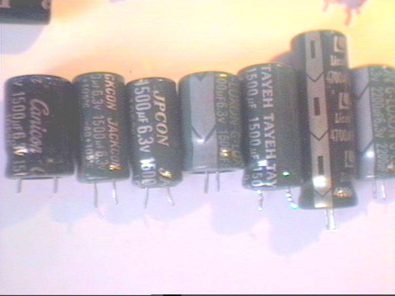

                                      • Rainbow
                                        • Aug 2005
                                        • 1371
                                        #39
                                        Re: bad cap manufacturers - please post yours here
                                        Here are some photos.
                                        Tayeh, Licon, G-Luxon, Jackcon, Jackcon, DST, DST, Jackcon, JPCON
                                        Close view of the DSTs - the smaller one has flat top but the bottom came out:
                                        Canicon, Jackcon, JPCON, G-Luxon:
                                        Misc. other crap - bad mosfets, mosfet drivers, VRM controllers, serial line drivers, etc.:
